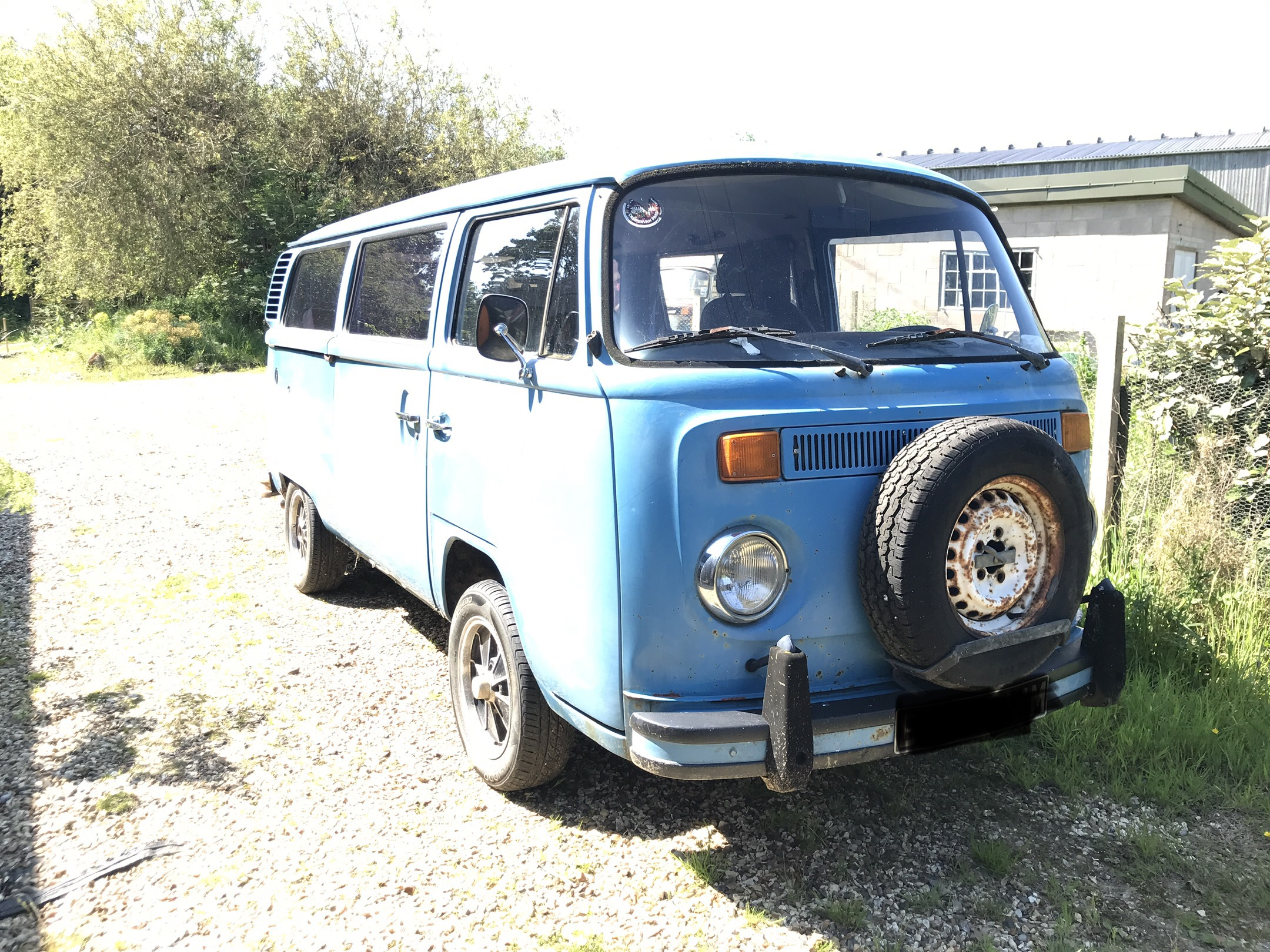

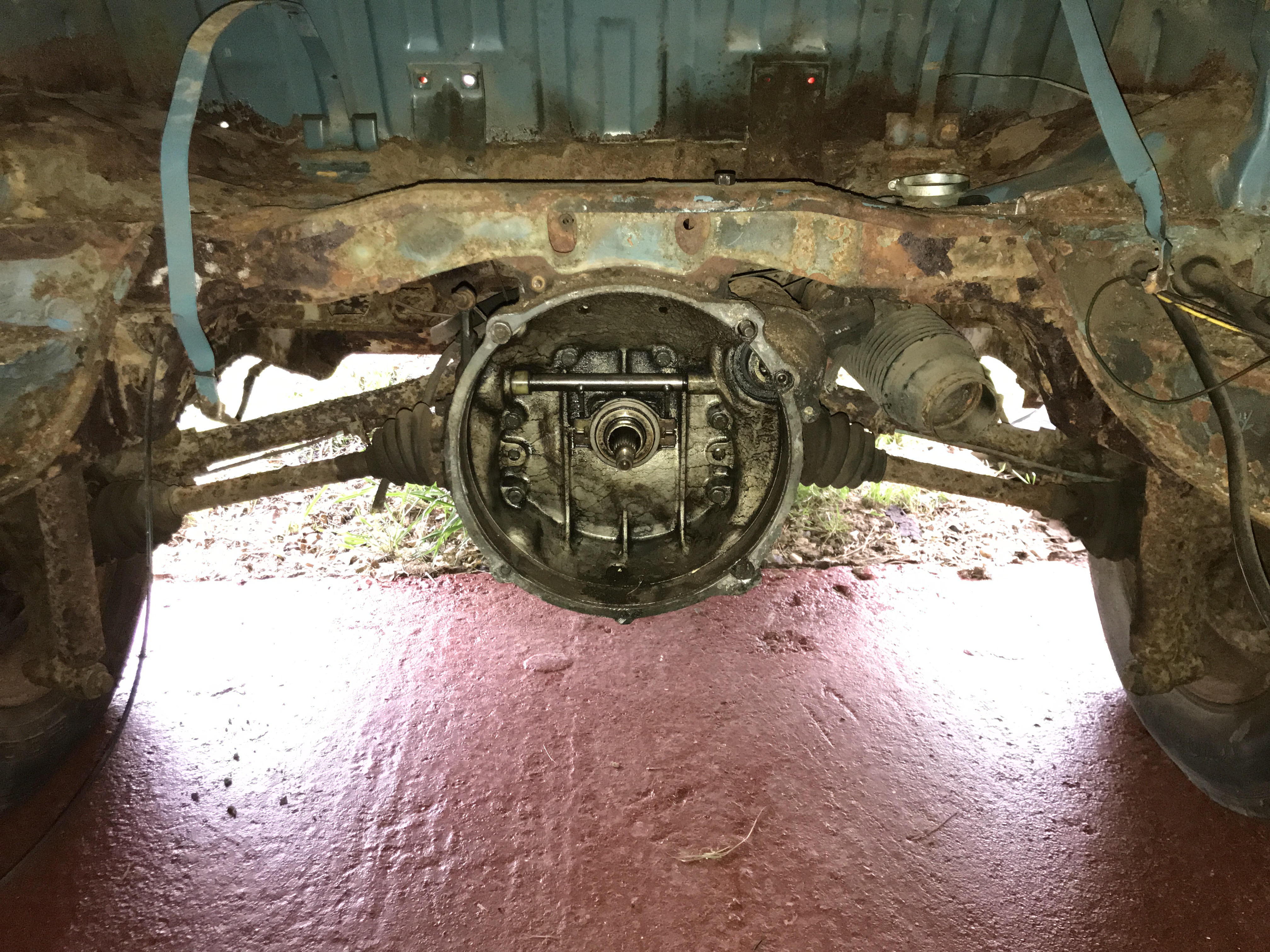

I have a medium nice VW T2. Eventually will be electrified. But I don’t want to practice on that. So have bought a complete failure of a VW T2, lots of v bad rust and daylight everywhere. I will practice on this.

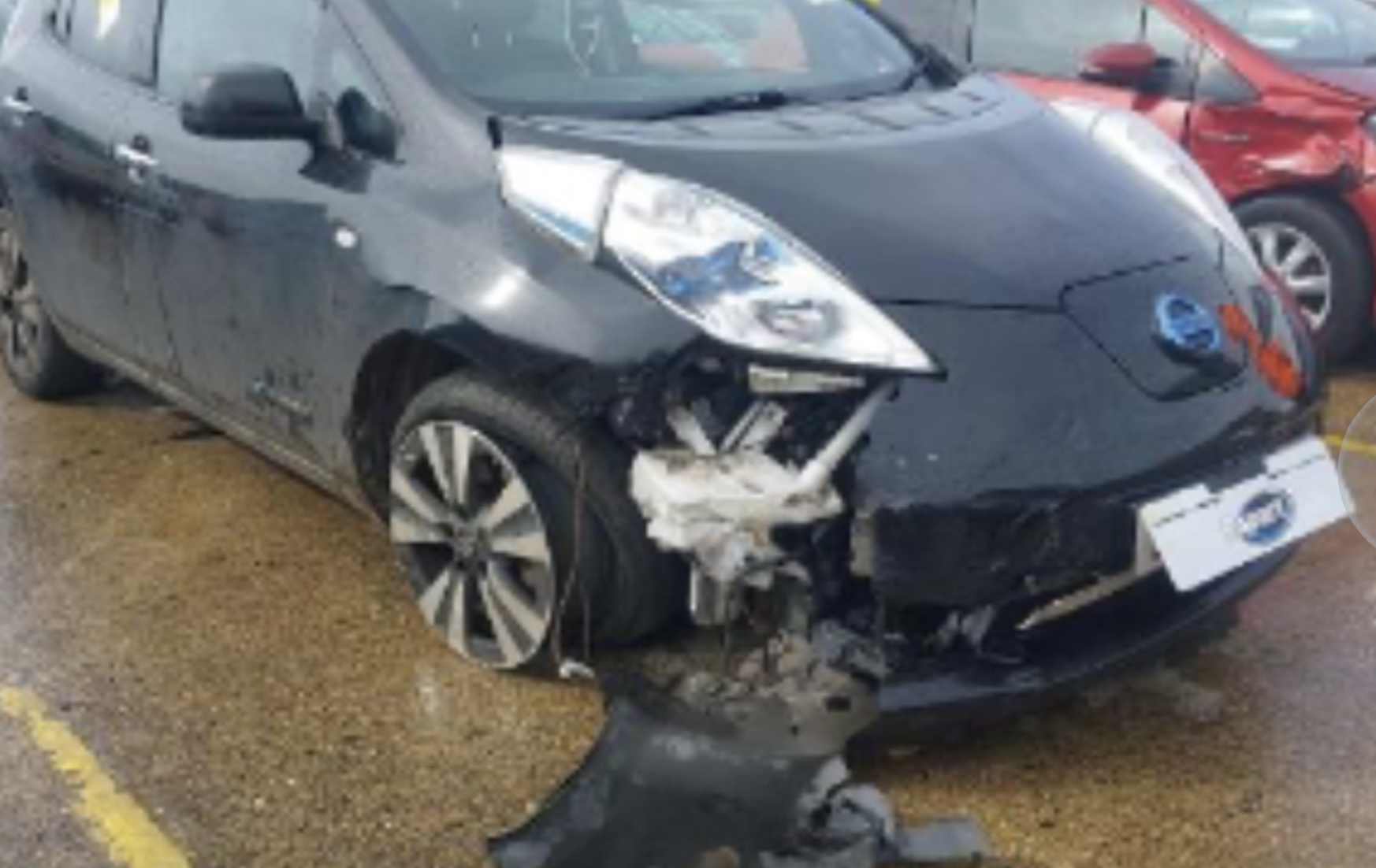

I have bought a smashed up Leaf (2015), 24kWh batt. It arrives tomorrow.

Re: Leaf to VW Type 2 Campervan
Standing on the Shoulders of Giants.
The path that got me ready to try my first conversion is a meandering one, as it should be. I'm going to list a bunch of the links, posts, etc that led me here. The actual list is much longer, but if my build turns out to be successful, and you have a question on how i got wherever i got to, this page might be useful. As described in my intro post, I class myself as a beginner, not a hacker or code monkey. So some of the feats of wonder from Damian etc are not in my list as its outside my abilities currently.
Parts I'll use

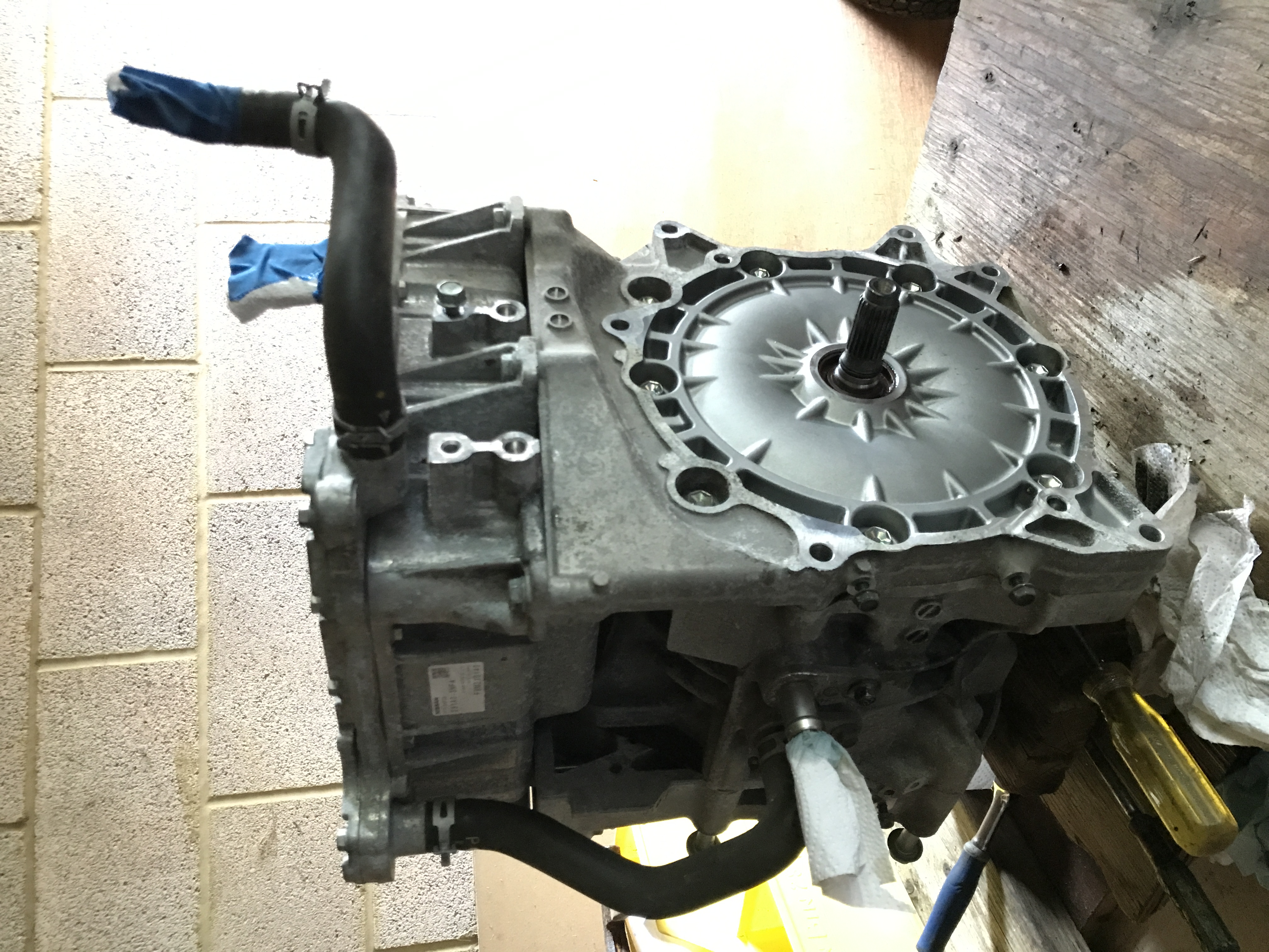

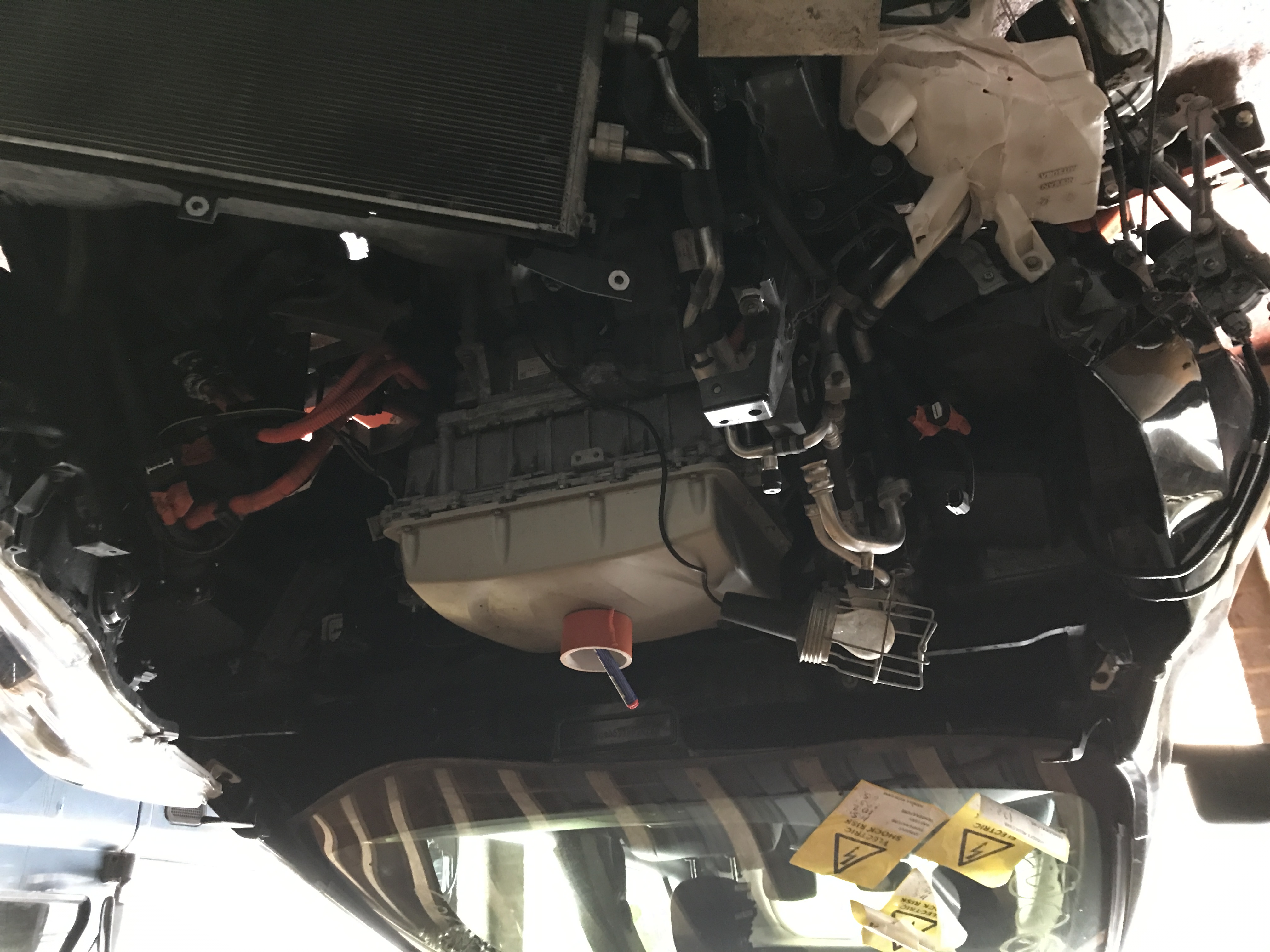

Take object A and insert into position B. Simple.
Actually, slightly stuck on the aircon currently. Still pressurised on the Leaf and have not found anyone interested to come out and suck it out professionally. Need to sort that before I can get the engine out from what I can tell.
Object A (shown upside down, not my fault) Position B
It’s free… (meaning released from captivity, not zero cost!)
Sorry about photo orientation. Second time it’s done that. Probably a setting I need to work out.

not sure what you planned to do as far as an adapter goes but I split the leaf gearbox casing and then left the half attached to the leaf motor as a spacer and made an adapter to go from that to the gearbox, here's a link to my post if you want to take a look it's right near the startianlighting wrote: ↑Tue Apr 30, 2024 7:17 pm

Nice idea. I’ll have a look at what you did when I have a bit more time. Current plan is to get adaptor plates and coupler from BratIndustries, but nothing is finalised yet, but I have sent Angus an email yesterday I think to move it forward a bit.andybpowell wrote: ↑Tue Apr 30, 2024 7:35 pm not sure what you planned to do as far as an adapter goes but I split the leaf gearbox casing and then left the half attached to the leaf motor as a spacer and made an adapter to go from that to the gearbox, here's a link to my post if you want to take a look it's right near the start

yes there's lots to consider in the whole process budget, timescale, what you want to do yourself and what you can do yourself so many things to considerianlighting wrote: ↑Tue Apr 30, 2024 7:42 pm Nice idea. I’ll have a look at what you did when I have a bit more time. Current plan is to get adaptor plates and coupler from BratIndustries, but nothing is finalised yet, but I have sent Angus an email yesterday I think to move it forward a bit.

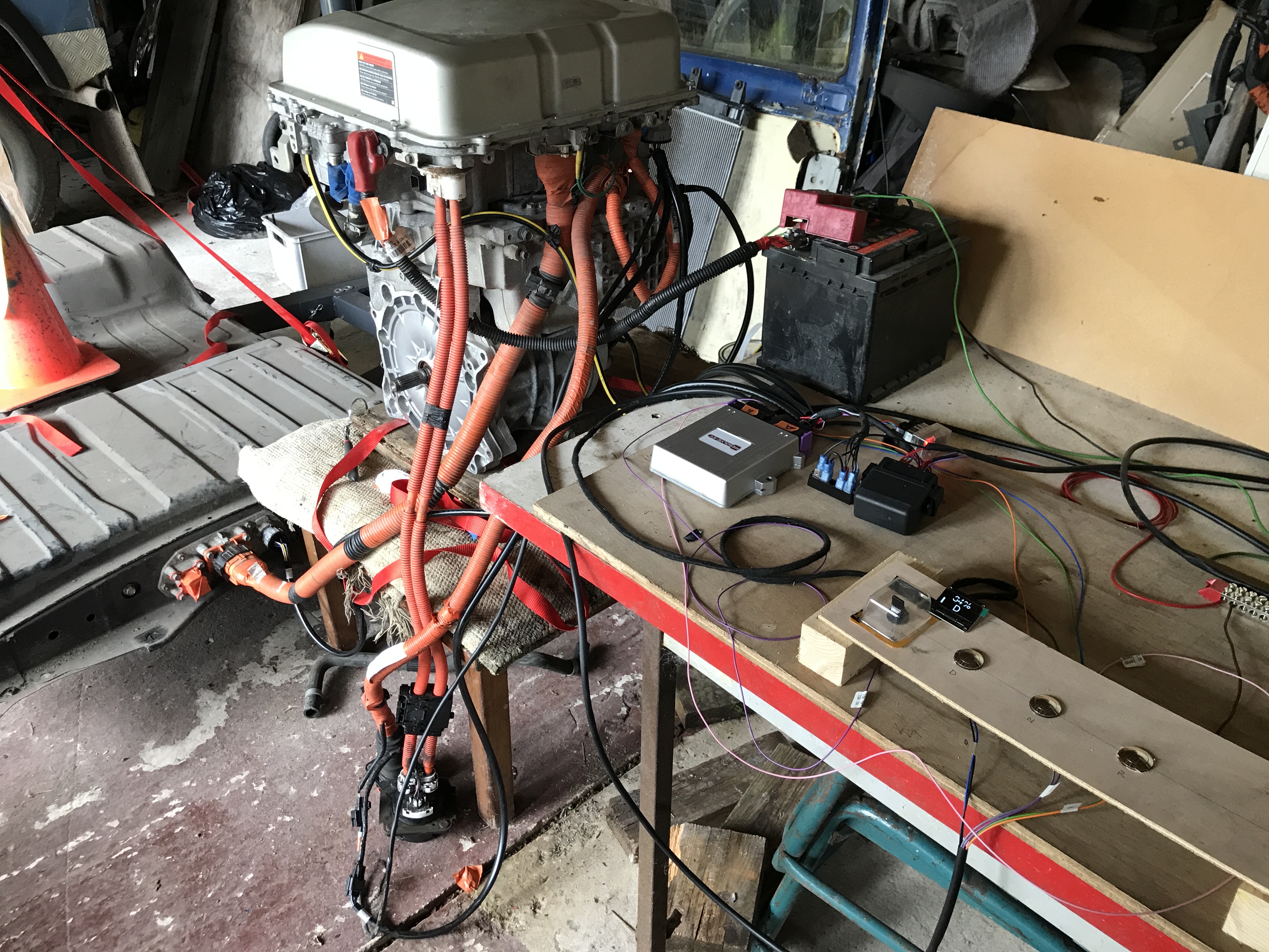

Next stage - received Resolve EV controller, plus I went for supplied wiring looms. Nicely packaged and went together well.
It’s been so long since I pulled the main battery disconnect or out that I completely forgot to return when I was ready to test. That took a while to sort out. Idiot!
Anyway, it seems to be alive, but frustratingly I can’t get it to switch from neutral to drive or reverse.
I have tested 350v is getting into the PDM and down into the inverter. My 12v is good and Resolve display starts up after ‘ignition’. But nothing from my D or R buttons (switches and 12v is good there).
More tea may fix it.
EDIT: actually, a gentle nudge in the right direction from Isak at Resolve-EV, all working now.
Just need to deal with an odd accelerator behaviour now. I could not find the recommended pedal, so this may be the cause.

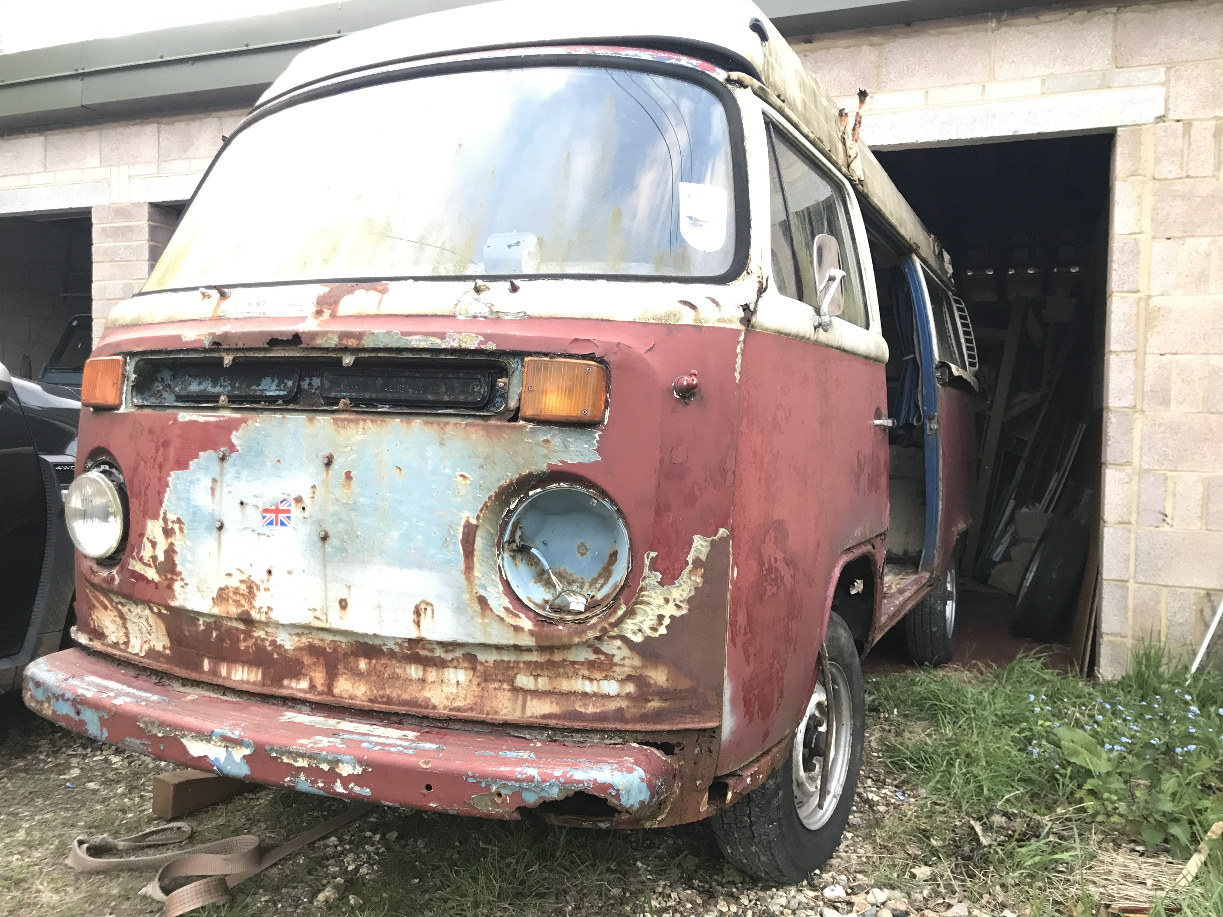

And maybe it’s worth a photo of the final VW I hope to convert once all the stars have aligned and I’m fully tested on my initial disaster-bus.
Doesn’t look too bad, but it’s got some rust that needs sorting now before it gets too far, so this EV-ing will also trigger some restoration work.

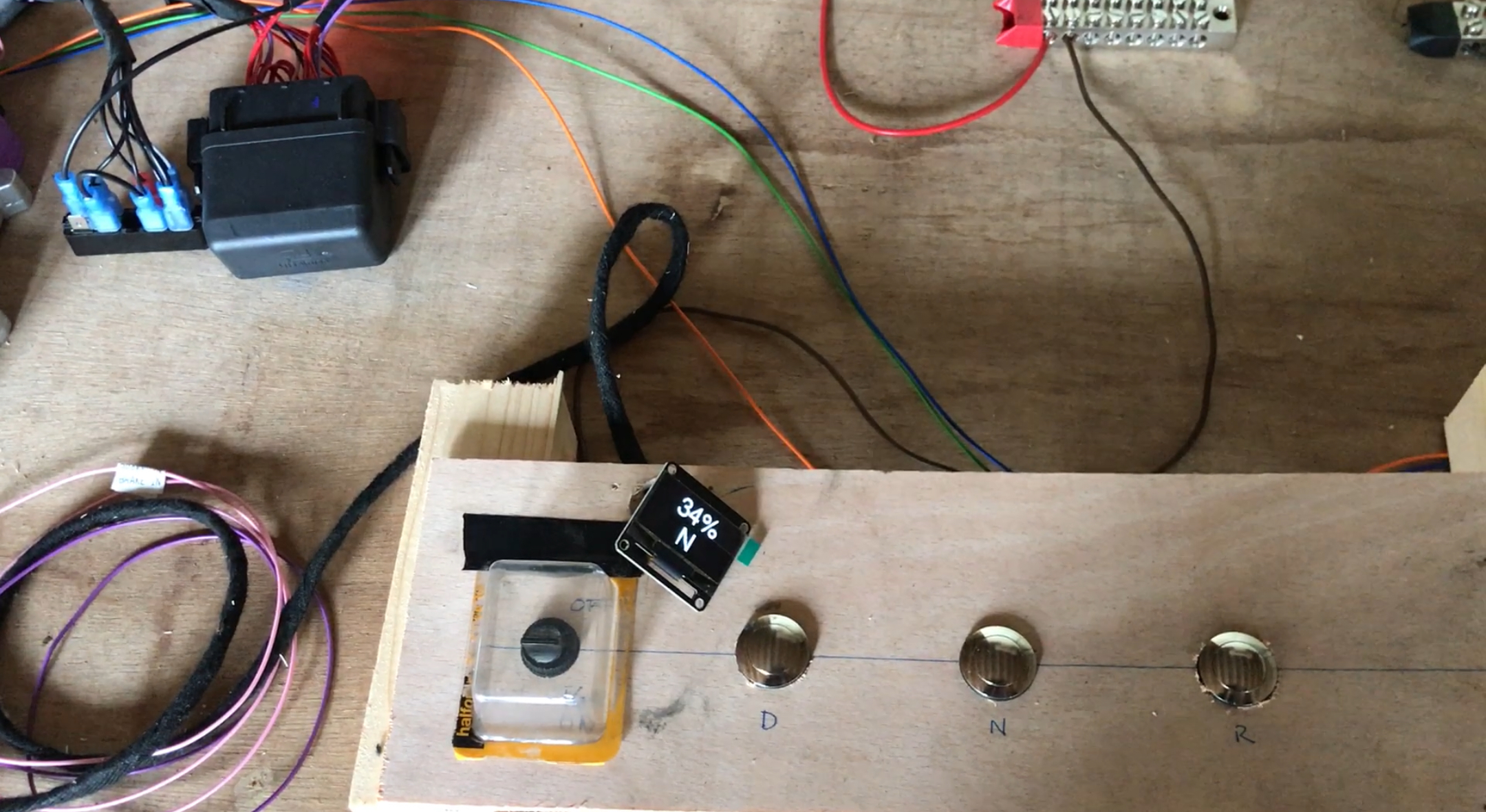

Things have been quiet on my build. I’ve been waiting for my Brat Industries coupler and spacers. They are now in the post! So hopefully I will be able to start making some substantial progress soon.
I was having a panic yesterday on my bench setup. I could switch D, N, R on the buttons and this was tallied on the small OLED, but the motor only reacted in reverse. drive did not move. Had I blown something up? Nope, a stray copper thread on the back of my brake button was shorting. So the brake was ‘on’, preventing driving forward. Panic over.

1 - I don’t have a decent workshop, so I can’t put the VW up high to work underneath for long periods. Just axel stands and jacks.
2- I know a lot of people do it, but there’s something fundamental worrying to me about daring gravity not to do it’s thing and pull the battery out from under the vehicle. This is a first build in many ways for me, so I am taking low risk approaches when I come to choices. Putting it inside means it can’t go anywhere.
Although I am keeping the normal gearbox, I expect it will be left in 3rd most of the time. Just like you, I will change direction on the motor using DNR buttons, not using the mechanical gears.
Steering / weight - partially unanswered. But I currently expect to be about 200kg heavier. But it’s built for a 800kg payload, so in theory I’ll be well within spec. They were built for hard work originally. Having said that, I may go for a power steering upgrade. I know a good VW mechanic who has done this successfully on other T2s. But I haven’t gone into detail on it yet.

If the weight of the Leaf motor is similar to the weight of the VW engine, that will lever enough weight off the steering to balance it out reasonably well, it just depends how far forward you plan to mount the battery pack.ianlighting wrote: ↑Sat Oct 05, 2024 5:41 pm I thought if the battery under the chassis. Reasons not to for me -
If you are keeping the gearbox, you won't have that area or the engine compartment to use, but you will still have where the fuel tank was and under the back seat area ....... under the floor does keep the weight down low to help with the handling .... the Kombi at it's best has the reputation of handling like a dog on a polished floor

By my calcs, Leaf motor stack is 100kg (not incl battery) vs 160kg for VW incl 50% full fuel tank, plus all the other gubbins I don’t need.T1Terry wrote: ↑Tue Oct 08, 2024 10:10 am If the weight of the Leaf motor is similar to the weight of the VW engine, that will lever enough weight off the steering to balance it out reasonably well, it just depends how far forward you plan to mount the battery pack.
T1 Terry
Then battery on top which is still to be defined but you can see roughly where I’m at if battery is say 300kg -TBC
If I could wave my arms and it just happened, yes underfloor would be great. But in my real world I’m happy with placing under bench seat and behind front seat bulkheads. Should be good horizontal position if a little higher than ideal.
This is a T2, so handling and performance are not the goal here!
