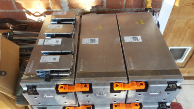

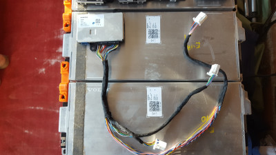

I have a 69kWh Polestar battery (only modules, bms slaves, bus bars and cables, no case or contactors)

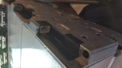

24 modules 2.88kWh 390mmx152mmx110mm 13.1kg, cell tap connector TE 936348-1.

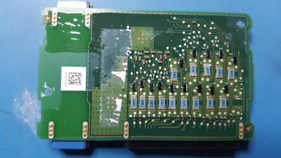

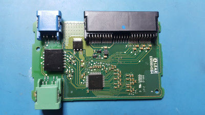

8 BMS slave modules LTC6812 based (ISOSPI interface), connectors JAE MX77D040HF1 MX77A004HF2 MX77A004HF3
The bms slaves I have are populated with 14 balance resistors, the pcb is layed out for all 15 cells the LTC6812 supports.
Each BMS slave, monitors 3 battery modules (12 cells voltages, 6 temperatures). Each battery module has 2 NTC temperature sensors, Approx measurement 13k at 18degC, 17k at 12degC.
As I don't have any other Polestar parts I can't help with can bus decoding, In any case I think it would be easier to interface the BMS slave modules directly since the LTC6812 datasheet and code is available (Analog Devices Linduino)
For my vehicle conversion I intend to design my own hardware using LTC6820 to interface with the BMS slave modules with software based on simpbms.

The modules are 4S3P, (3P was found online somewhere) 196.2Ah, either 24 or 27 modules per battery (69kWh or 78kWh). I don't know what type of cells are used, nominal voltage is 14.68V if that helps. I don't intend to open a module though, the cover is welded to the module frame. Picture of the label attached.
