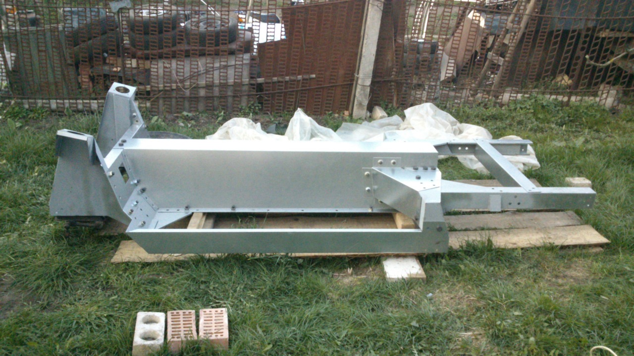

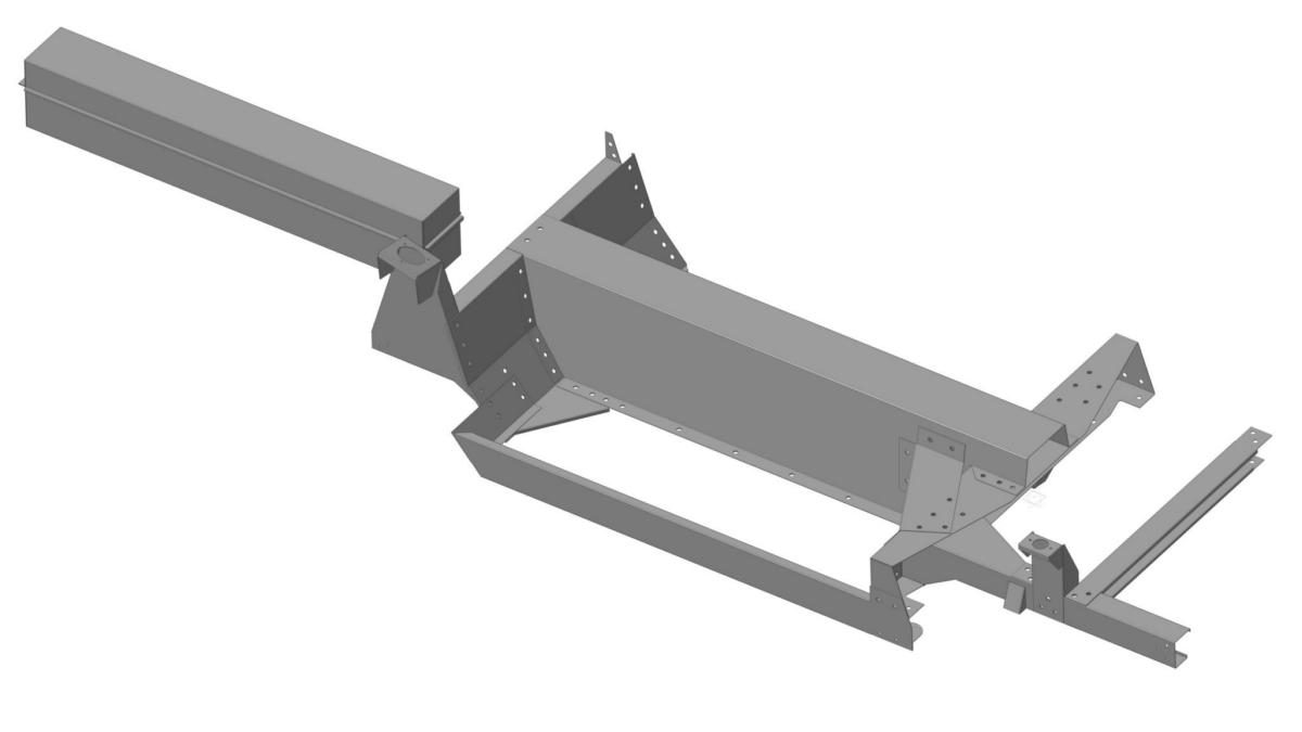

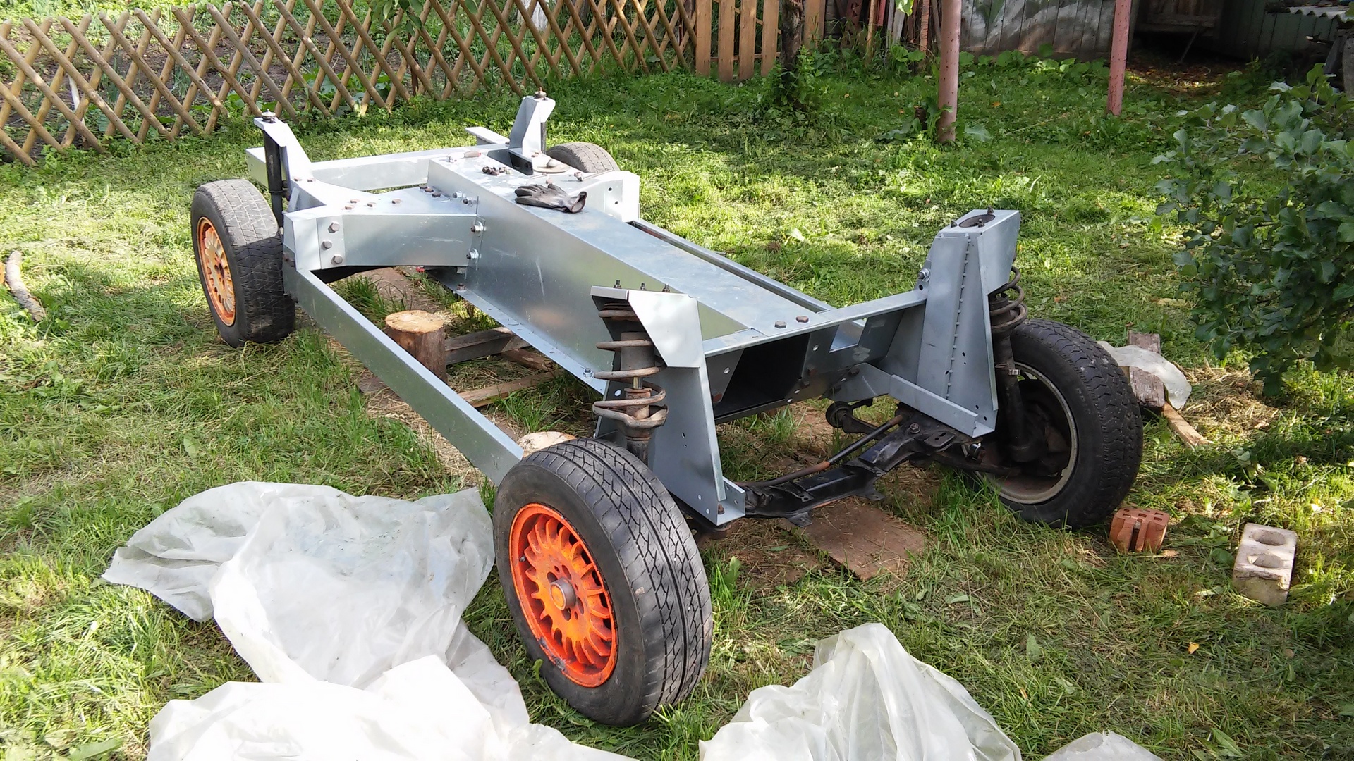

This project is lasting for too long already. It was named "Zero Emissions Frankenstein" because it was built a little bit from everything. Main goal however was to make myself busy and to fight boredom. :mrgreen:
Frame was designed as so called "backbone chassis" and central tunnel was supposed to contain battery pack of 22 100Ah LiFePo4 tall cells.
Suspension and drivetrain was from BMW E30 because I always wanted to create a RWD car, to have drift fun sometimes =)
It was made of sheet metal because at the moment I was working as a bender, and looking at that decision from now, I realised how wrong I was.
DISCLAMER: FROM NOW ON THIS FRAME IS GOING TO SCRAPYARD, PROJECT WILL CONTINUE WITH NORMAL TUBE WELDED FRAME.

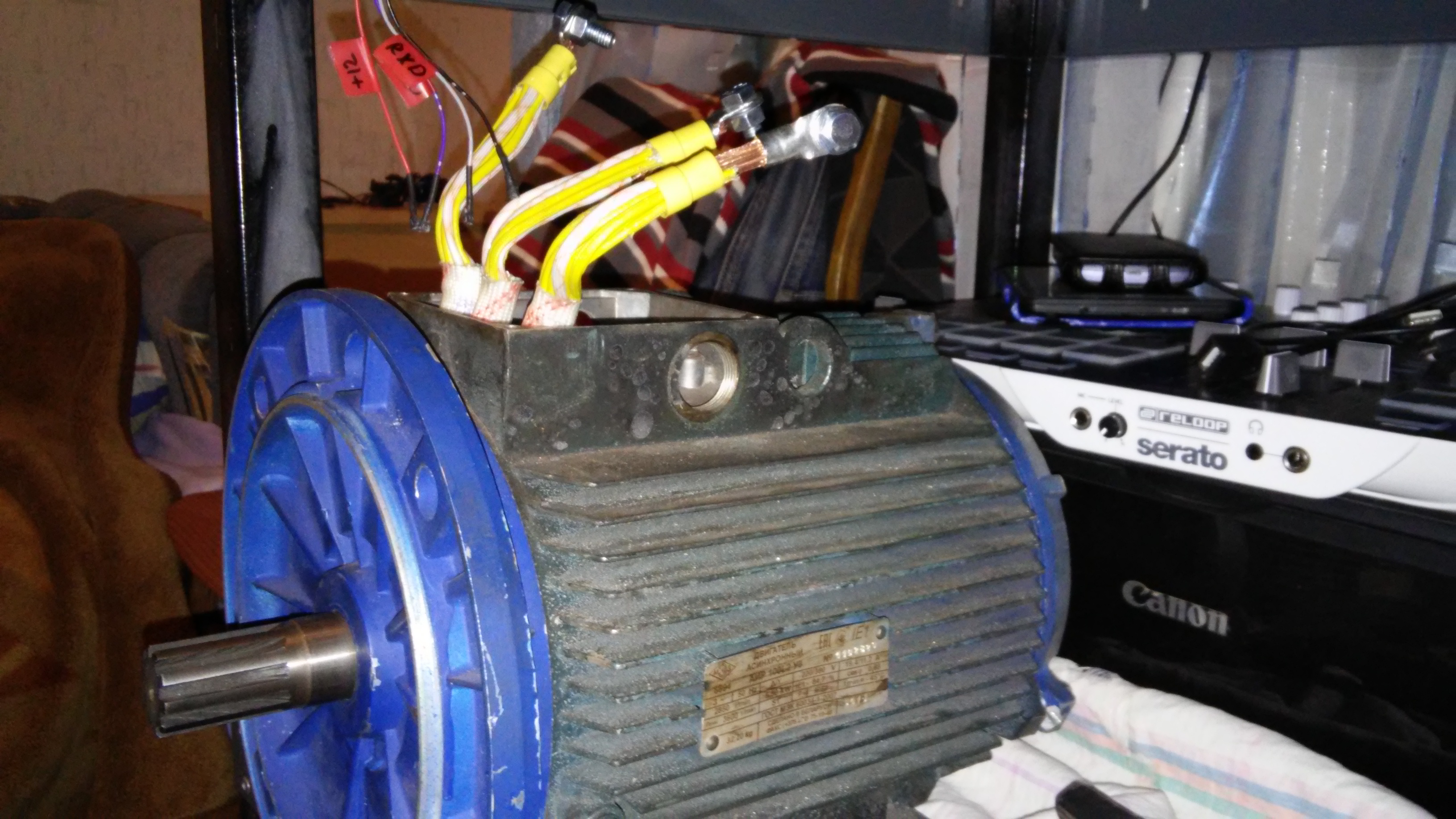

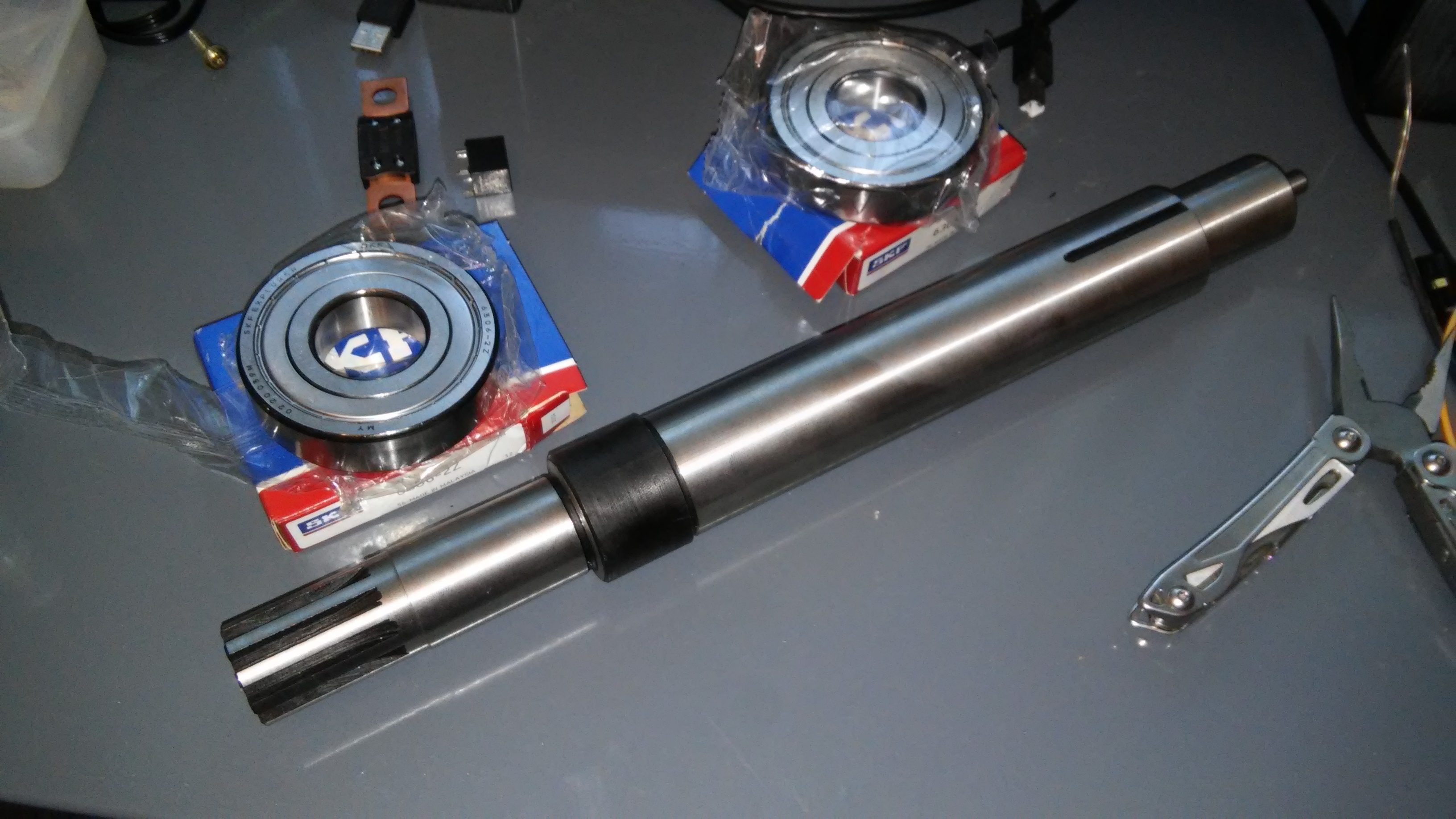

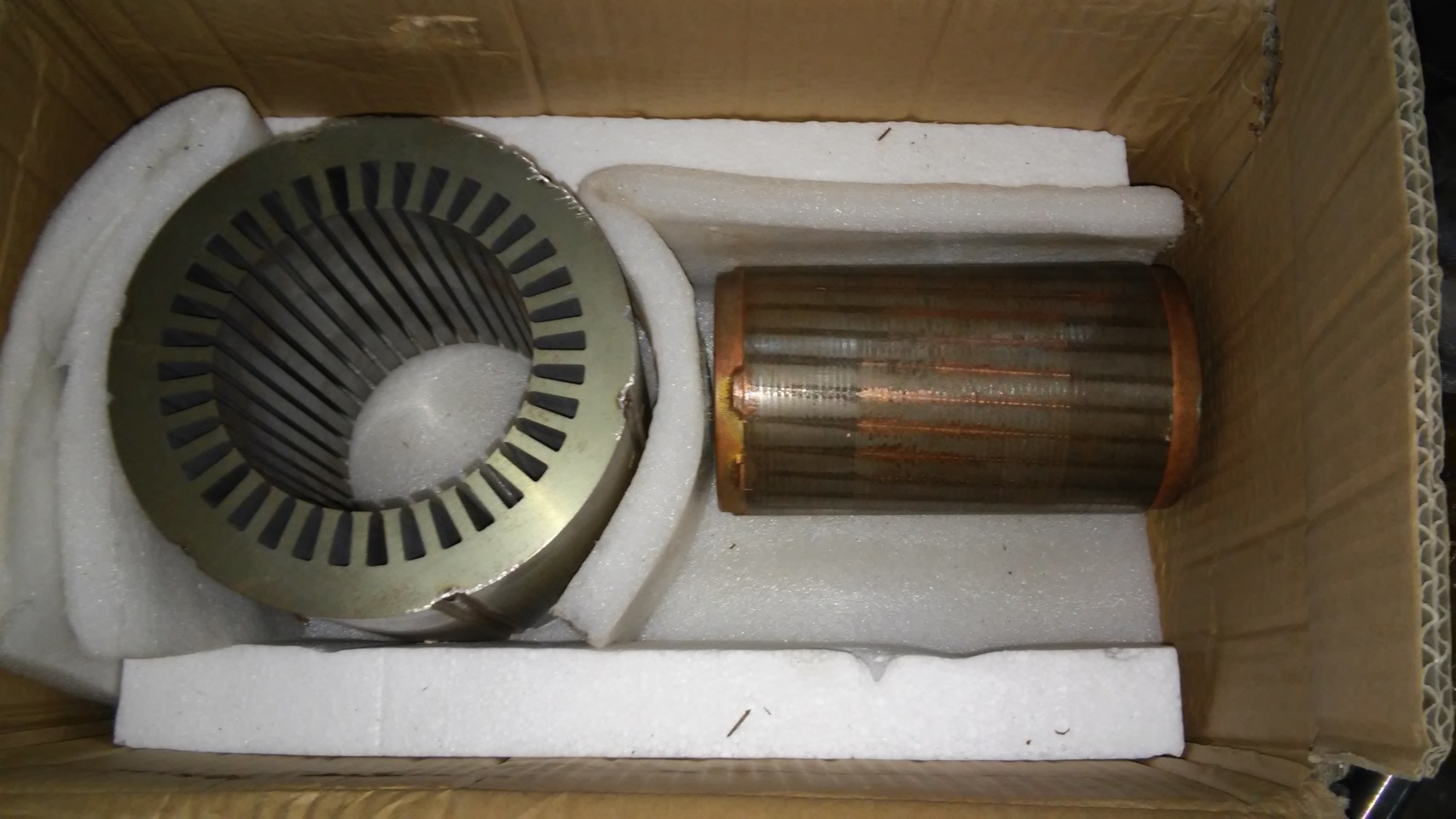

As powertrain, I chose ACIM custom made motor with combind windings(and that was a mistake, as I learned later),
copper rotor from kienle-spiess.de, custom made schaft and AMT 102-V encoder.
To power it I chose Curtis 1236-6301 inverter. Curtis inverter provides a torque control mode, which is incampatible with combined windings.

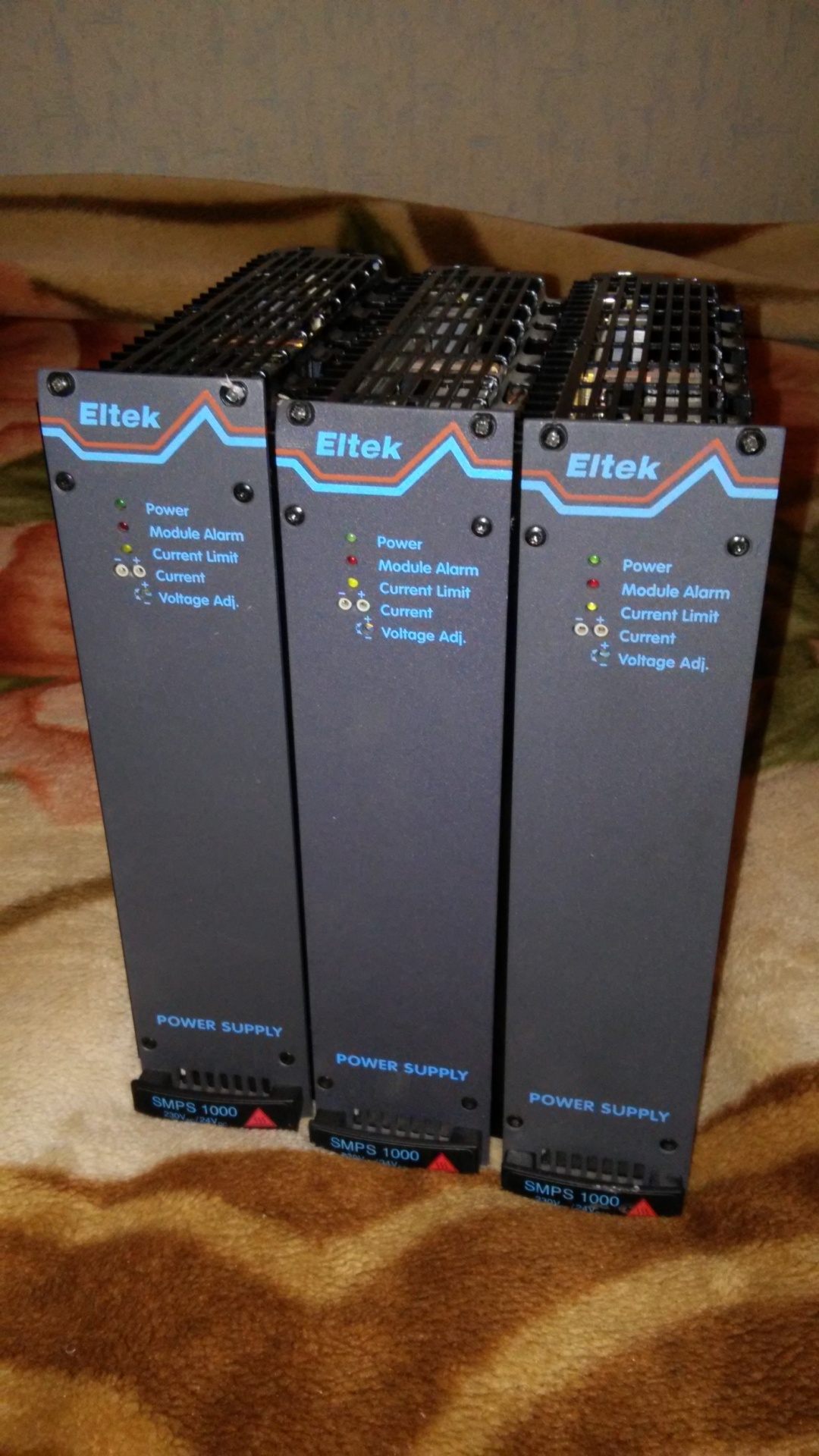

So voltage of the system was supposed to be around 80 volts, to charge battery I've bought three Eltec SMPS1000 power supplies to work in series.
I've also purchased PowerWatcher2 and Smart BMS from Yury Logvin, I bet some of locals know him :)

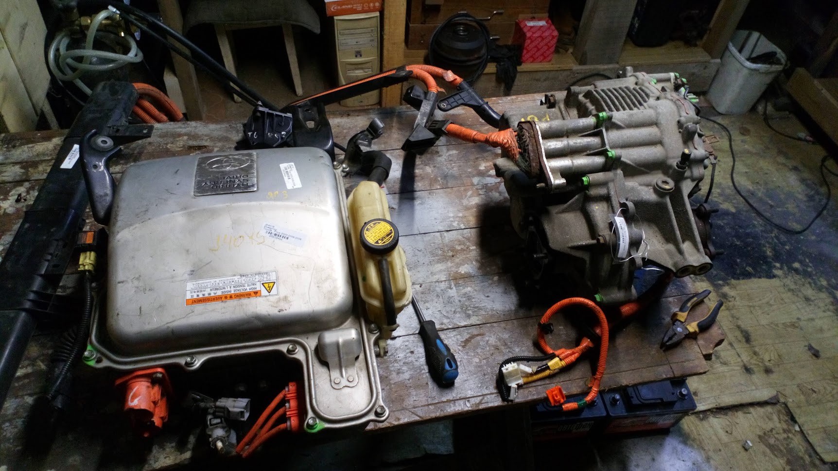

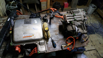

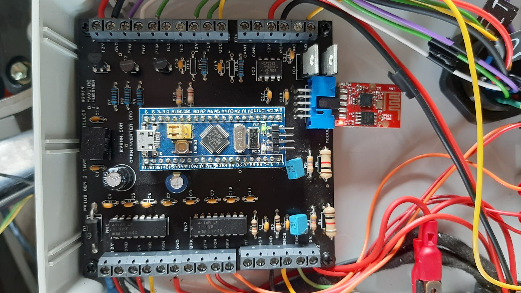

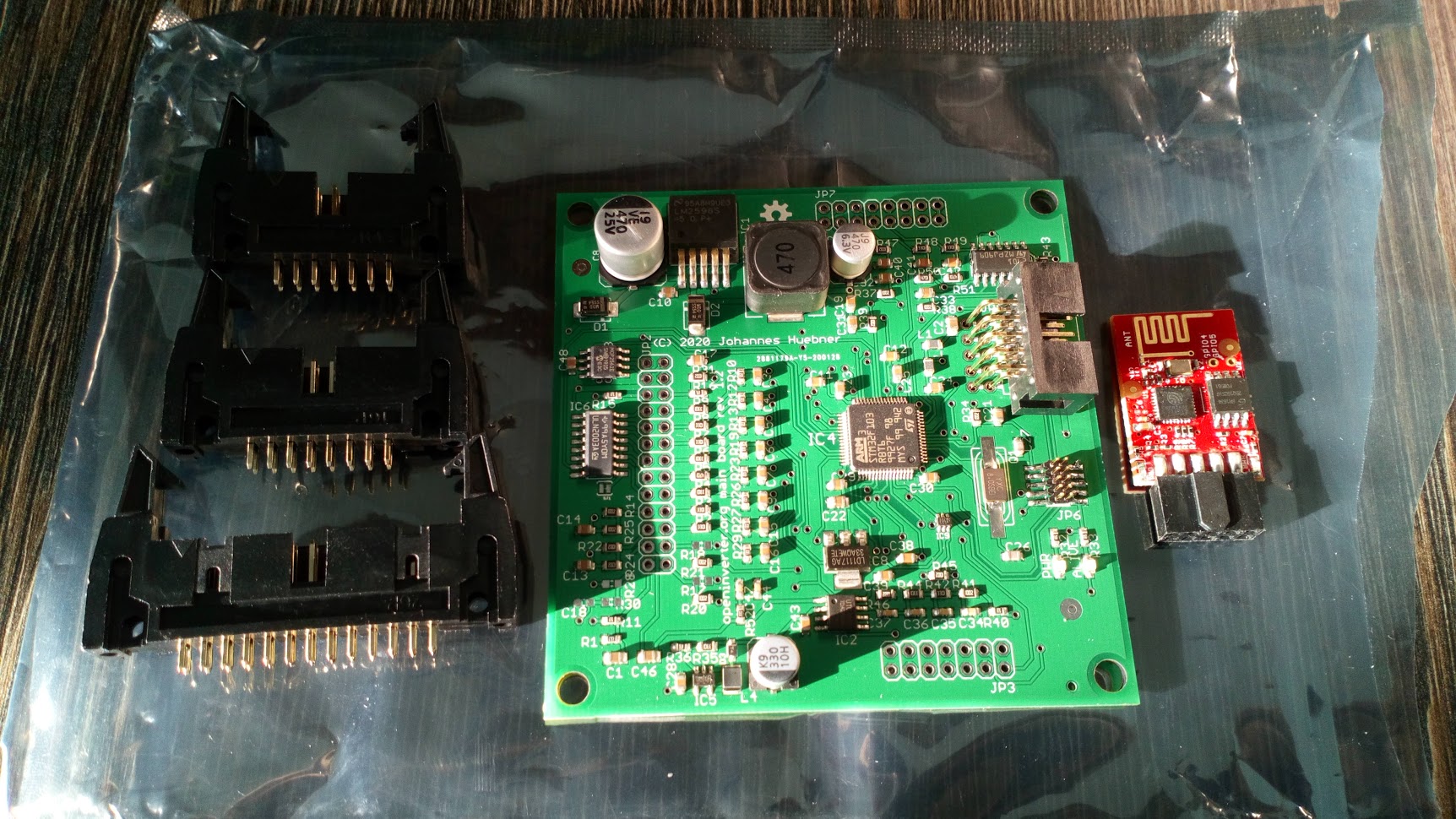

For now, I've bought Prius Gen 2 inverter, Gen 3 inverter, Lexus RX400h MGR, Damine's gen 2 board and Johu's gen 3 board.
Currently I'm experimenting with Damien's board as it is the simpiest one for pairing it with gen2 inverter and ACIM motor.
I believe for now I'm the only one who actually drove a vehicle, powered by Damien's gen2 board.
So here I am, continue to fight with issues here and there and thinking which way to choose, cheap inverter, or cheap control board...

So today I've fixed an issue with "din_forward" stuck on high. It was dead capacitor C9. Voltage didn't dropped when forward pin was switched off. Still don't know why main contactor isn't closing, when precharge is deactivated... Might be issue with BTS117, both of which I've populeted myself. Web inteface shows no "stop" errors, only "warn" ones, as il1 and il2 are not connected.
For a good tuning process I need a water pump, because powerstage overheats instantly, as it's almost 30*C every day :? Nnfortunately, I'm under quarantine, and can't go and buy one. Need to wait one week....

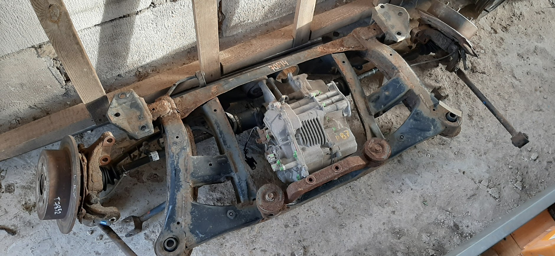

When I've watched Damien installed MGR into BMW subframe I desided to go same way: to cut my BMW driveschafts and Lexus driveschafts and weld them together.... and then I've found out how much E30 parts cost here in Belarus :shock: I desided to leave them as is and sell later.
Insteard I've bought the whole Lexus RX400h rear subframe with another pair of driveschafts and hubs. It cost me 50 euro - dirt cheap even for my country I must say :)
I also found out that Toyota Camry 40 (4x4) and Lexus RX400h are technically the same car: same schock absorvers, same hubs, same subframes, same steering rack etc... Some parts for Camry cost cheaper, some parts for RX cost theaper. So I've bought front hubs as well, will buy front subframe eventually and need to somehow connect MGR with front hubs for a AWD. Number of splines is the same, but diameter is different. At the same time nut diameter and thread are the same :? Need to work that out.
