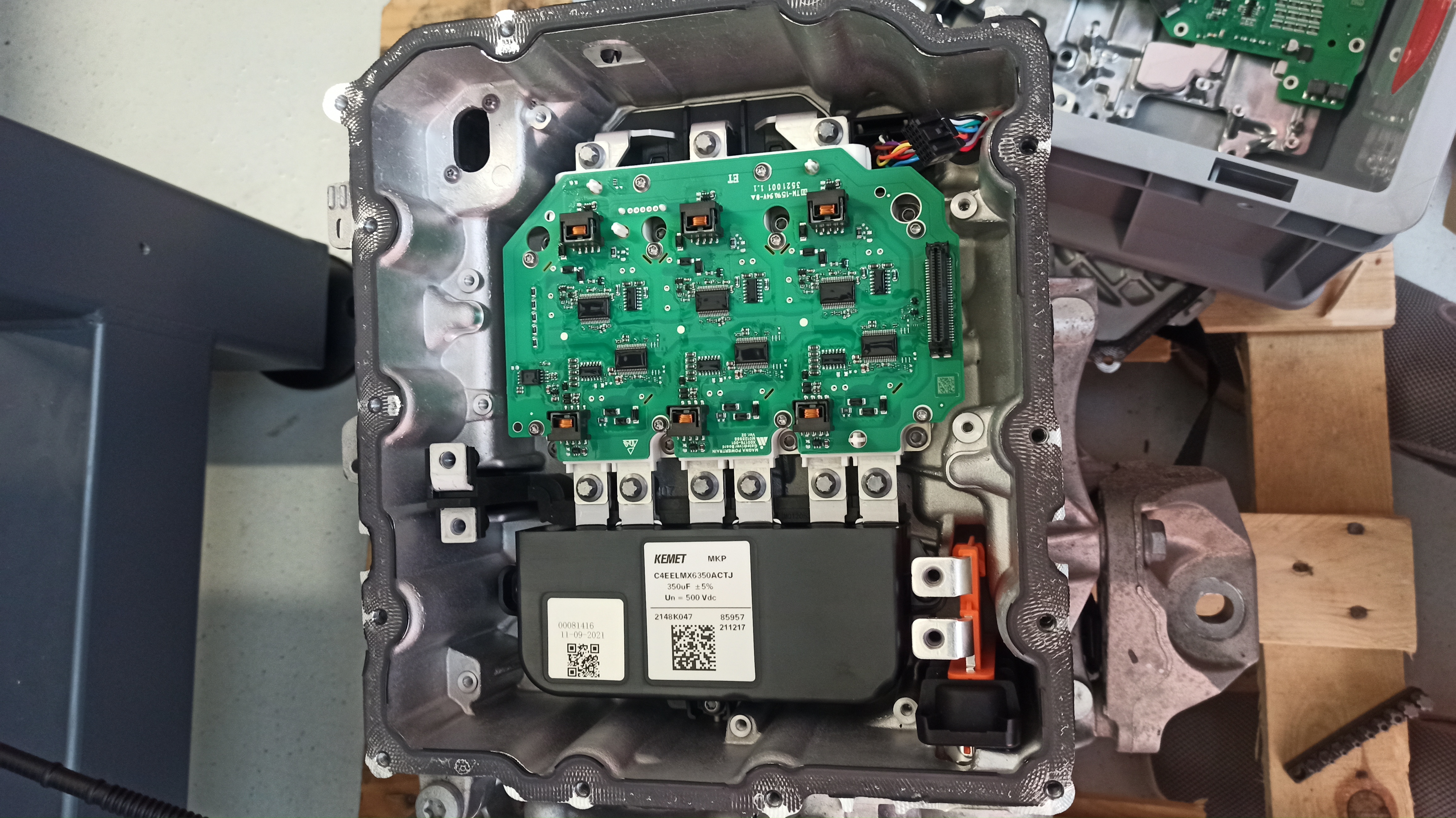

Here are a few more pictures of the ID4 front inverter. This drives an asynchronous motor and has a rated output of 80kW.
The IGBT power module FS660R08A6P2FLB is used together with the LEM current sensor HAH3DR 660-S07/SP2.
Here is a comparison of the housing sizes between the Leaf inverter and the ID4 front inverter.

Post by BarkasFlo »
Small update: I have finished designing the replacement driver board version 1 for the IGBT module.
Piggybacked onto this board are SKYPER 12 R drivers from Semikron. I also managed to remove the original driver board, which was pressed on using a press-fit connection, without damaging the IGBT module.
When a man says he's going to do something, he does it. You don't need to remind him every six months.

The adapter boards arrived today. After a short moment of tension, the certainty that all the holes are in the right place :D

Just out of interest, is there a reason why the board is so large and not limited to the mounting holes and connection pins? Because of the shielding?

To the phase output side it is so large because of the mounting of the current sensors. On the DC-side i could have spared some millimeters, but it was easier and quicker in the design process to just make a rectangular shape. And the cost of the PCB isn't increased very much. I think it also helps with the shielding, but that wasnt the reason for the design.

Is there a reason for not just using the pre existing driver board?

Reverse Engineering of the Schematic of the existing driver board (Parts, Connections, etc.) is way more complicated for me than just design an equivalent driver board. Some ICs don't have a part number and i don't have a x-ray machine to follow the signal traces.

Progress has also been made with the driving of the IGBTs in the MEB inverter. I have assembled the adapter board and installed it as a test.
To do this, I had to cut away about half of the intermediate base in the inverter, as the driver board is higher than the original. (I was already aware of this during the design process). The next step is to design the control board with microcontroller, CAN interface and resolver interface to test the driver board. I will try to tackle this as soon as possible.
