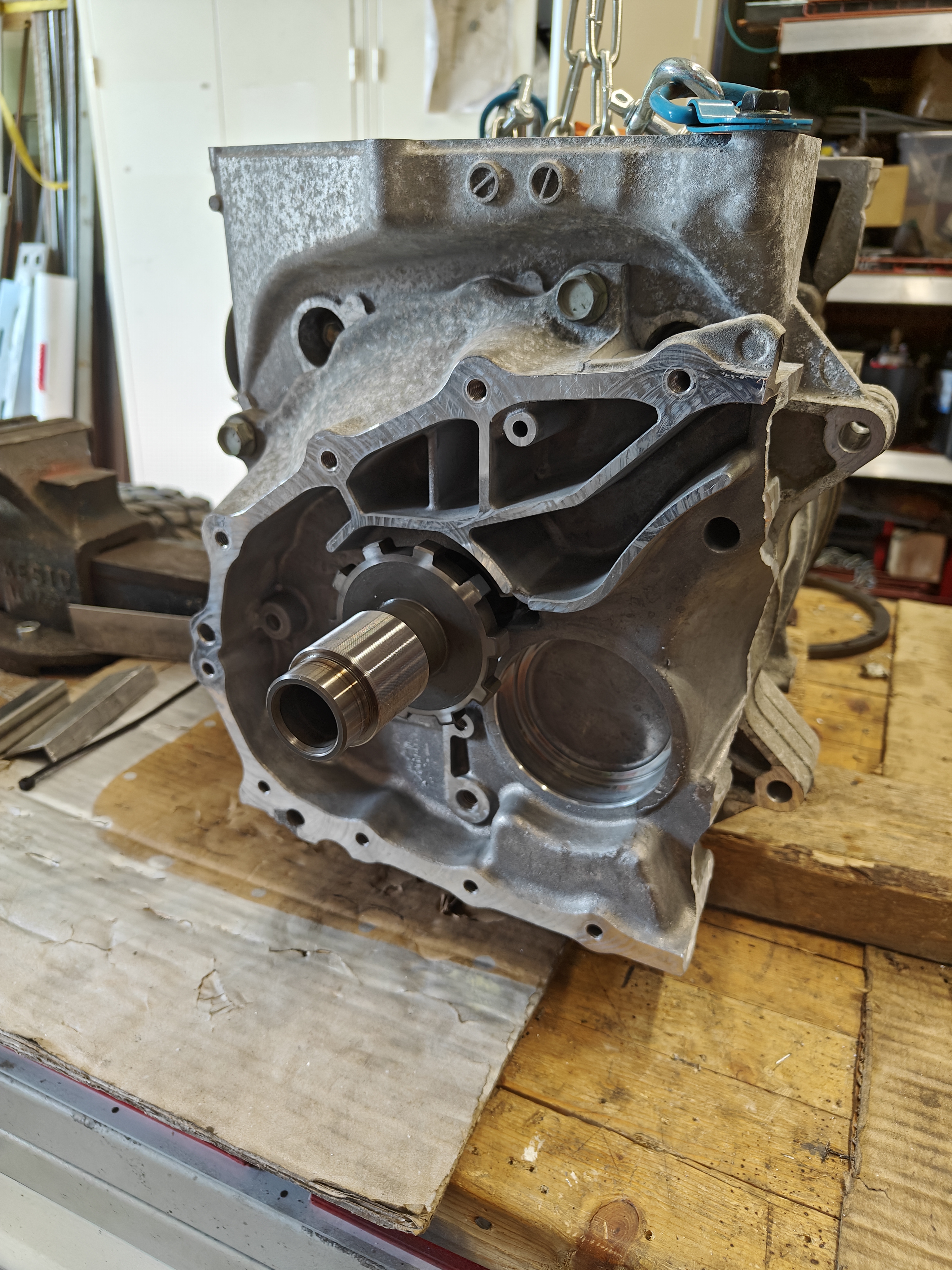

I have seen photos of a couple of Leaf gearboxes torn down and not seen an oil pump. I have seen one with open bearings and another with sealed (clean) bearings. Isak Söderlund of Resolve EV runs the motor in his Porsche 924 backwards, but I will take a second look at the gearbox teardown pictures to see if Nissan is channeling the splash onto gears or bearings. I'm not worried about reverse torque as these regen regularly. We know the thing will run backwards, the only question for me is how long?

J0hannes
Posts: 116
Has thanked: 15 times
Been thanked: 134 times
Re: [WIP] 2003 Dodge Dakota 4x4, Dual Leaf Motors
Post by J0hannes »
Joshie225 wrote: Fri Aug 30, 2024 10:17 pm look at the gearbox teardown pictures to see if Nissan is channeling the splash onto gears or bearings.
Nissan most definitely is doing the splash lubrication magic here.
This is a cut case, but you can see the cavity which collects and sprays oil onto the middle shaft and lubes the first gear pair of the reduction gear set. The other case half also has the cavity feature.
Looking at the image, when output gear rotates counter clockwise and throws the oil to the collection cavity, the middle shaft rotates clockwise and it throws the oil up and left. That's why you have that roof over the input shaft.
Yes, there is a probability that it will be somewhat ok when operated in reverse, but accept that you will have seriously degraded lubrication. Adding an external pump will not help much as the case is designed for oil circulation by gears and attempting to turn that flow is not really a sensible thing to do.

Thank you for the picture and analysis. The differential gear is bathed in oil and should hold/carry enough oil to protect itself and its mate. I do wonder about the first reduction gears, but the fill hole and lubricant level are pretty high and it appears that the large intermediate gear may also be bathed in oil. That gear spins pretty fast so it's hard to know what's going on dynamically, but it may end up slightly starved. Maybe if Isak tears down his gearbox, or pulls the magnetic drain plug, we can see what happens in the real world. Maybe I email to ask.
