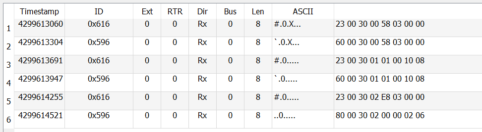

I have managed to break something.

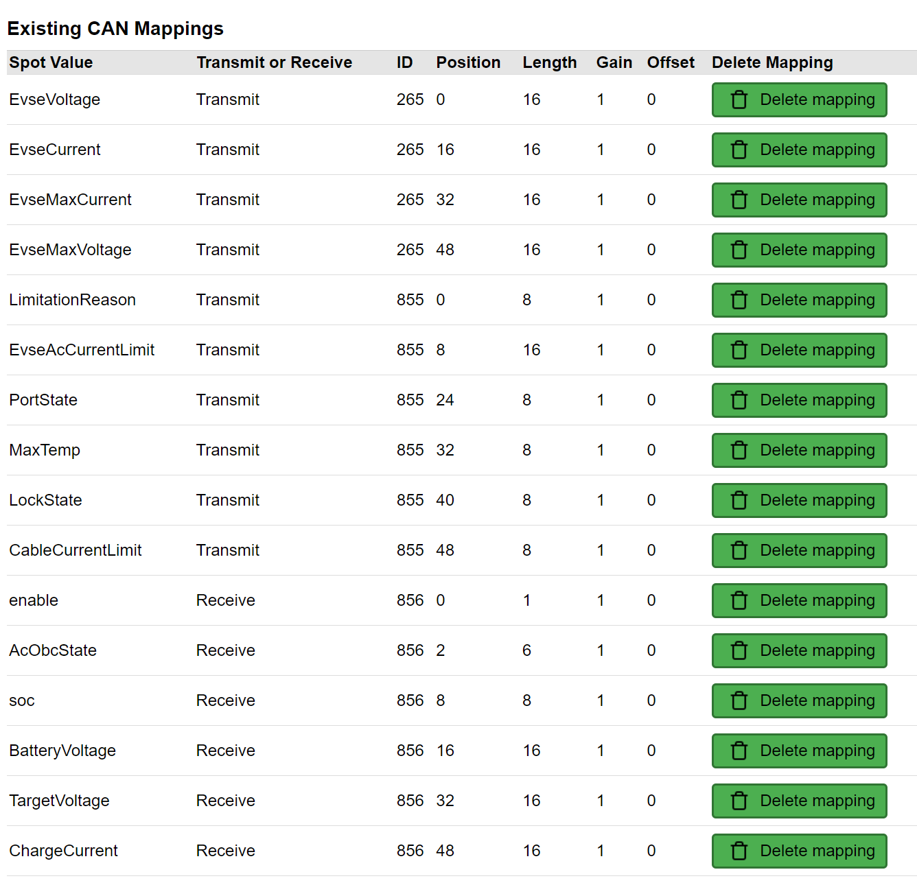

This is with a Focci board, but should not matter as its the underlying library. I am working on writing code to get a CAN mapping written automatically from Zombie to Focci to ensure compatibility. My code was a bit crude as in it could get stuck spamming one frame. Managed to now break it to a point were the CAN subindex 2 is no longer accepted, 0 and 1 are. This is for the Zombie sending it or via the ESP32 interface.
https://openinverter.org/wiki/CAN_communication

Subindex 2 commits the mapping. Maybe you have used up all slots. If you haven't saved to flash just reboot

johu wrote: Tue Jul 30, 2024 4:17 pm Subindex 2 commits the mapping. Maybe you have used up all slots. If you haven't saved to flash just reboot
I have the Zombie run a clean up routine first by emptying the write 0x3100 and read 0x3180 messages, currently no CAN is stored as far as I can tell. As the response from Focci are already 0x80
Rebooting did nothing, same with reflashing the BIN.
Cold boot now, requesting first write ID.

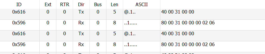

I have seen repeated create/erase cycles of CAN maps to cause the device to get in a state where it reports it has an empty map and will not accept creation of new map entries. Not got a full reproduction yet to raise an issue against libopeninv. Rebooting fixes things though.
You might find my unit tests good documentation of how the protocol should work: https://github.com/davefiddes/openinver ... oi_node.py

davefiddes wrote: Tue Jul 30, 2024 4:43 pm Rebooting fixes things though.
Not in my case, so seems I have taken it one step further.

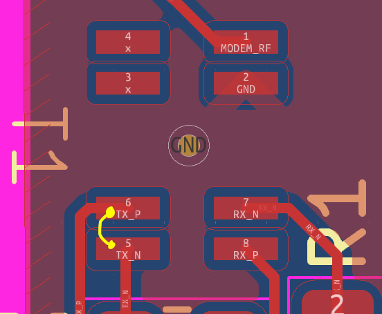

JLCPCB has a small quality issue with the soldering of the RF transformer. On two boards, the transmit path is shortened by a solder bridge below the transformer.
Found this during testing, no communication was possible, but the modem did not go to sleep (LED stays green), this means the modem hears the EVSE, but the Foccci was not able to transmit anything.
Measuring the coil reveals 0.0 ohms, while the coils on good Focccis have ~1.5 ohms. We should keep an eye on this when testing new focccis. Or maybe redesign to use a better solderable transformer?

That's unfortunate, is there solder mask between the pads?
There looks to be a surprising amount of solder in there.
You might be able to shrink the pads down slightly or offset the pads away from each other a tiny bit in the footprint for the next batch.

Yes, a lot of solder, much more than on similar sized other pads. Is it possible that they can selectively control the amount of solder paste? They use very small amount for resistors, but for the big transformer they seem to go the safe way. Hm.
Shrinking the pads is a good idea. And yes, there is solder mask between the pads, this works on the pcb side. The tin tends to bridge on the ferrite side, seems the ferrite "pulls" it.

The solder paste should start on the pads.
I'm not sure how JLC adds the solder, I don't believe they use the solder paste layer info for that. I think they use the pad info and +/- from that.
