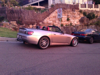

I'm converting a Honda S2000 to EV.
Http://youtube.com/@evs2k
I started this project by buying a Tesla SDU and fitting it to the S2000 subframe.
I then went on a search for batteries and electronics to fill the rest of the gaps. I needed a modular battery so I could custom package it in place of the engine and gearbox. Tesla modules just won't fit.
I purchased two crashed MG ZS EVs, built one good one, and was left with all the parts I needed (or so I thought).
