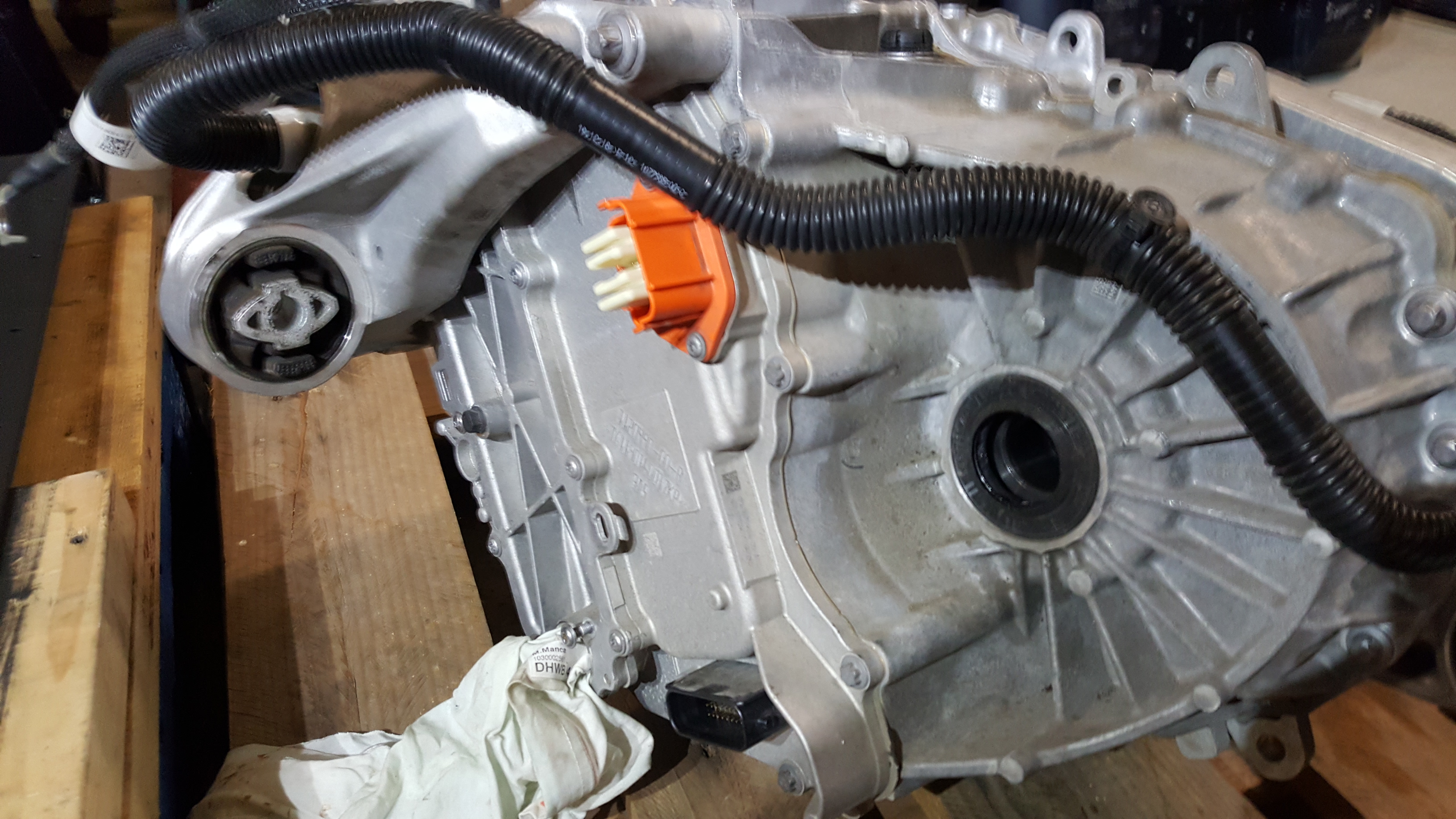

Setting up a thread to document the reverse engineering of the Model 3 rear drive unit. The specimen is from a European 2019 car with just over 20k km on the clock.
Initial observation is the motor exhibits cogging on initial turn but very little while turning via the drive shafts. The plan will be in two parts :
1)Remove inverter and run the motor with a prius inverter so we can learn how to control it with the Openinverter system.
2)Reverse engineering the Tesla inverter to allow use with an open source logic board.

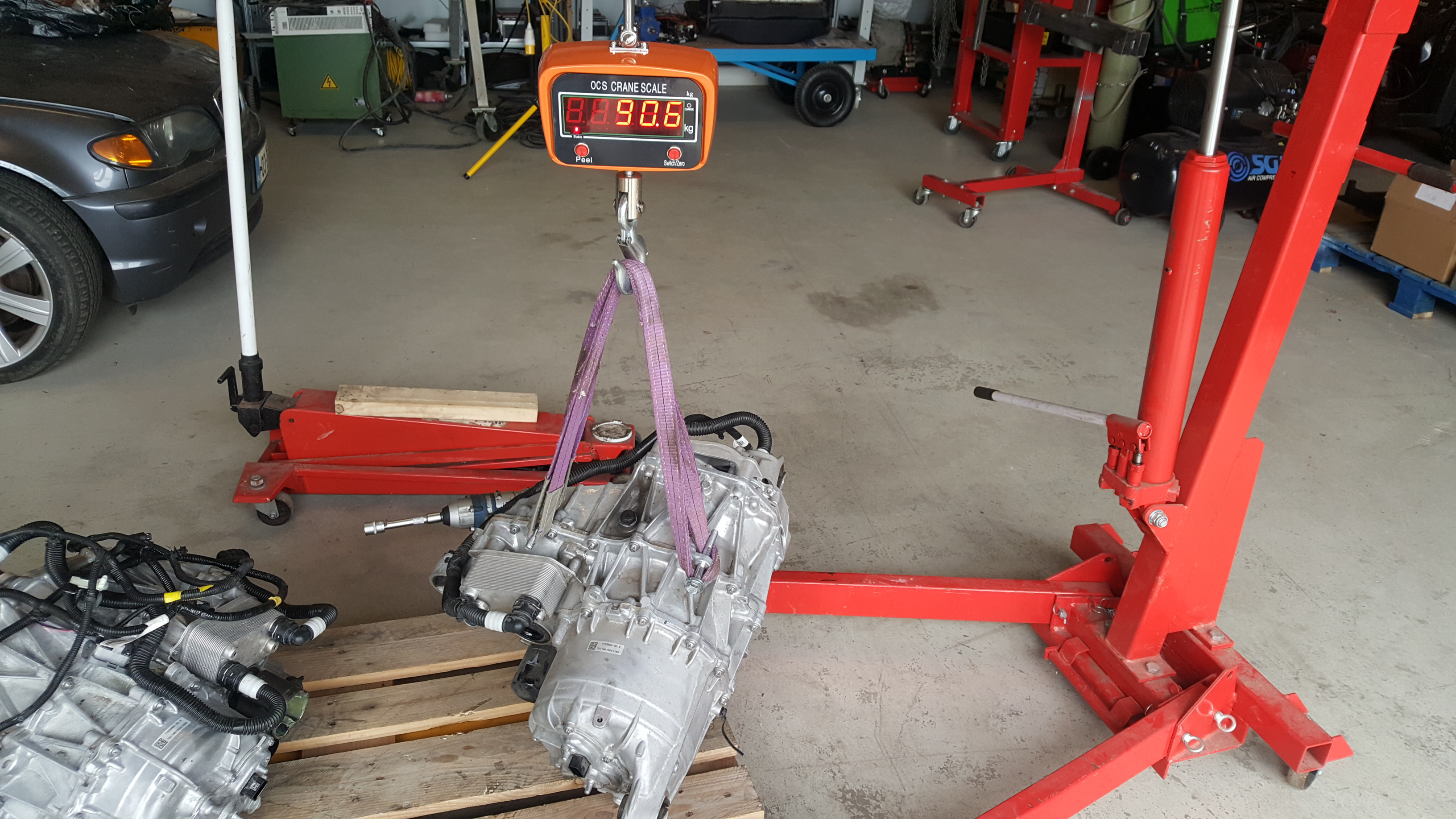

Weigh in for the rear drive unit.

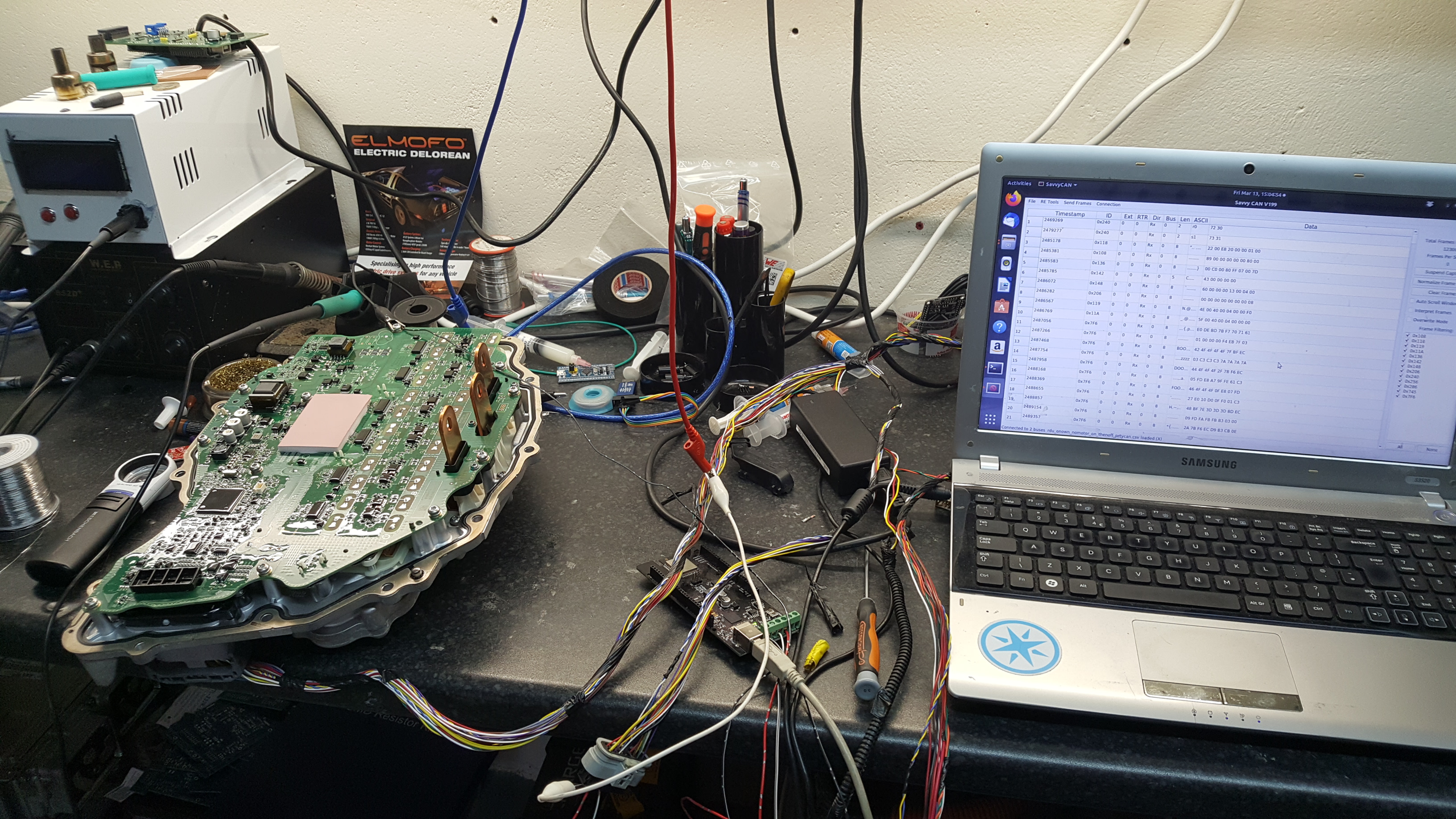

Posts: 4000
Been thanked: 1117 times
So, first power up of the M3 rdu inverter on the bench. Elon flashed some nice coloured leds at me and pumped out massive amounts of CAN on TWO busses. I took a sample for posterity. Up on the github repo for the can hackers :)
https://github.com/damienmaguire/Tesla- ... Drive-Unit
Posts: 4000

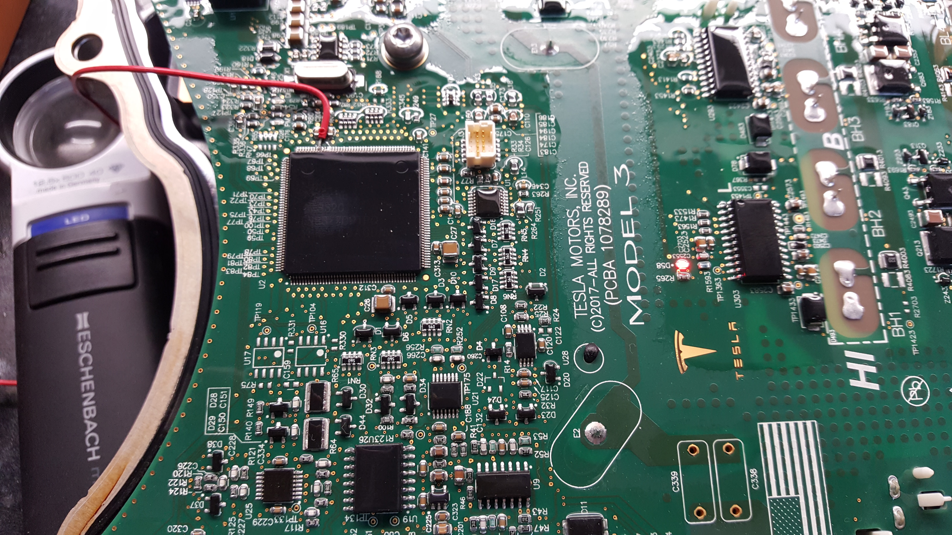

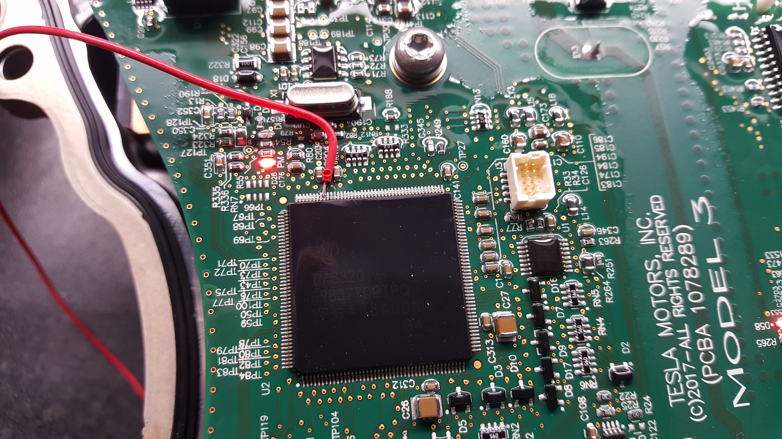

Now we can start the real hacking. Phase one : eliminate the musk, eliminate the problem.
Pin 124 of the TMS main processor is the reset pin called XRS. Pulling that to ground puts Elon asleep and leaves everything else up and running. Easy pickings for the upcoming HubenAtor XM-3000 modchip:)

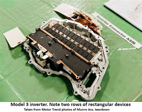

Some useful info in this article;
ABOUT THE SIC MOSFETS MODULES IN TESLA MODEL 3

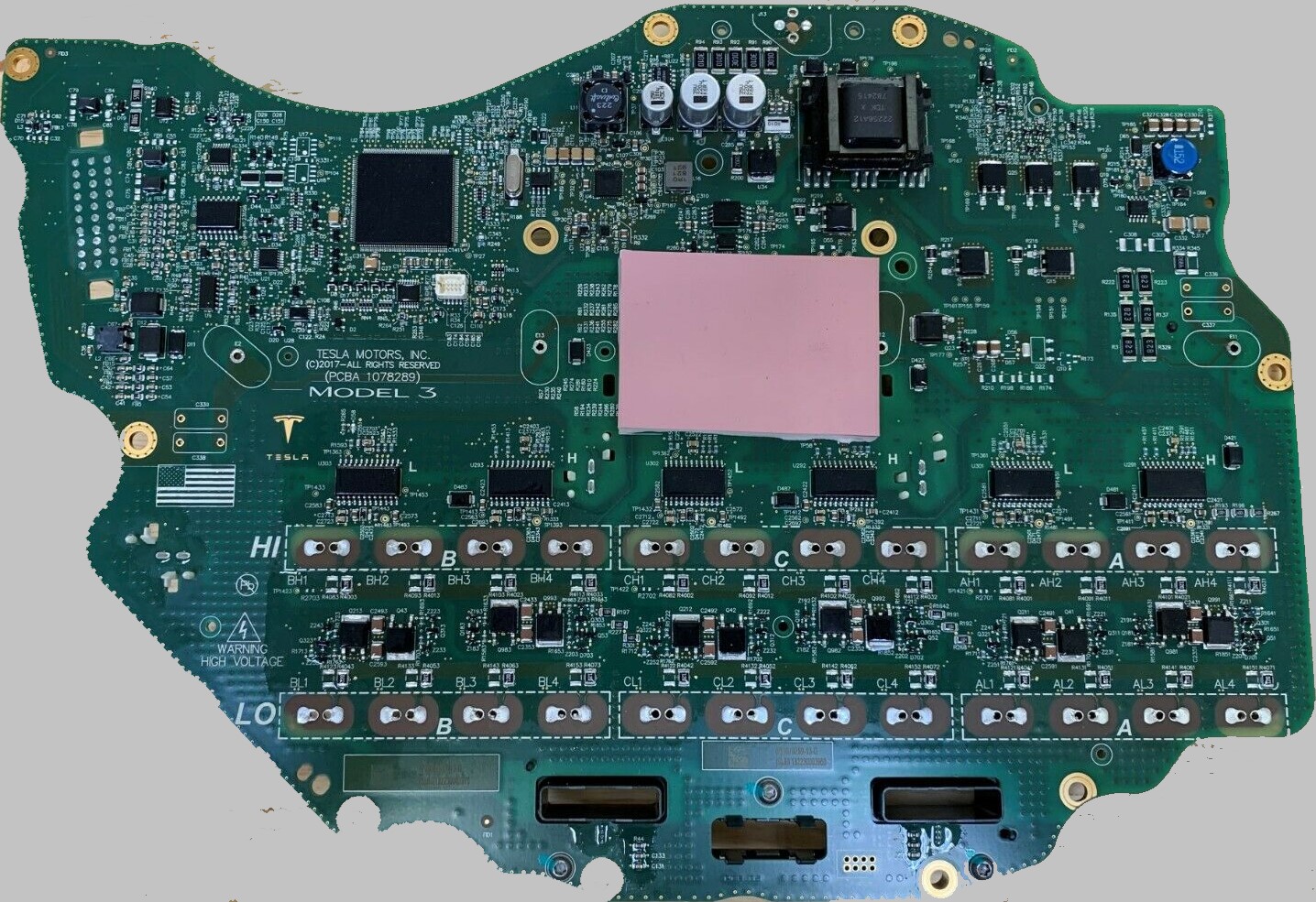

JeanVapeur
Posts: 14
Joined: Sun Mar 01, 2020 12:01 pm
Location: Germany
Post by JeanVapeur »
Thats all I found, possible this can help... ;)

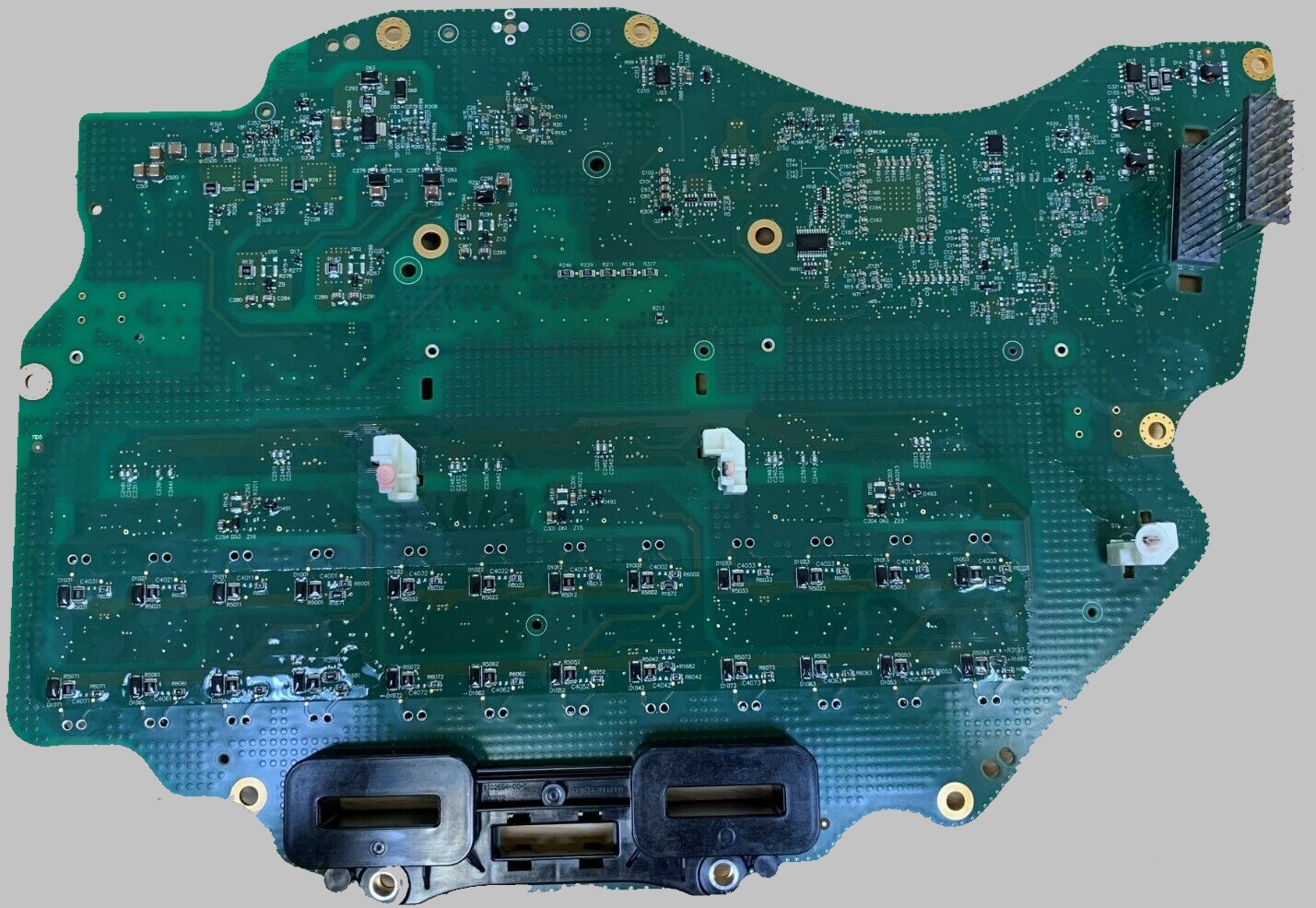

Posts: 4000
Anyone find a high res shot of the rear of the board? I'm getting a feeling old Elon is using bootstrap gate drivers:)
Posts: 4000
Yep. D421,D422and D423. High side bootstrap diodes:)
Posts: 4000
So a little more investigation reveals a Viper16A based power supply section used to generate the low side iso voltages. Not 100% sure as yet but looks to be derived from the hv. Can't say I like this. They're building cars not cheap mobile phone chargers. A multi output dcdc wouldn't have put them out of more than a few $...
