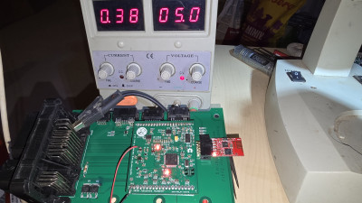

Hi. Repairing Mini v1.1 board. DC buck converter to 5V was fried.
Tested with 5 V afrer it, board and leaf plugin board works, web etc. Drawing 380mA at 5V.

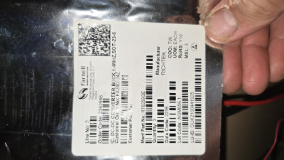

Ordered new RT8259GE DC DC converters. After soldering board works till i rise voltage at 12V input to ~7V. Then RT8259 is damaged. And after it is damaged if i give 5V after it, board works.
Something is not ok with this DCDC converter...
Maybe external rt8259 components are wrong?

Ok issue solved. Mini board had burned path at 12V input pins between gnd and +12v. Was not short but heating up, and somehow dcdc converter was impacted.
Cleaned the pcb itself out of burned textolite.
Now i have 160mA at 12V.

Now i see IC1 on Leaf doughter board is hot up to 80 degrees.
