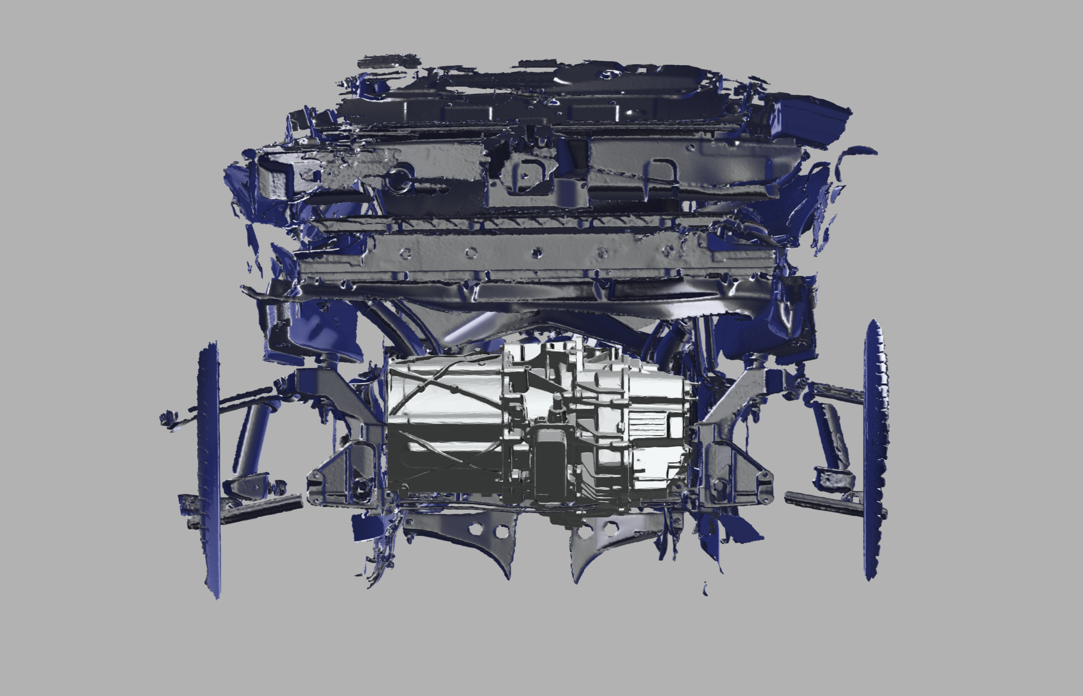

Here are some of our efforts in scanning the underside of the car, and some attempts to fit the model 3 rear motor (in its native orientation).
Long story short it won't fit without a lot of chassis mods, and there are no solutions which enable it to be run in reverse currently, so out of the question.
The Tesla, SDU, by contrast looks like it might fit with little / no mods.
Check out the 3D render...

Re: Tesla-Powered Porsche 911 996

In terms of proximity to the sub frame, yes this fouls on the sub frame mounting points left and right, but it can be raised quite a bit. I took a photo of the underneath to illustrate -- the large coolant lines above the current motor location can be moved / removed, allowing it to be raised and tilted forward. I'm hopeful I'll be able to make it fit with minimal / no sub frame modification.

As promised, the scan of the underside of the 911:

I would say a Tesla RDU wont really work without massive changes to the aluminium subframe members which I would steer clear of. Also massive lack of clearance around it to the subframe even if you remove the mounting points for the rear crossmember.
Possibly a Front Drive Unit will work given it is angled back. I do not have a reliable model to position in the scan. EDIT found one https://grabcad.com/library/tesla-front ... -3d-scan-1

Here is what I taught with a Front Drive Unit, it is tight to the body above the subframe but alot better as you are in a wider subframe section.
You would want to rotate the drive unit down from having the cooler horizontal, till you get clearance.

My fusion skills are very weak, but i've been doing some playing with the models and it looks like it might fit...just...

If you have two mesh files, meshmixer is much faster for just trying to orient them to test fitment.
Fusion struggles with detailed meshes.
Great suggestion on the front drive unit! Seems like it’s pretty feasible.

Ive started mocking up the rear box, containing 12 of the 18 modules. The rear will also house the HVJB and charger, sitting above the battery.
The box will be raised into the car from the bottom, bolting to the cross beams pictured above.

So I've been working on Stephens 911, replacing the smashed window and window motor first of all.
Then on to working on mounting the SDU. I've made a frame that picks up the gearbox mounting point and replaces the cross brace. The plan is to also extend the frame to also extend back to the engine mount points which can then serve to mount some of the battery modules.
