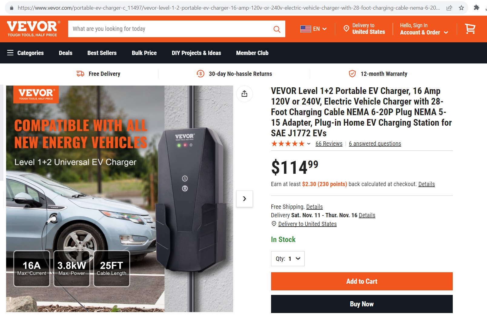

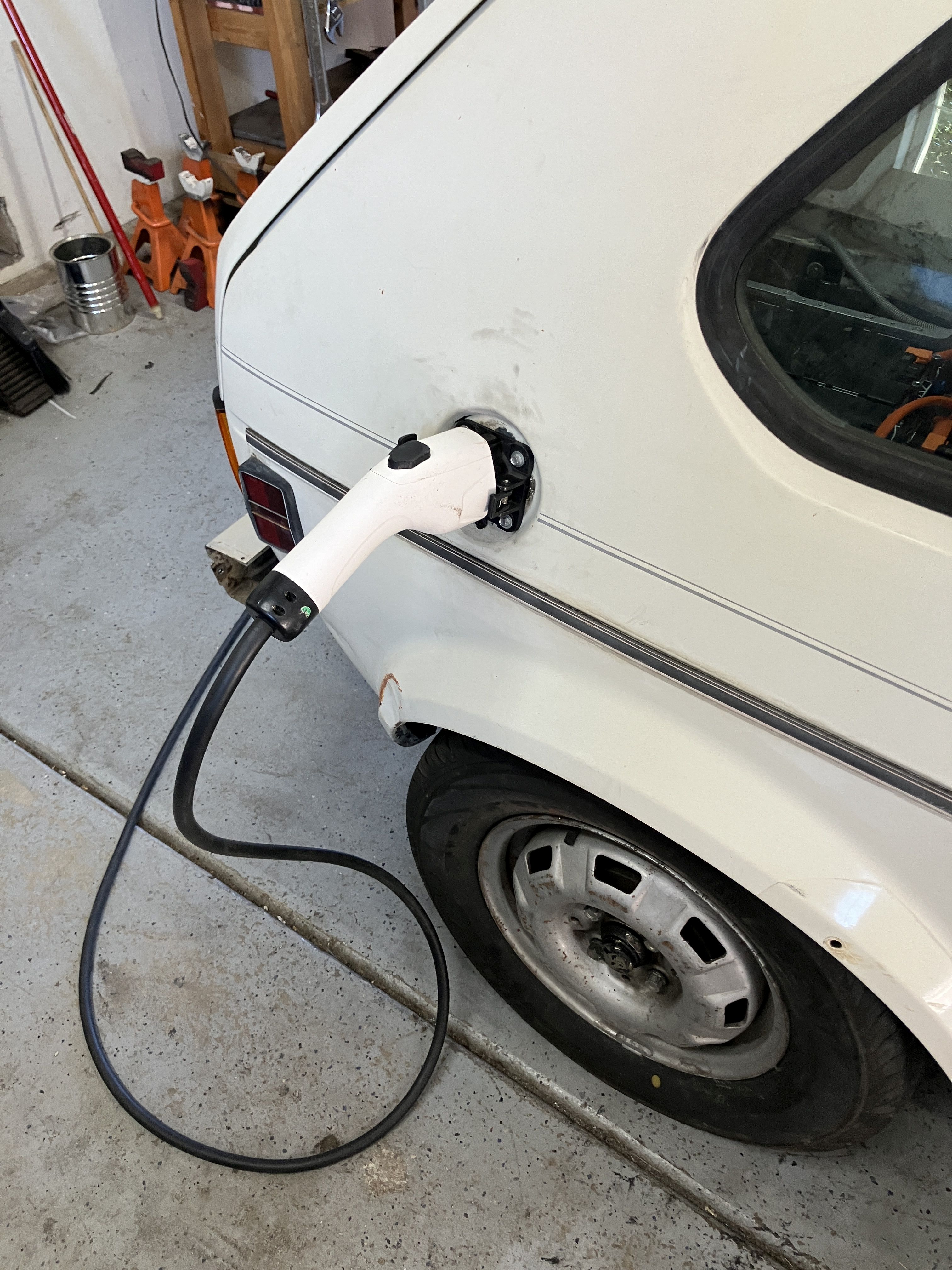

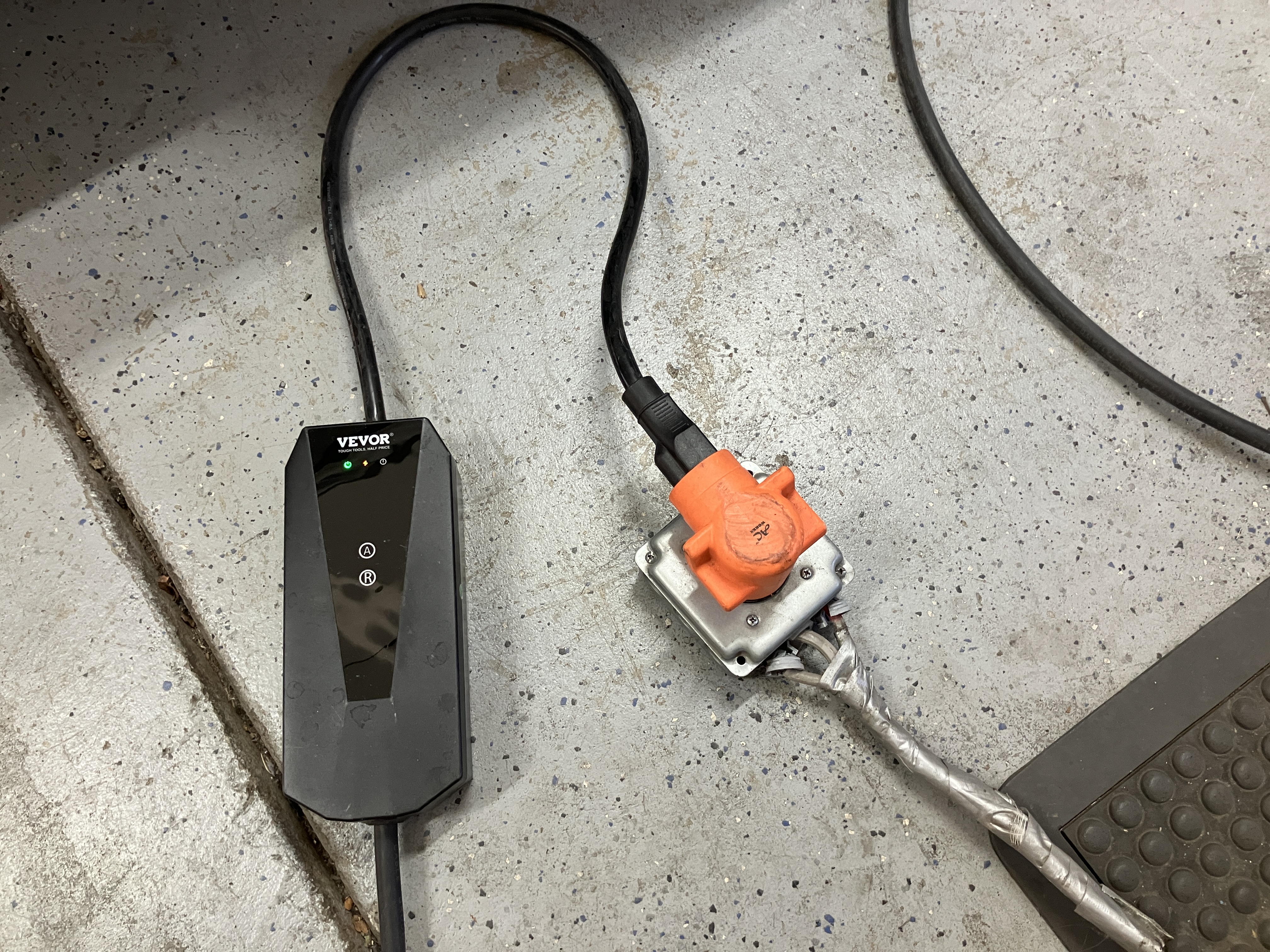

OK, so got the charging workings, yes all by myself, by simply following exactly precisely the steps from the boys on Mr. Damien Maguire's best kept secret Discord Server which you can get access to by supporting him on EVBMW Damien Maguire where you can show your support for him creating Open Source Electric Vehicle Projects!
Super Thanks to the Fellas on the Discord Server I appreciate you too much !!!
The Zombie will go into Charge mode without the Control Pilot signal connected and even without the J1772 hair dryer plug plugged into the charge port, so just be aware of this.
One way to tell if the CAN communication is working is to look for some charger Spot Values such as charger temp and U12V (U=Volts) and I12V (I=amps) which tell you the DC-DC converter part of the charger is charging the regular 12v car battery.
That's Level 2 charging which just means at 240 volts
It don't have to be the Science of Rockets, here I am just using a regular clothes dryer outlet that i added an extension to, and we converted our clothes dryer from electric to gas, so this is always available

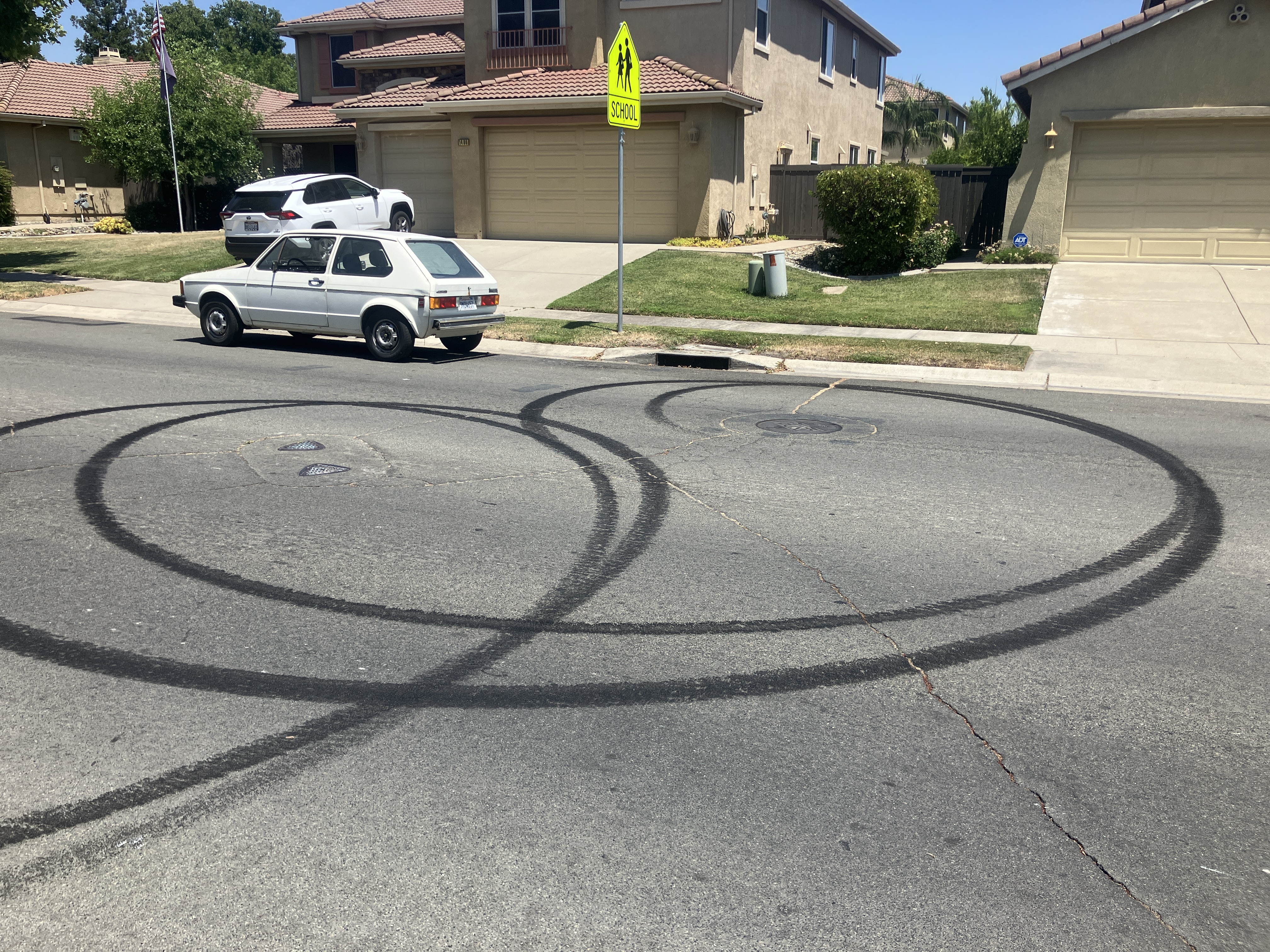

MattsAwesomeStuff wrote: Thu Jul 04, 2024 7:40 pm I'm uncomfortable celebrating by the inches here. What is this, a celebration for ants? We are being trained to underwhelm ourselves.
Let's get this sumbitch rollin' so we celebrate the success all at once!
Do a burnout!

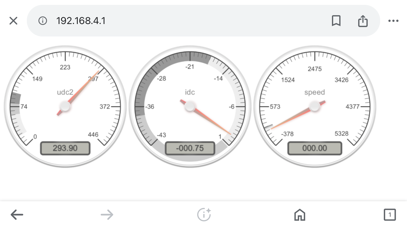

here I am just using my iPhone to show some basic virtual gauges: Volts, Amps, and RPM
I use the battery pack voltage as a fuel gauge for example 327 volts is 90% charged but that's as high as I am willing to go without BMS and I think I can run it down to like 265 maybe
the Amps show me how much current I am drawing
and the Speed gauge shows me the electric motor RPM

Considering the weather there I don't really think it's fair to call that a burnout, as it's just what happens when a half-molten tire sitting in the sun for the afternoon makes contact with asphalt in normal operation.
Congrats on leaving the property and endangering public safety by letting it on the road. It's a real vehicle now!
