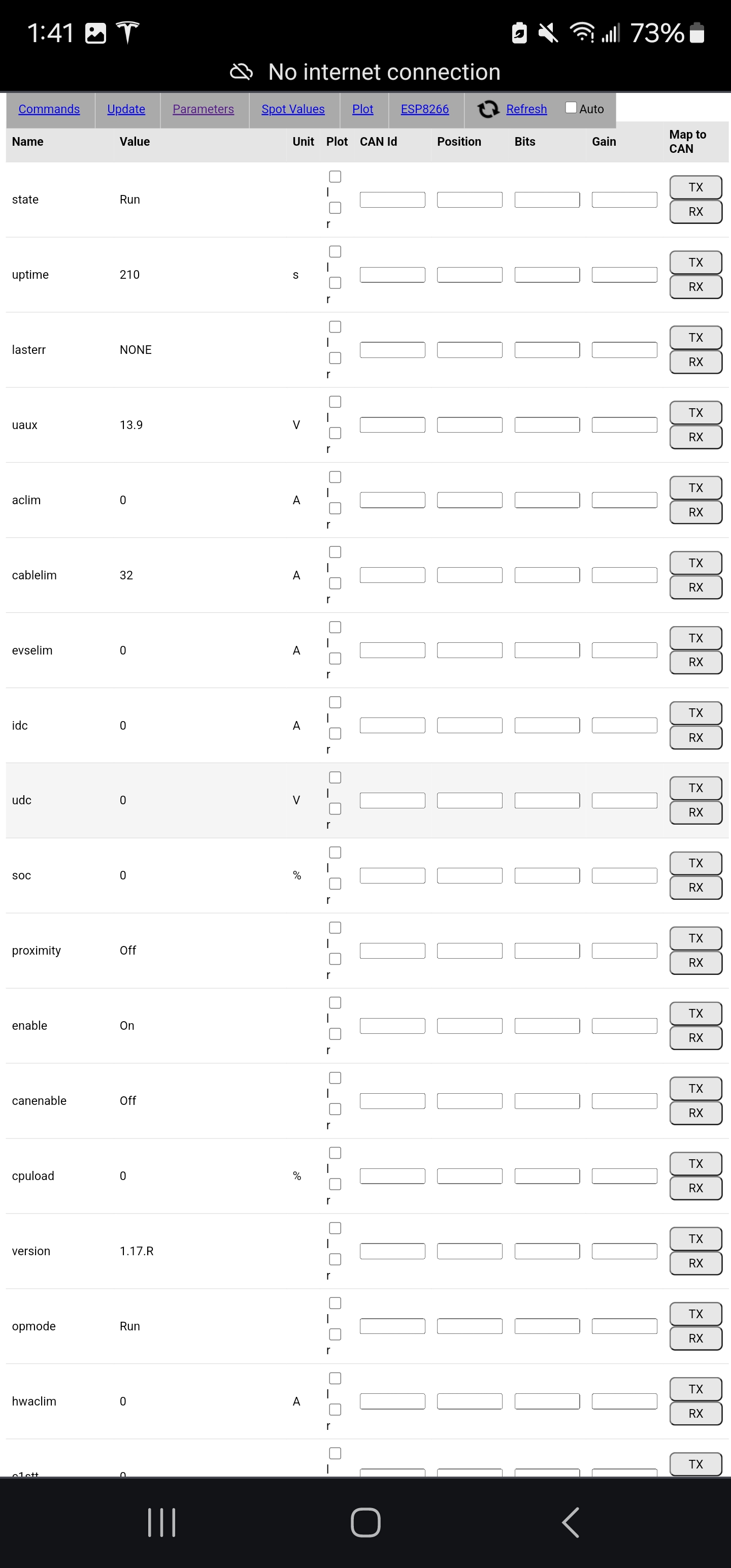

I hear the EVSE click, and even see it flashing indicating it is charging. However, there is no amperage coming out of the Tesla charger.
The tesla charger has red lights on all 3 main boards, and everything else seems to be fine.

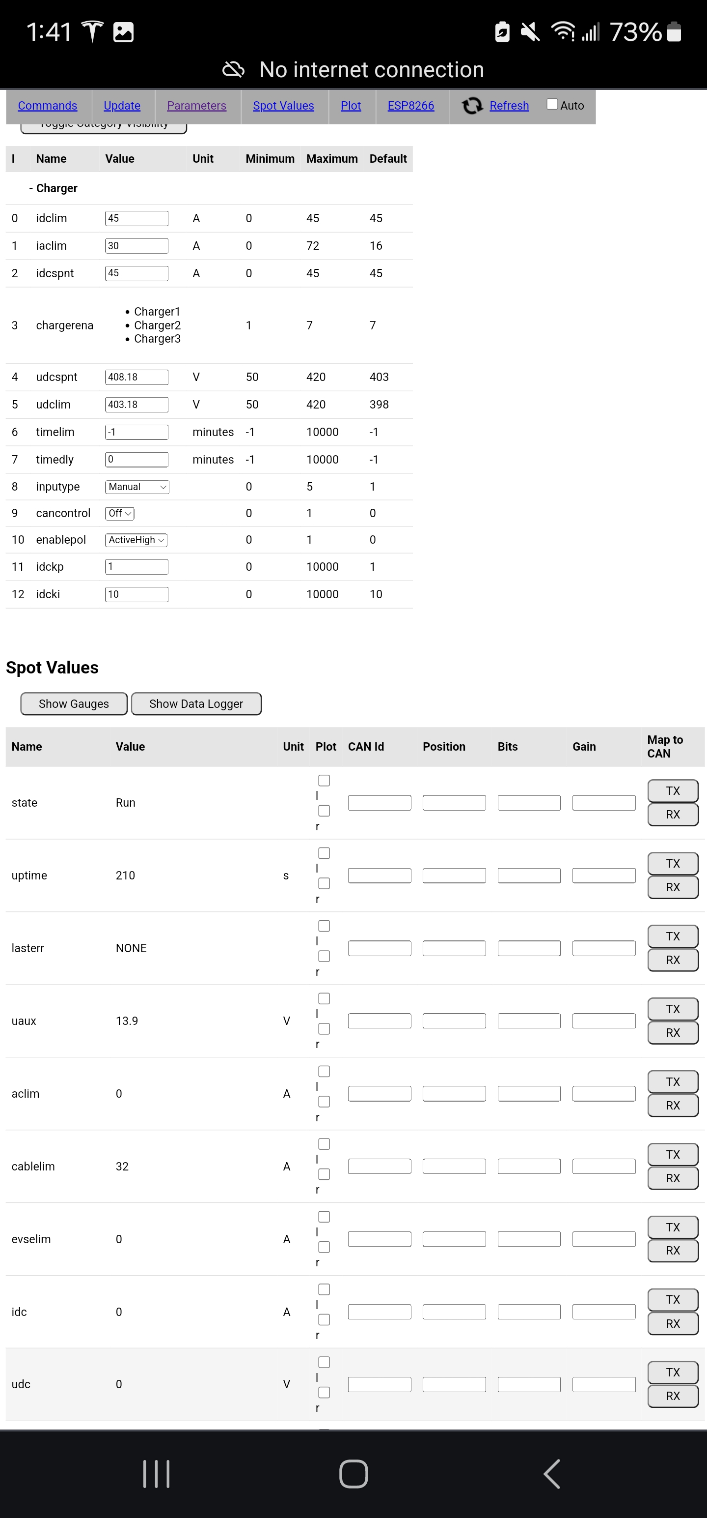

I will upload my parameters as well as spot values while I am attempting to charge.

Maybe you dont connect EVSE PP signal? In general you bring GND to PP signal to activate Gen2 charger. If i remember correctly connecting Enable signals will only light ONE red LED. When you show the charger PP signal it will activate another set of LED and start the process of charging.EVsRock wrote: ↑Mon Jul 01, 2024 10:02 am I have a Gen 2 tesla Charger with the open source board in it. I am using it with a Vero BMS and their j1772 charge controller.

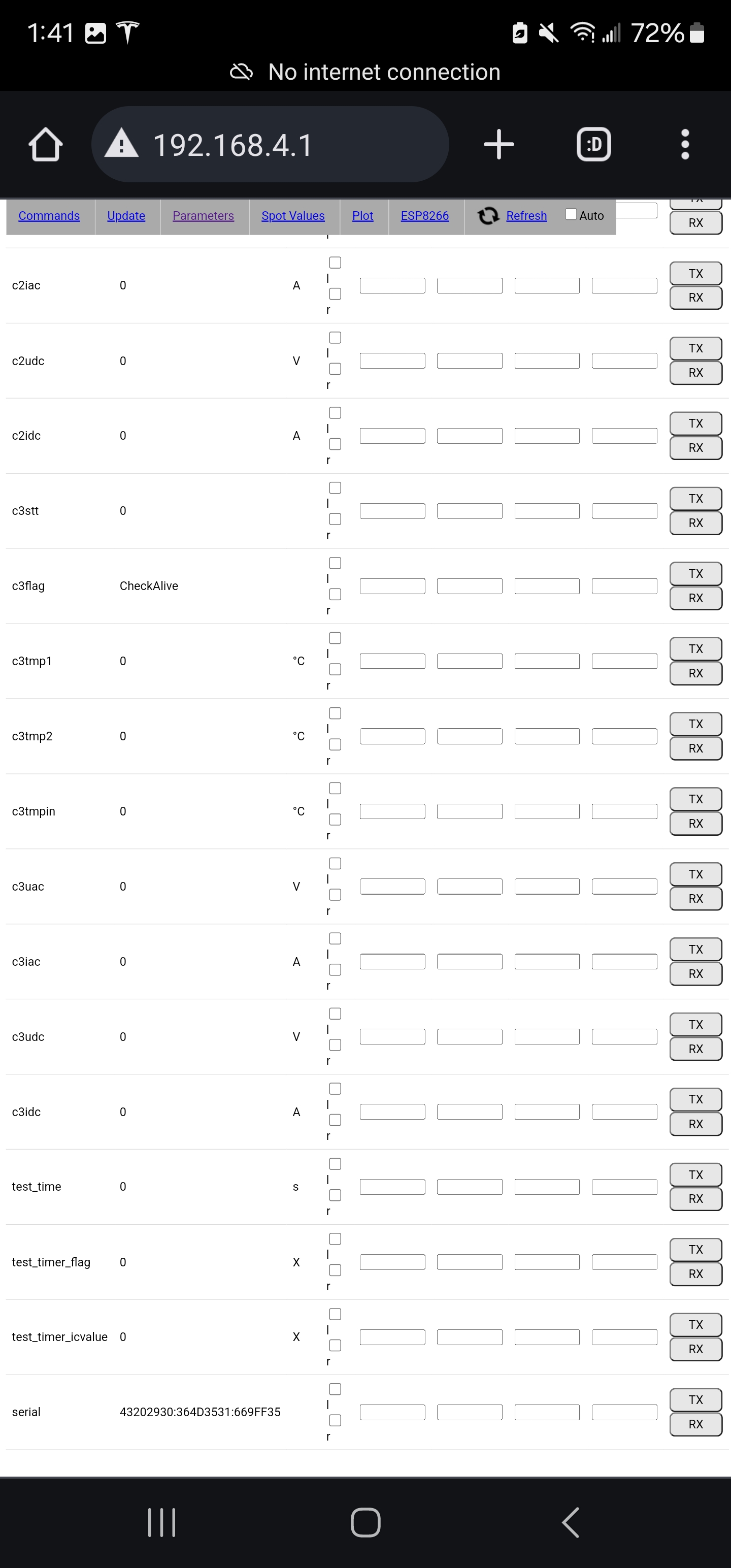

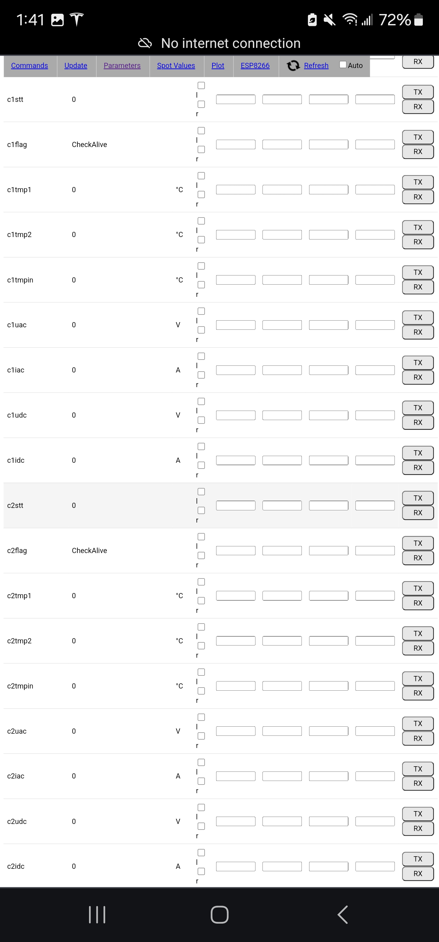

None of your info for the phase modules populate also there seems to be no HV connected to the charger. Please also not HV to the charger and the AC voltage being applied must happen at nearly the same time, within a few seconds or the charger may not work.

Currently, I am using a simp charge to handle the j1772 communication. So the CP and PP pins on the tesla charger are not connected to anything. Do I understand correctly that I should connect the PP line to ground? My Simp bms and Simp charge should handle the current limits with the EVSE.

You are assuming a lot.EVsRock wrote: ↑Mon Jul 01, 2024 5:42 pm ......
See the wiring here https://openinverter.org/wiki/Tesla_Mod ... N2_Charger
Notice input pins
B1 - 12V power
B7 - GND
B5 - Cp pin - about 25% PWM signal from12V to show 16A request from EVSE you can use 9V signal too
B11 - Proximity (PP) - to GND when active
D1 - Enable - to 12V when active
I never tried to control charger via CAN...

I also suspect a CAN termination issue or bus short circuit as the control board receives absolutely no data from any if the three charge modules. Even if the battery is connected correctly you wouldn't see it because... No data
