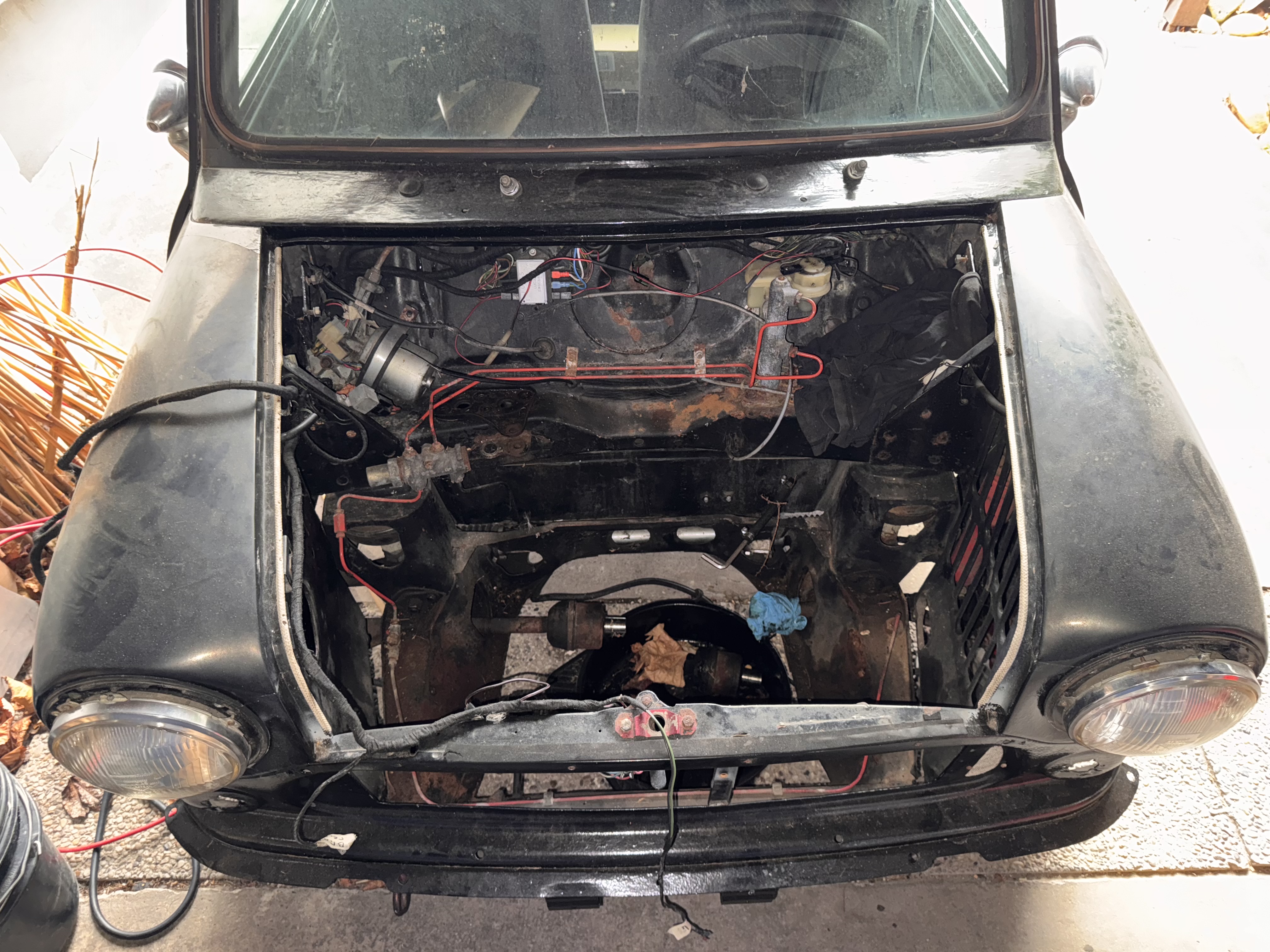

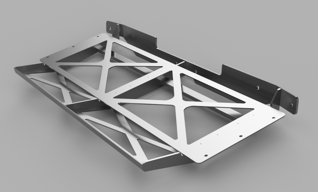

Small project update:
Plans changed a bit, as the engine was more shot than I thought...
Pulled the engine after redoing the wire harnes and disassembled it. Engine is rebuildable, but not worth it in my opinion, as I would need a Oldtimer licensplate here in Germany to run it in bigger cities, but due to the fact that paint is not in a good condition and a missing interior, I don´t see the work to be put in there atm. Also registering it as an Ev gives me some more freedoms like LED headlights etc.

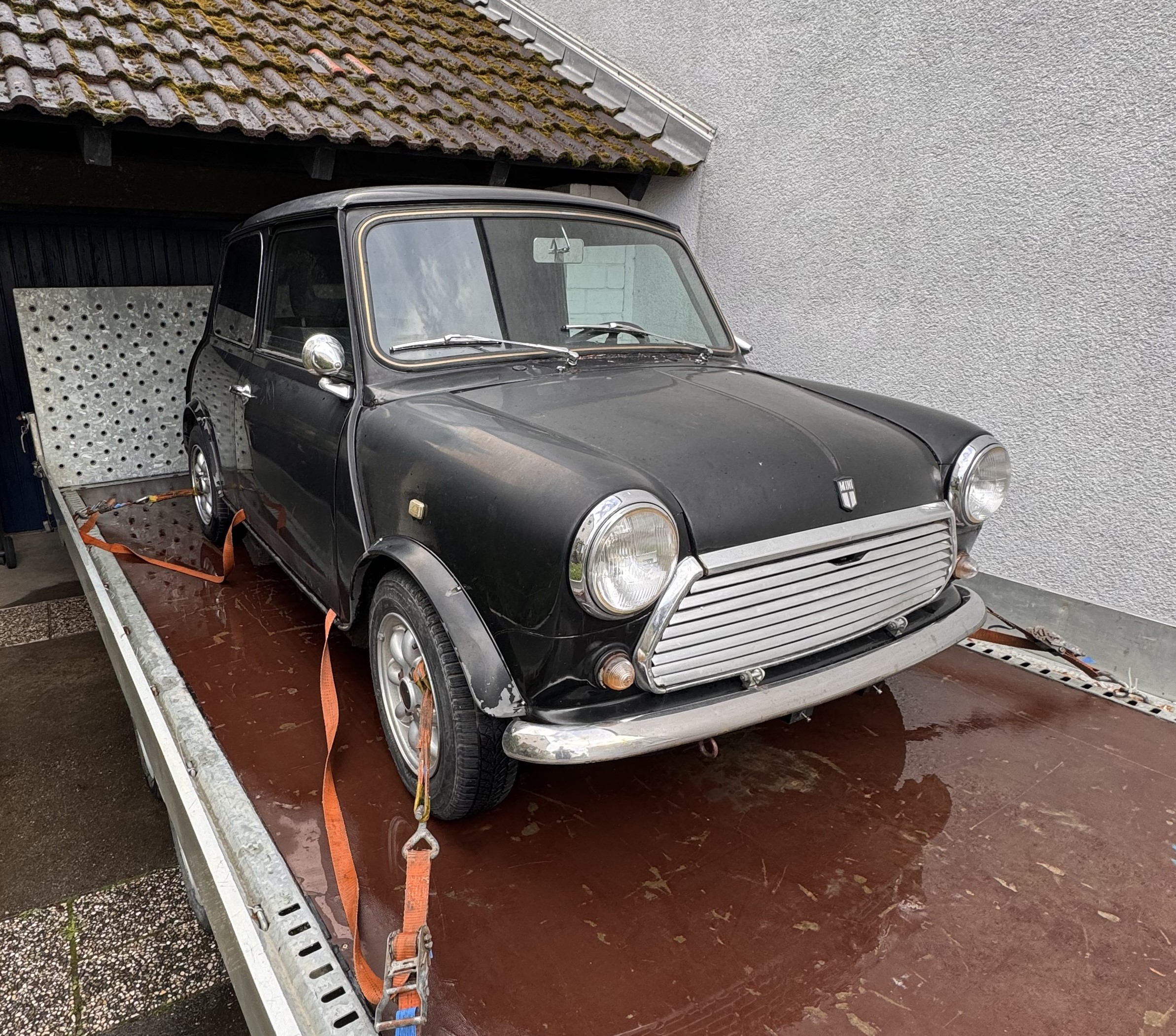

Arrival picture:
We all know the rule: never buy a rust bucket...
Pics look way worse than it is, mainly surface rust. Subframes will be pulled anyway, to be painted properly and to rebuild all bushings and brakes.
So whats the plan?
After a little more research I decided to go with the BMW 12 kWh pack, mounted to a 10mm Aluminium plate. The casing is designed to adapt to a cooling plate later on, if needed.
Rest of the build is going to be Outlander parts with a Zombieverter VCU. Motor, Inverter and OBC/DCDC are all going to be mounted in the engine bay, to have a proper weight distribution, as the battery will be on the rear seats.

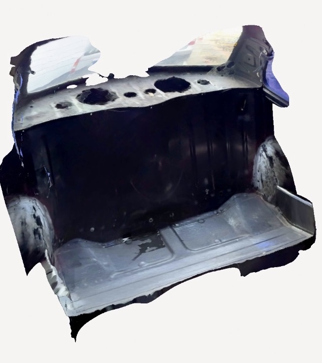

So I startet to do some CAD work after scanning the rear seats with my phone:
Scan is kind of useable, but mounting points are not visible in the raw scan and quality/ accuracy is horrible...

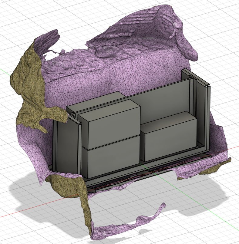

To desgin the mounting points I did some oldschool CAD with some templates I made in the car. I hope it will fit properly, as the seating frame is not the straightest piece in the car :roll:
Rough placement of the components:

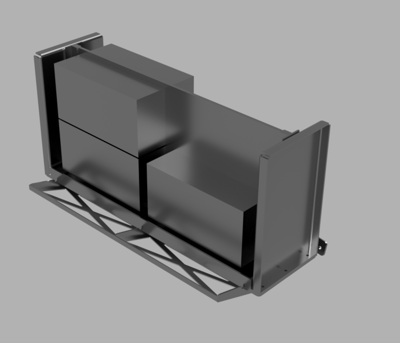

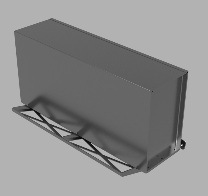

New frame for the battery on the rear seats. Will be attached at the lower harness mounting points:
Frame with the battery box:
On the empty spot the BMW S-box and an isolation monitoring device (needed in Germany) will be placed. Vent and HV/ LV connections will be on the right side.
If my TÜV guy wants another mounting point I can use the upper points of the harness attachements.
Does somebody have a scan of the BMW Modules and S-Box, or at least the dimensions of the S-Box? I would appreciate that information :)
Next steps are going to be the desging of the front frame to mount Motor, Inverter and OBC/ DCDC.
Scanned the front as well, but accuracy is a catastrophy :?
