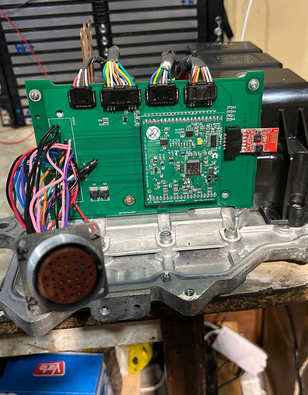

Hi all. I bought your board, connected it and the motor spins in the opposite direction. I checked all connections 3 times and they are correct. Please help me with the setup.
The motor rotates in the opposite direction regardless of whether the mode is forward or reverse.
Sorry for the bad text. I am writing through Google Translator.
Motor Nissan EM57 2017 8700300056
Inverter Nissan Gen2
Firmware Version 5.14R-foc
My parameters

photo of my board

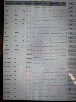

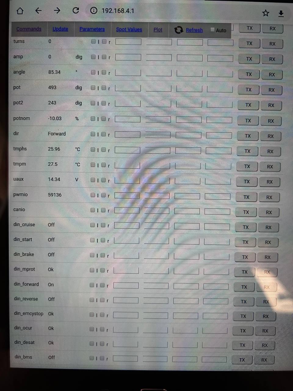

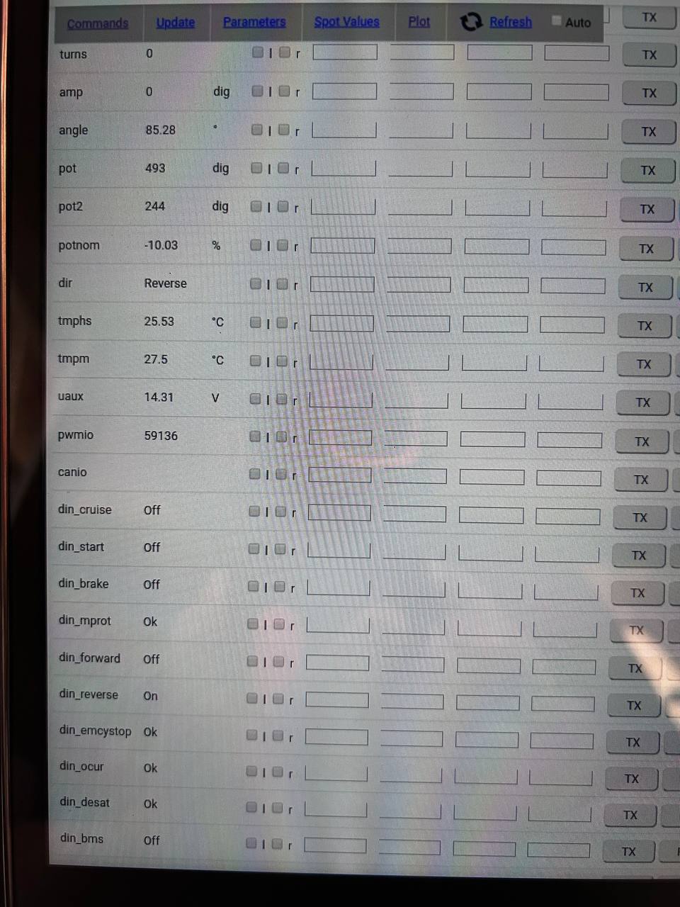

Re: The motor turns in the opposite direction
In the description of the parameters and spot values https://openinverter.org/wiki/Parameters
we find "dir", with the explanation Rotation direction. -1=REV, 0=Neutral, 1=FWD
This could help, to split the search range into two two smaller search ranges. There are two possibilies:
(C): The dir follows your direction switch. This means, the switch is correctly configured, but the software does not consider dir for the motor actuation.
(D) The dir always shows the same direction. This means, your direction switch is not correctly evaluated.
Which case do you see?

When you switch the 3-position toggle switch, the parameters change.
