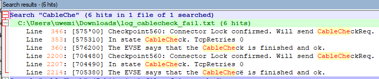

In the log I see the cable check is successfully passed:
[705380] The EVSE says that the CableChecë is finished and ok.
[705380] Will send PreChargeReq
and in the PreCharge the voltages are not fitting, that's why it does not finish:
[708380] PreCharge aknowledge received.
PreCharge aknowledge received. Inlet 0V, accu 20V, uMin 150V
[708390] Difference too big. Continuing PreCharge.

Re: First-Time Config of FOCCI And CCS1 vehicle charging
There is confusion. You are saying the cable check fails, and in the related log it is successful.
How do I get to this conclusion? Using Notepad++, there is in the search window (Crtl F) the button "find all in current document". Searching for "CableCh" reveals the conclusion.Github: http://github.com/uhi22 --- Patreon: https://www.patreon.com/uhi22

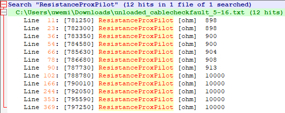

I do not think the issue is physical connectivity. I ran some more unloaded tests (values under 500v to negate any din/iso issues), and the PPresistance values were reading nominally until I initiated the charging sequence. I tried this with two separate chargers with the same result.
I tried messing with PPvariant and when it was set to 0, PP resistance was reading ~2800 during the charger fault. Again failing cable check. Could this be a configuration issue? I'm beginning to suspect that a problem occurred with FOCCCI at some point during testing.
I've attached logs from the latest test below.
- unloaded_cablecheckfault_5-16.txt
- (35.47 KiB) Downloaded 284 times
It does not help to try random things. The goal is to find the root cause, why the PP resistance is not 150 ohm. This is a simple resistance measurement, where not much can go wrong. Theres a certain chance, that fixing this issue could also fix the failed cablecheck.
To find the issue with the PP resistance, I'd propose to do some additional measurements. Because, we have your 150 ohms (measured with your multimeter) and on the other hand this, measured by Foccci: This could mean, that the Foccci in general is measuring wrong, or that something between Foccci and the CCS plug is wrong. To find this out, I propose to connect a 150 ohm (or what ever) directly to Foccci, between PP and ground. This should (if you configure the correct PP variant) lead to the correct value in the web interface. If not, search inside Foccci. If yes, search in the harness.
You could also do a voltage measurement, to find out where is the issue. Foccci has a pull-up of 330 ohm to 5V. If you have 150 ohms PP resistor in the plug, the two resistors form a voltage divider between 5V and ground. The divided voltage is around 1.5V. You could take a multimeter, and measure the following positions:
1. PP to ground directly at the Foccci board. Expected: 1.5V. Measured: ....
2. PP to PE at your CCS inlet. Expected: 1.5V. Measured: .....
3. PP to PE inside your charger (there where the empty PP wire hangs around). Expected: 1.5V. Measured: .....
If the Foccci says that the resistor is much higher, you will measure much more that 1.5V directly at Foccci, and the position where the voltage is lower will guide you to the point where the connection is bad.
