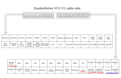

I am testing Zombieverter VCU and I am having problems with VCU not switching into the Run mode. I currently have only Ignition on connected on Pin 15 Forward and reverse on Pins 53 and 54 and start on pin 52. I can see that all abovementioned buttons are registered as dinstart and dinforward etc. I have tried changing udcmin to a diffrent values but this did not make any difference. It seems as one of the conditions for it to go into a run mode is not met. Has anyone experienced this issue and what else could I check in my settings? I attached my parameters file.

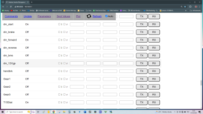

Thank you for a quick response Tom I only have Zombieverter with power hooked up and buttons I mentioned. Nothing else is connected. I also tried connecting Prius Throttle and this is working correctly as well. I can see throttle response accordingly to me operating the pedal.
I did try BMW E31 just now with the same result. I did see the classic option was working in Gregski video where he has only start button and ignition connected and VCU was going into run mode. I should also mention that if I select Reverse or Forward with the switch and use auto refresh the dir value is switching constantly between Neutral and Forward or Reverse whatever is selected with the switch.

Re: Zombie not going into Run mode
Permanent 12V
T15/Igniton 12V/active
Start signal 12V/actve
No throttle Errors, so resting Pot is over potmin. Also Pot is not pressed
No UDC errors, so udclim not triggered and udcsw has been passed or reached
Ofcourse you can also fail precharge, but you are not measuring udc. You must be missing an error repoting.
Do not keep refreshing the params. Provide 12V to VCU permanent then 12V to ignition - nothing else. The briefly provide 12V to start.
Then refresh you spot values. What do you see for first few?
I have just tried this - no change on refresh. I pressed show errors and it displayed a message no errors. Opmode still remains off. I have to add that this board was made by JLC PCB and I added a CAN chip and few transistors myself. But all buttons reading correctly if I look at dinStart and T15 ignition come up as On permanent for ignition and momentary switch when I keep start pressed. I wonder if some issue on the board causing this?

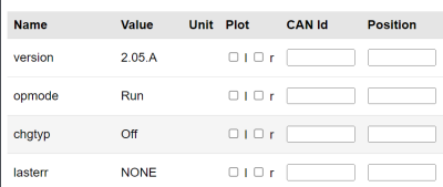

I have found a screen recording when I did testing And can confirm that status was set as below
and throttle reading when not pressed as below
Could this be the reason for not going into the run mode?
Yes, as already explained in at least three posts above. You are not meeting two of the three conditions that must be met to go into run mode, as indicated by "status". Set udcsw to 0 and potmin to 500 ( i.e. >491 ) and it should work.
Sorry royhen99 you were absolutely right the issue was because I had potmin set to 300. And of course as I had throttle connected it was reading around 500. I set potmin to 600 and it went straight into the Run mode. I had udcsw set to 0 previously so this was not a problem.
