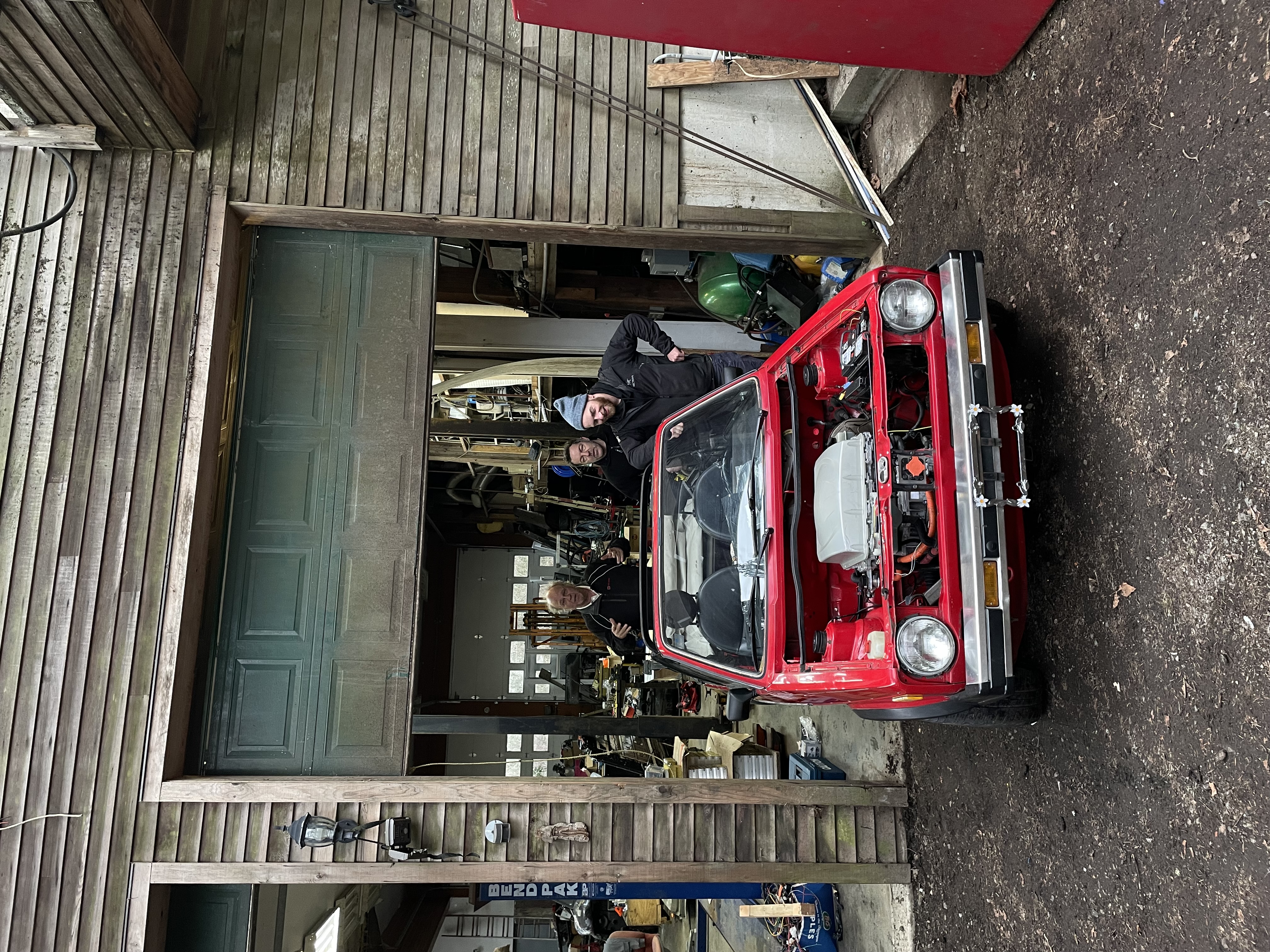

The guys are stoked! We burnt some rubber today
There’s no noticeable torque steer, takes off like a rocket, steering is nice and light. Needs stiffer springs In the rear as it dose run, we put lowering springs in the front.
Pretty much no power in reverse, it’s un usable.
I’ll have to do a savvy can dump and see if there’s any missing messages ?
