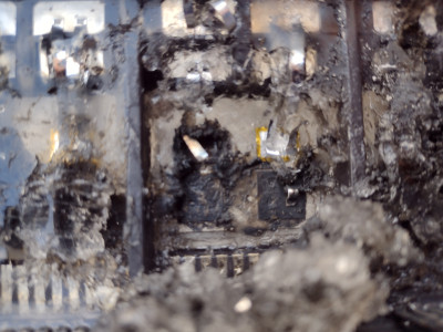

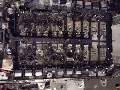

I had a pair of contactors, Tesla ones, one welded one didn't.
The unwelded one appeared to measure fine when closed but under load it was higher resistance. So replaced both now.
So on to the cool photos of the inverter igbts
Cars back to running great again.
