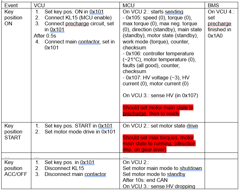

That didn't work so far, sadly, and I assume it's about the start sequence. Does anyone have an idea how MCU start sequences typically look like? I had the MCU CAN matrix checked at least four times for every signal read by the MCU also being sent somewhere on the bus. It is attached below. Also below, I marked in red the steps where the MCU does not react as I hoped.

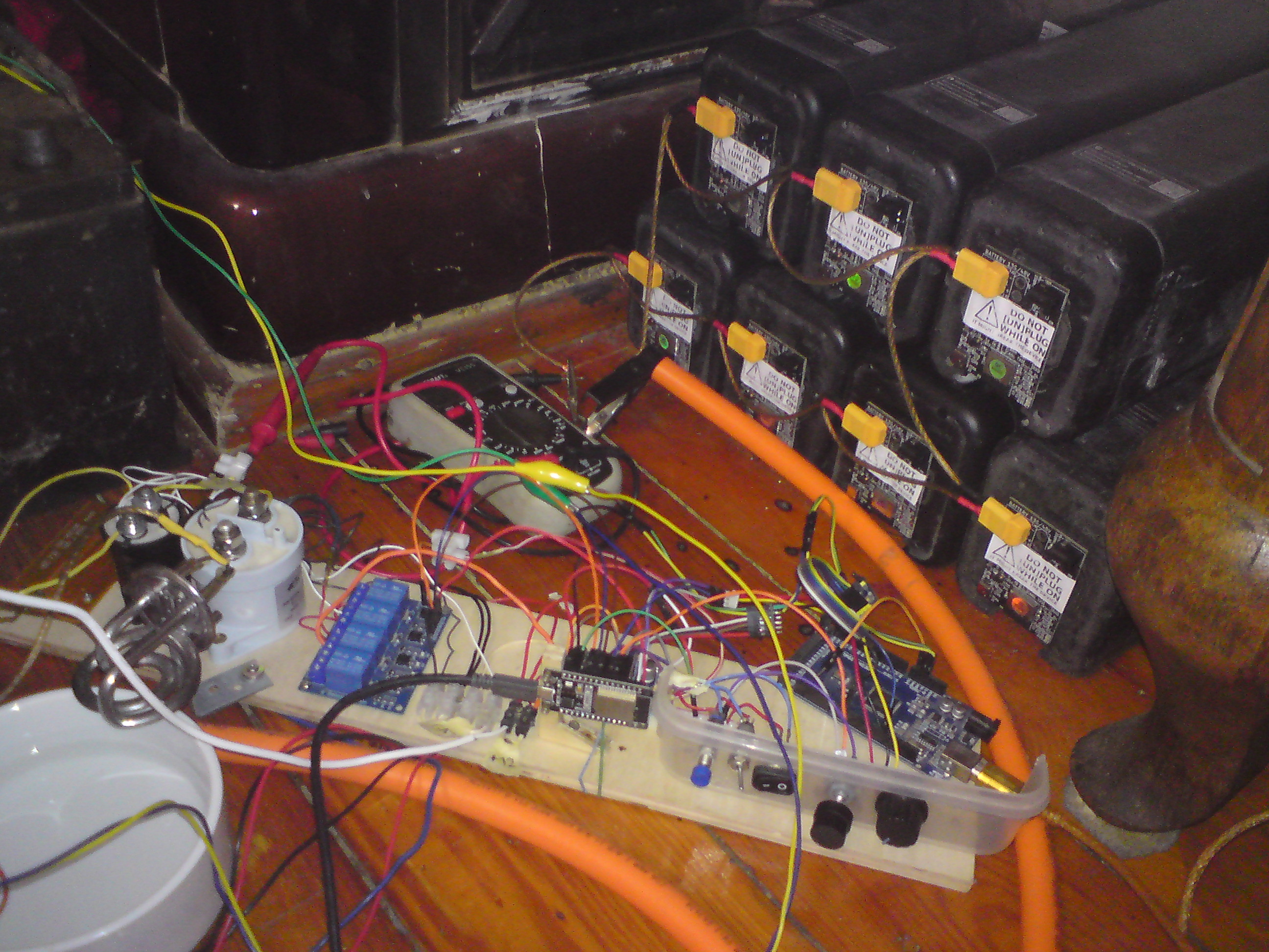

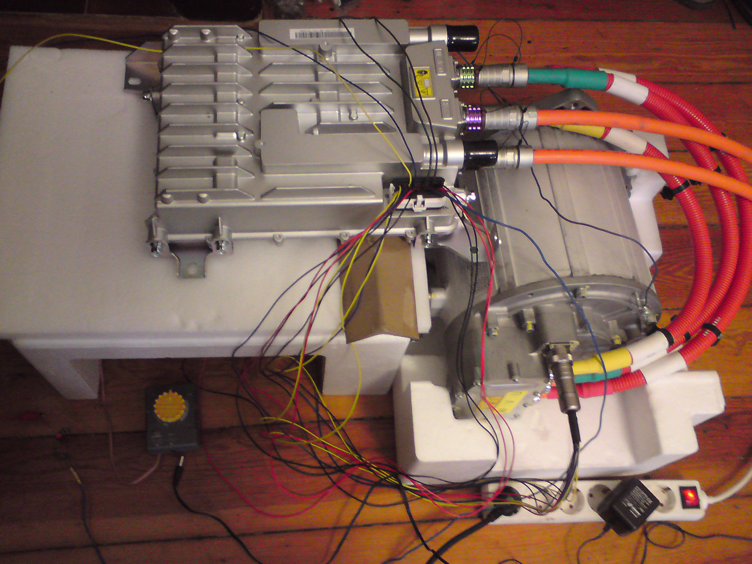

Here is my test bench setup:
Devices:
  • VCU: ESP32 with CAN capabilities and all the logic
  • MCU: APEV528 motor controller, CAN matrix attached
  • BMS: emulated by Arduino with CAN board
  • ICU: hand brake tightened/released CAN message sent by BMS emulator
  • Observer: RasPie with CAN board
Setup:
  • Battery bank provides ~350V without “own will”
  • HV connection fused with 10A and with old heater element at HV+
  • Contactor and precharge circuit connect HV to MCU, controlled by VCU
  • All devices are connected to the CAN bus at 500kbps, same GND, terminated at MCU and observer
  • Observer runs a program to translate CAN messages into signal names and values
  • VCU reacts to key position (ACC, ON, START), gear lever (only P and D), throttle, brake
  • HV interlock line in and out at MCU is connected directly
On power-up (key position ACC):
  • VCU starts sending 0x101: throttle (0), brake (0), gear lever (P), work mode (torque), motor mode (standby), key position (ACC), connectors (open), status signals (all good), counter, checksum
  • BMS starts sending 0x1A0: precharge not finished; no error; rest zeros
  • ICU starts sending 0x431: park brake released; rest zeros
Event sequence:
MCU CAN matrix
APEV528 CAN MsgList_V3_Excerpt.xlsx
(358.57 KiB) Downloaded 118 times
I'm happy about any idea or hint. Sometimes it's the small things that matter (and sometimes I miss the obvious).
Thanks in advance!

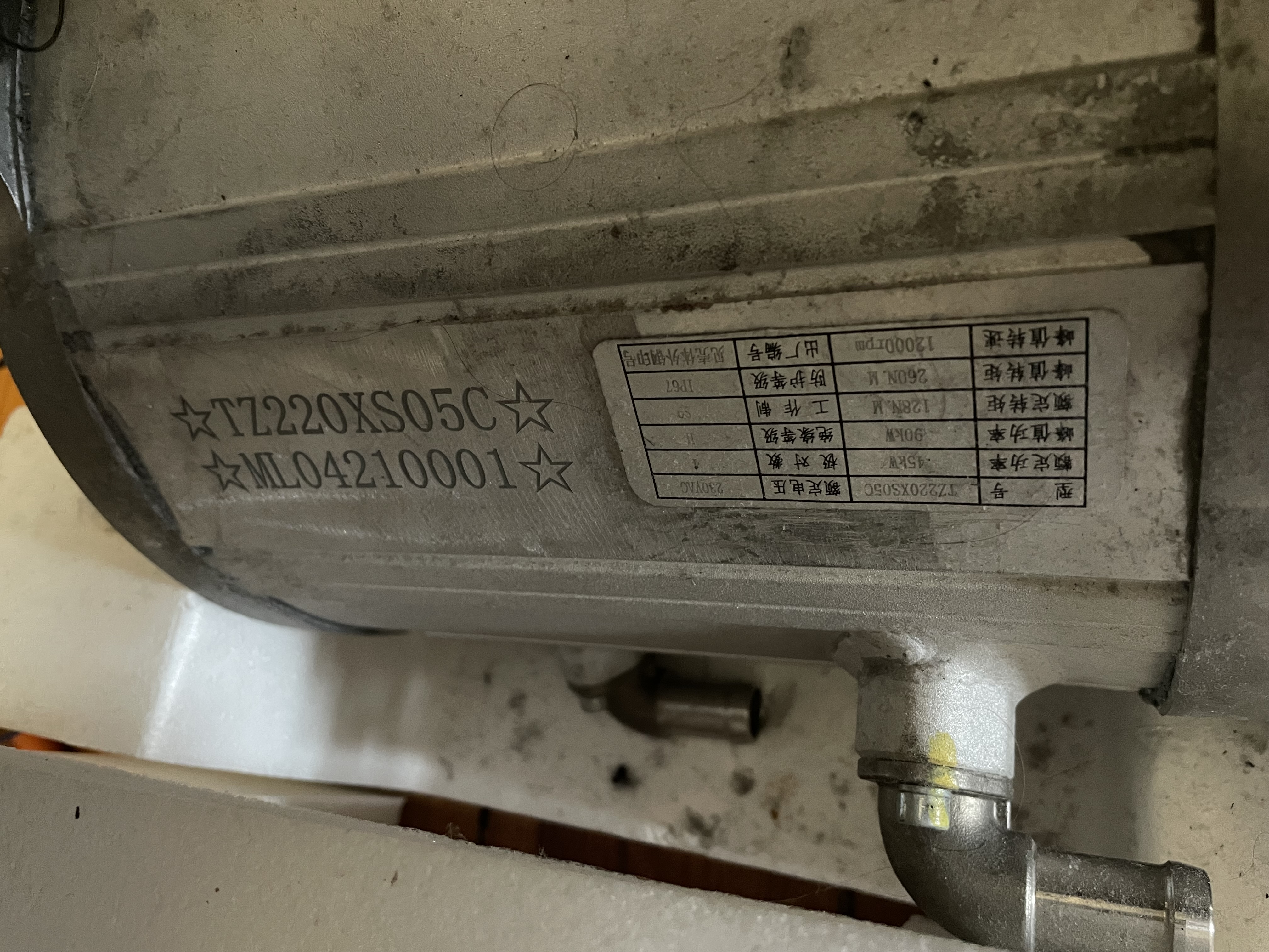

Do you have photo of motor and inverter data plate so i can see if i can get any more info?
marlinarnz
Posts: 11
Joined: Fri Dec 29, 2023 9:50 pm
Has thanked: 8 times
Re: Start sequence for OEM motor
Post by marlinarnz »
Thanks, your help is much appreciated!

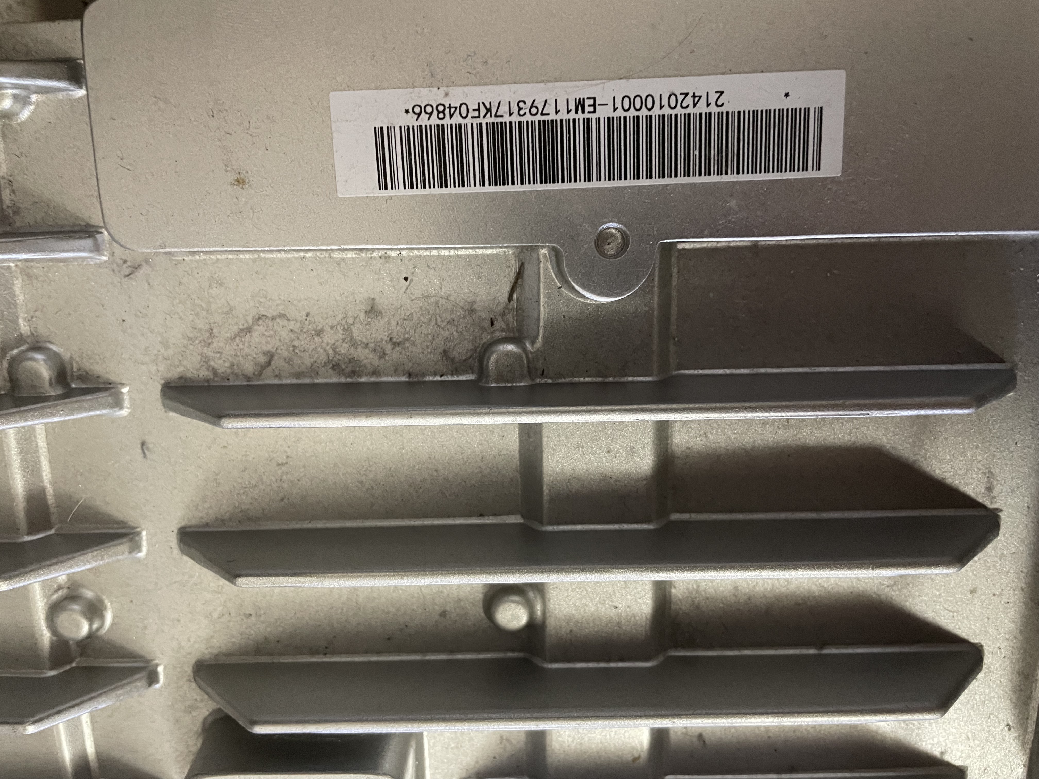

This is the motor data plate:
And the inverter:
Both have been manufactured by a small Chinese distributer, called Zhejiang Alpha Electrics, which doesn't exist anymore. The motor is labelled with "KCEC" on its back (hidden by three phase cables), but the fault diagnosis list I received for the inverter implies that the inverter had been programmed by Valeo for GAC (as attached). The motor and inverter model is called "APEV528. I also have a "manual" for the inverter, but it's so useless that I won't waste server capacity uploading it here.
