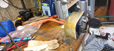

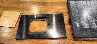

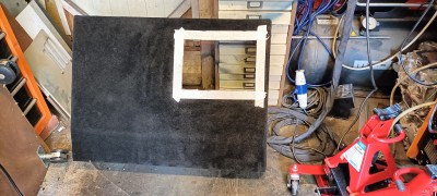

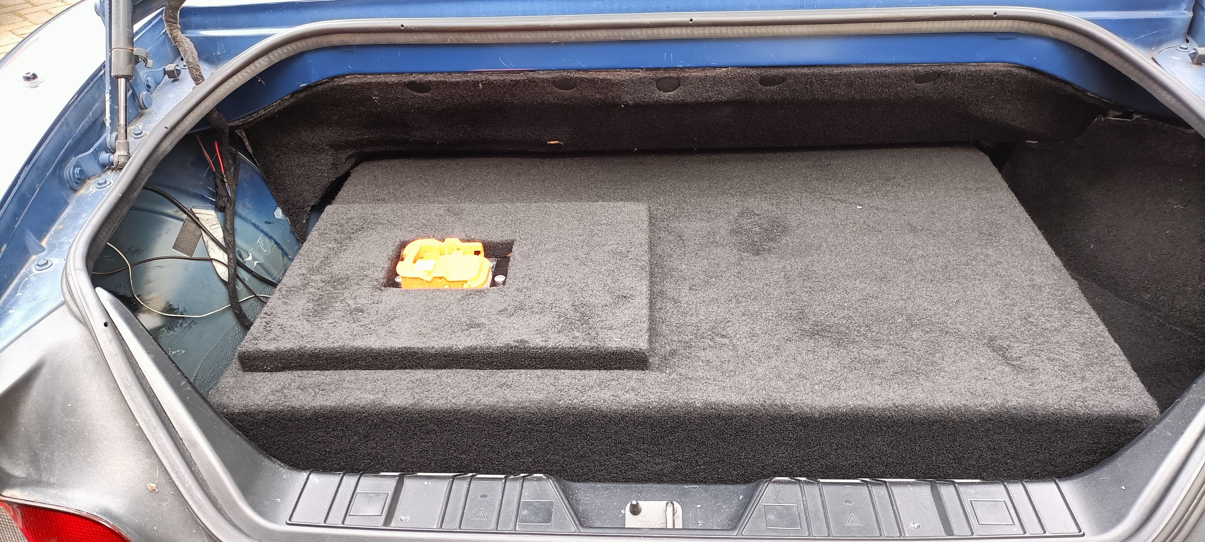

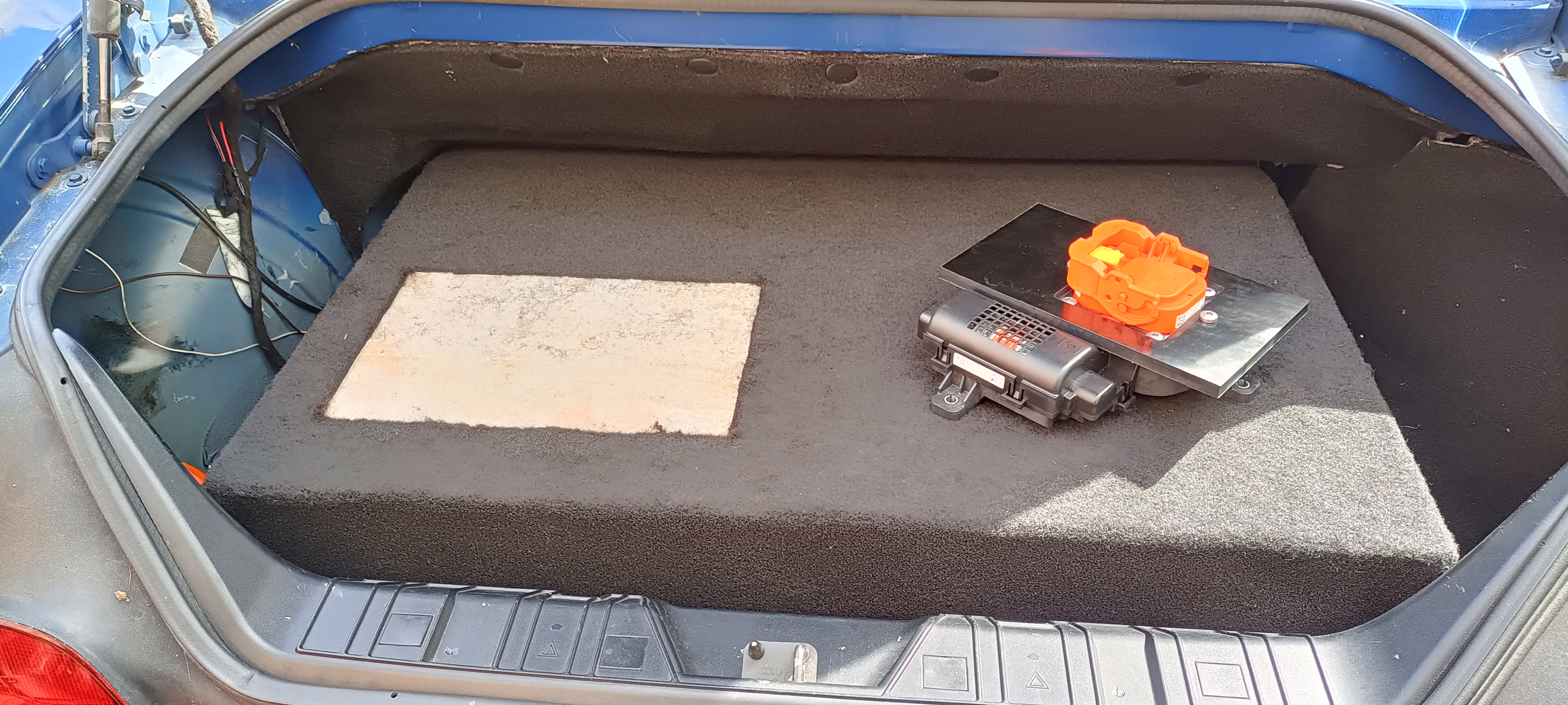

While I'm waiting for the next software update I've been getting on with the jobs I've put off, today it was the rear battery box safety disconnect
I have already made an adapter to allow me to mount the KIA Niro disconnect flush as the fuse was higher than the mounting face
there wasn't enough clearance above the modules so I had to create a raised section in the box
And then retrim around the new section
It's not actually connected yet but that's an easy job for tomorrow

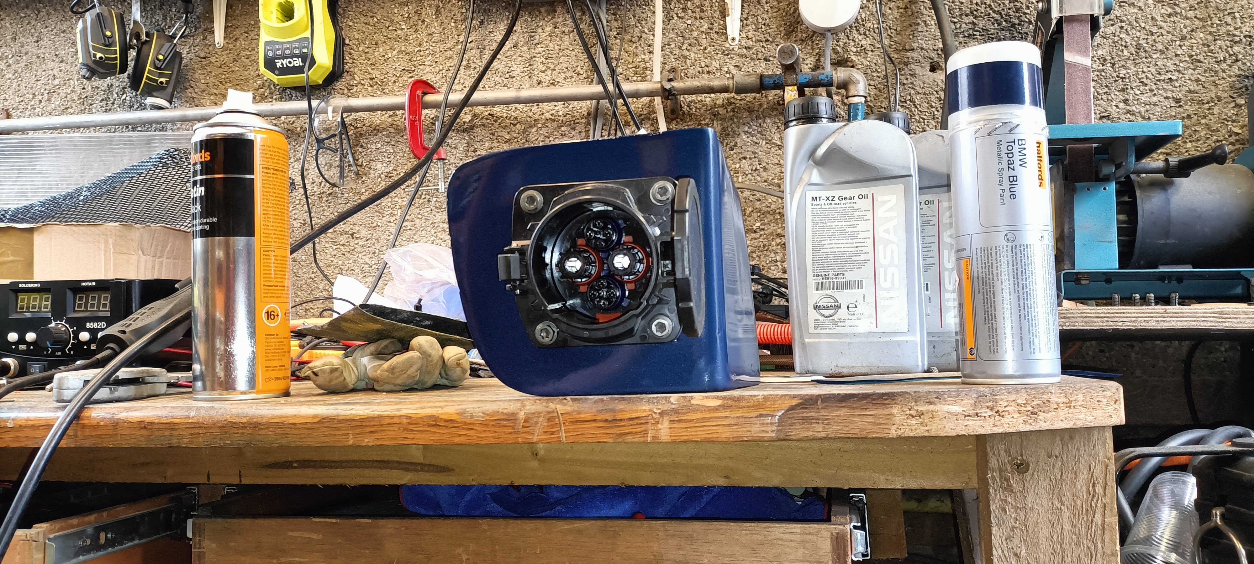

just been shopping to purchase the final few things I need to do my Chademo charge port I'm going to replace the lower grill with steel mesh where it will be fitted
if the weather doesn't get any worse I'll get the old plastic one out and get started this afternoon

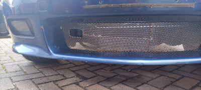

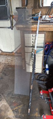

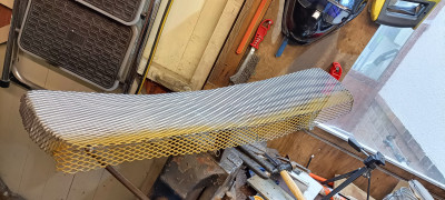

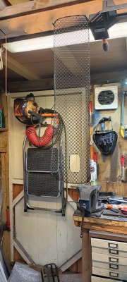

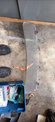

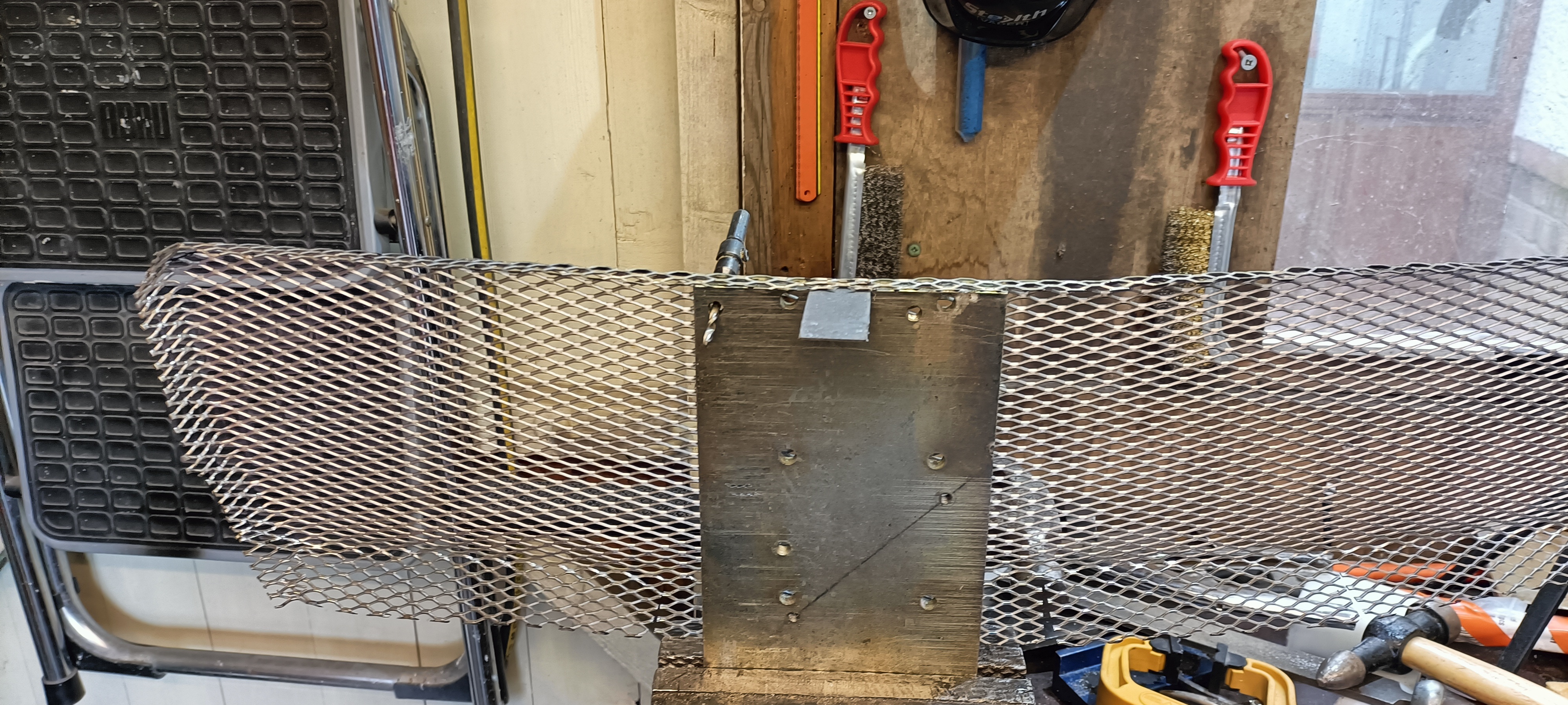

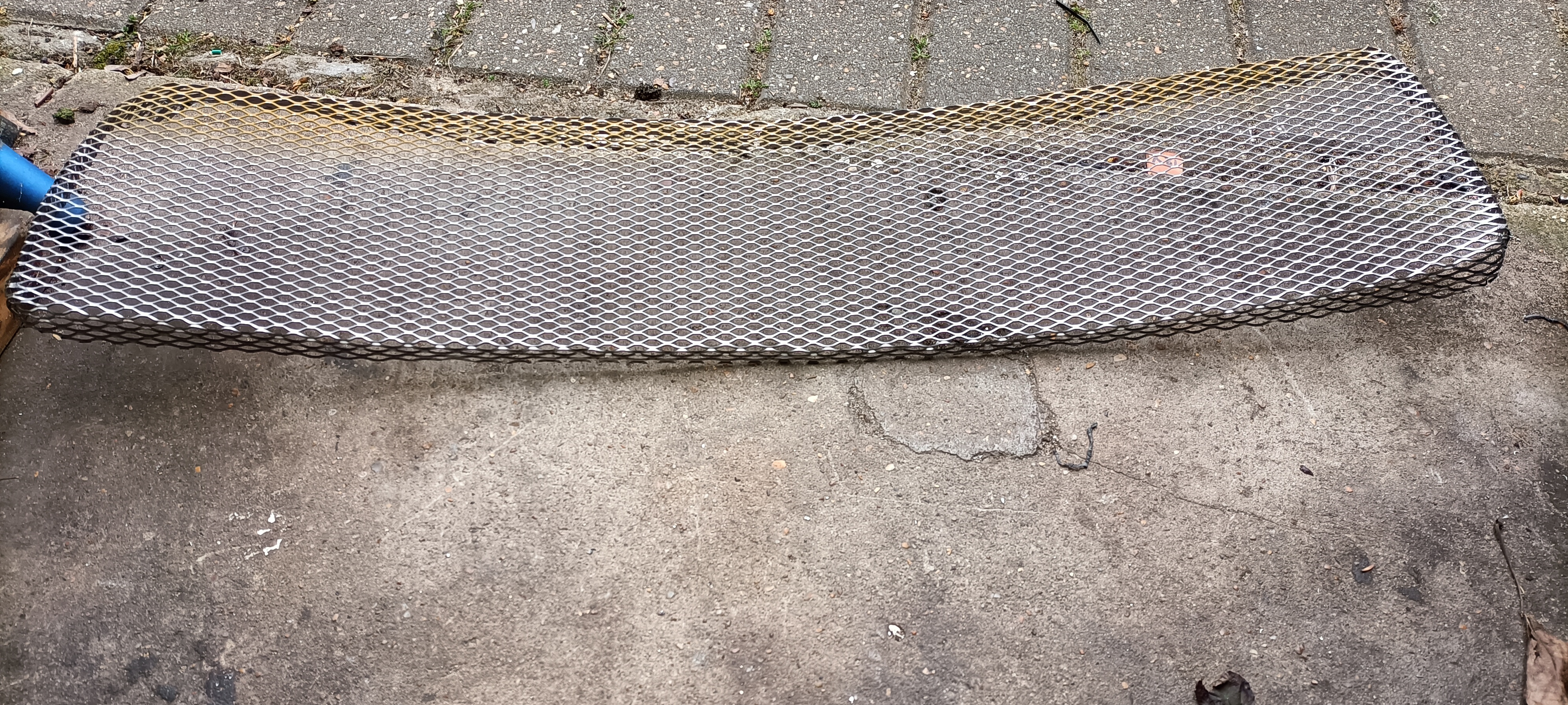

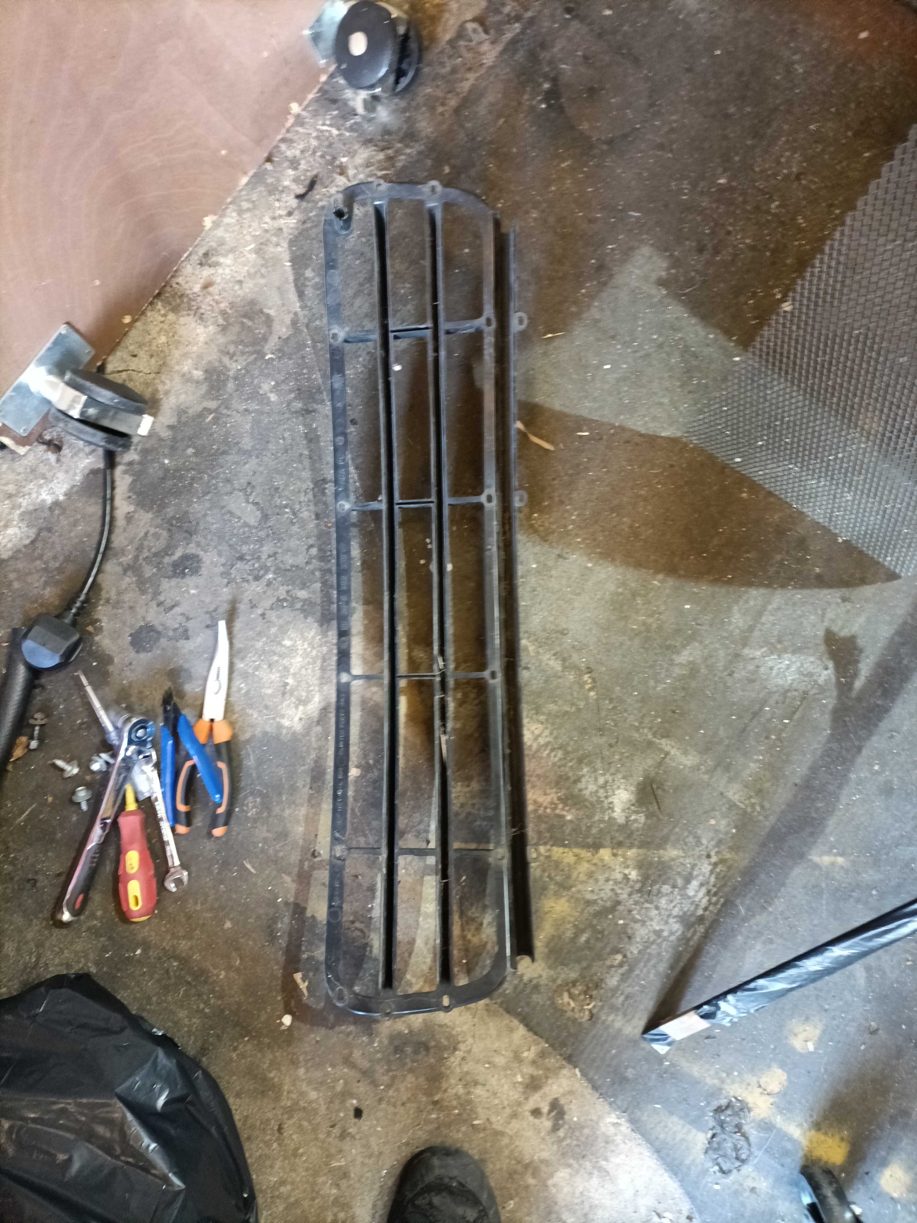

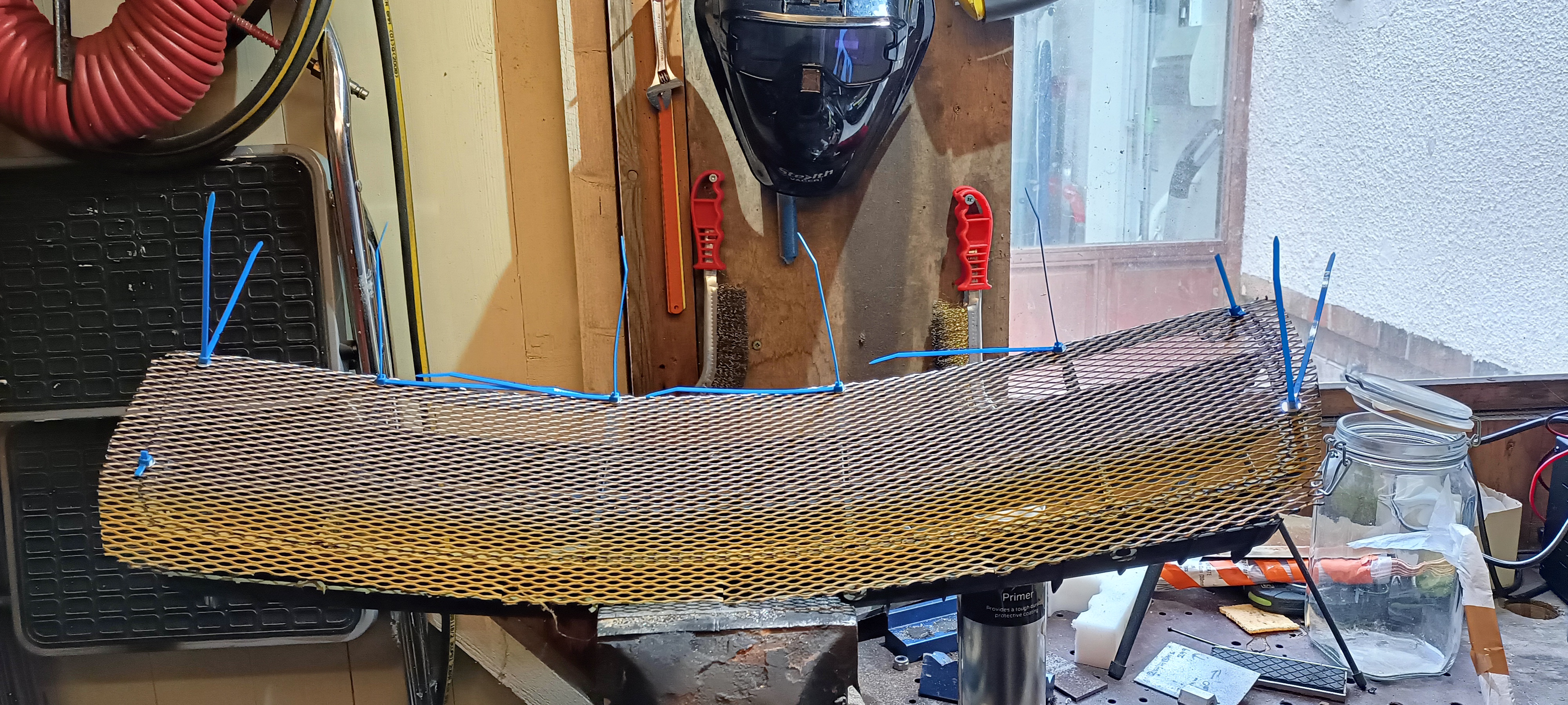

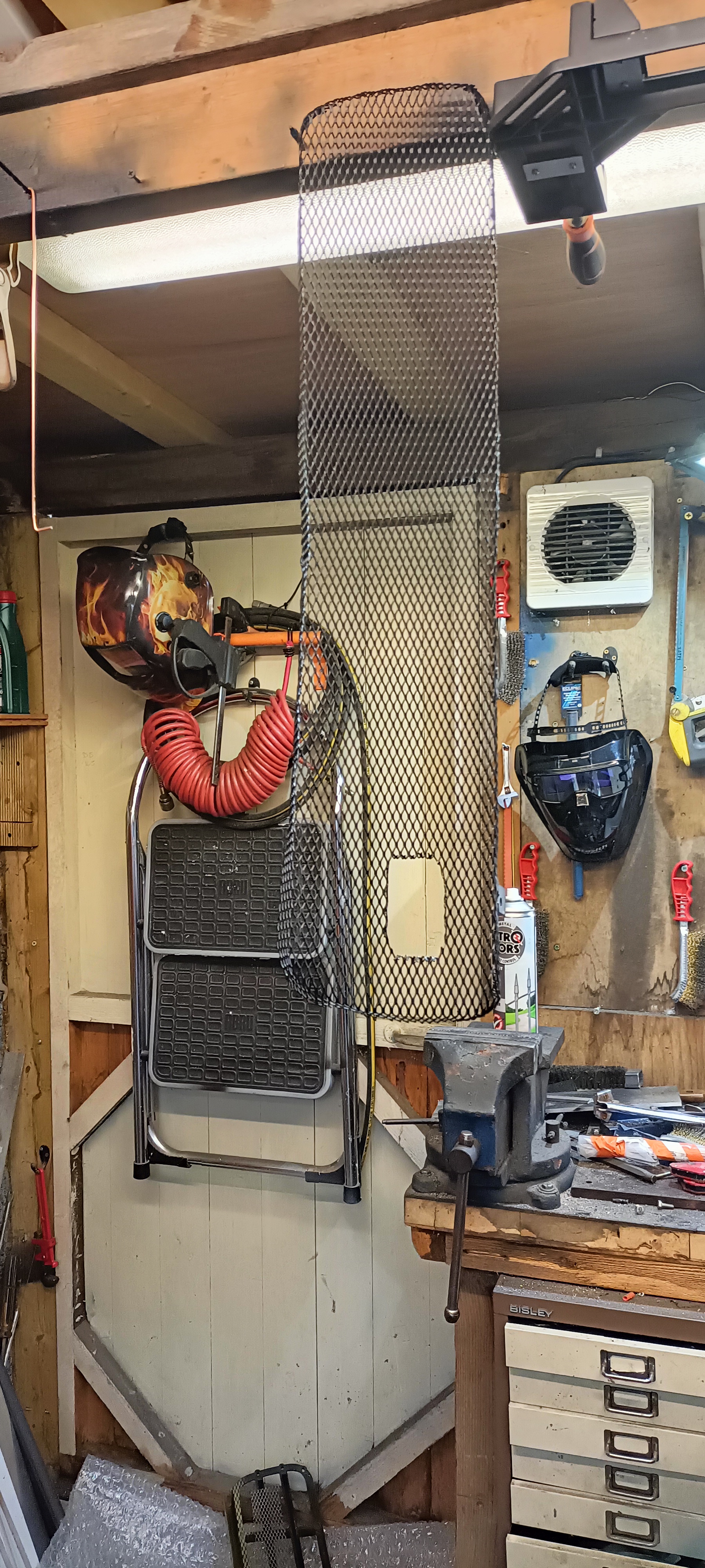

Have made some progress with the Chademo install, I'm replacing the plastic lower front grill with steel mesh that will have a reinforced secton for the charging socket
It was awkward to make as it curves in both directions and being steel harder to work than an aluminium mesh also razor sharp
I welded some tags on for mounting but then the rain hit so plays over for the day

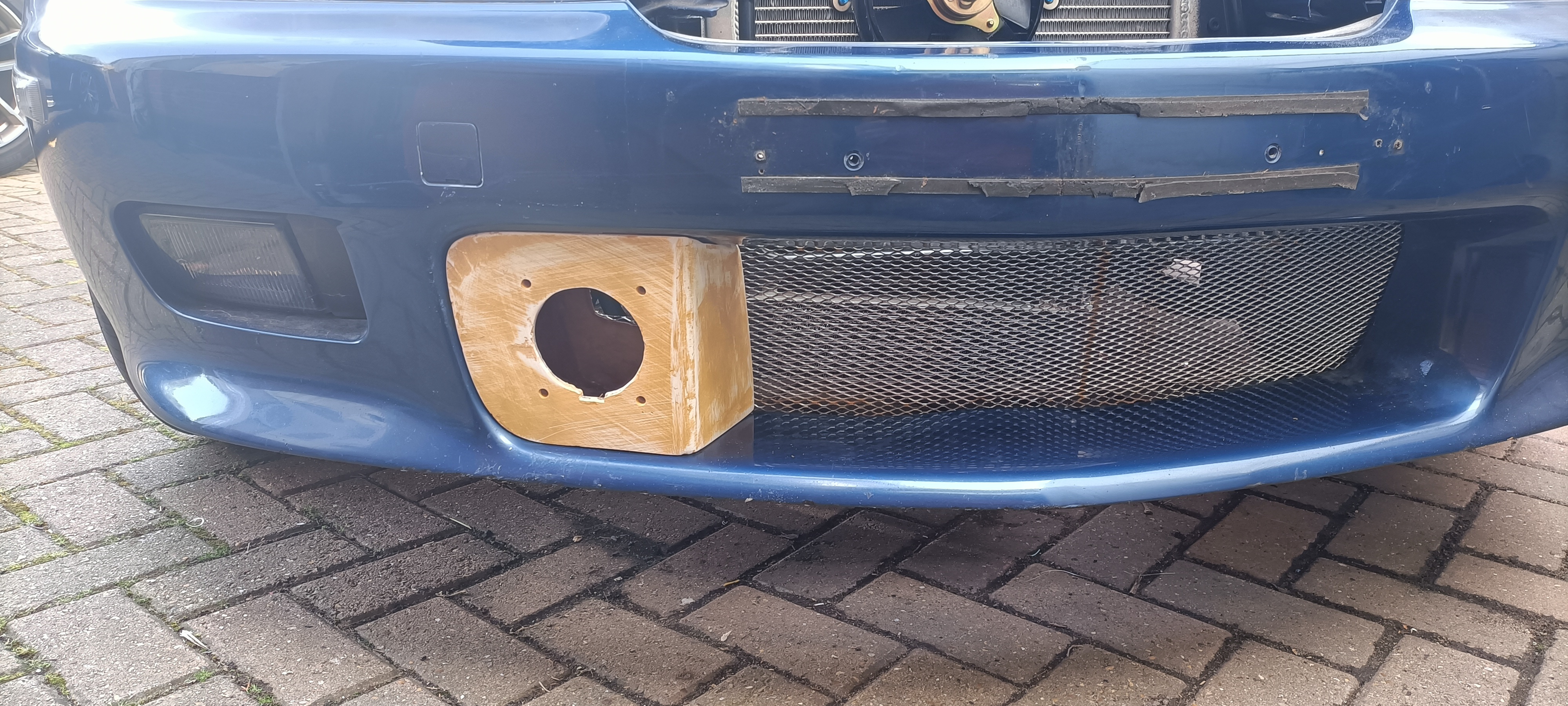

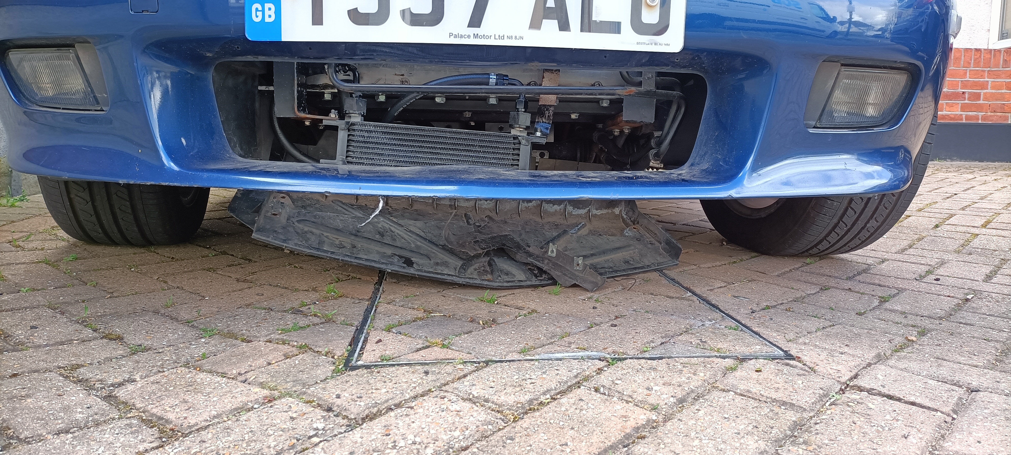

Well that was a waste of time, seems I got over excited and didn't look close enough the front battery box mount is in the way and I'm not changing that so I now have a mesh front lower grill that I didn't need. but it looks good
:lol:

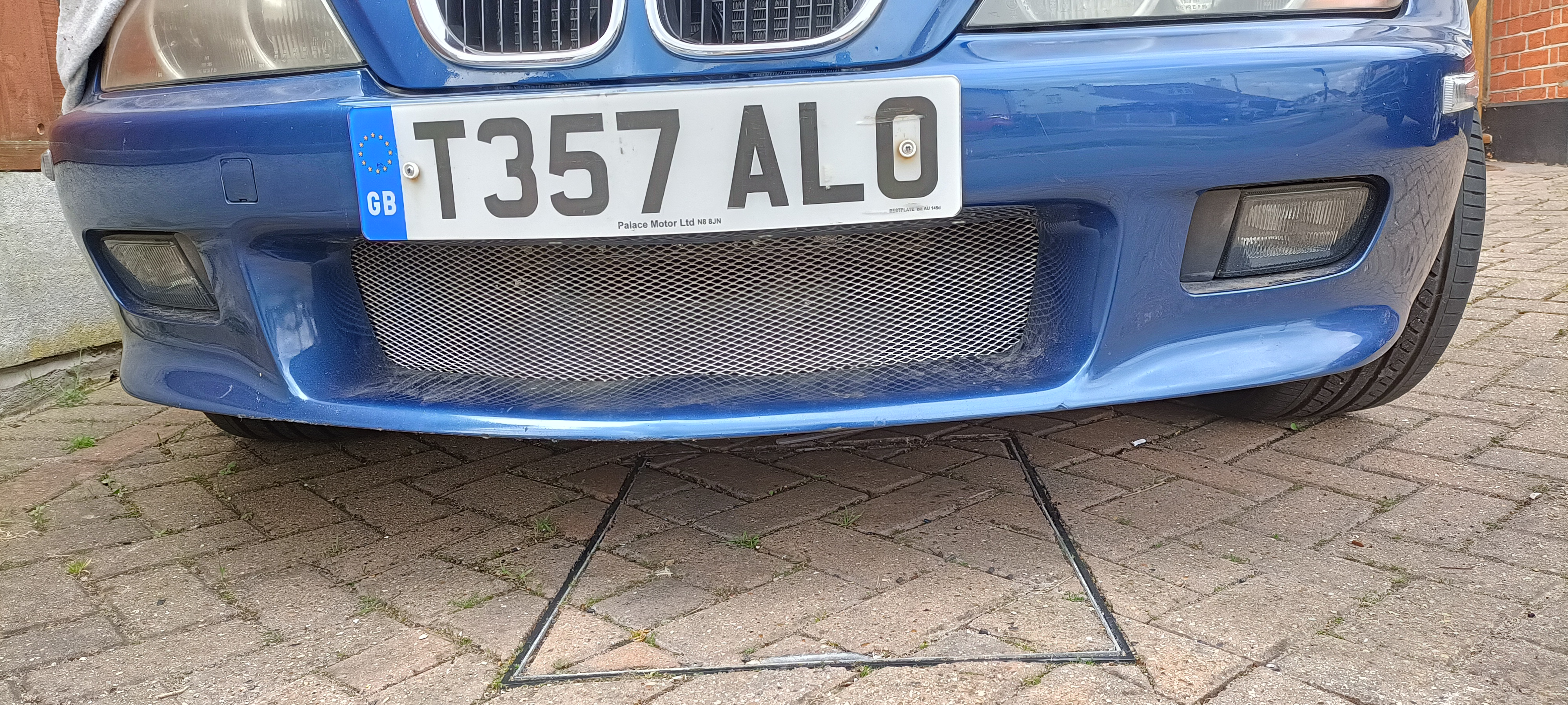

after a small change of plan the chademo install is getting there
so should be able to start the electrical part of the install so expect some stupid questions ;)

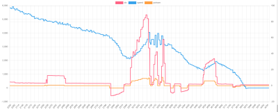

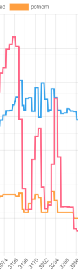

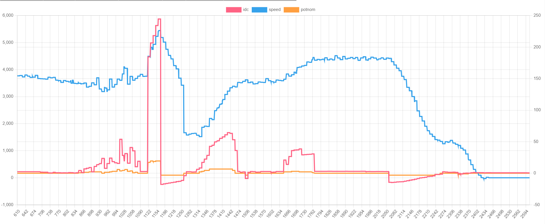

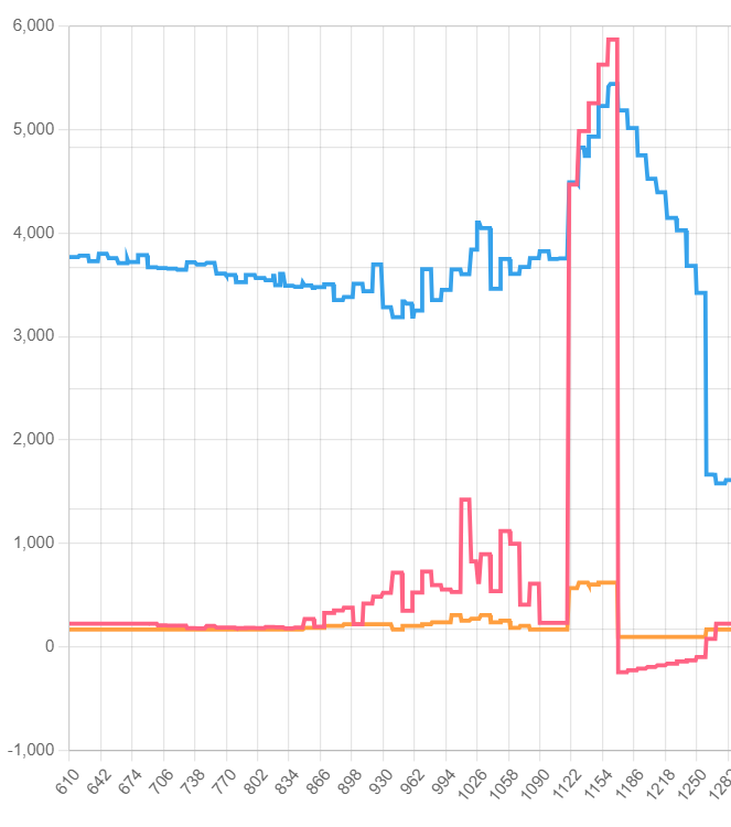

latest logs on Zombie ver 2.15
I've included the whole plot and a cropped version showing the juddering
in the second pair i managed to maintain a steady speed on the flat and it started as soon as I tried to speed up a little
Ev8
Posts: 834
Has thanked: 44 times
Been thanked: 172 times
Re: [WIP] BMW Z3
Post by Ev8 »
Looks like potnom oscillates at the same time? So software based issue and the inverter is just doing as commanded?
Posts: 2962
Has thanked: 328 times
Been thanked: 847 times
Re: [WIP] BMW Z3
Ev8 wrote: Sat May 04, 2024 12:23 pm Looks like potnom oscillates at the same time? So software based issue and the inverter is just doing as commanded?
No these are just symptoms, alot of testing has been done. The issue is the IS300h and GS450h have a quite a bit of slop/delay in things. This creates all sorts of havoc on tuning regen and on off throttle behaviour. To add to the difficulty it will be unique to every setup due to vehicle inertia and driveline slop.

Cool, yes make sense I get a similar effect at very low rpm pulling away, if you don’t accelerate through it you can set up an oscillation though the drivetrain
the potnom fluctuation is probably my foot on the accelerator pedal being moved due to the juddering as it's quite harsh
