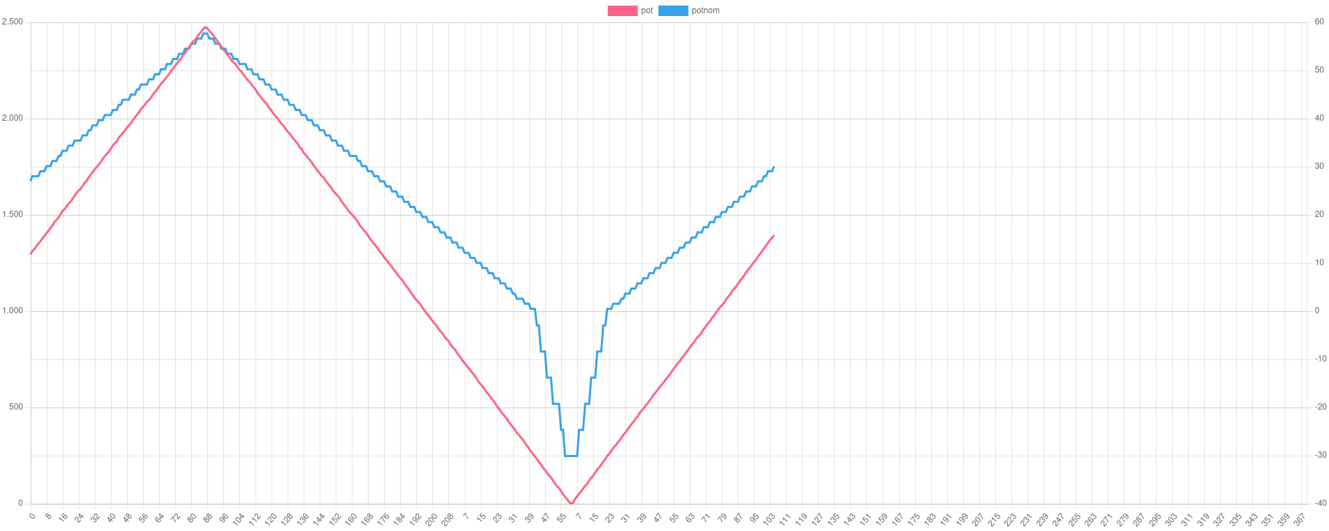

I have finally merged the last pull request but something looks not right:
potnom runs in steps of 1 above 0 and even steps of 5 in regenSupport R/D and forum on Patreon: https://patreon.com/openinverter - Subscribe on odysee: https://odysee.com/@openinverter:9

That looks completely wrong. Also the acceleration looks off, as it should be linear. Are you sure it's the right code?
How do you test? Can I replicate that test somehow?
What maxregentravelhz have you set? How about what rotor hz are you passing? If rotor hz is 0, it calcThrottle will return the same value as potnom.
I tested passing 0,0 -> 50,0 and back from 50,0 to 0,0 with increment of 0,25 and results are not in steps of 1 or anything like what you're seeing there. Here's a sample of what calcThrottle() returns (going up to 50% and then down, using params: regentravel=30.0, regenrampstr=19.0 brkmax=-60.0 brknompedal=-60.0, maxregentravelhz = 200)

I used this code: https://github.com/jsphuebner/stm32-sine/pull/42
maxregentravelhz=90 (the default) . I used a signal generator with 0.1 Hz saw tooth 0-2V

I have stripped the code back down to the basics and it is also quite well drivable. Of course I never had a chance to test yours so can't compare
https://github.com/jsphuebner/stm32-sin ... f2268f195e
It's a simple linear curve, more speed more regentravel until maxregentravelhz is hit

Ok. That looks simple and easy to understand. Good to get rid of that dead zone with the official firmware too
. Hopefully I made it bit easier for you
I agree that my code was bit difficult to read and maybe not as simple as I would liked it to be, but it works very nicely. Thought, just found out that there was a small bug related to increasing the regentravel - it never reached max. Just fixed that to my fork of stm32-sine.
Did you find out what was causing those weird steps in your graph?
