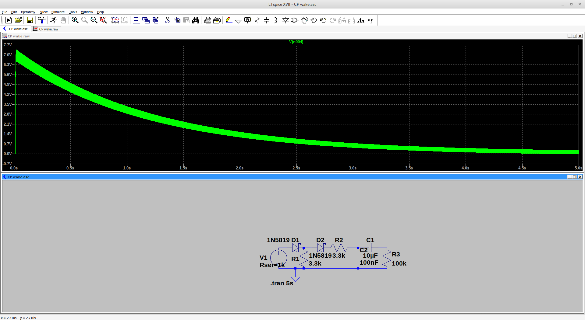

Got a new batch of boards. Always very satisfying when getting into the charge loop. Took some re-reflowing of the QCA chip, still doing that one by hand.
Anyway, the wakeup circuit doesn't work at all. The TL431 shunt never pulls it's output below 1.8V and 1.2V is the threshold for shutting down the 5V reg. So will remove the PP wakeup for the next revision and just roll with CP and external wakeup for now.
Might patch in just the new wakeup input to have a bit of functionality

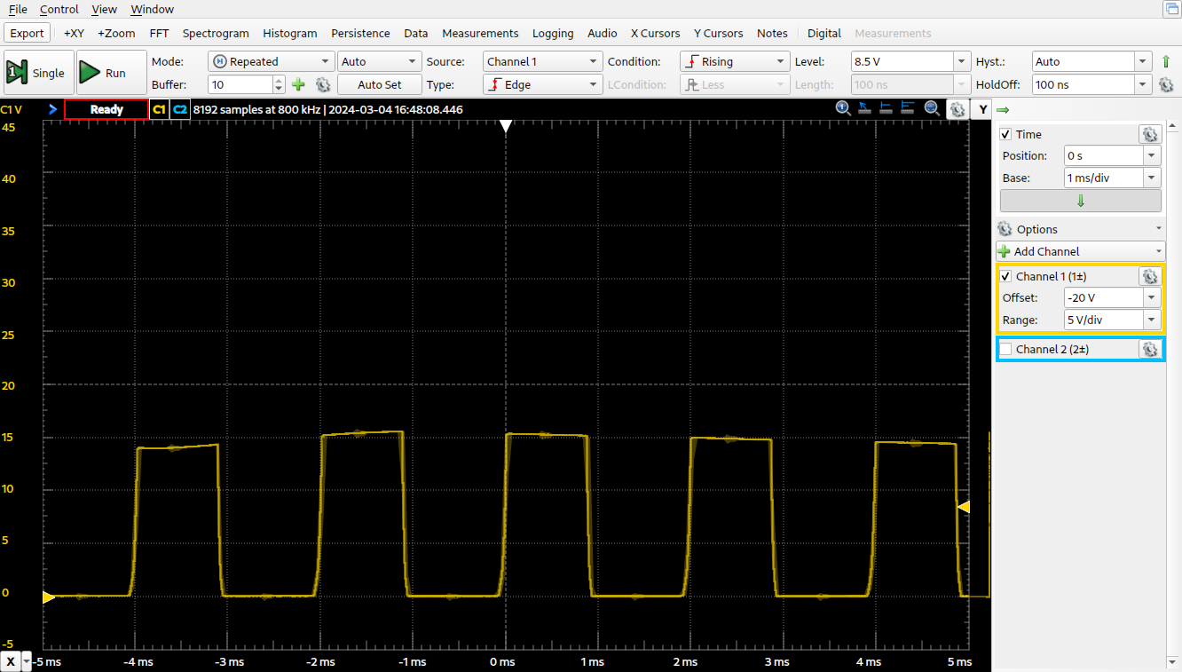

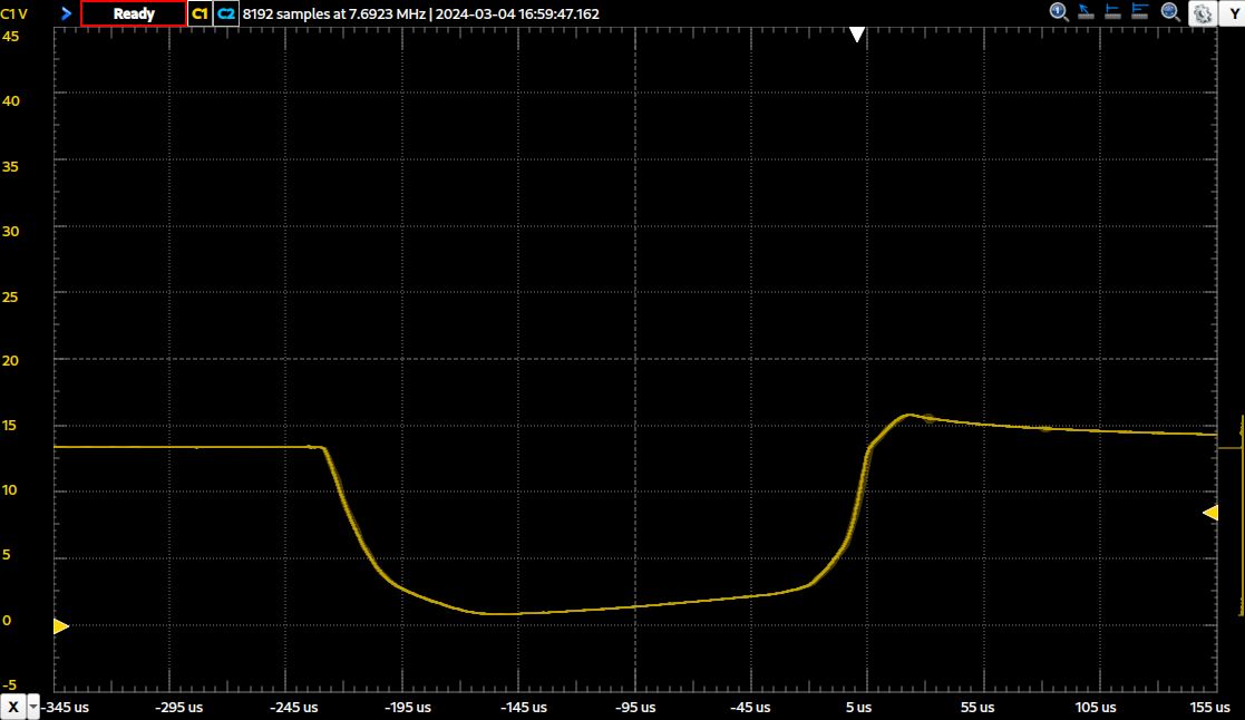

Played with the economizer a bit more. First, when HardwareVariant <= 4003 (I changed unknown to 999) PWM frequency is reduced to 500 Hz.
So yeah, it certainly doesn't limit turn off voltage very much. With a freewheeling diode added it looks like it should This was just with a tiny relay. Then I replaced the relay with a larger inductor and set the duty cycle to obtain an inductor current of 600 mA. Already then the NCV chip became painfully hot after little time.
I reckon the inductor had entered saturation because of the low frequency. Dialed back to 10% or 470 mA: Looks better, but the edges really aren't very steep. Tempted to say we disallow economizing completely with the NCV8402 variants

Pooohh, this really looks ugly. But the times are according to the data sheet roughly:
I'd agree, that with these conditions the PWM does not make sense. It would need to be faster, to avoid saturating, but the faster the PWM the more heat is produced due to the slow transitions. Will only work if the inductance is much higher than in your test. Maybe adding an additional inductance in series, as workaround?
- Been thanked: 1913 times
Re: Develop a QCA7000 board?
That or an economized relay in the first place. Only affects a couple of boards so I'm not too eager about it. I myself use economized relays
