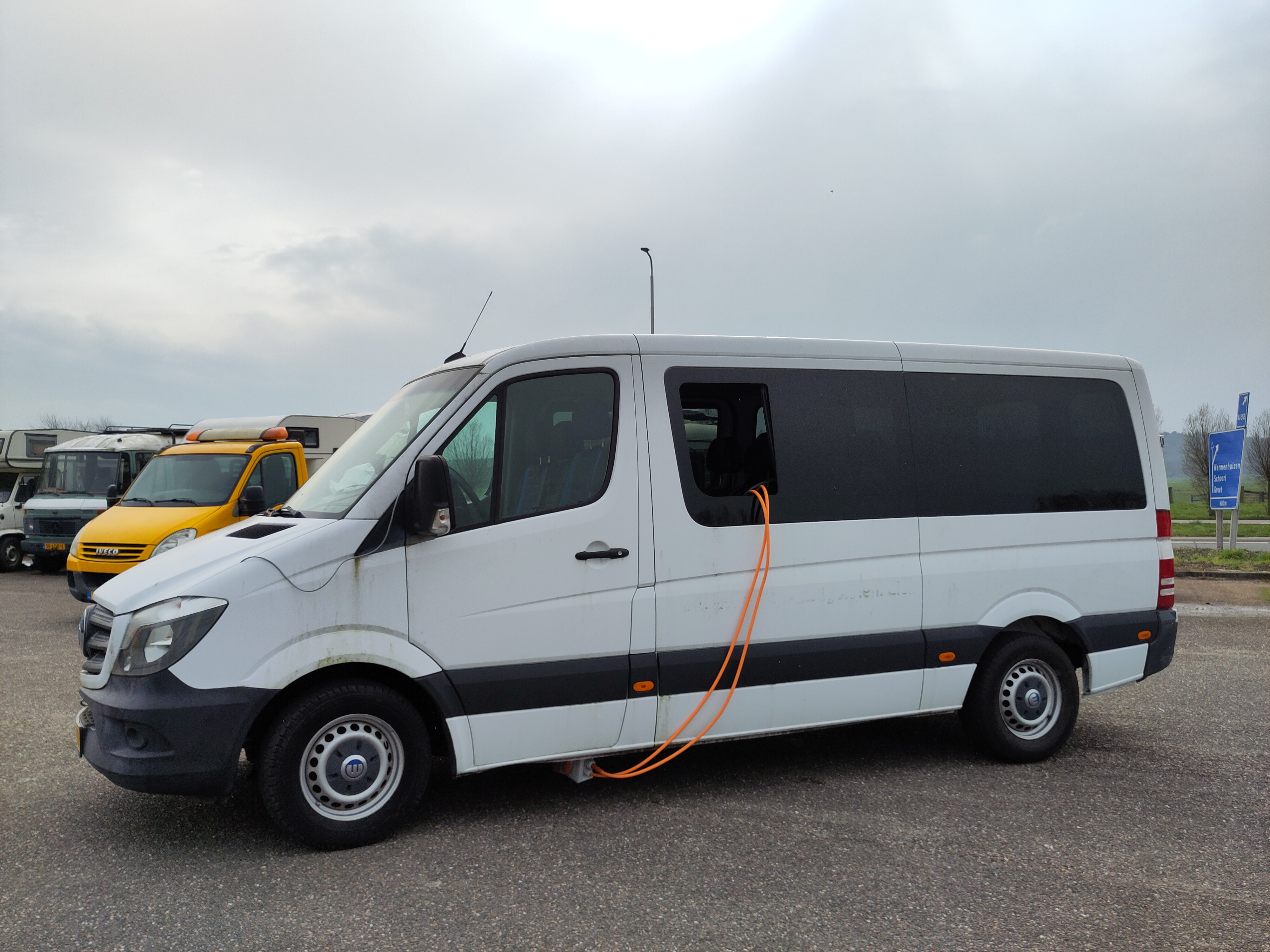

So, I bought an electric van that was broken, and it was made by a small German company that already went bankrupt.
This one was one of their last, in 2015.
It basically is a Mercedes Sprinter with a Siemens ELFA2 drivetrain (motor and inverter) mounted to the 6 speed gearbox. That wasn't really necessary, but it worked.

Doing some basic testing, with some questionable cabling :mrgreen:
The cables are shielded though, and I'm just driving 50 meters and stopping again.
PHEV battery pack for testing on a pallet, forklifted in the rear of the van. Convenient.

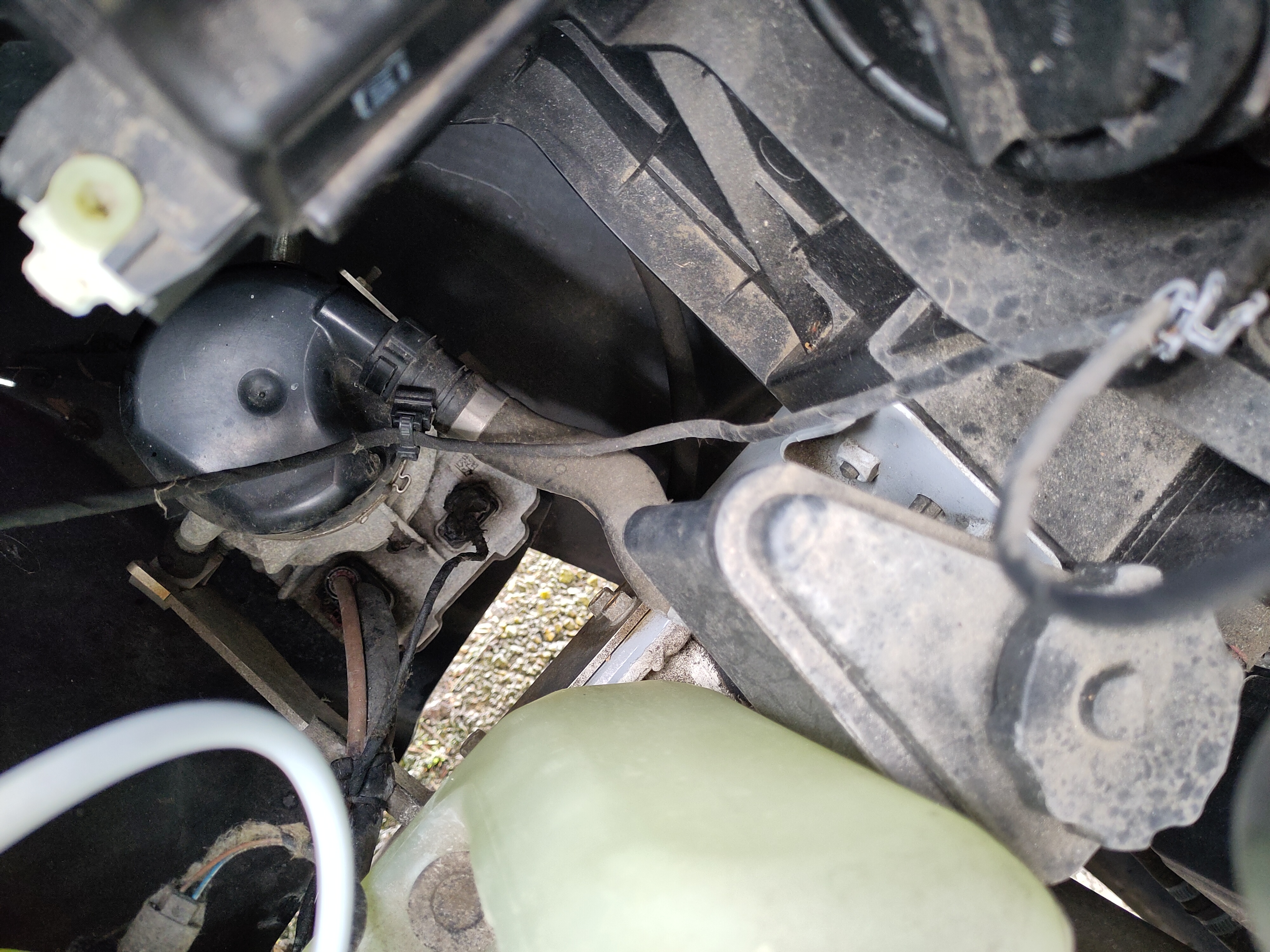

Now, I've got to figure out this electro-hydraulic steering pump.
It seems like something that ZF offered, but maybe somebody else really produced it.
There isn't any clear labeling on it.
Next to the big 12v power supply, there are 5 cables, obviously a 12v signal cable and 2 bus systems.
I will check them this week, I'm afraid that they are CAN bus and LIN bus.
But since it is steering, it could be redundend CAN bus?
I only have CAN tools so I will check it that way.
The red-yellow wire does get 12v on it when the key is on, and the pump is still silent.
Since this is a pretty big van, I'm afraid taking a dumb EHPS pump from an Opel or something will not be powerfull enough.
On the other hand, if these dumb pumps with the wires connected to each other go to high output, it might be good enough.
Jacobsmess

The vauxhall/Opel Corsa D EPAS have been used in motorhomes and other large Mercedes vans to success. I plan on swapping my van to the Corsa D EPAS when I pull the ICE engine for EV conversion.

Jacobsmess wrote: Sun Mar 31, 2024 8:37 pm The vauxhall/Opel Corsa D EPAS have been used in motorhomes and other large Mercedes vans to success. I plan on swapping my van to the Corsa D EPAS when I pull the ICE engine for EV conversion.
So with the electric motor on the steering column?
That seems like quite some work to me.
The van I have still has a standard Mercedes steering system, so as long as I get the fluid going into one house and out the other, I don't have to do a lot more mechanical work.
I do agree that a motor on the steering column is probably the best solution, lighter and more efficient (only when you need it).
But at this point I don't want to dive into steering systems (not enough time) and I don't feel comfortable messing around with it.
However, there are lots of other Opels in the wrecking yard for parts that do have simple on/off electro hydraulic pumps that I could fit. But yeah, they might not have enough flow.

I made a seperate topic for this power steering pump. I did some CAN bus debugging, but without any further info, it is quite hard.
It probably needs to be replaced.
viewtopic.php?t=4882
