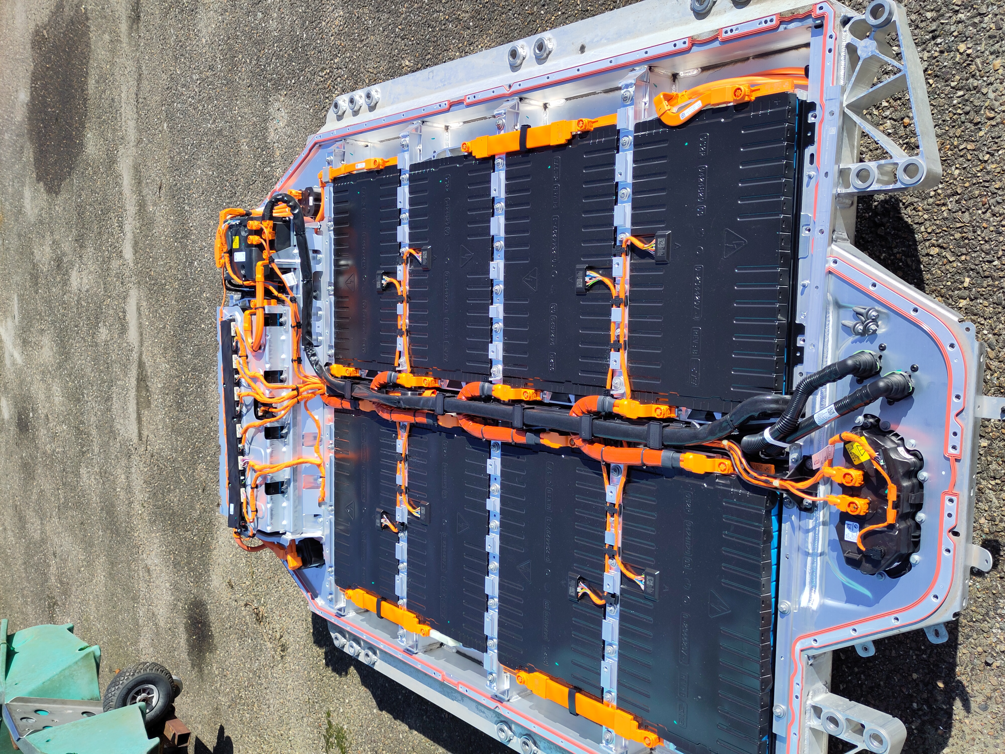

Hi all,
This might become a general thread for Generation 5 packs used in BMW IX3 and other models since 2021/2022.
I'm opening up a Gen 5 BMW EV pack, a ~80kWh one.
They come in different sizes up to 111kWh, but they all use the same cells. Typically in 2p but I think the 111kWh uses 3p?
Anyway, mine has 8 modules of 9s2p and 2 modules with 11s2p making 94s.
I intent to reuse this, with hopefully not too much effort.

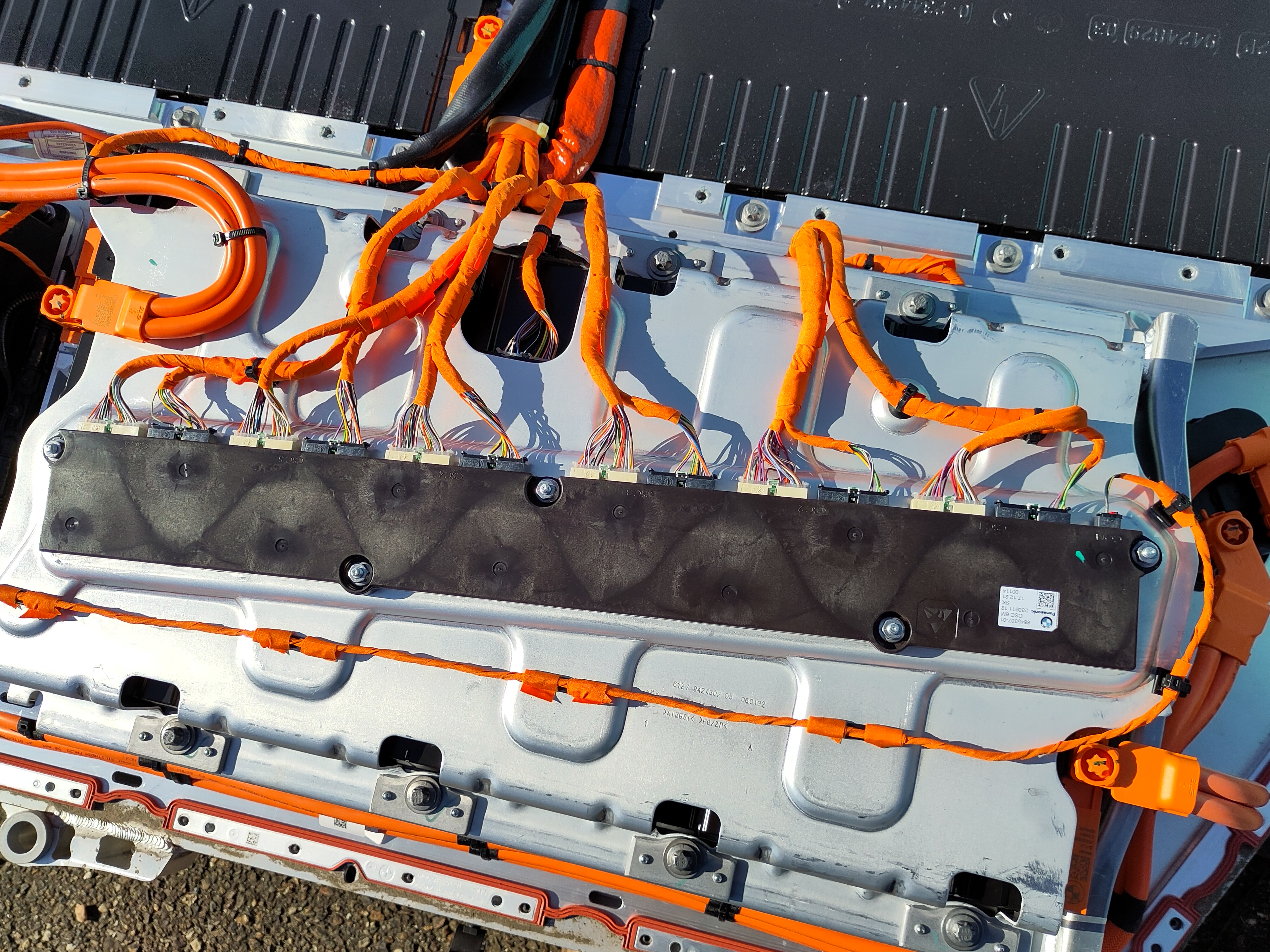

Re: BMW GENERATION 5 packs (IX3 etc) - opening / reuse / reverse engineering

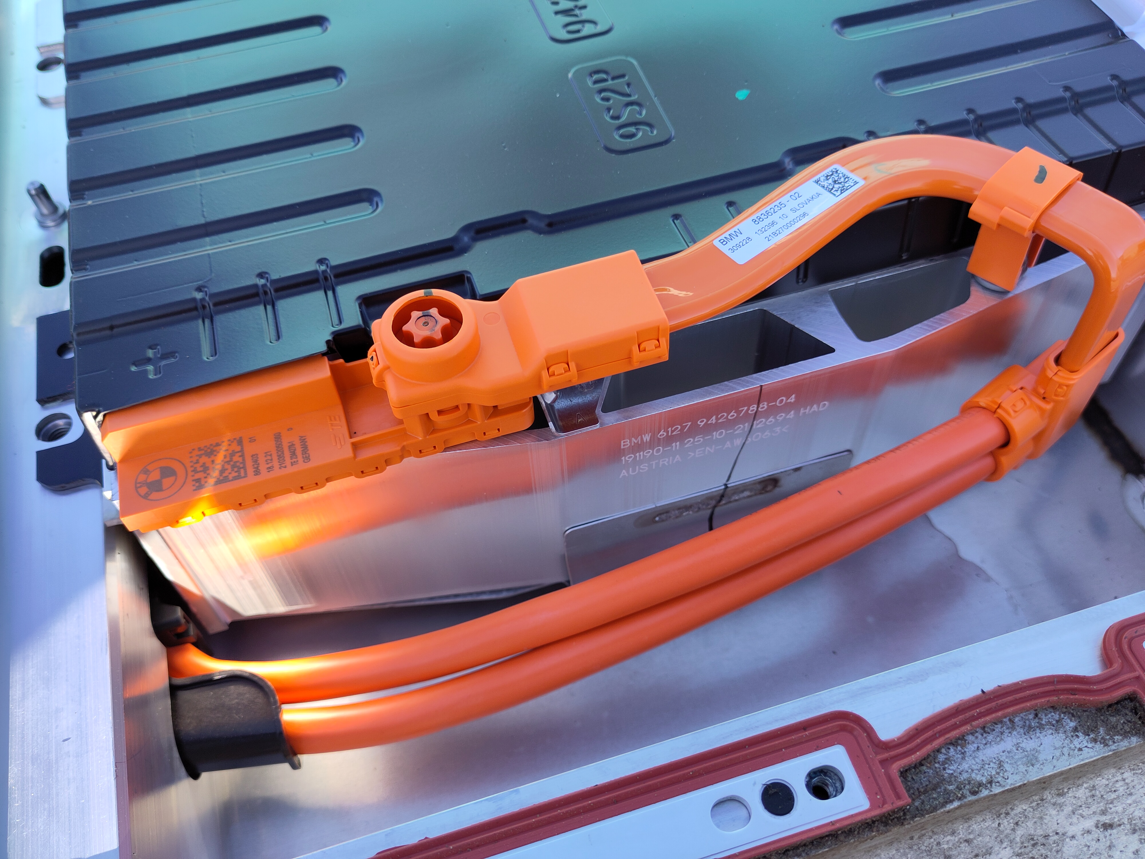

For now I just have some rough measurements of the modules.
They are ~11cm high including a liquid cooling plate under it.
They are 31.5cm wide without the flange, which seems to be 2cm on each side.
The 9s block seems about 56.5cm long and the 11s seems 68 to 69cm long. (4 cells more)

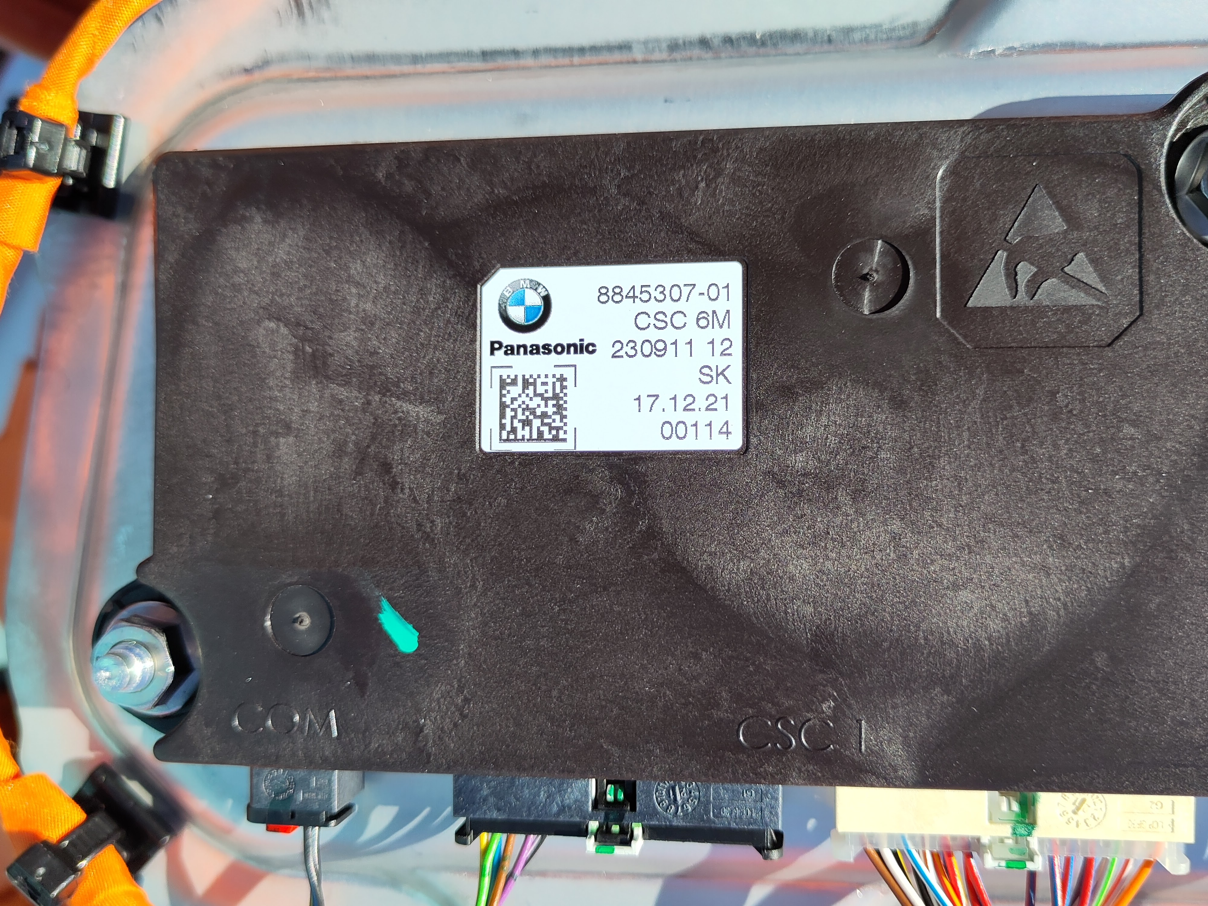

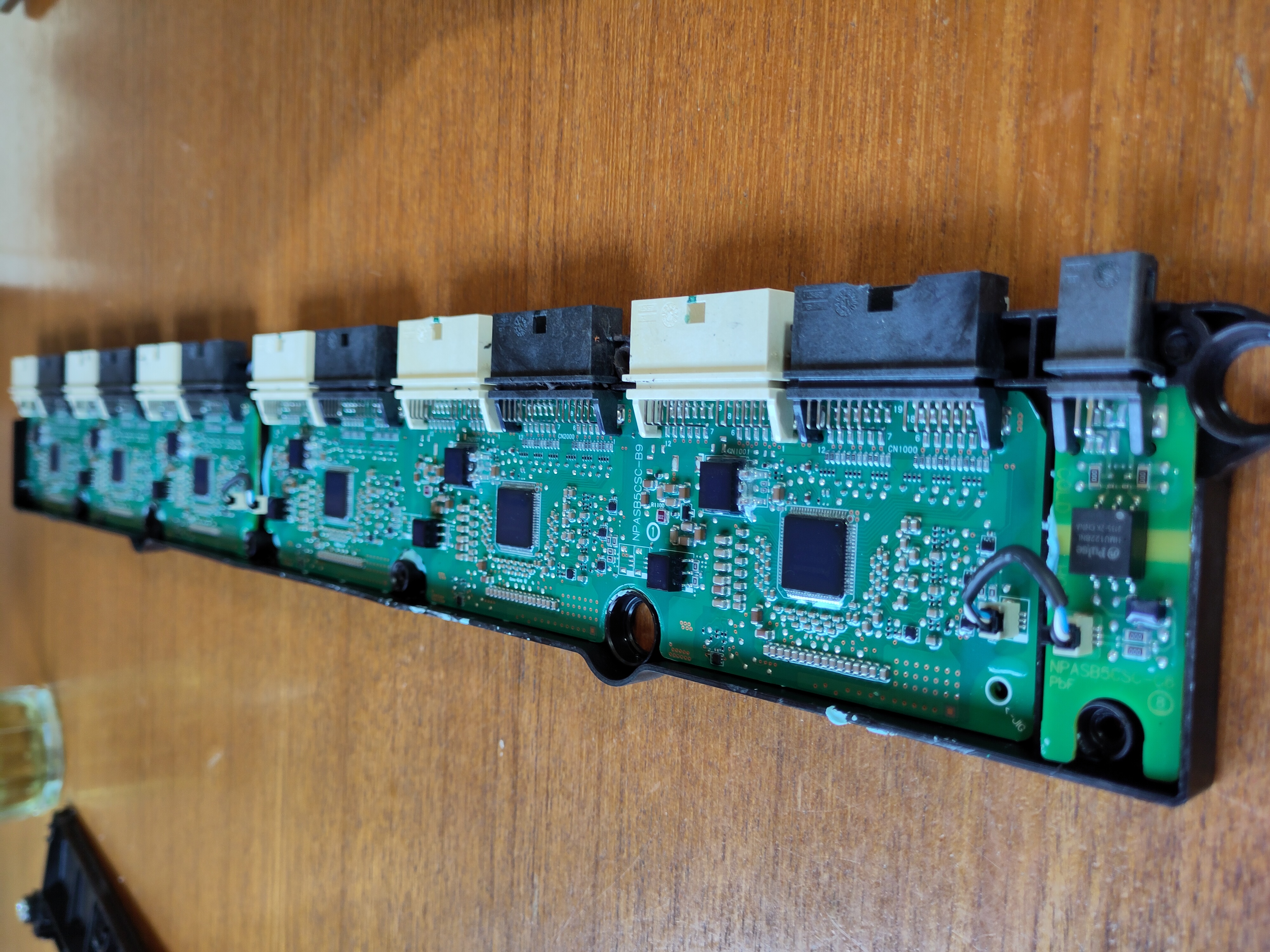

CSC 6M module for all the cell voltages and temps
2 Wire interface labeled as COM which must be the CAN bus.
There is a connector from the main PCB to the small CAN board, so 2 of the 4 wires must be for power. 5 volt most likely?
This is the module where the low voltage connector is on the outside of the pack.
This connector comes into the pack and should have 12v and CAN amongst others

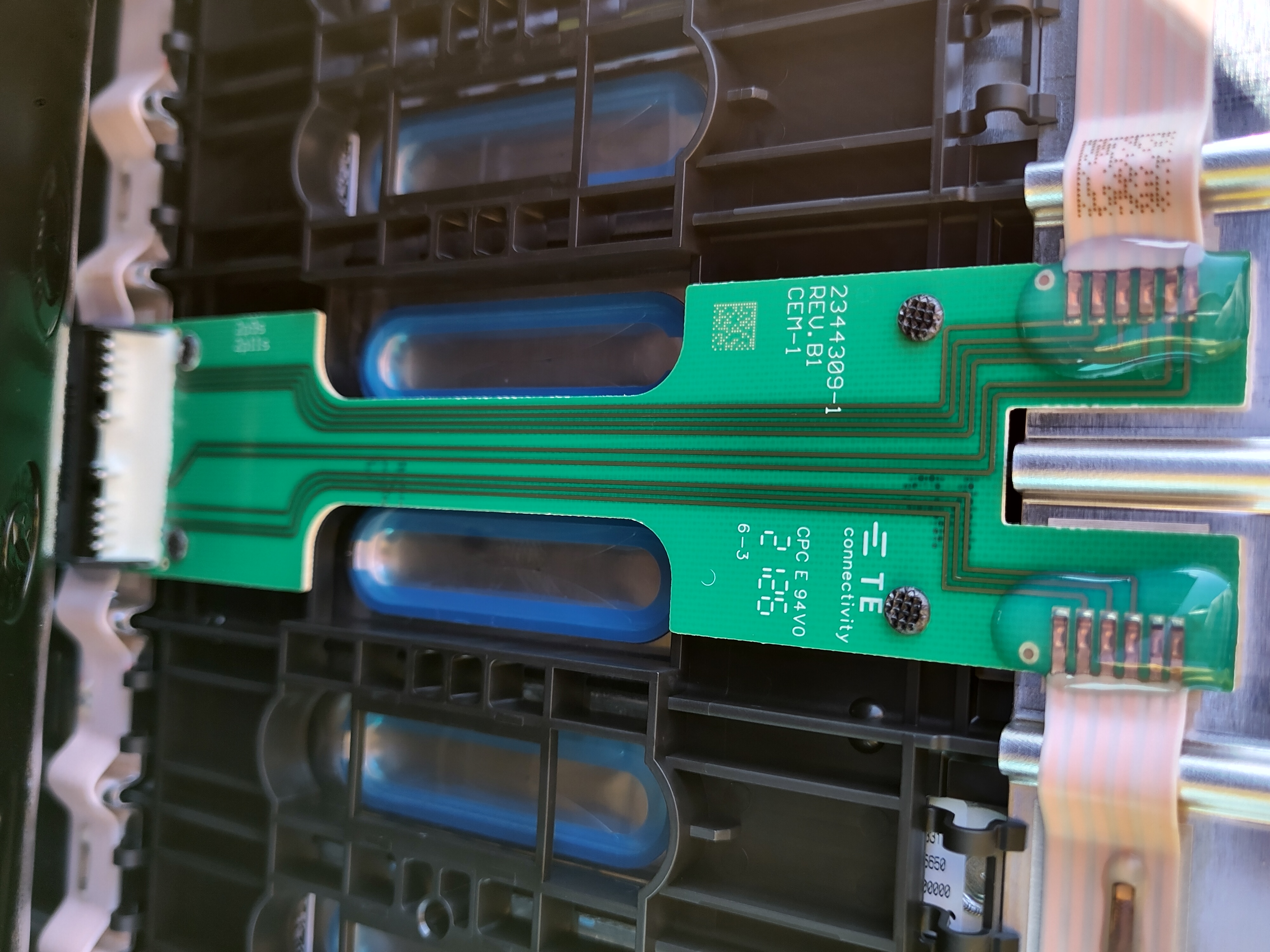

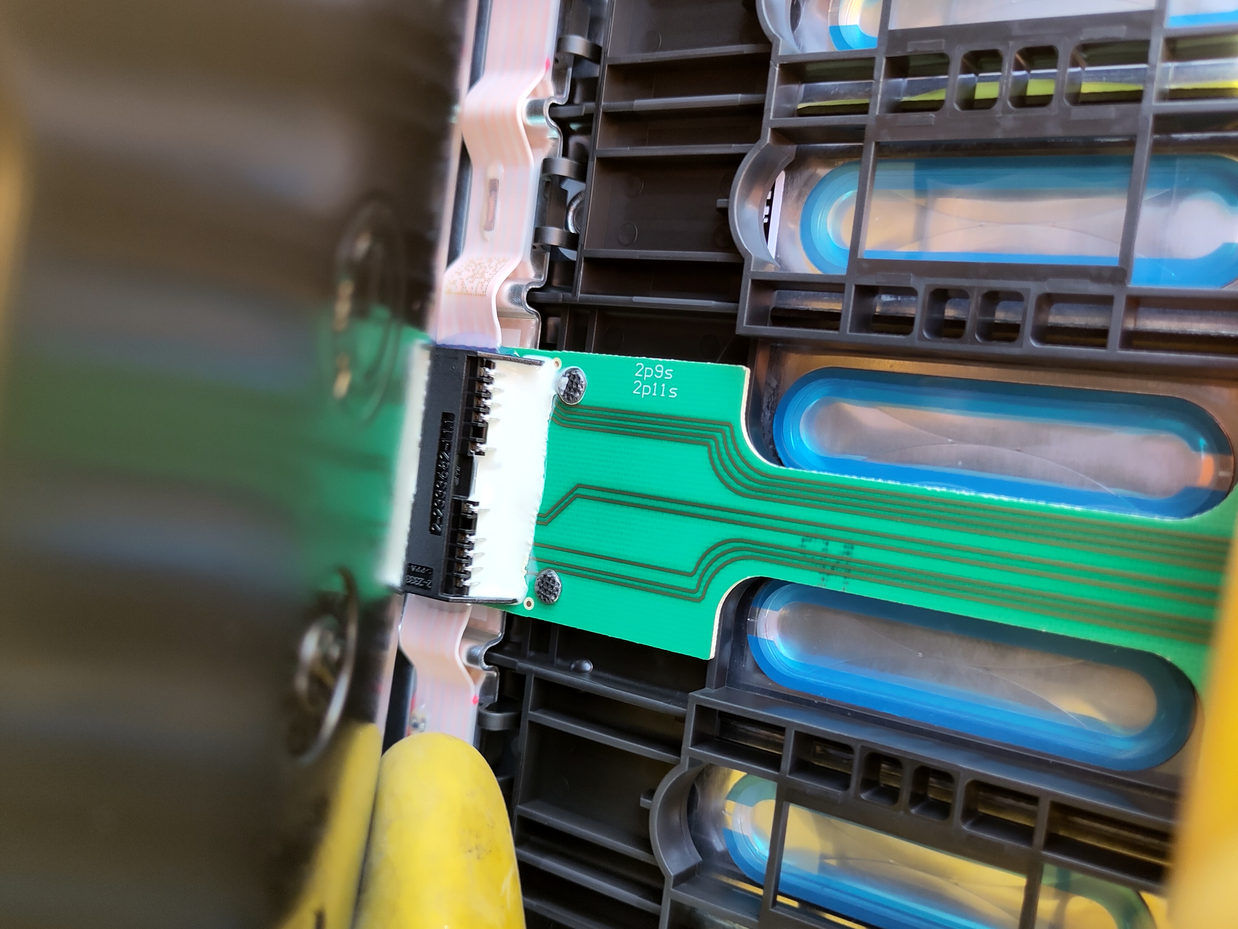

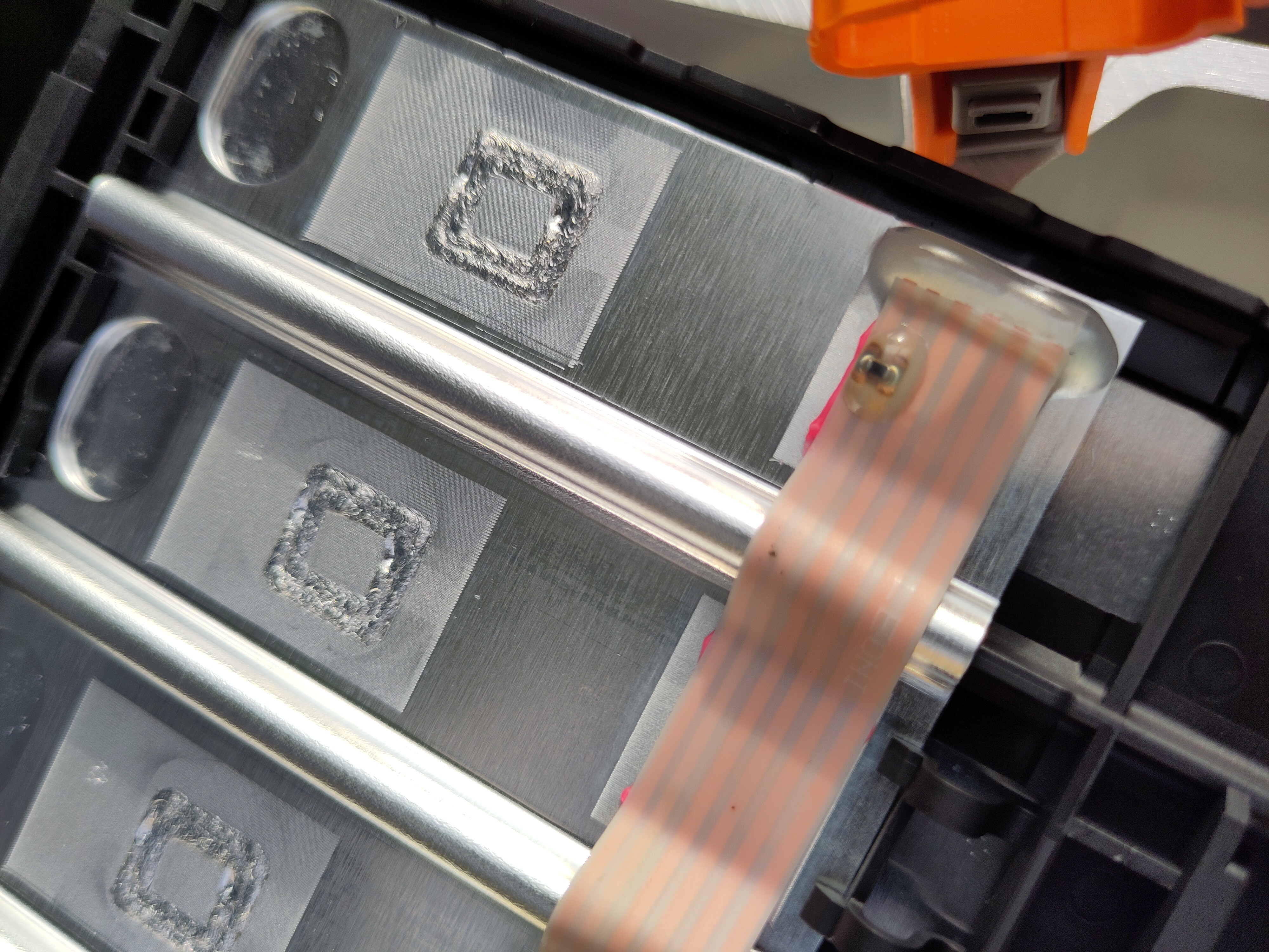

The CPC boards on the modules. Same PCB for 9s and 11s, you can count the cell wires. Temp sensors probably on the other side?

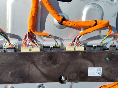

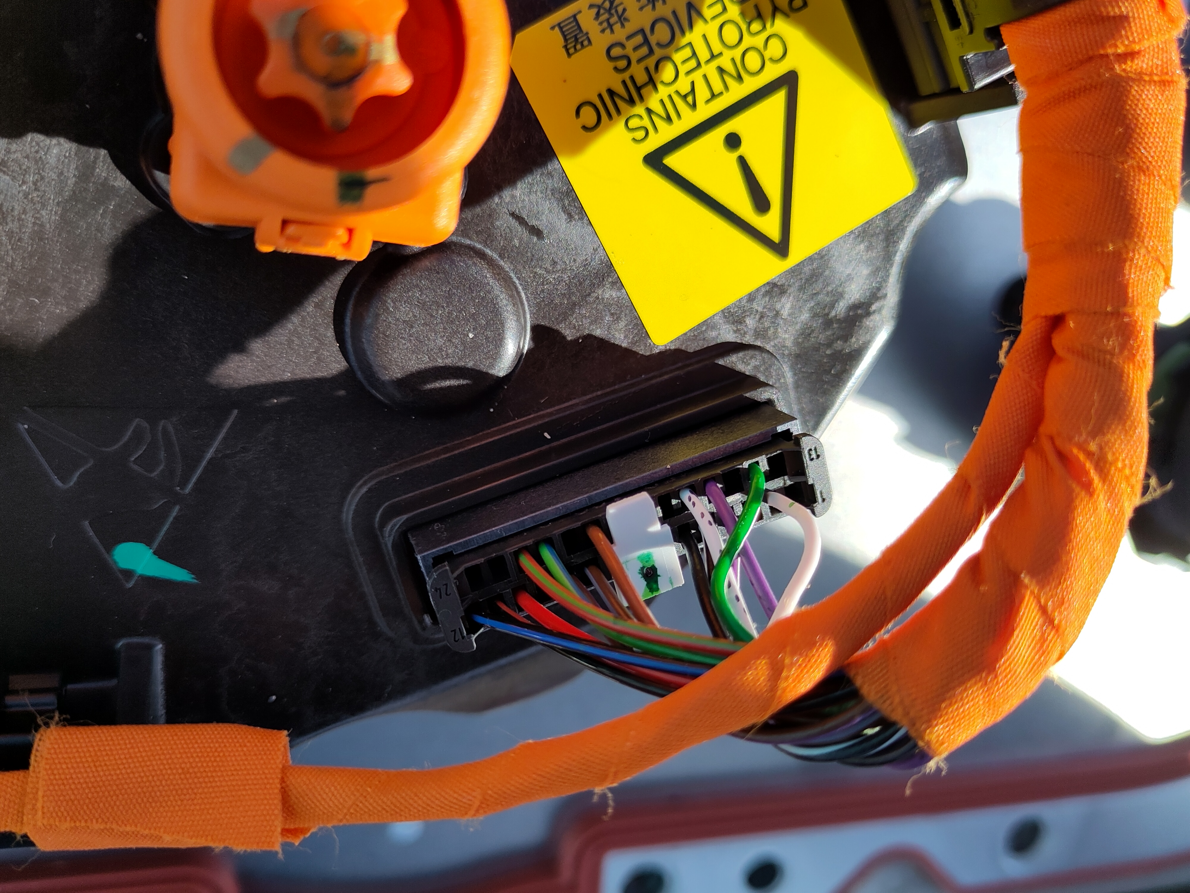

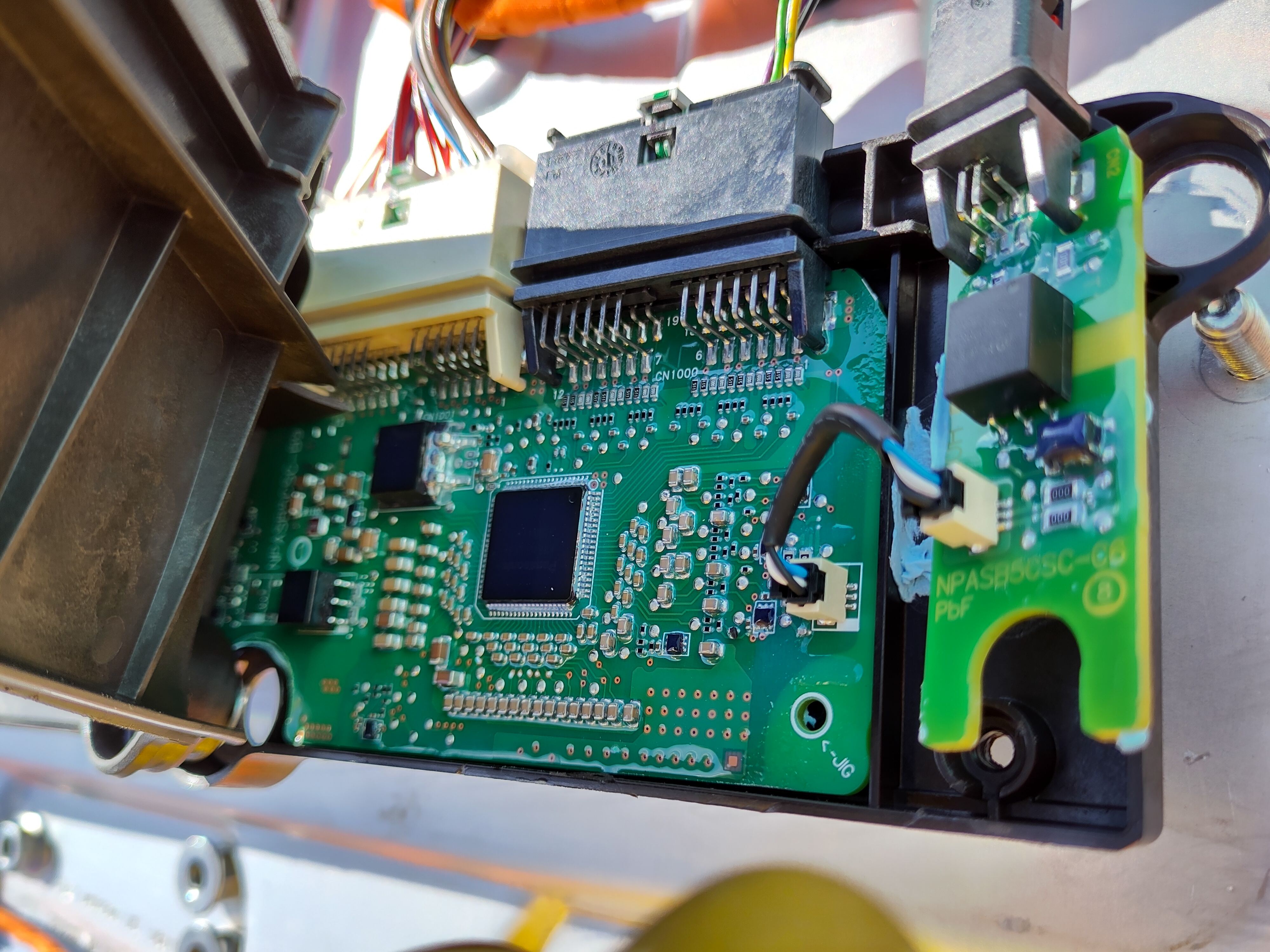

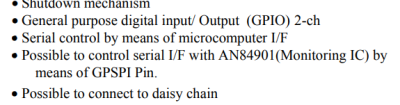

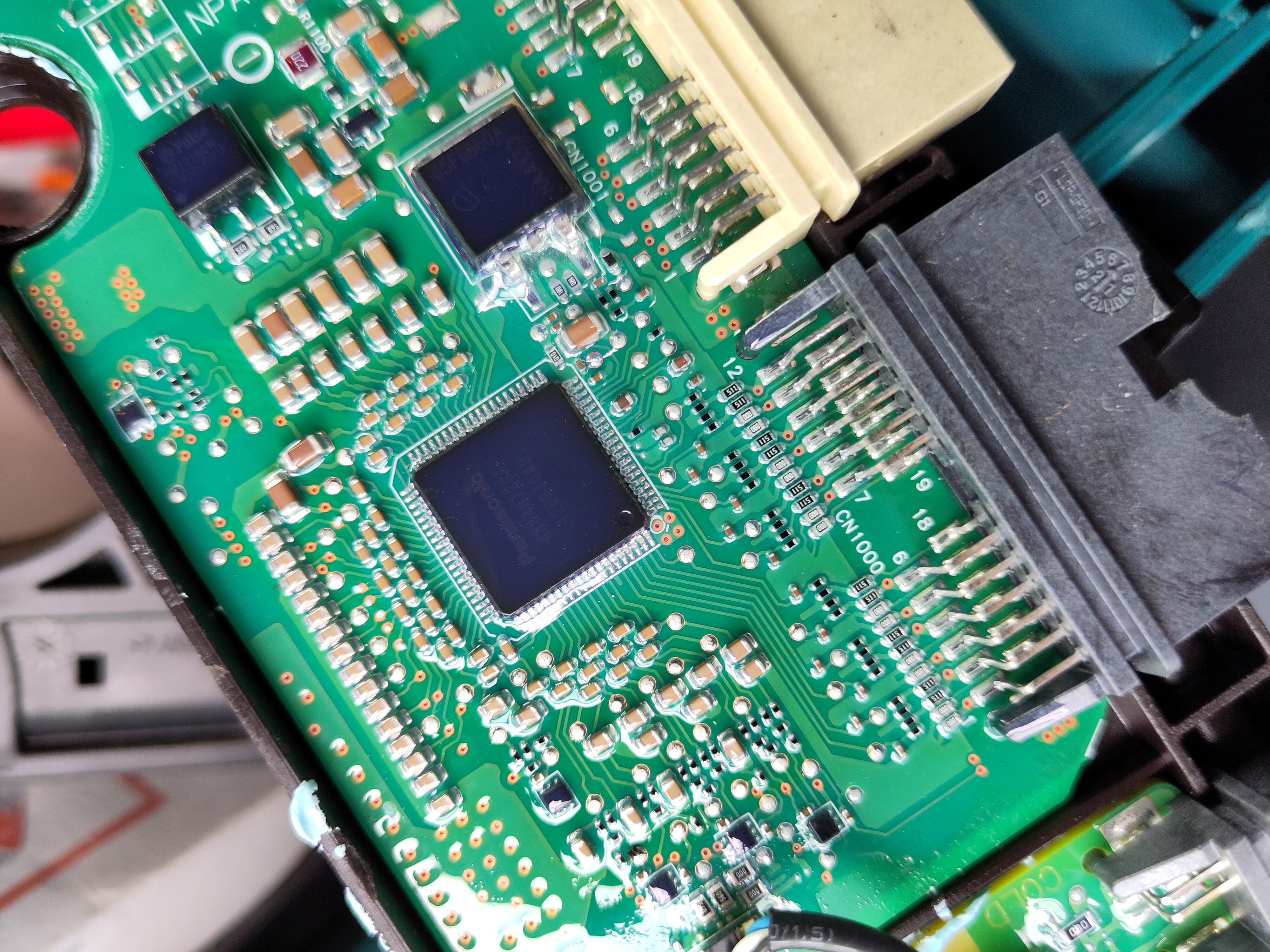

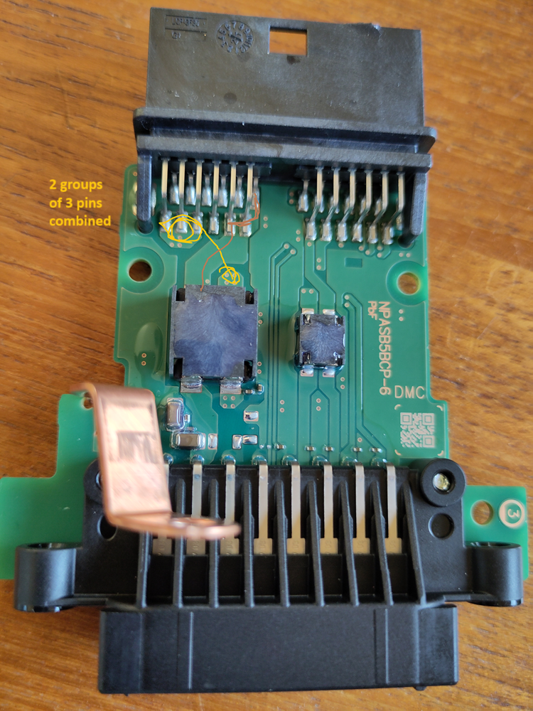

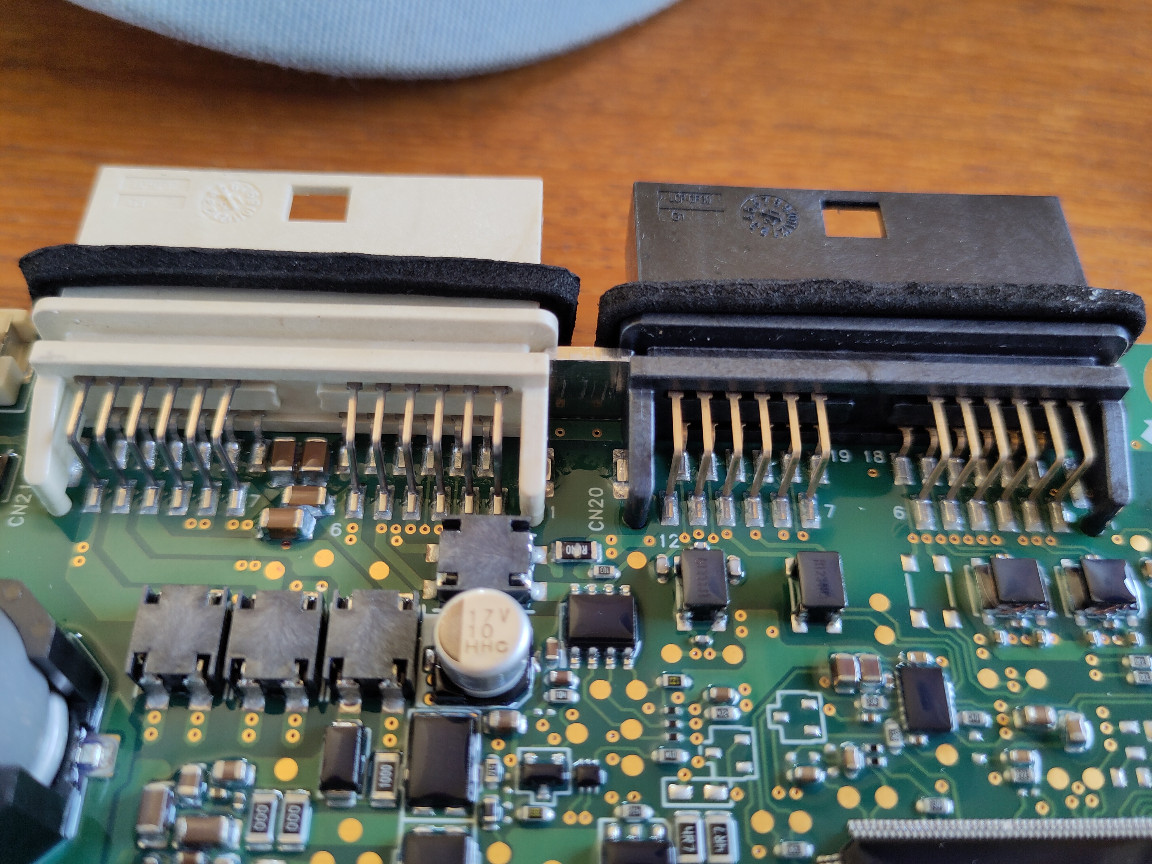

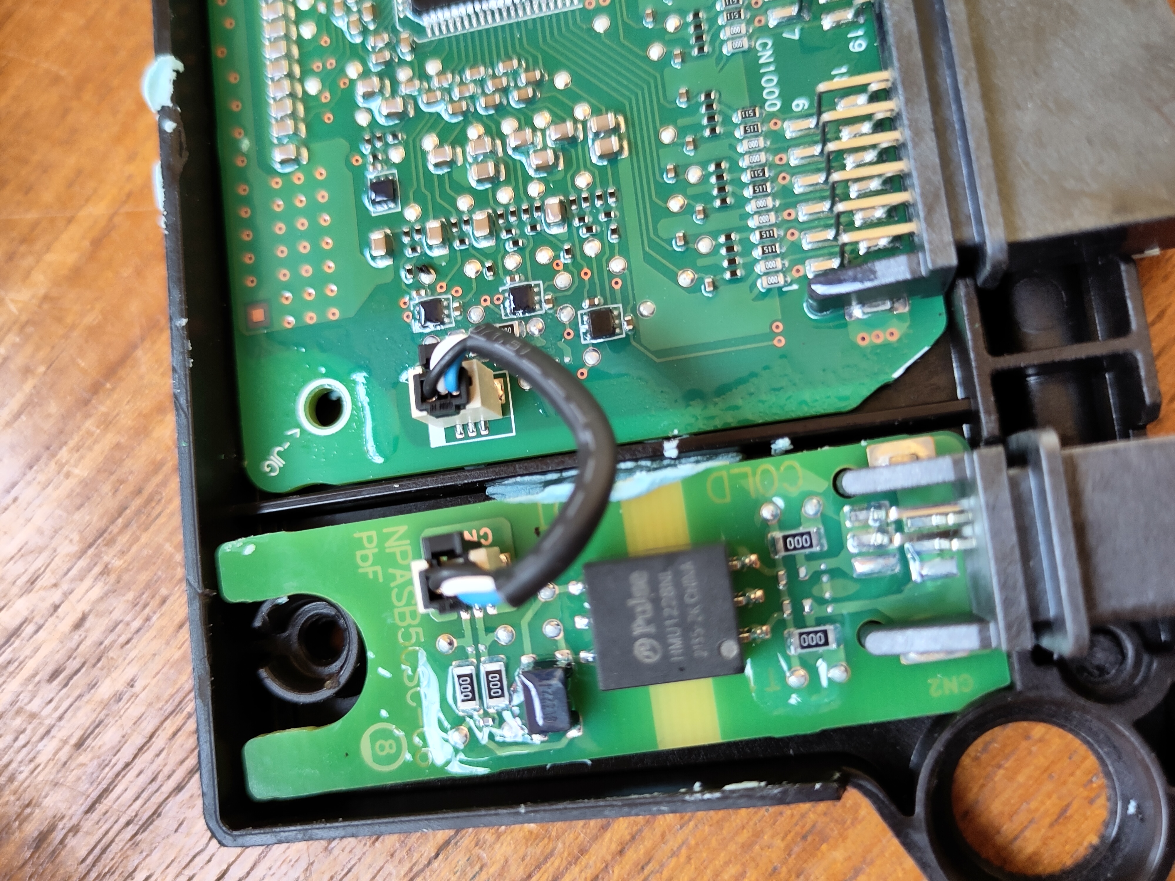

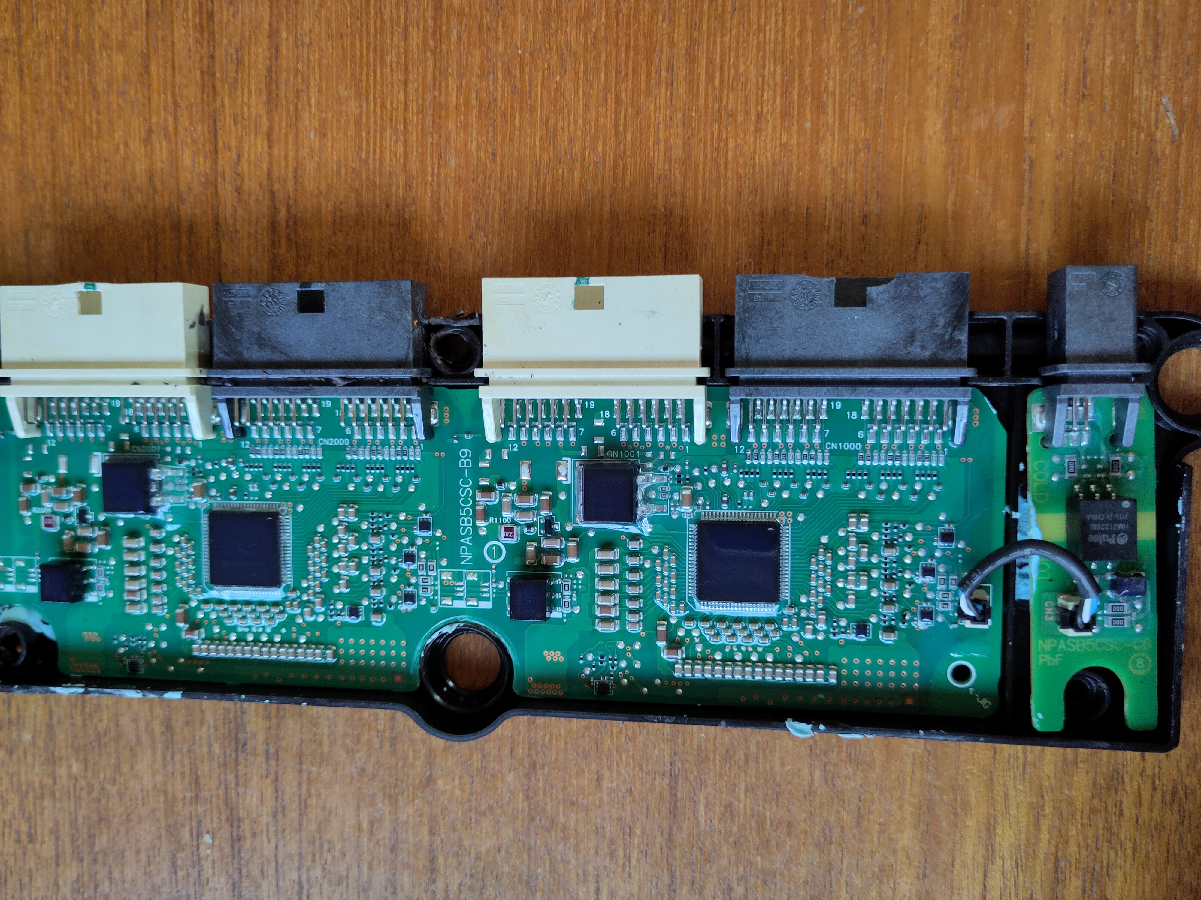

I opened the main CMU, it is glued but not to hard to open.
It consists of a single COM port PCB, and two PCBs which read the cells. These two PCBs actually consist out of 3 PCBs onto one PCB.
Everything is connected through with 4 wires. So most likely 2 wires for communication and 5v and GND.
The main chip is Panasonic AN84912UA 12584040, 6 times.
Here is a PDF Datasheet of a comparable one, though it only manages 10 cells instead of 16s.
https://www.datasheets360.com/pdf/954756336527486306
It mentions a 5v and 3.3v VDD. I think this is different from the NXP and TI solutions I have seen here before for reverse engineered BMS boards that aren't CAN.

that makes it a pain, as it will be Panasonics take on how to do ISO-SPI/ISO-Whatever.
So not directly reusable without reverse engineering it from a signal level.

What a wired BMS solution! I can't find any information about this chip.
Panasonic transferred its semiconductor business to Nuvoton. Now, there are some BMS chips:
https://www.nuvoton.com/products/batter ... qualified/
But these are new-generation chips, and of course, there is now a publicly available datasheet.
I'm sure AN84912UA uses ISO-SPI for communication and probably supports 20S cell configuration.
But it will require serious hacking without documentation.
In this case, being at the BMU level will be easier. I'm interested in seeing what the BMU looks like

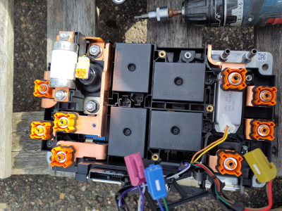

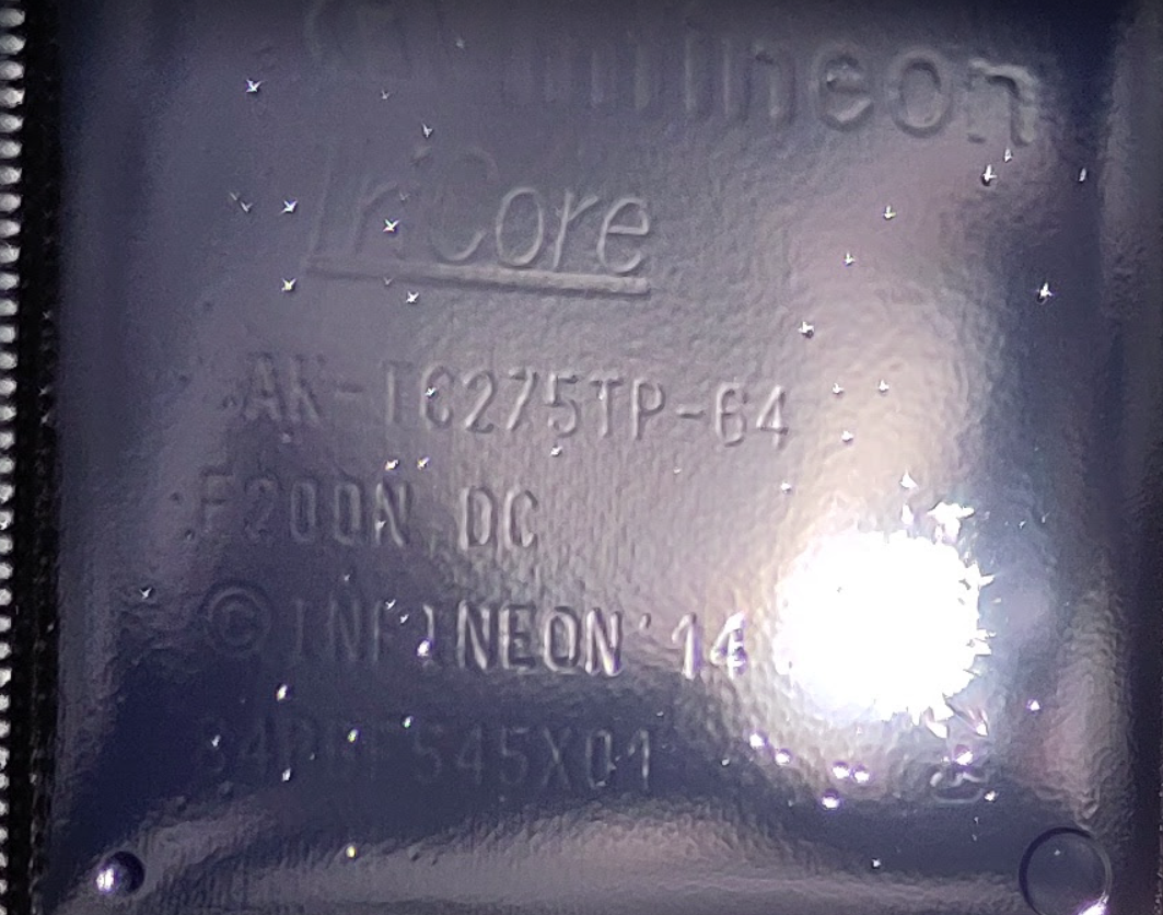

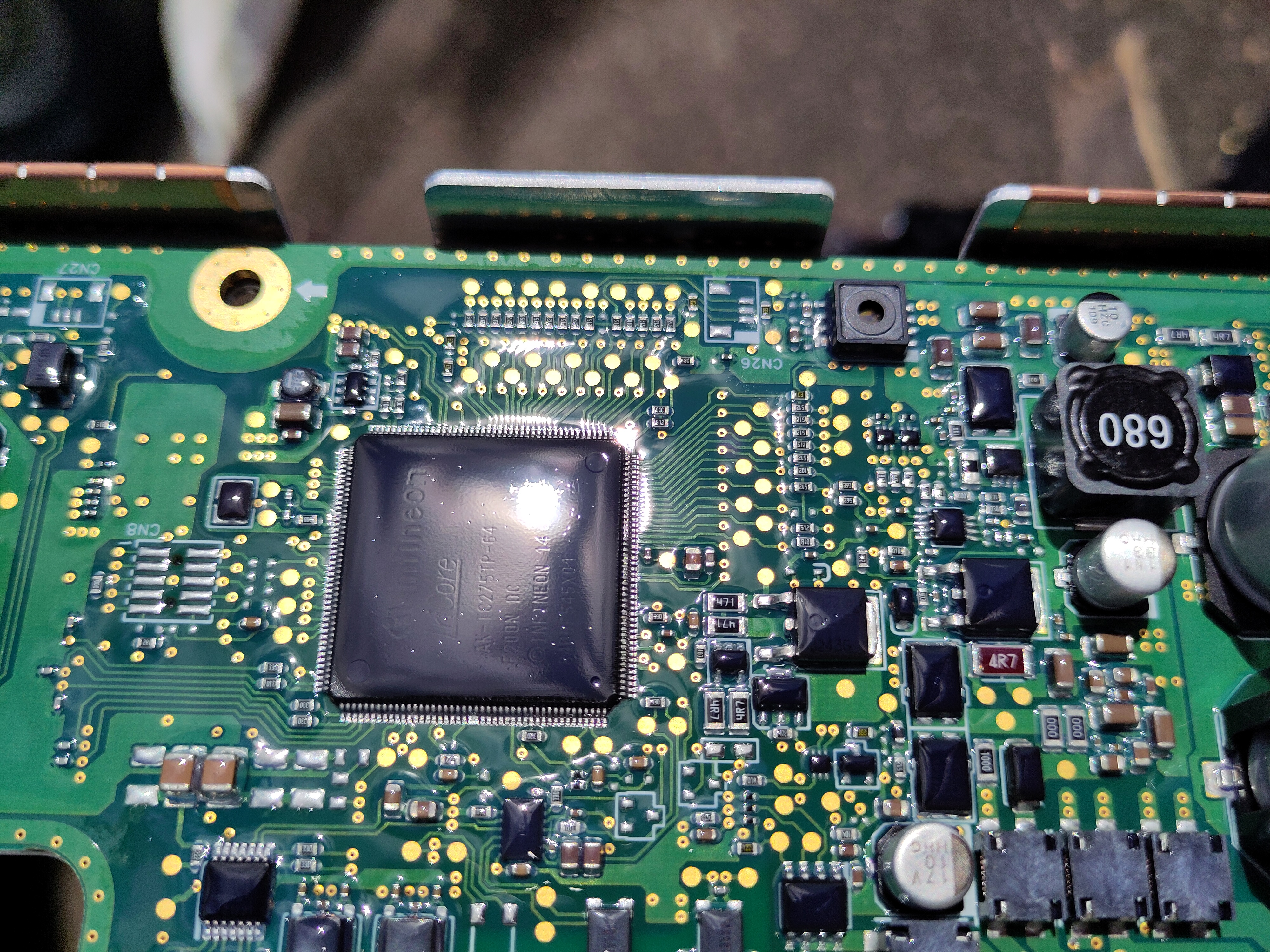

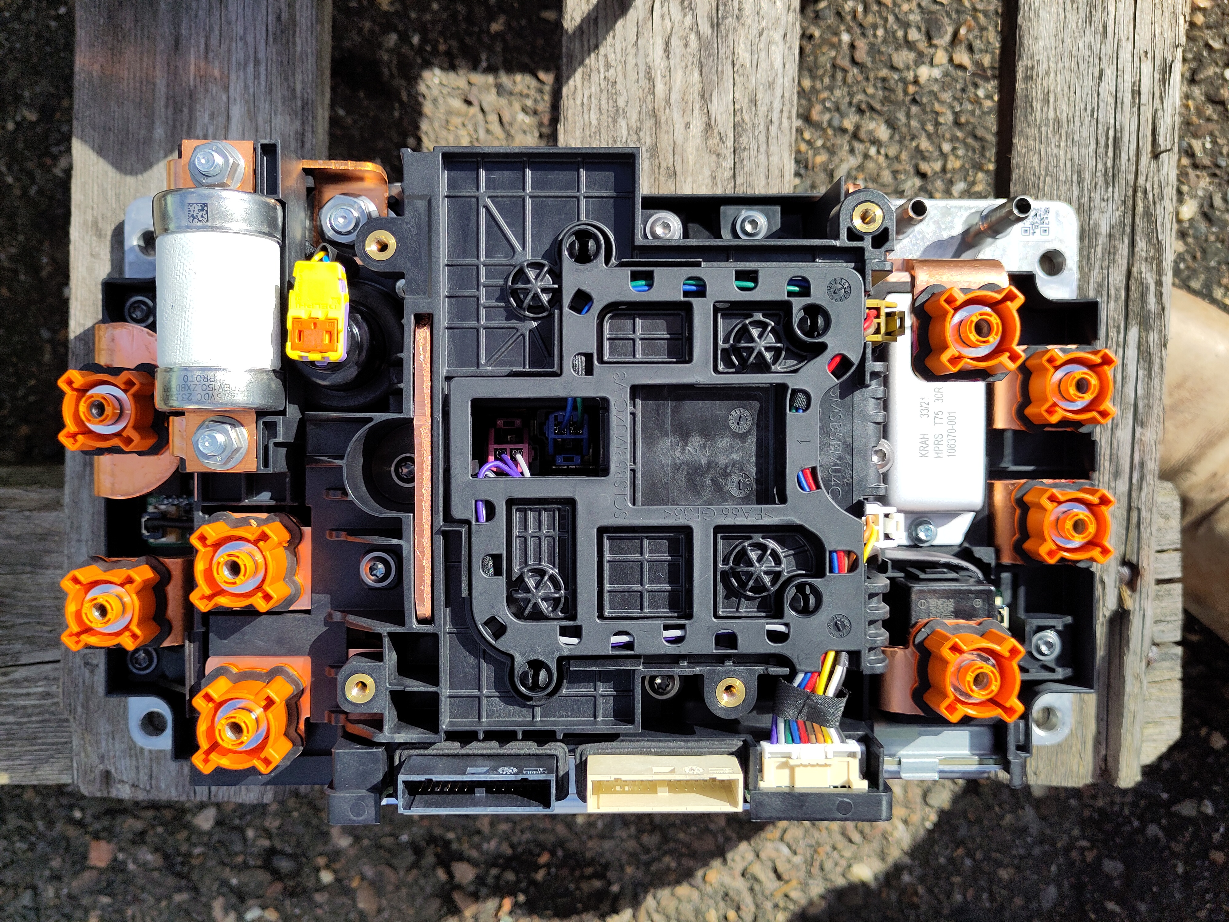

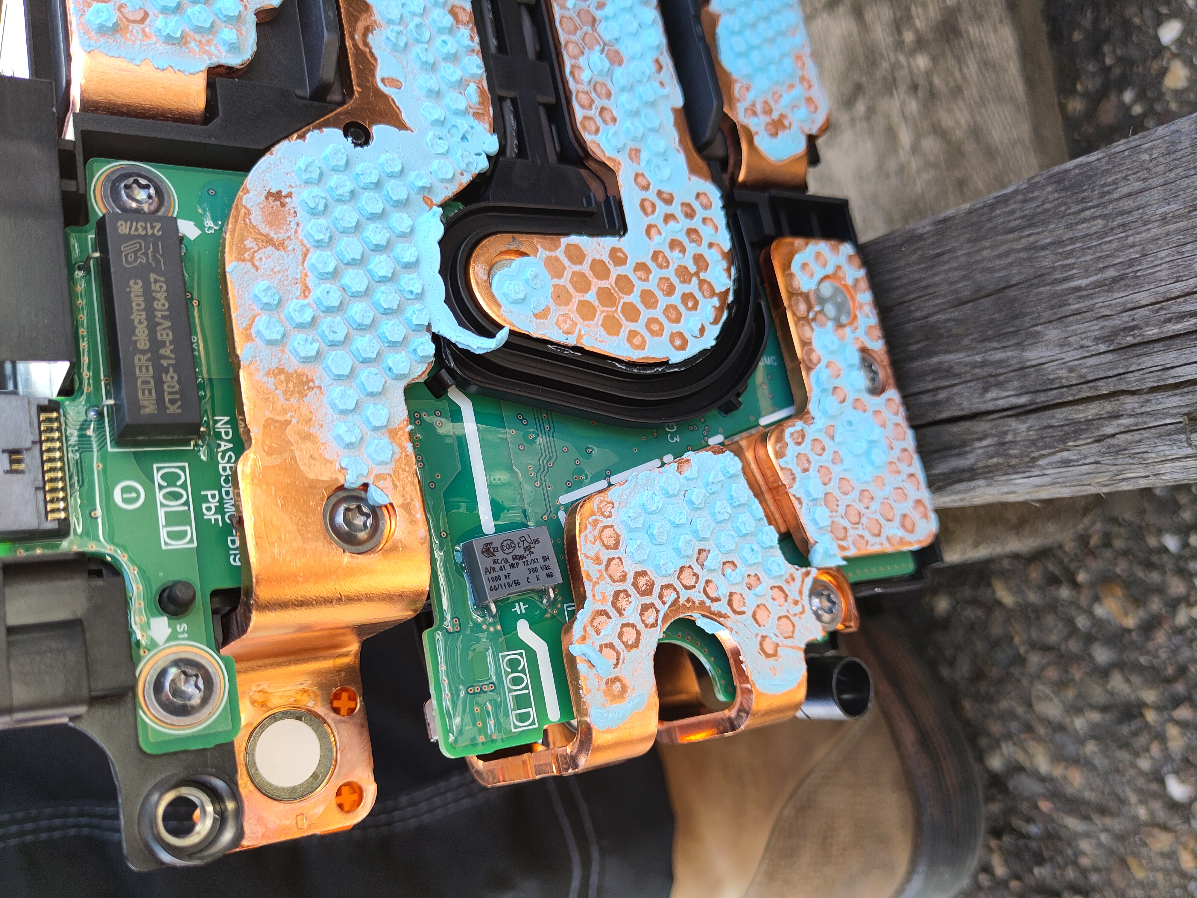

Ok so I opened the BMU. That should give some people some more clues.
I didn't do any power up and checking for communication or anything, just opening and taking pictures.
The BMU is on a liquid cooling plate.
It turns out the main BMU PCB has an Infineon tricore mictrocontroller on there. I guess that is not a very specific chip to deduct anything.
At this point it is probably more useful to try and power it up and figure out where the can bus is.
These 4 blocks are probably contactors...
The BMU seems to have a lot of high voltage connections, I think it has seperate charge point and drive point take of on it.
The bottom is also a PCB with major power lines on it.
I am assuming there are only measurement functions on there but haven't checked properly.
As can been seen, this part is liquid cooled
This is the main PCB where the only recognizable chip is the Infineon Tricore mcu
Here the full Infineon microcontroller part number
https://www.infineon.com/cms/en/product ... 4f200n-dc/
So, it seems this MCU talks to the Panasonic BMICs to get the cell data.
I think this BMU is pretty complex and specific, and not common enough, to put in a lot of effort to reuse as a whole.
But, if there is an easy way for it to dump the cell values, it could be convenient.
I don't have a proper (usb) scope for that to check the SPI bus, and I don't know where to apply 5v or 12v

By the way, these are the temperature sensors, two per module.
I haven't tried much other than to measure resistance over pins that weren't giving any cell voltage (so they must be sensor related) but I could measure any resistance value over any combination.
So probably something digital or something to apply a voltage over?
I think these sensors are NTC, probably 10k. They are used widely for temperature measurement in batteries.
Regarding Infineon MCU, I've seen the same in Pegout e208 BMU. In that implementation, the BMS gives much information, including cell voltages. More info in this thread: viewtopic.php?t=2675
But I can't guarantee that both BMUs are similar. We must see some CAN traffic. This will require powering the BMU and sniffing the CAN bus.
I'm struggling with the pinout. The CAN bus was very quickly found, a twisted wire and measuring 120 Ohm.
There are enough indications of what 12v+ is, the ground perhaps also, but probably needs a wakeup / key on kind of extra signal.
I'll post some pics later
Well, these are the times I notice I am a software engineer
But it seems that the positive and negative are not that hard.
This is the PCB of the low voltage connector on the front of the pack.
Below is the connector outside the pack.
There is a copper part sticking out that had connection to the battery pack casing, but it is not connected (directly) to one of the pins. So it doesn't seem to be 12v ground.
Anyway, there is a bigger component that is connected to two groups of 3 pins each. That clearly seems to be 12v positive and negative.
The pins are combined on this PCB.
On the main BMU PCB they are not combined, there they have seperate paths.
Here, on the main BMU PCB, you can see the 3 wires coming on on the top left (now on the white connector). No longer combined, but on the other PCB they are.
These 3 wires on the top left are colors RED, BLACK+RED and BLACK+BLUE.
The other wires are all a variant of BROWN, which is a common color with BMW for ground.
So that seems to make sense.
I am not at the battery pack anymore, but it seems I should have probably connected at least 3 pins to 12v+ and 3 pins to 12v ground.
I had 5 at most. So that might explain something.
But, I probably will still need to apply 12v to some other pin as well for an ON signal.
