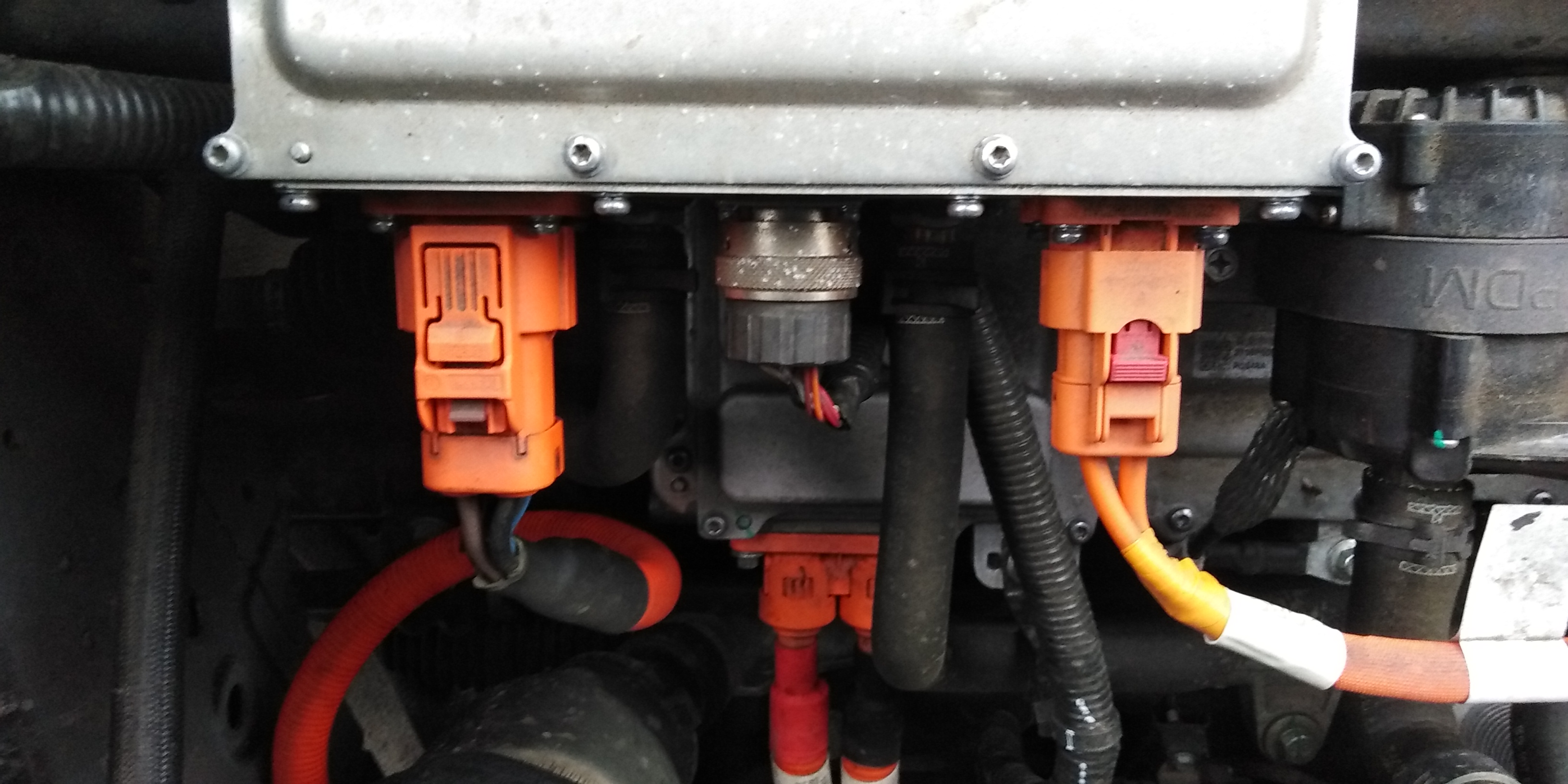

I found my fathers Seres 3 features what is probably the 3-phase version of the MG charger that Damien recently hacked. If so it is an 11 kW charger, DC-DC converter and V2L inverter.
Would be a nice upgrade for Touran. Can't find it on ebay or brukdel though.

Oh, DC/DC is separate then
Re: WtB: DFSK/MG 3-phase Charger
Will be nice to add a wiki page about MG ZS Chargers, part numbers etc. Seems this one is applicable in many cars. I'm really considering this onboard charger for its capabilities size and price.
Yes, looks much like it!

Interesting. Says nothing about V2L but it's nice that they also support 32A single phase
The AC connector in the document looks different than on the charger above.

Same one as in the photo by Tomas and also 6.6 kw version available for sale from MG
I think that's the one Damian hacked. But single phase is pretty much useless on the main (3phase) land

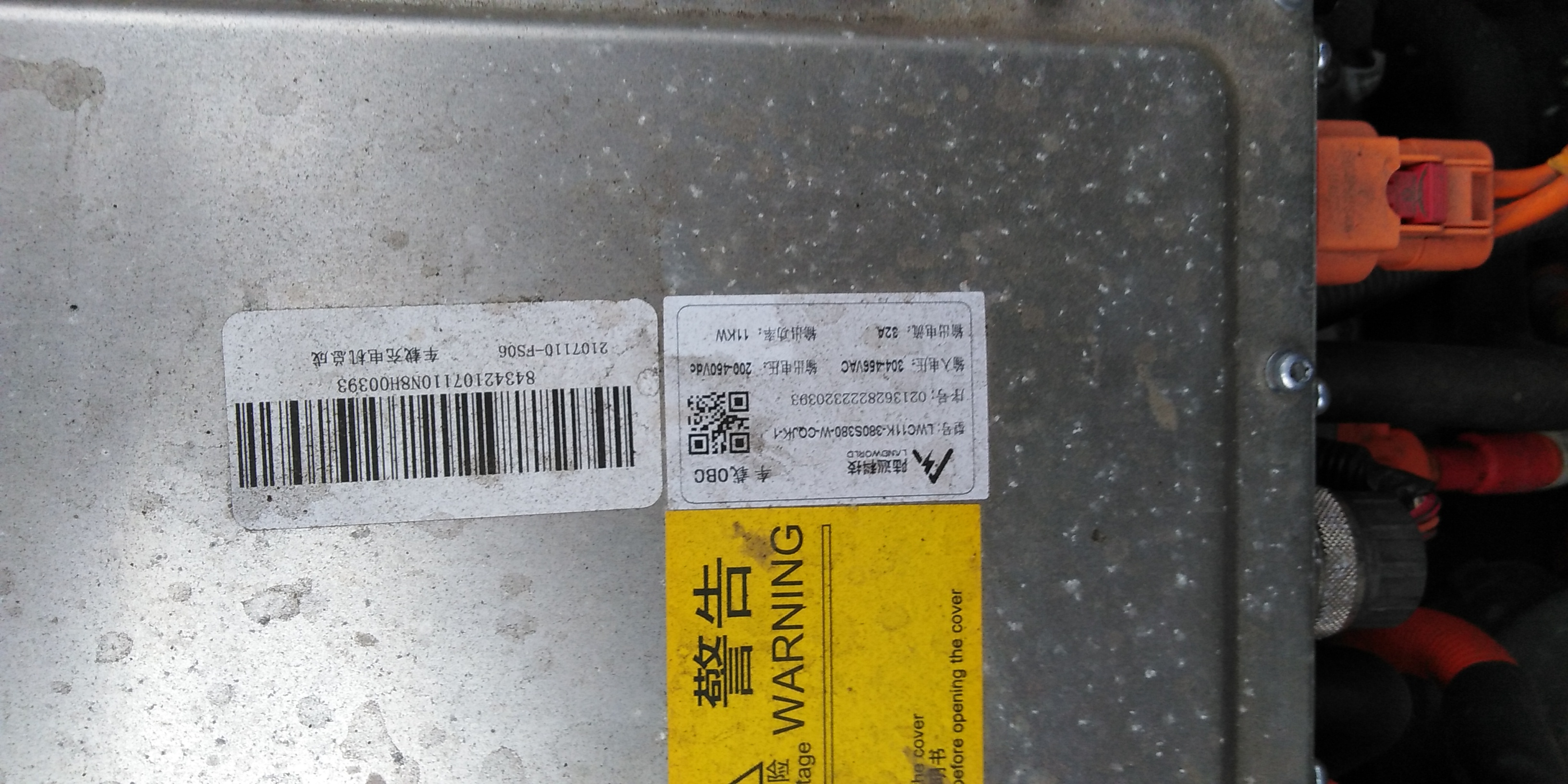

Got the 11 kW one from Sweden
Are you willing to disclose the price and your source ? I would also be interested to buy one.
It was found here: http://www.bildelsbasen.se/
I payed roundabout 500€ delivered from Sweden
Now I'm searching for the plugs which turns out harder than I thought.
Part numbers HVC5P63FSX06 (input) and HVC2P28FSX04 (output)
