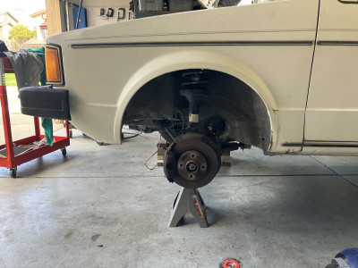

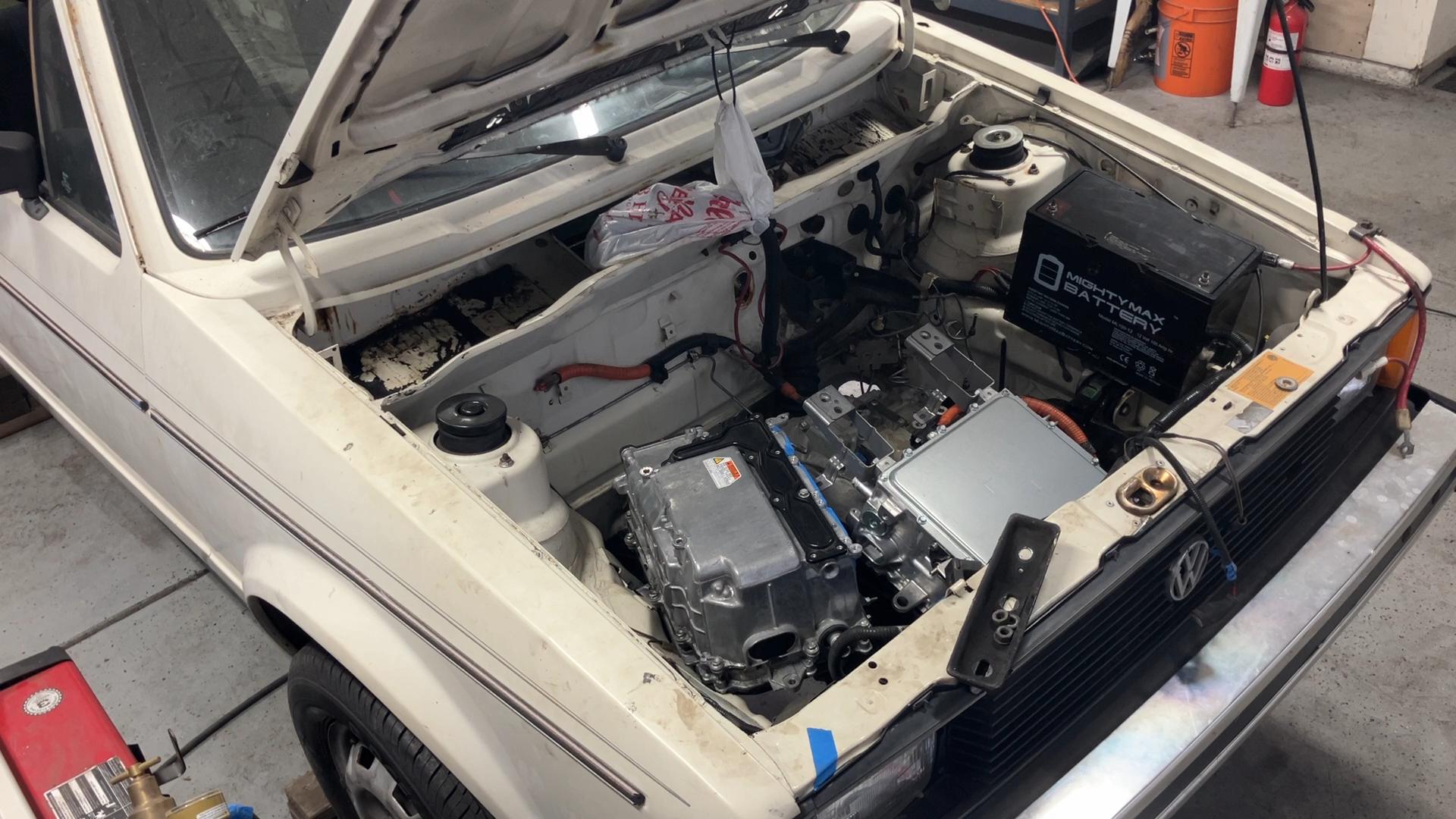

84 VW MK1 Rabbit DIY EV Conversion - Front End Height
If any of you can recommend some adjustable shocks/springs I would really appreciate it.
Project Counter: Day 57

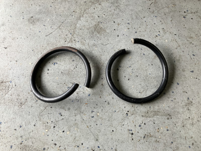

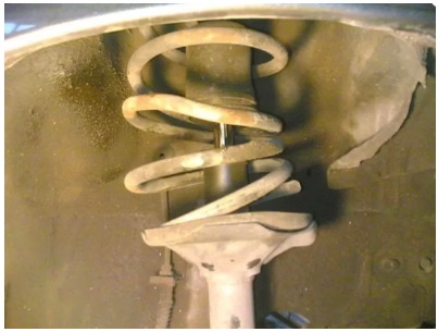

I'm not sure that cutting springs was the correct solution here.
I'm fuzzy on it, but, IIRC cutting springs does 2 things:
1 - For the same weight on the spring, it starts lower. Obviously, as you cut a ring off.
2 - For the same weight on the spring, it's stiffer (17% stiffer in your case, because you removed 17% of the spring).
So you're starting lower, but you're also going to sag less under weight than you were. And it'll travel less as you move.
This means cutting springs is an okay solution to when you want the same car to just be lower to the ground (it makes it a bit stiffer, but it would have to, since you're lower to the ground you don't want it bouncing down as low as it used to, it doesn't have enough clearance anymore). But it's not a great solution when you change the weight of the vehicle and want it to ride the same as before (much less common). To do that you need softer springs, which I think means springs made from thinner cross section.
Don't take that as gospel. Every time I hear this described it's easy to justify anything in my head. So much bro-science. But that's my best impression.
https://web.archive.org/web/20210604061 ... ng-springs
It's hard to find advice on what to do with springs when you lighten a vehicle's load, because almost no one's doing that. They're lowering because they want the same car to ride lower.

thanks Matt I appreciate it, I know this fact, if you ask 3 car guys a Suspension Question, you will get 5 opinions, lolMattsAwesomeStuff wrote: ↑Tue Mar 05, 2024 10:00 pm I'm not sure that cutting springs was the correct solution here.
the bottom line is this car is a P.O.S. and if the ride is too stiff nothing stops me from replacing these with some aftermarket adjustable "thinner" spring ones, right?

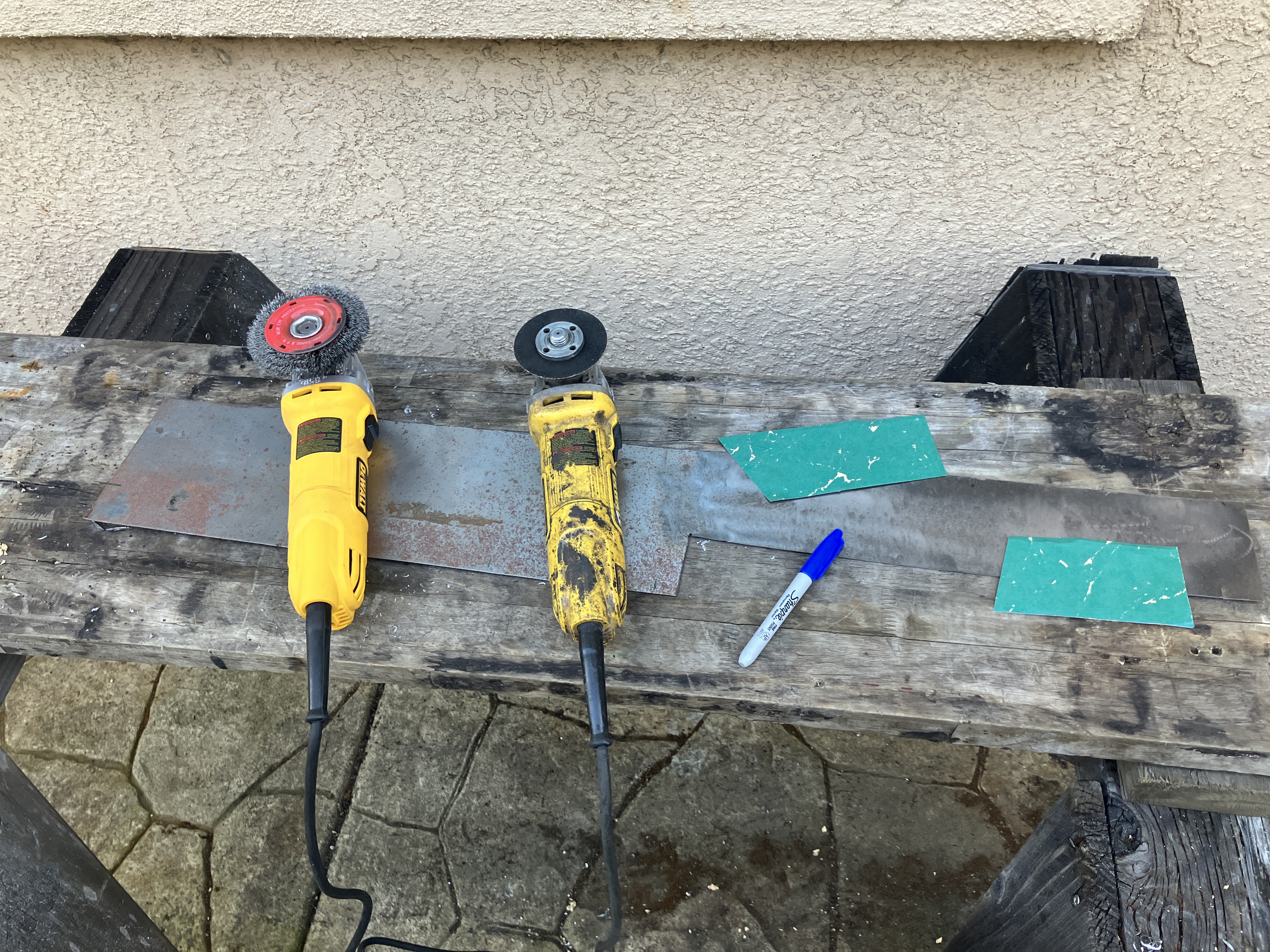

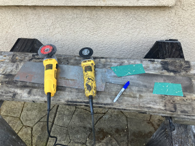

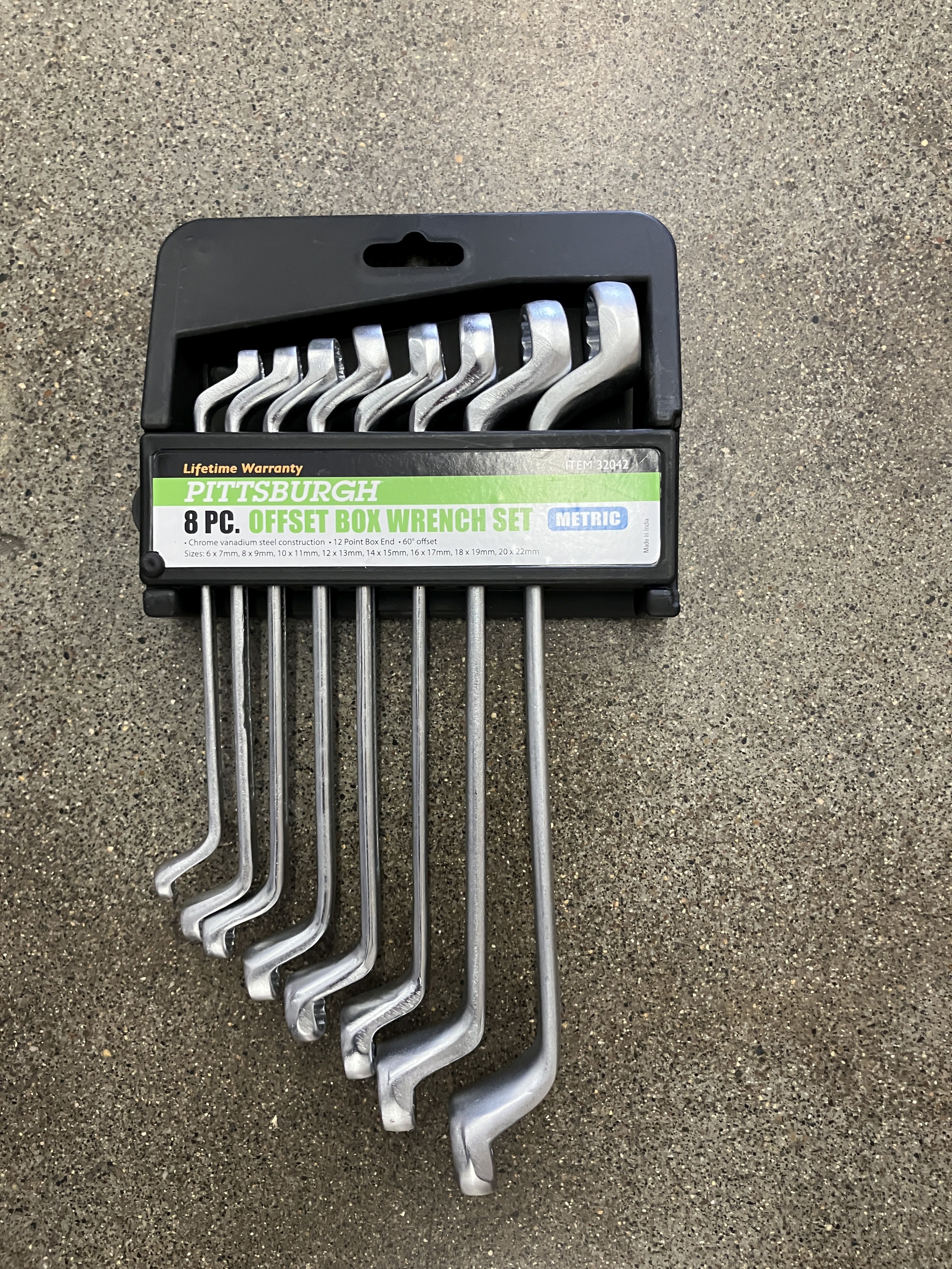

you ever had to buy a whole pack of tools just for one tool ?
Re: 1984 Voltswagen Rabbit Prius Gen 3
Cutting springs gets a bad rap, but its one of those "it depends" things.
Some springs like those shown here, are parallel at one or both ends. Cutting those (on the parallel end!) is generally fine, and it can work fairly well. As above, you end up with a shorter spring and a little bit more spring rate, generally pretty much exactly what you want for mild lowering. An old car like this is probably very softly sprung anyway and a bit more stiffness is a good thing. Ofcourse you cant get the exact spring rate and starting length that you might need.
Also, if you go too far the one issue that can occur is the spring ends up loose at full damper extension, which is obviously dangerous as the spring can come out of the seat if the suspension gets unloaded over a bump or something. This is where the bad rap comes from, folks cutting off 2 or 3 coils to get the car slammed into the ground. The proper fix for that is either a shorter damper, or a progressively wound spring. That means the spring starts out soft, but is designed in such a way that as it compresses down, part of it becomes coil bound and the effective spring gets shorter with a much higher rate.
Many cars however have springs with a "pigtail" on both ends. If you cut that style of spring, it will no longer safely seat into the spring platform.

you absolutely nailed it here, I just want to add that on my truck which has aftermarket shorter springs (not ones that I cut) they tend to fall out of their cups/seats any time I jack up the front end, so you have to remember to reseat them properly when lowering the truck back down, this is one of the reason I want to try 2" drop spindles on that truck instead of 2" shorter coil springsAragorn wrote: ↑Wed Mar 06, 2024 3:55 pm
2" drop spindles and 2" springs should be the default for a C10
You can investigate shorter dampers or even limiting straps. Some modified 4WD's have springs that come out of the seats by design, but they have some sort of cone arrangement to guide the spring back into position when it comes back down.

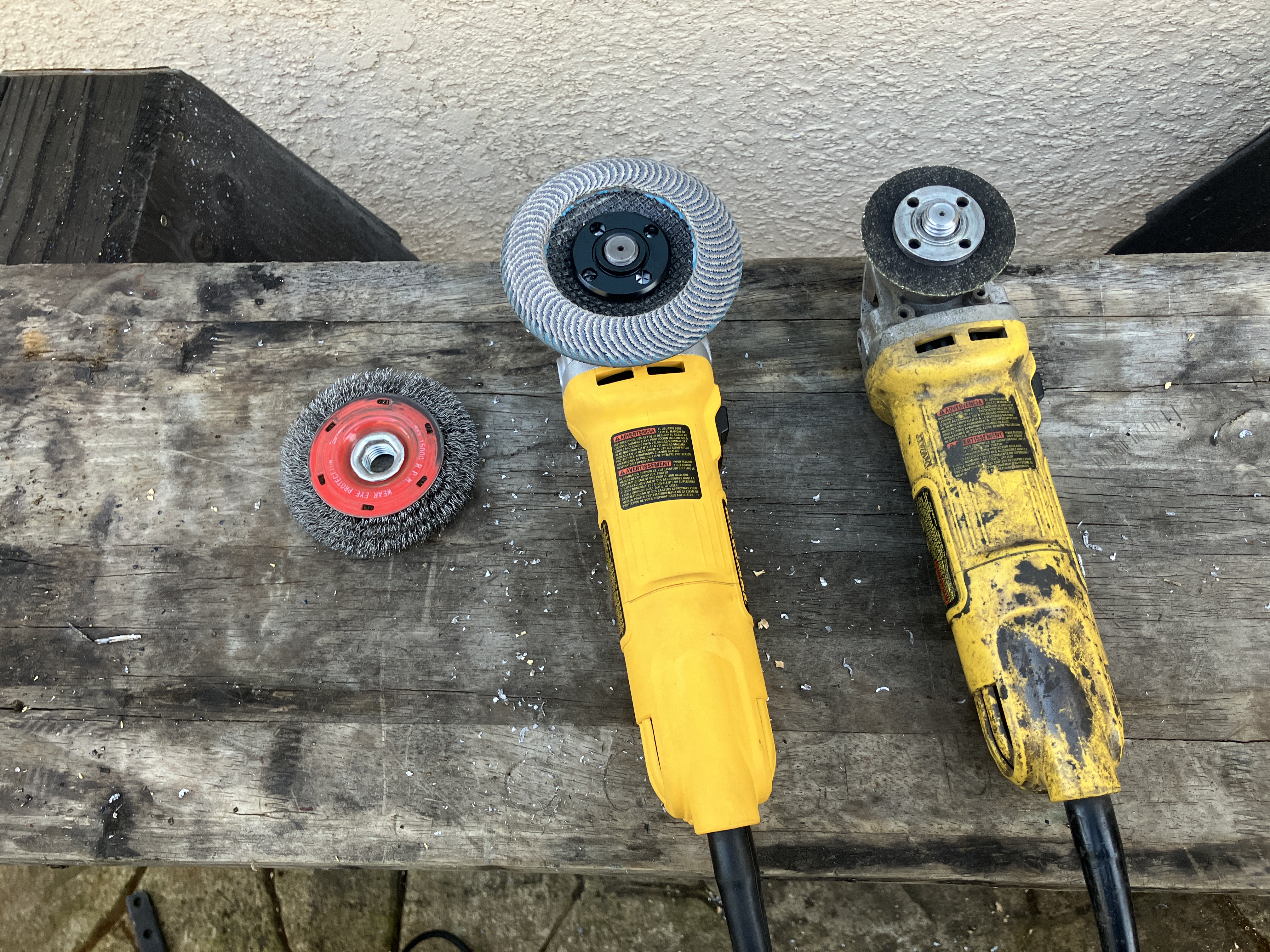

One grinder for cutting one for grinding. That's how you know you're really fabricating.

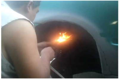

I am sorry to be late to the party...
In the old days (i am not that old) i remember autotuning folks saying how to cheaply lower the car.
You wrap the installed spring by moist rags and identify the spot where you must weaken the spring to get the chassis lower by an inch or so. Then you apply torch to heatup this spot to yellow and keep the rest of the spring wrapped and cooled. When you heat the spot on the spring enough you will see the spring letting go. Mind you this process is irreversibe as far as homeowner is concerned. But you keep your spring length and socket installation OEM.

Hello old man, I will speak up so you can hear us (jk) indeed that has been the Rite of Passage on American Low Riders for years (minus the moist rags) and don't ask me what they do to leaf springs, ha haarber333 wrote: ↑Fri Mar 08, 2024 5:59 am I am sorry to be late to the party...

Hmmm... could be thats why i feel like suspension vibrates 1/2s after i dove through a pothole. Or is it just old worn 1992 bushings... i will get back to you...

Heating the springs to the point where they bend will destroy the tempering of the spring significantly weakening it. Essentially heating something cherry red and letting it cool down slowly will anneal the steel. It's a very bad idea.arber333 wrote: ↑Fri Mar 08, 2024 5:59 am You wrap the installed spring by moist rags and identify the spot where you must weaken the spring to get the chassis lower by an inch or so. Then you apply torch to heatup this spot to yellow and keep the rest of the spring wrapped and cooled. When you heat the spot on the spring enough you will see the spring letting go. Mind you this process is irreversibe as far as homeowner is concerned. But you keep your spring length and socket installation OEM.
