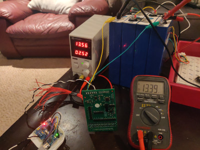

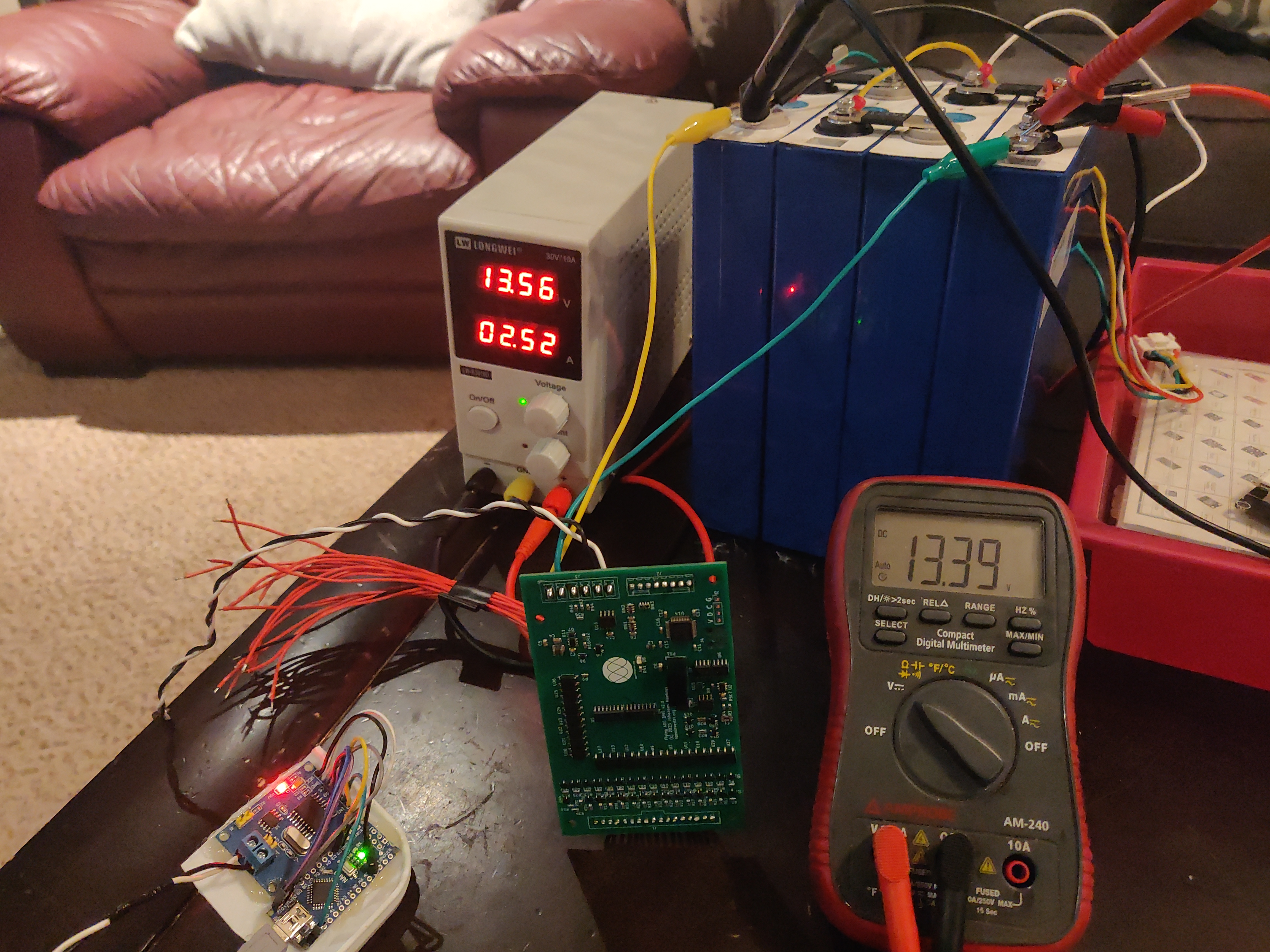

Hey Johannes
I do not have the BMS powering up. I am giving it 12v. + is connected to 12v and - is connected to ground.
Been thanked: 1914 times
Re: Switched ADC BMS
12V enable
Proton
Posts: 366
Location: Georgia/US
Has thanked: 227 times
Been thanked: 57 times
Post by Proton »
So do I have to connect 12v+ from 12v+ to enable and leave 12v- connected to ground?
Yes 12V (pins 1 and 2) is permanent and pin 3 enables the device. It must be pulled to > 2V
