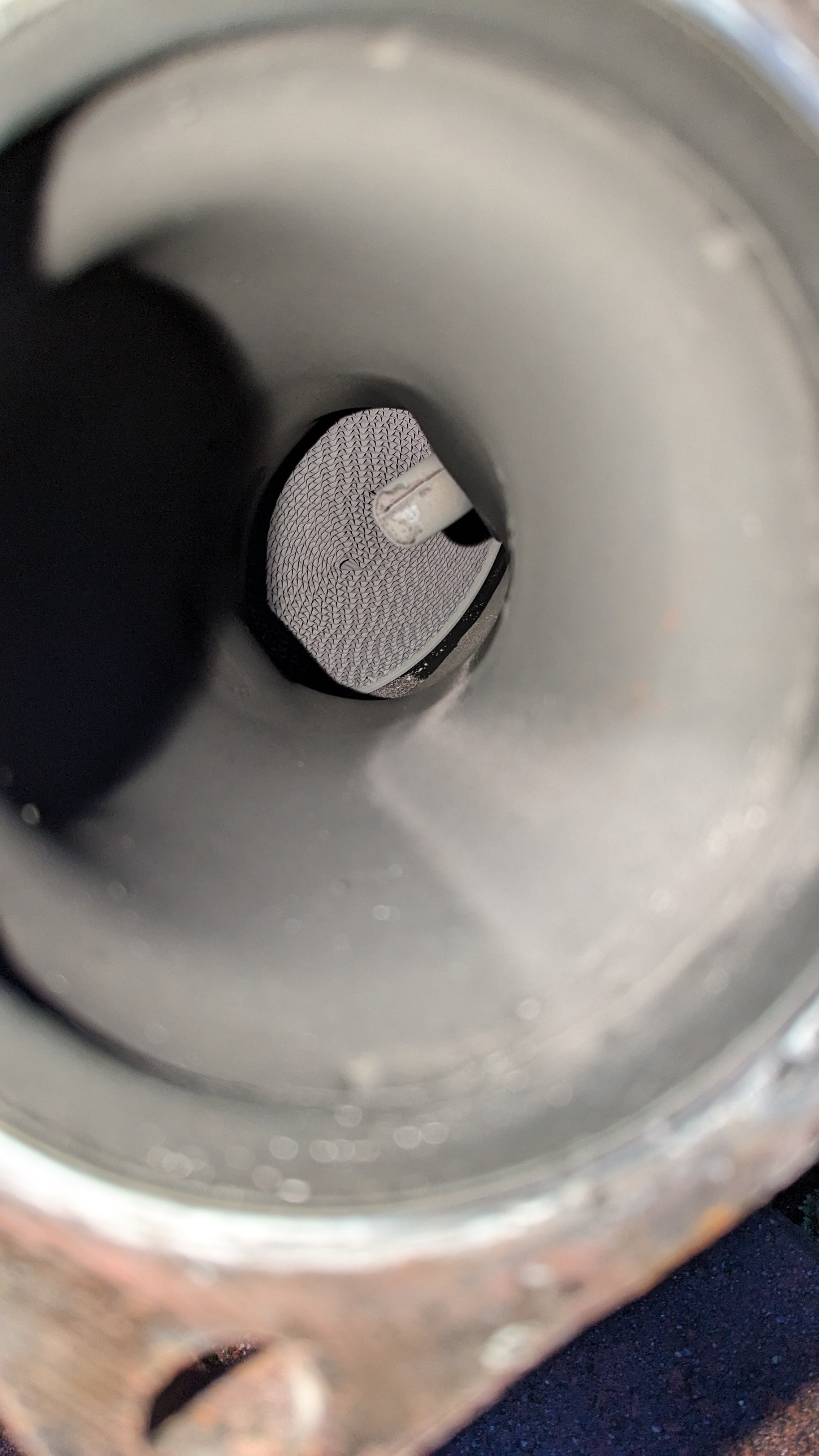

Today we got busy and took out the fuel tank and exhaust system. The latter was quite challenging because the screws in the clamp connecting the catalytic converter to the muffler were rusted beyond recognition and the rear exhaust pipe was welded to the muffler at some point. Even the small piece of pipe for the exhaust tip was rusted solid, so we had to maneuver it above the rear axle.
Maybe the catalytic converter can bring some cash back to the project as it is still intact and the matrix is still present :)

But the reason for the procrastination was my other Volvo, which needed a new exhaust (yes, it would actually need an EV swap, but for now that's not feasible). And the exhaust replacement was sponsored by Damien's favorite RUST, which made this take three days instead of a couple of hours...
