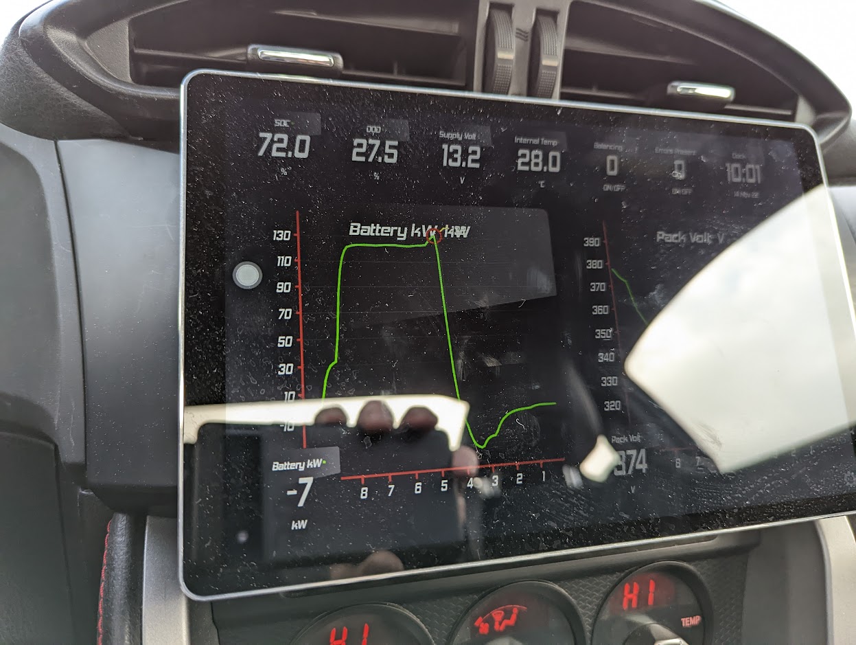

Meanwhile i changed the inverter to a 160Kw inverter and i now control the inverter solely by canbus and not over the openinverter board anymore. Johannes programmed the code for me in my ECU and now the car runs very smooth now and alltough it just deliveres 125kw at the moment it is faster than before.
That is because it keeps the 125Kw throughout the whole rpm range. The new wiring loom i made out of a GEN3 Loom and GEN2 Loom: Looks almost like before, but it is a direct swap for the GEN2 inverter

Very nice. Leaf code was "borrowed" from Zombieverter, it ported to the F4 without changes.
Have you limited to 125 kW or the VCU code?
