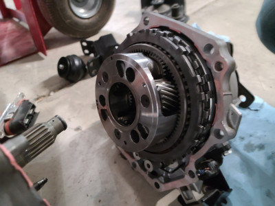

I apologize for neglecting this thread! I am just picking up this project again. I just fetched a 2007 Tundra for sub $1k last week! I was about to use a 2005 Cayenne for the project but a 4x4 pickup truck is my preference... Next week, I should be able to test fit the JF1A transfer case shaft on my L110F transmission output shaft (When I realized the L110 was a no-go, I bought a L110F). I still need to go through the L110F tail housing to see if I can easily mill my own and transfer L110 tail housing Pawl assembly into it (that and the output shaft speed sensor are essentially all that are in the tail housing) to sell people, to expand the supply of 4x4 capable L110 gearboxes... it may me more difficult/expensive than what would be feasible, especially since the output shaft is not the same as the L110F either. I have the ability to cut splines/gears with 4 axis cnc milling but I don't have the ability to harden/temper my own parts.
Attached are my photos of the internals of the L110 / GS450h transmission tail housing (circa Jan 2021 - I didn't think to post them or check this thread at the time, sorry).

What I'd love to see is adapters for different propshaft flanges to the exg spline on the gs450h. Any chance you could measure the gs450h output shaft splines for me? Major diameter, nope diameter and number of teeth I guess. Thanks

Re: Connecting a GS450H to an existing Transfer Case?
I already posted the number of teeth and major diameter 4 years ago: viewtopic.php?p=11390#p11390Jacobsmess wrote: ↑Sat Jan 13, 2024 7:49 am What I'd love to see is adapters for different propshaft flanges to the exg spline on the gs450h. Any chance you could measure the gs450h output shaft splines for me? Major diameter, nope diameter and number of teeth I guess. Thanks

Only got the number if teeth there from what I can see but useful nonetheless... Although unfortunately the rest of your post suggests it's unlikely I'll find a replacement flange with my required bolt spacing.celeron55 wrote: ↑Sat Jan 13, 2024 1:17 pm I already posted the number of teeth and major diameter 4 years ago: viewtopic.php?p=11390#p11390
The diameter is in the photo with the calipers. The sealing diameter also.Jacobsmess wrote: ↑Sat Jan 13, 2024 4:45 pm Only got the number if teeth there from what I can see but useful nonetheless... Although unfortunately the rest of your post suggests it's unlikely I'll find a replacement flange with my required bolt spacing.

Glad to see you back at this project! I am also using the LS600H transmission in my build and would be interested to see if there is another transfer case compatible with the stock transmission that is not full-time AWD to help improve range when AWD is not needed.TinkerTan wrote: ↑Sat Jan 13, 2024 5:46 am I apologize for neglecting this thread! I am just picking up this project again. I just fetched a 2007 Tundra for sub $1k last week! I was about to use a 2005 Cayenne for the project but a 4x4 pickup truck is my preference... Next week, I should be able to test fit the LF1A transfer case shaft on my L110F transmission output shaft (When I realized the L110 was a no-go, I bought a L110F). I still need to go through the L110F tail housing to see if I can easily mill my own and transfer L110 tail housing Pawl assembly into it (that and the output shaft speed sensor are essentially all that are in the tail housing) to sell people, to expand the supply of 4x4 capable L110 gearboxes... it may me more difficult/expensive than what would be feasible, especially since the output shaft is not the same as the L110F either. I have the ability to cut splines/gears with 4 axis cnc milling but I don't have the ability to harden/temper my own parts.

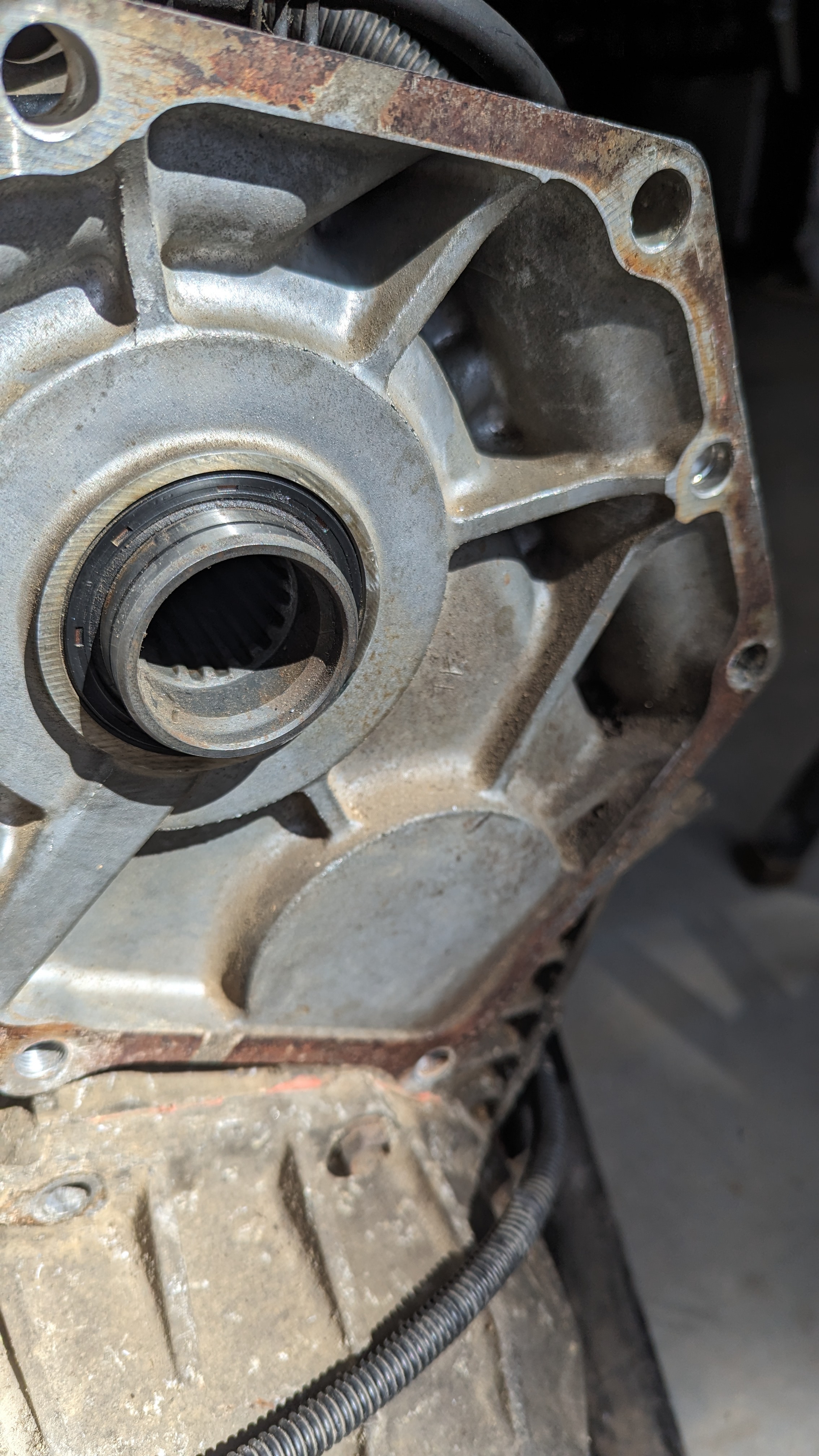

I have found a shaft seal which should suffice for the L110F output shaft (seal around the OD of the female splined JF1A input shaft), though it is 1mm short and will sit recessed as much in the seal bore. The ID and OD match. The 710407 (Timken and National Oil Seals) is the only seal I could find which would work and I had to buy a couple on ebay, as they are backordered everywhere else I looked. I will update the forum on the shaft seal fitment when they arrive.
Seal Update again 7/11/2024. The 710407 did not work out. I tried a couple other shaft seals that also did not work out. I found one seal that is quite a tight fit (1mm too small on ID) but it does seal. Corteco 23121282458, for various BMW transmission output shafts. So far, that's the only off the shelf seal I've found that would work.

Regarding the shaft seals:
JF1A input shaft seal - kept OEM, did not need to change
L110F output shaft seal - a larger ID seal was necessary, since the JF1A shaft sealing surface has 51mm OD instead of 48mm. I could not find an exact fit shaft seal, but I found one that works well enough and is a tight enough fit in the L110F output shaft seal bore. It is the Cortico 23121282458, which is used in BMW trans output shafts. All others I tried that fit the shaft did not fit snugly in the bore and did not seal. This one is 1mm too small on the ID (50mm, the tcase shaft fits pretty tight). This is the best solution I could find that is not a custom seal (it would require a 62mm OD, 51mm ID, ~8mm height (although 9-10mm would only help it sit tight in the bore. There's like 15mm of bore height. The OEM seal does not sit all the way in the bore, it sits flush).
Although I set aside my 3D modeling and machining of the adapter to more quickly cut and weld an adapter together, I do plan to return to that soon, in order to end up with a stronger tcase adapter and to be able to provide you all with an adapter solution for 4WD with the L110F (with JF1A or JF3A).

In the mean time - here is a shot of the back of an A442f Auto trans which mates to the HF2A transfer case in a 100 series landcruiser. The pic shows that the output shaft of the A442f trans appears to be the same as the output shaft on the 'extension' section of the L110f.
Note, the output shaft on the L110 (GS450H) with the tail section removed does not appear to have the same spline count and would not mate to a HF2A (refer images from previous posts above).
Hope this helps someone.

I finally unearthed my HF1A case and introduced it to my L110f.
https://photos.app.goo.gl/TPJhsGkttbBnSQpf7

Hi Herb
Thanks for the video. Unfortunately, I am still a few months behind you so I can't help with a dxf file.
How did you find the mating of the shafts between the L110f output and the HF1A input spline?
i.e is the output shaft on the L110f long enough to make a good connection with the input spline of the T-case?
Cheers
It looks like there's enough spline engagement if the face of the tcase is touching the face of the transmission. The seal surface sticking out of the tcase also slides perfectly into the seal on the transmission and looks like would even wear in the same place as it did when it was connected to an H55F. So I estimate roughly the same spline engagement as in the 3B use case (and 1HZ/H150F which is how I'd used it previously). My old 1HZ/H150F/HF2A combination with 4.10's, 35's and 27psi boost never had a problem.TongueTester wrote: ↑Wed Apr 23, 2025 2:26 am How did you find the mating of the shafts between the L110f output and the HF1A input spline?
I'll measure the actual spline engagement.
The real problem is that I think there's not enough room for an adapter plate while maintaining enough spline engagement.
Here's the two faces mated up. I haven't really clocked the transfer case relative to the transmission to check for driveshaft clearance It looks like it might just clear those oil lines or whatever they are. (in all these photos, I have the tcase pulled away from the transmission around 3/4").
I just did some more digging and learned some things. Apparently the HF1A came with a number of different input gears and the spline configuration is slightly different depending on whether it was originally behind an R151F or an H15xF. https://forum.ih8mud.com/threads/differ ... es.912806/
So just to confirm, this particular HF1A (in the above photos) came from the back of an H151F and it's these splines that match up with the L110F transmission. The HF2A which came behind the automatic transmission of an FZJ-80 should also have the same splines since that was the one I used behind my H150F. I hope that's just the right amount of confusion.
If your HF1A came from behind an R151F as seen in the Tundra apparently, the splines will not fit the L110F though according to the thread above, you could change the input gear to 36212-60120. YMMV.
