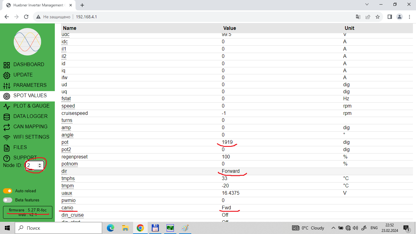

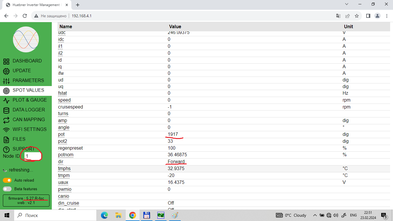

The "pot" and "pot2" parameters are not saved on both controllers (that is, Rx and Tx) after a power failure. Before the power is turned off, everything works and the slave controller receives messages identical to the master. Is this a feature of the firmware? Or am I doing something wrong? I haven't tried it since 27.
Image MG2
Image MG1
Posts: 6716
Has thanked: 369 times
Been thanked: 1544 times
Re: Inverter Firmware 5.32.R
Indeed 5.32 removes any mapping from pot and pot2, even TX mapping. That should be changed. So 5.27 on both sides. You need to hit Save to Flash to make mappings permanent

johu wrote: Fri Feb 23, 2024 9:19 am That should be changed. So 5.27 on both sides. You need to hit Save to Flash to make mappings permanent
Yes - everything works with the previous firmware. The settings are saved.
MG 2 sends
MG 1 receives
But nothing is displayed in the CAN map. But this seems to be a problem in the web interface. In the old (gray) mode, all CAN data is visible.
