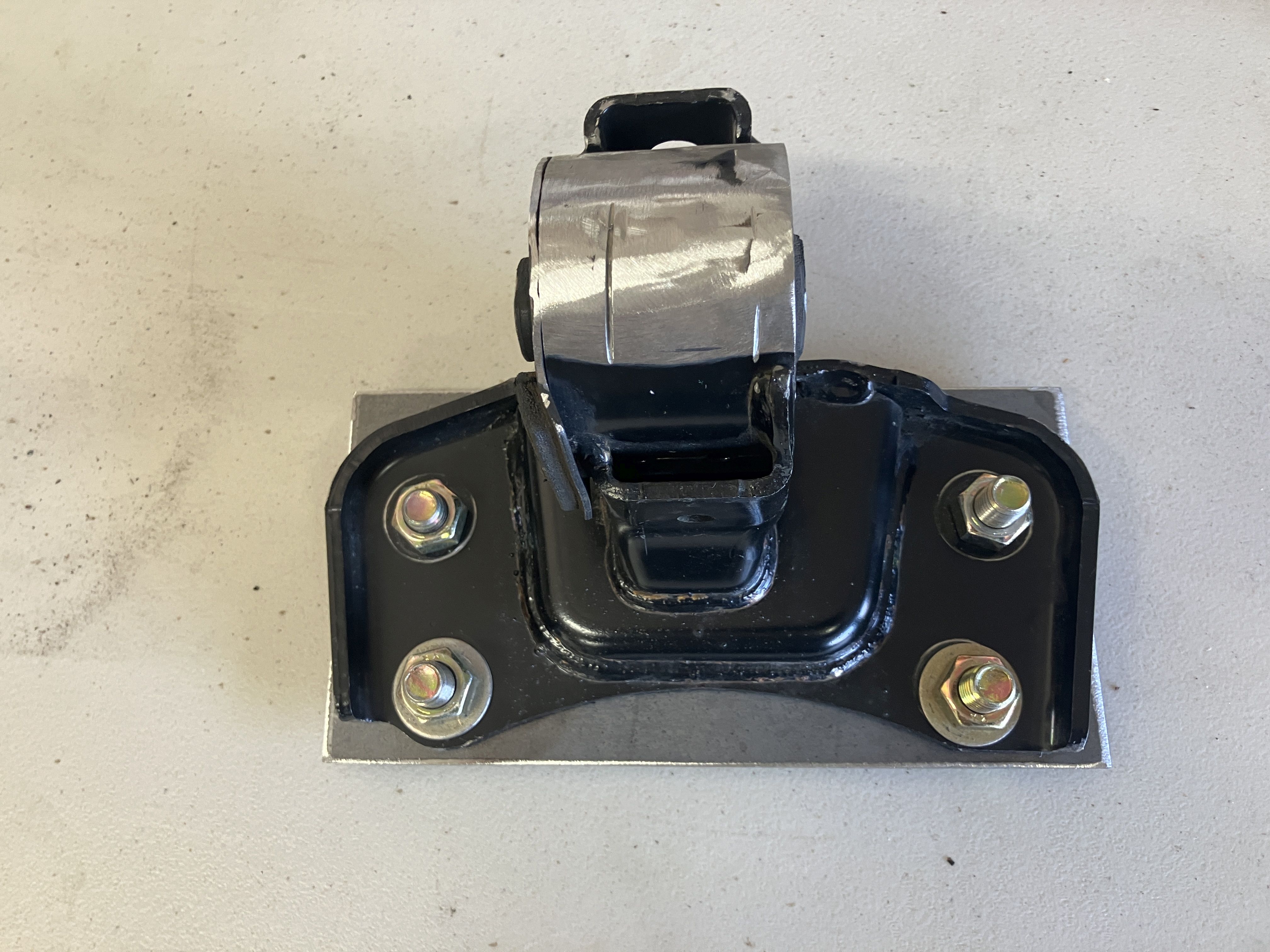

let's take a look at some pics of the "bell housing" rubber mount and the temporary rigid radiator core support bracket
yes I am a sh!ety fabricator but also everything is cattywampus on this car
I later remade the one below:

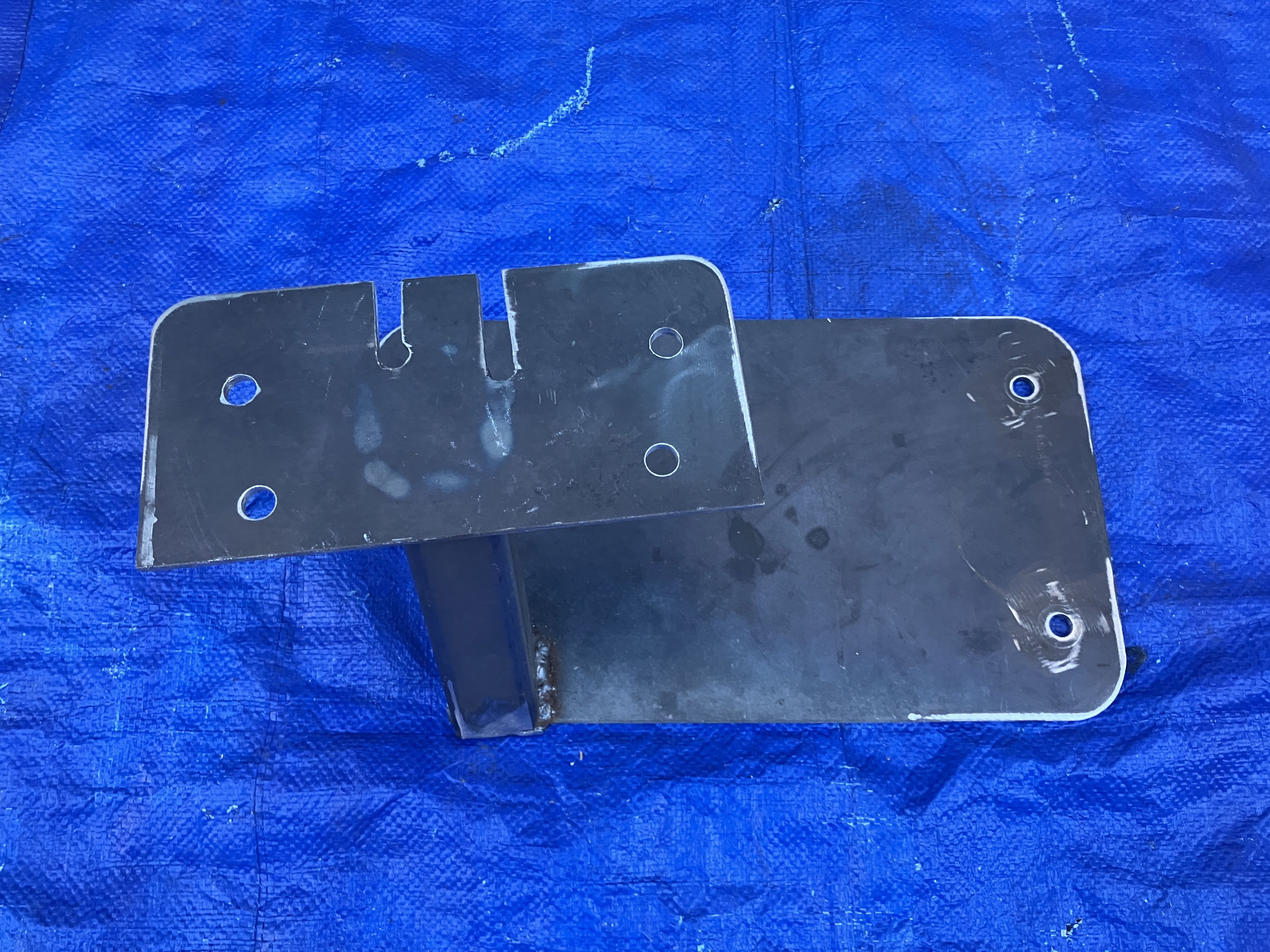

Some people cut corners, I like to round all my corners 🥁
this is the same "Bell Housing" bracket, it's where originally the engine would mate with the transmission, I think if I ever re make it, I will cut the big plate to be the exact profile of the bell housing clam shell
had to cut out an opening for the CV axle obviously, and had Ray Charles weld that up for me, [ahem] with his feet !

after seeing how much steel spacers actually cost I decided to cut my own, (so I went out and bought a $200 dollar chop saw - I'll show them)
here's a look at the spacers, spacering:
tack welded into place

I could have just welded the bars to the stock Prius bracket, but that would have made it much harder to assembly and disassemble, plus it may have melted the rubber bushing, so I made a plate instead
The Sandwich Design
