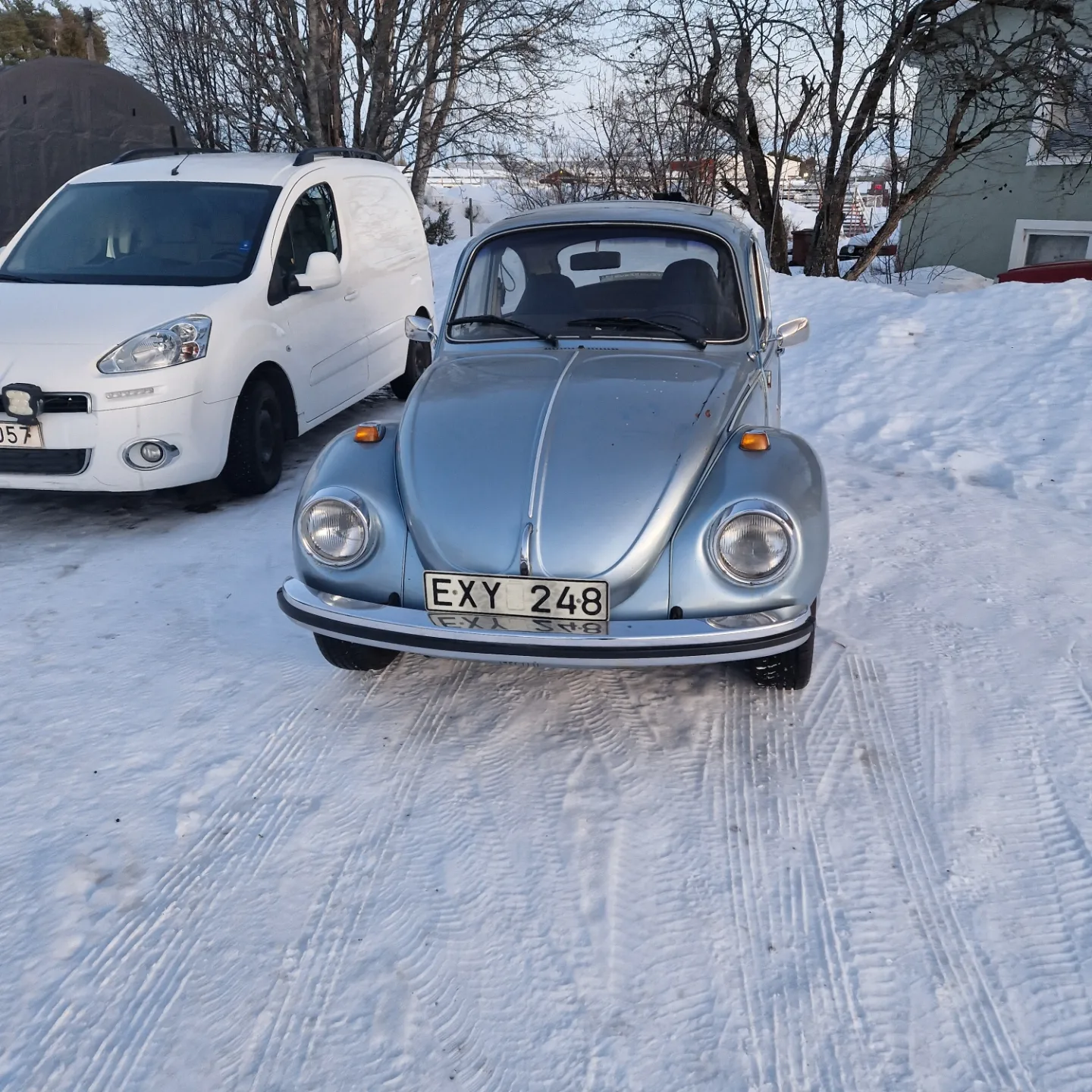

This is my -73 1303S that will be converted to electric. Have an Outlander motor with reductionbox, inverter, charger/dcdc that I might use but a Tesla sdu sounds tempting. Haven't seen any real performance number from outlander setups yet so I don't know what to expect from that. Please feel free to comment and give advice

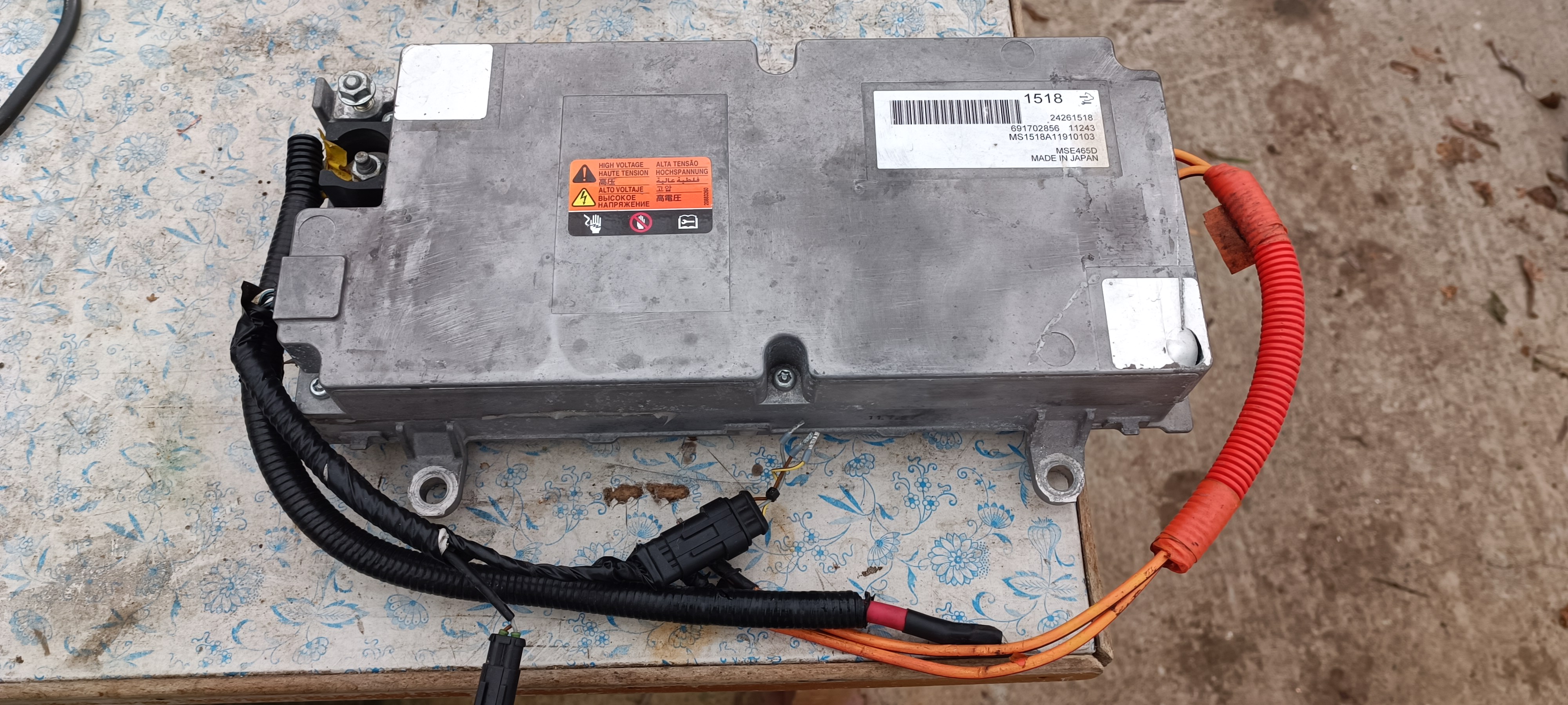

So I have decided to use my Outlander rdu in the Beetle. Will probably sell the charger/dcdc and get a small aircooled charger and dcdc instead that fits under the rear seat for a neater engine (motor?) bay. I know that a Chevy Volt/Opel Ampera dcdc fits. Perhaps a CCS Socket for a future fastcharging upgrade. Still believe @tom91's EVS-VCU will be a excellent choice to control it
- Been thanked: 1918 times
Re: [WIP] 1973 VW 1303S
I have an Ampera DC/DC converter left over, can add a picture later if you're interested

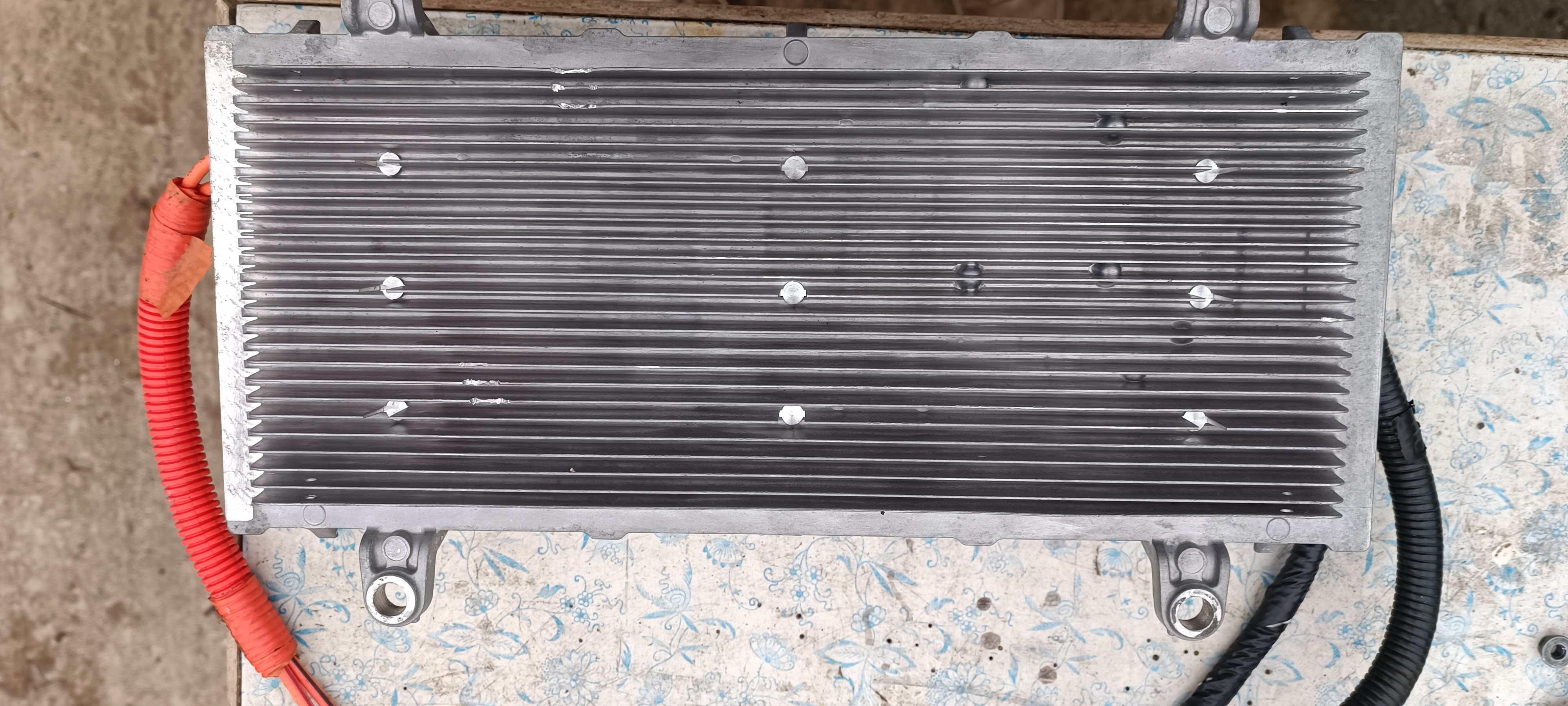

And here you go.
It comes with a pigtail to make contact to CAN and, as far as I remember, a 12V enable signal. I think it needs one CAN message to start producing and sends one or two messages with status info.
The back heatsink has some indents were it sat on the Nissan inverter.
I bought it back in the day from arber, he included two fans but I ran it without them and made sure it gets a little air stream from driving. With that it stayed reasonably cool (50°C) even loaded with 90A from my PTC heater.
I cut the fam bracket because I used one for cooling my Nissan battery. If you want I can include that second fan also.
