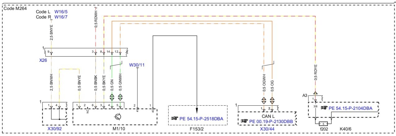

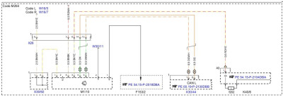

I got the pinout from the factory service manual and the resistance/capacitance values of the pins are also plausible, so I'm reasonably sure that's correct:
  1. GND
  2. NC
  3. Terminal 30t
  4. CAN-L¹ H
  5. CAN-L¹ L
  6. Terminal 30c (crash signal)
I've also acquired a promising looking DBC file that defines some CAN message IDs the BSG expects (not including actual nominal message contents tho, just some definitions).
¹ From the FSMs, CAN-L refers to the "Hybrid CAN Bus" whose only participants are the BSG and the CPC (Central Powertrain Computer). But according to the DBC file, the CPC forwards quite a few messages from other components to the BSG.

Another minor stumbling block was that CAN H/L were swapped, compared to what I had gathered from the official(?) wiring schematics. (But everything else was correct).
Idk why, but I triple checked it again and they're definitely the wrong way around in the documentation. Interesting :D

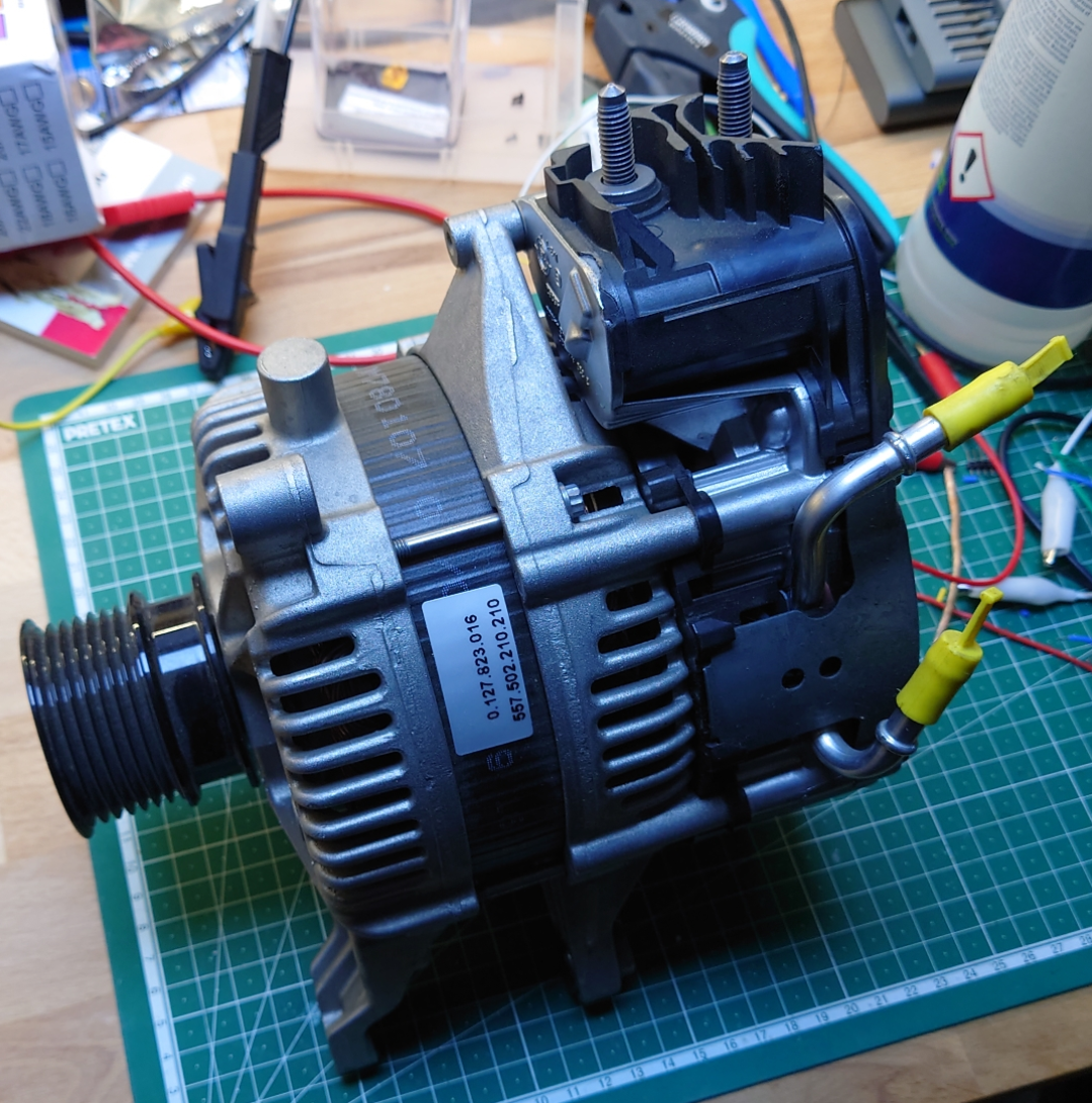

I am working on - I believe - exactly the same unit as you - although trying to get it working as a 48v generator rather than a motor. It seems to be part of a standard package which Lucas sells to vehicle manufacturers wanting to do "light hybrid" versions of their cars.
I am documenting my progress (roughly) at https://microcogen.info/index.php?topic=4052.0
I took a different approach from you, reckoning that as I simply wanted the generator function I did not need the controller module, so I ripped it off and opened it. I skinned my knuckles enough times doing this that I got a bit rough and it ended up being quite a destructive process (see the photo in that thread) but it's a complex picture inside and you might find it useful. My plan was to wire the five stator outputs into a bridge rectifier directly, and take manual control of the field current, and that would give me a 48v alternator.
What is really doing my head in is this : I cannot get the base alternator unit to generate more that about 20V without using crazy high rpm (I have put some graphs of performance into that thread but basically I think I would need about 11,000 rpm to get 48V+). This cannot be how it works in practice, because it's running at about 2:! off the crankshaft and the engine simply won't be turning that fast much enough time to be useful. I am also struggling to understand the "why" of the 5-phase setup. On the face of it, the alternator/motor is wound with five phases in a "pentagon" configuration (kind of like a 3-phase done in delta). Why would you do this instead of 3-phase like everyone else? It provides more smoothness in motor mode, I imagine, but am I missing something more? The documentation talks about both three-phase and five-phase operation, so maybe the controller does something more than just bridge-rectify the five-phase output. Maybe it's using the phases to do some sort of voltage-doubling, of the controller module could contain something like a boost converter to push 12-24 volts up to 48. This seems a bit clunky and I can't see the components in it that would be needed to do this. In particular I was expecting to see some large FETs in there, and there's no sign of them.
I figure if I can work out the Canbus commands I might get it into generator mode that way and see what happens. It's a nicely-made device, SKF / German-made bearings so I think it's worth persevering a bit !
