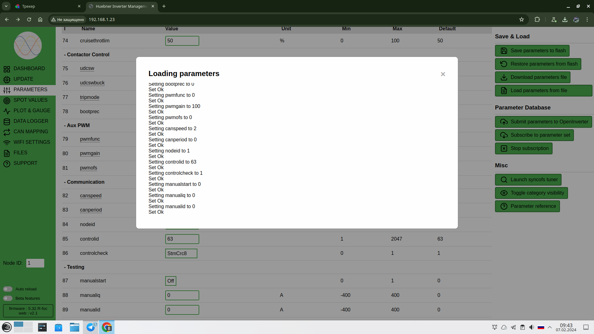

The interface is working... but there is a problem with downloading the parameters file! when uploading, the transmission fails at the end of the parameter list. Have you tried uploading a parameter file via the interface?

johu wrote: Sat Jan 27, 2024 9:54 pm I have to test parameter upload. What other issues did you find?
I am loading parameters
I tried it on both controllers. But the "CAN MAPPING" tab does not display anything. But I also noticed this on the old ESP 8266 interface connected to the controller via UART.

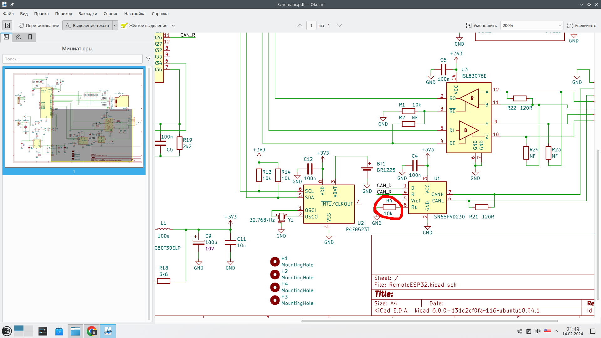

I have used the gadget some more. I found that R6 is way to high at 100k! That disturbs CAN comms. Either bridge it completely or replace with 10k. This must have been the reason why it disturbed the bus in my car.
Also it only downloaded the parameter json partly and that led to errors in displaying the CAN map. Please retry.

johu wrote: Wed Feb 14, 2024 4:11 pm R6 is way to high at 100k! That disturbs CAN comms. Either bridge it completely or replace with 10k
Is this what you mean?
Been thanked: 1913 times
Re: ESP32 Based Web Interface & Data Logger
Exactly! On the CANLite that I based the board on that you can buy in the shop it is 100k
