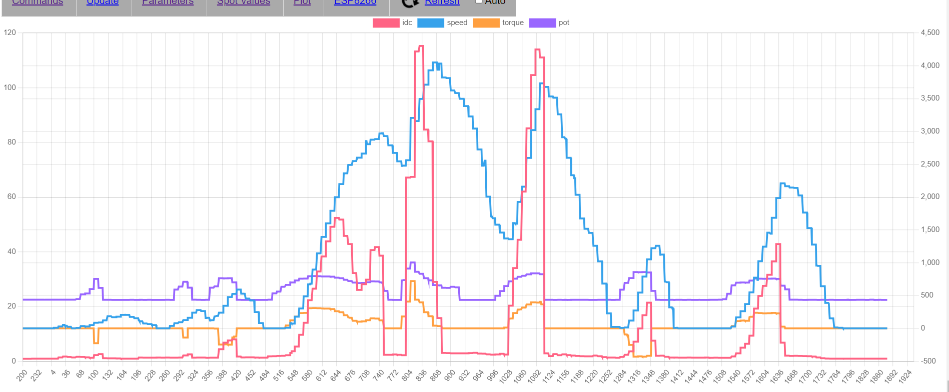

Thanks to Jamie coming through with an updated Bin making up for my shortcomings we have some more data from the l210 with is300h inverter
I'm pretty sure I'm no longer getting the harsh cut but the car is juddering a lot due to my bad choice of mounting the entire motor to gearbox coupling, but current still max's out at 120 Amps
