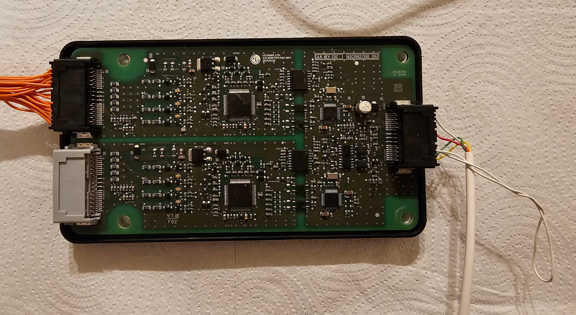

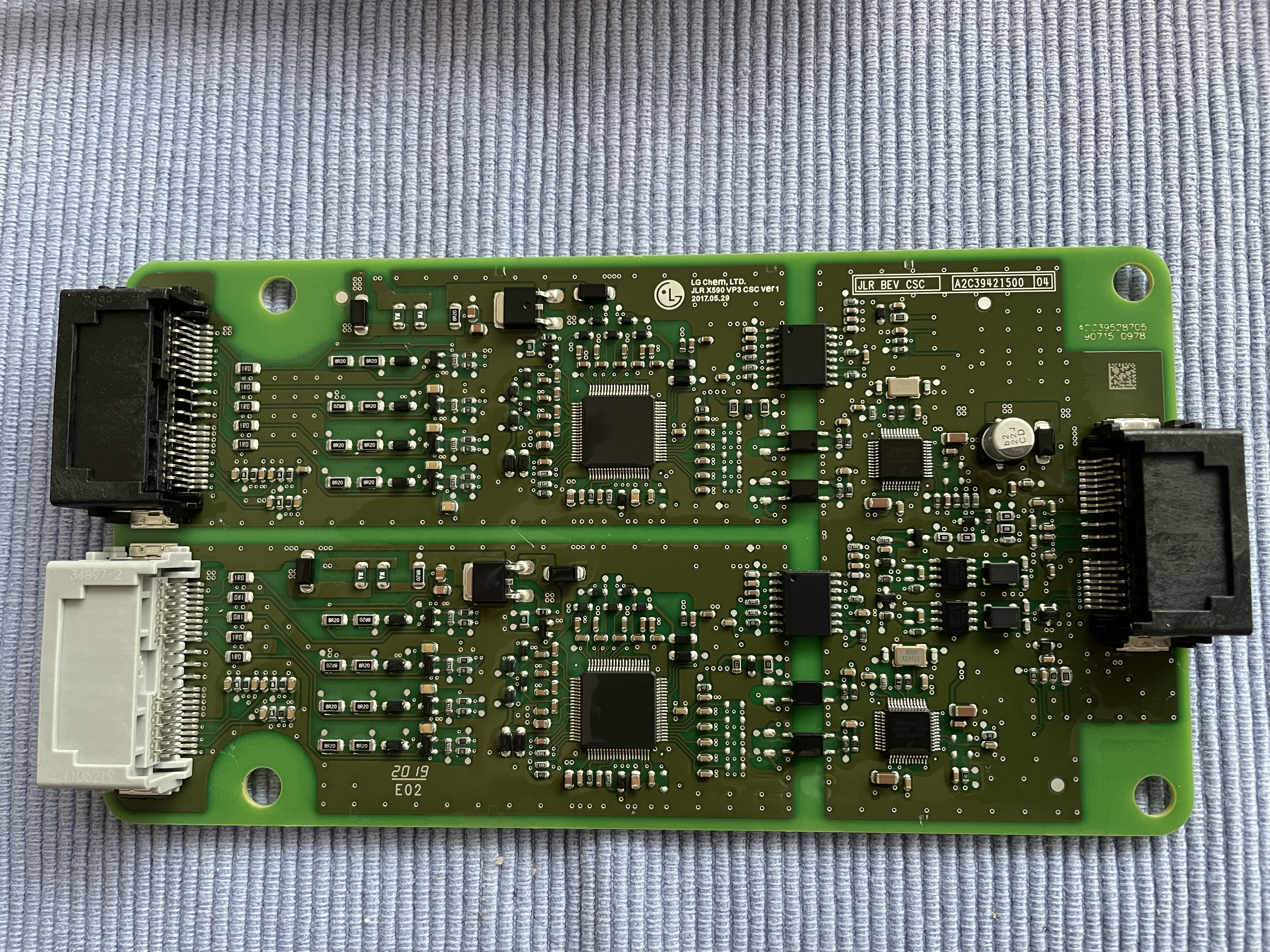

There is one master BMS and six secondary modules. Each secondary has two identical sections: BMS chip (76PL455ATQ) and MCU for communication. There is galvanic isolation between the BMS IC and MCU. (Picture)
Each section monitors nine cells (3 battery modules) or 18 cells for one secondary module. The I-pace battery is a 108S configuration consisting of 36 battery modules. Part of the BMS schematic is here.

And one picture of the device under test:

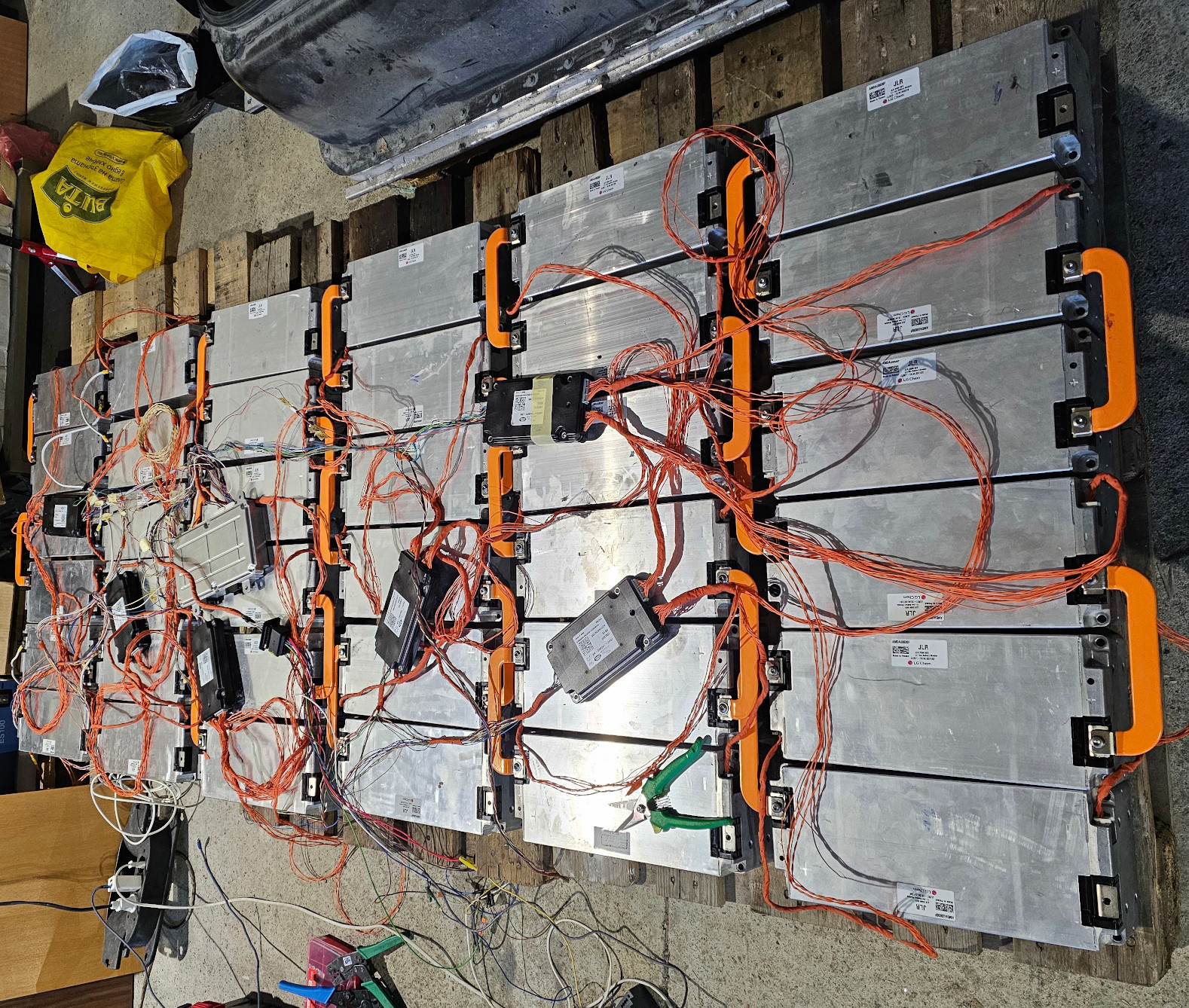

A few weeks ago, I attempted to reconnect the whole battery:
This enormous battery has many wires, and I only had a day to play with it, so reconnecting was incomplete.
I've captured some logs and am sharing them. Some of the findings so far:
* The central BMS probably requires a specific CAN frame to go into an operational state. It wakes up on any CAN frame and starts sending data, but after a while, it stops for a moment and then starts again. (master_CAN_ipace.txt). This bus needs external termination.
* Each secondary module transmits data with its frames: the first one is 0x111-0x114, the second is 0x121-0x124, and so on. There are two logs on the internal CAN bus. The difference is that I swapped the first and second modules.
The first module was out of balance, and I expected some balance commands.
Some frames may be related to the balance commands, and I will experiment with CSC modules when I have more time.
