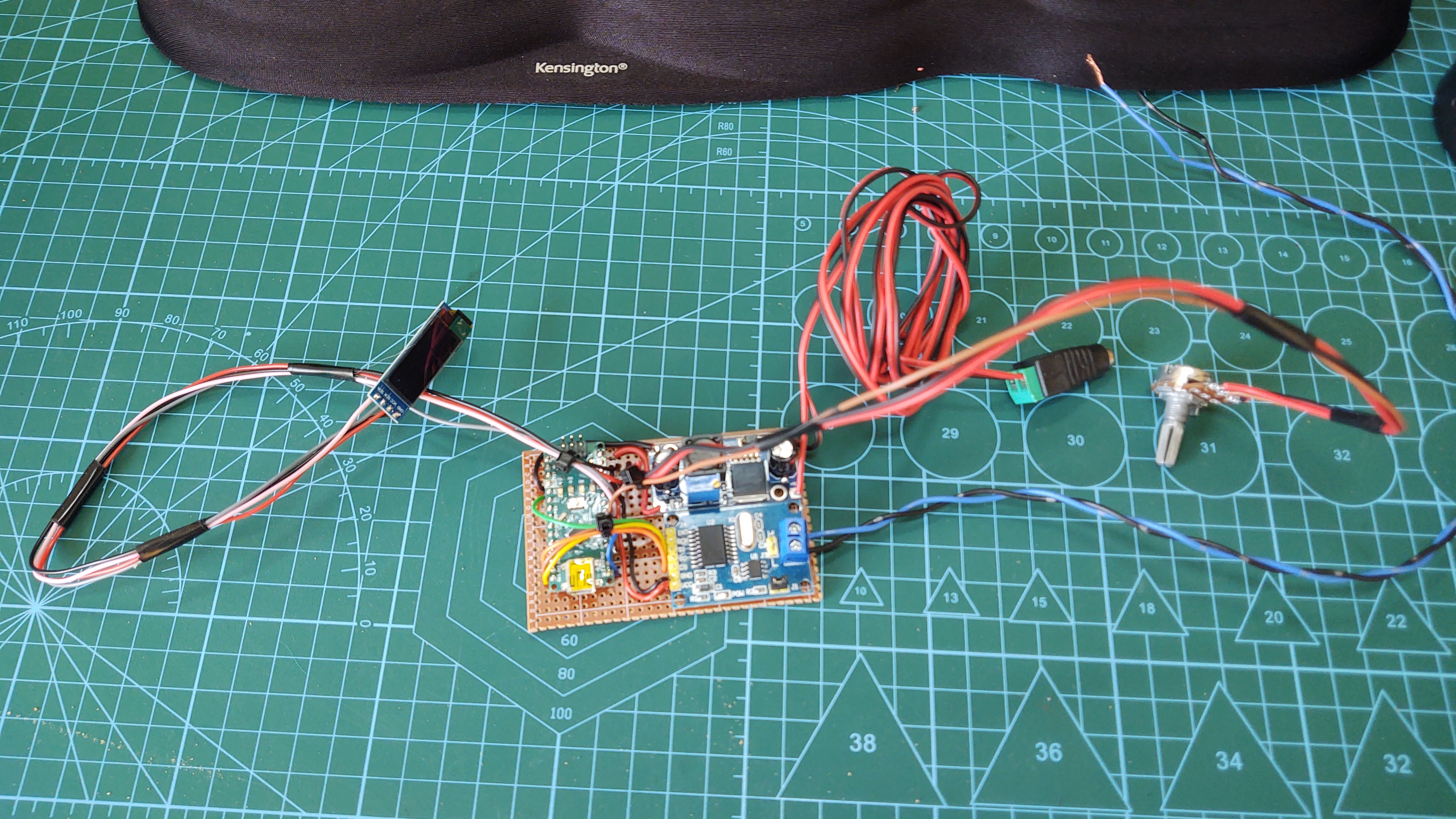

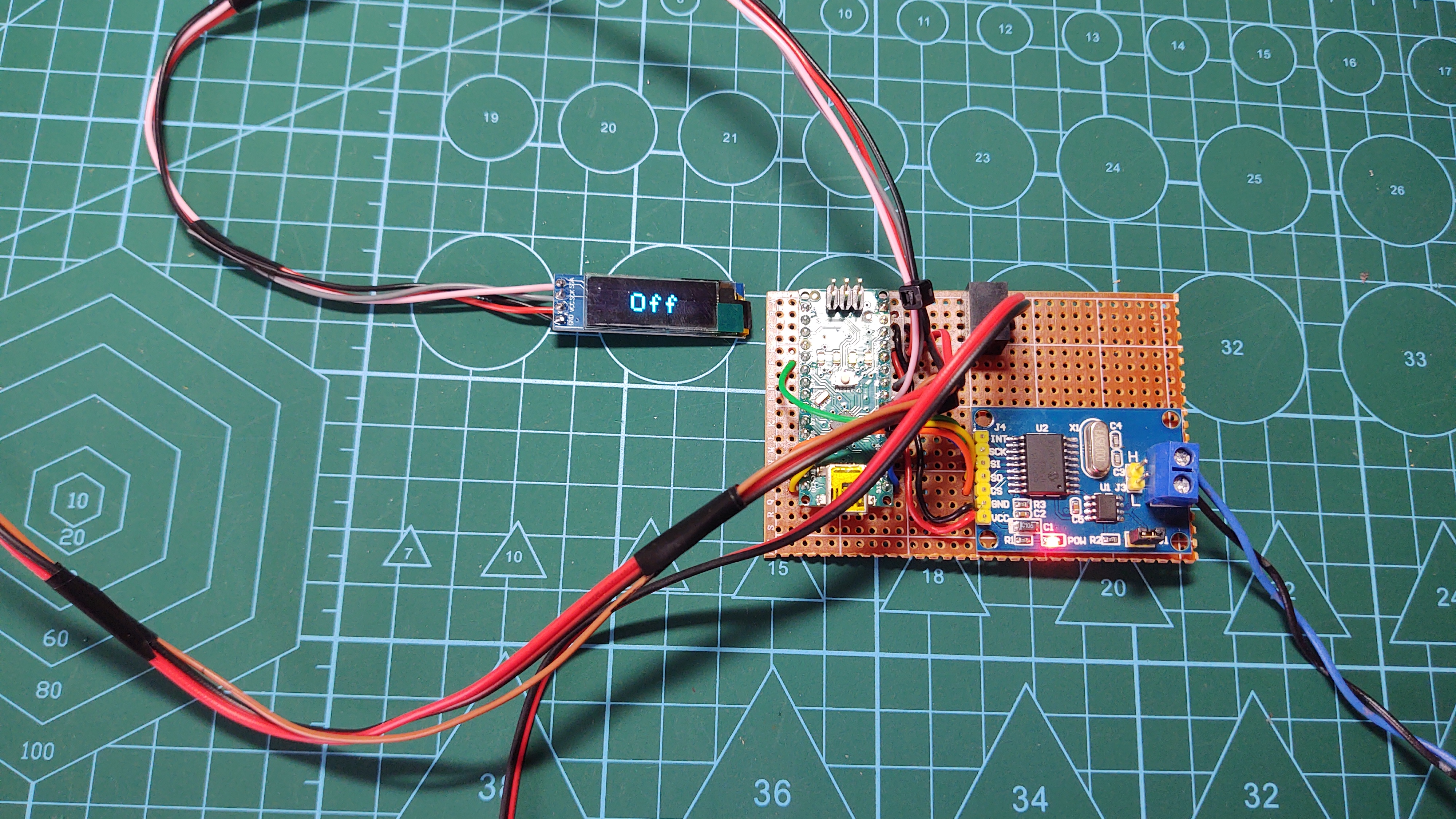

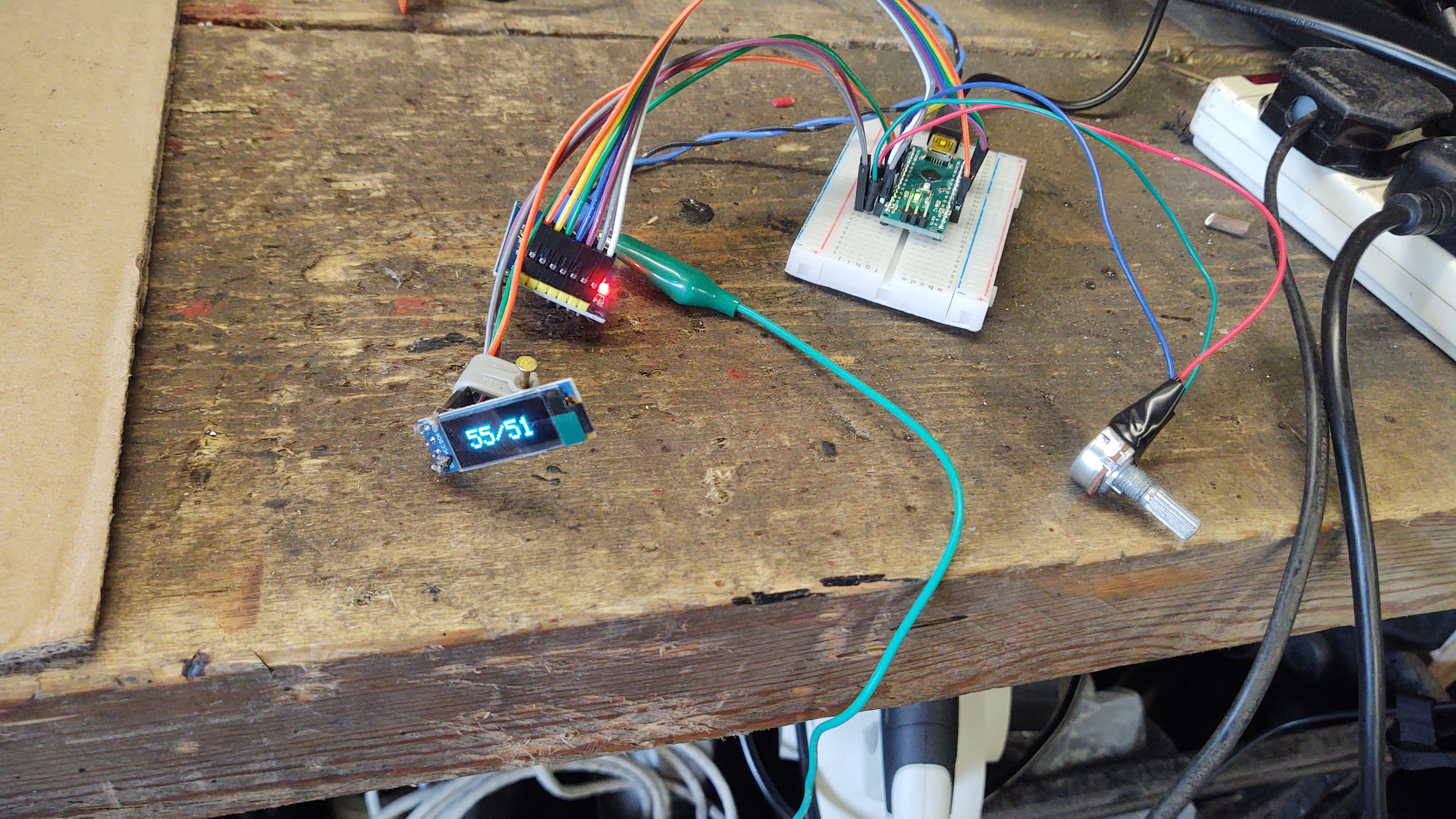

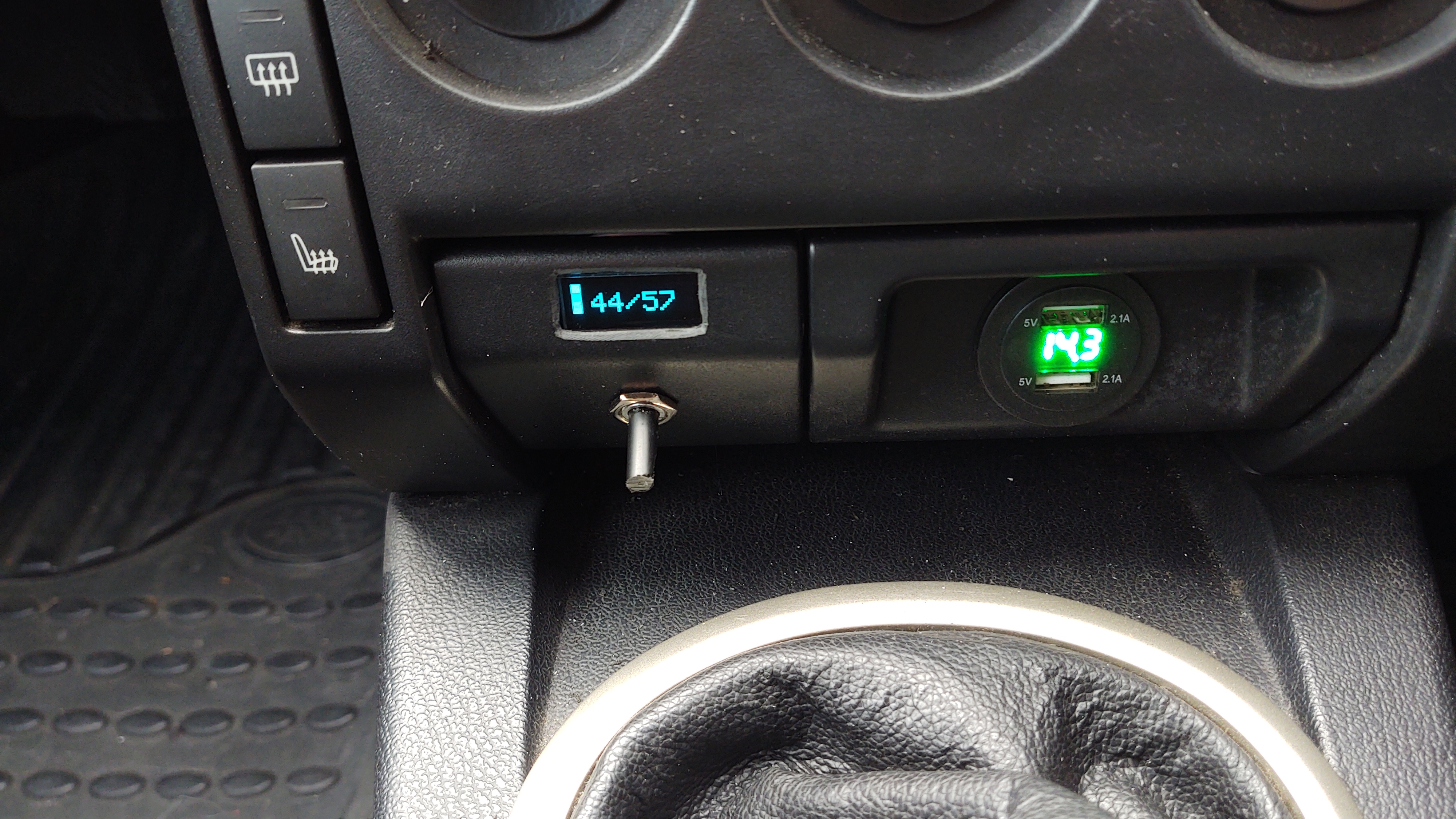

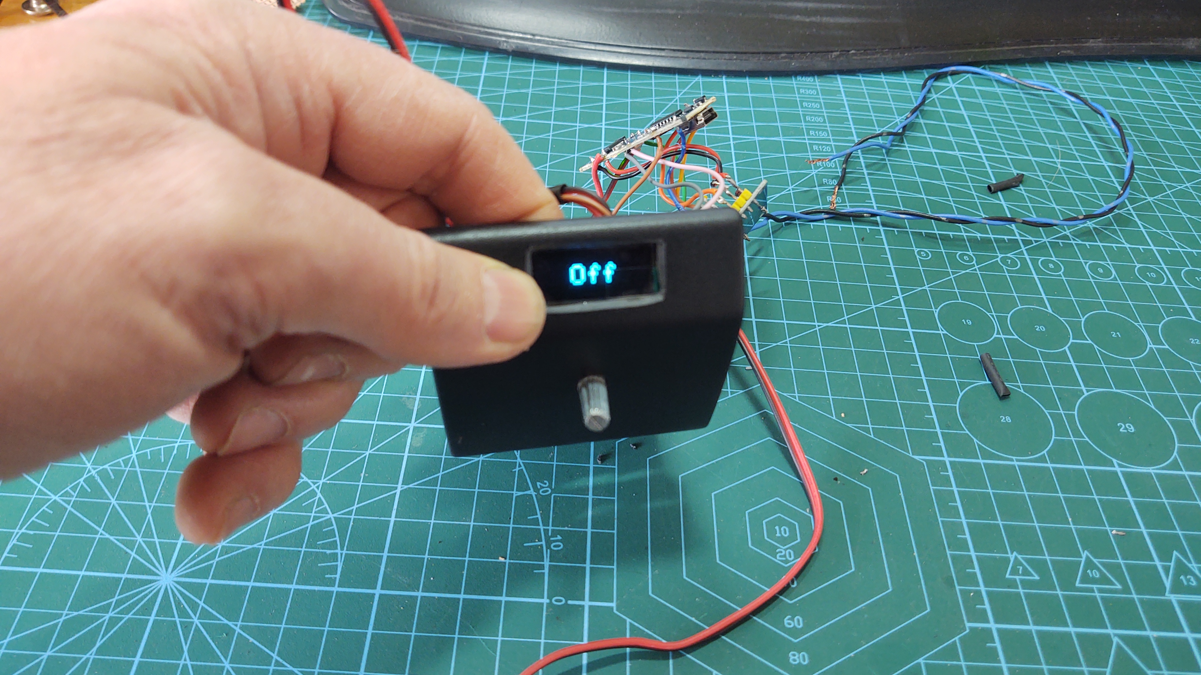

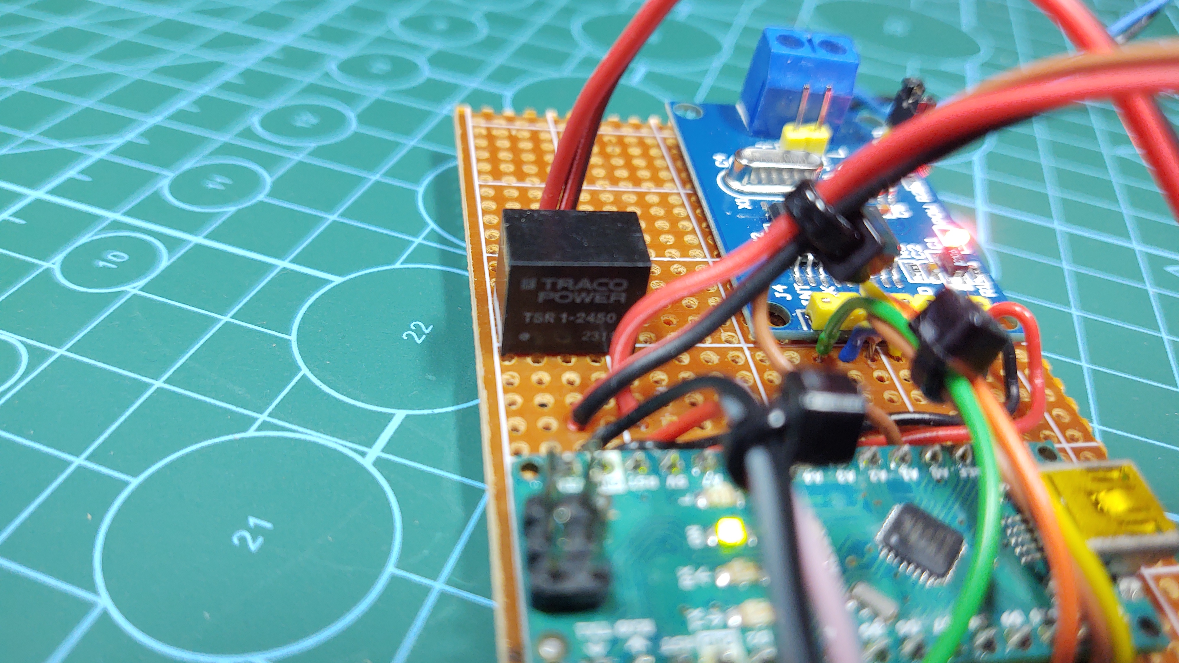

Thanks for this as it tidies things up nicely but to be honest I like the idea of seeing the temp requested and current temp in the display, plus having a pot to adjust the temperature seems like a good idea, even if it is only until I figure out what the ideal temperature is.
I received a couple of displays in the post today and managed to hook one up.
To my amazement I managed to do it right first time and it just works. :D
BTW the green cable is just shorting out the pins in the MCP2515 to enable the CAN network termination. Even with only a single 120R terminating resistor it works fine but I'll ensure both are connected in the final installation.

Alibro wrote: Wed Feb 07, 2024 2:07 pm To my amazement I managed to do it right first time and it just works.
Nicely done. I am glad it worked right away.
Alibro wrote: Wed Feb 07, 2024 2:07 pm having a pot to adjust the temperature seems like a good idea, even if it is only until I figure out what the ideal temperature is.
Yes i had to test the end temperature a couple of times as 50deg was ok with 0deg outside, but when -7 in the morning 55deg coolant would perform much better. But i still like to keep my control loops simple without too much sensors and inputs.

Just in case anyone is following this thread and needs to know what components to purchase these are the parts that worked for me.
Arduino Nano (I used a genuine one)---------------- https://amzn.to/3uA3str
MCP2515 CAN module (8Mhz)------------------------- https://amzn.to/487fZm6
I2C OLED Display Module 0.91" 128 x 32 pixels----- https://amzn.to/49ov9V1
4k7 POT--------------------------------------------------- https://amzn.to/3wbe42v ** Edit - A 1k linear POT works much better than 4K7 **
Traco Power 5V TSR 1-2450---------------------------- https://ebay.us/JHKUnI
Outlander 12V and CAN Connector------------------- https://ebay.us/2cH3c5 ** This is not the connector I bought but it appears to be the same. **
MCP2515----------------Nano
INT........................D2
SCK.......................D13
SI.........................D11
SO........................D12
CS........................D10
GND......................GND
VCC......................5V
OLED Display------------Nano
SDA.......................A4
SCK.......................A5
POT----------------------Nano
Pin 1.....................5V
Pin 2 (wiper)...........A0
Pin3.....................GND
If you want to use TurboPete's code be aware it will not send the "On" message 0x188 until it sees 'Contactor on) from the VCU.
If you don't have this connected you will need to comment out the first line with "OPENINVERTERCONTACTORS" in it plus line 231 "Serial.print(inverterStatus);"
In my case I have the heater connected such that it only gets power after the positive contactor is enabled.
This is the code already amended.

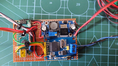

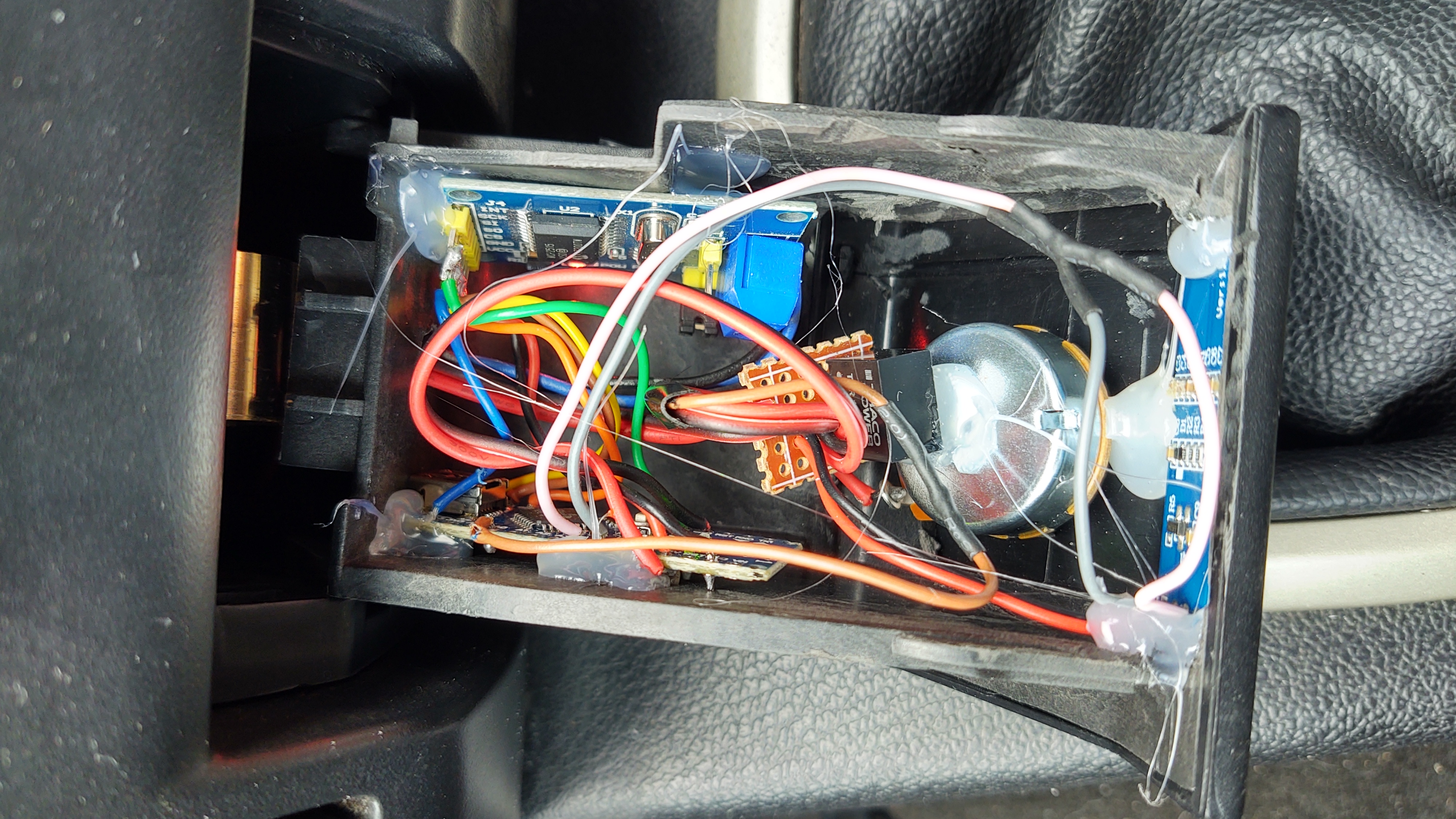

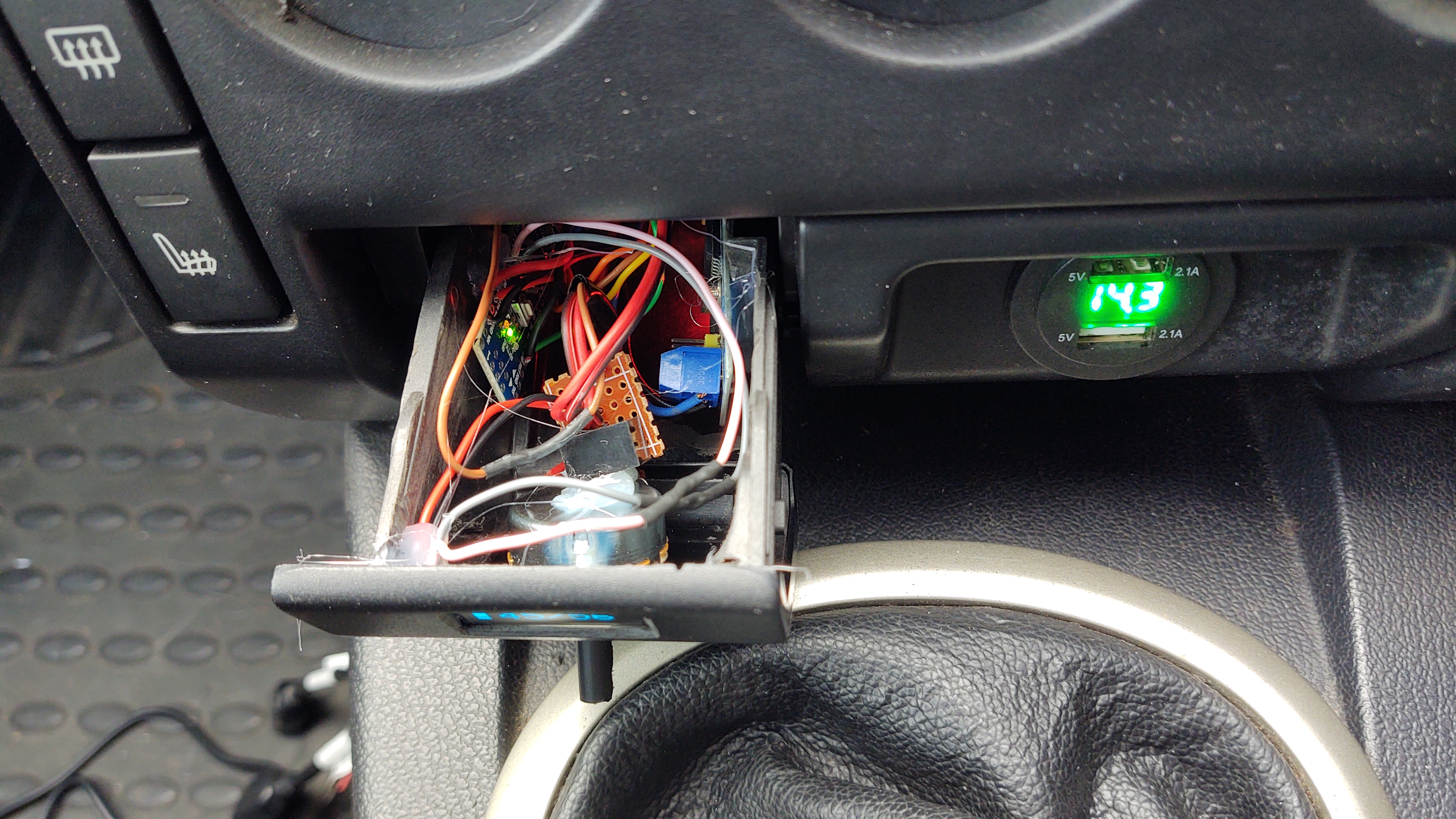

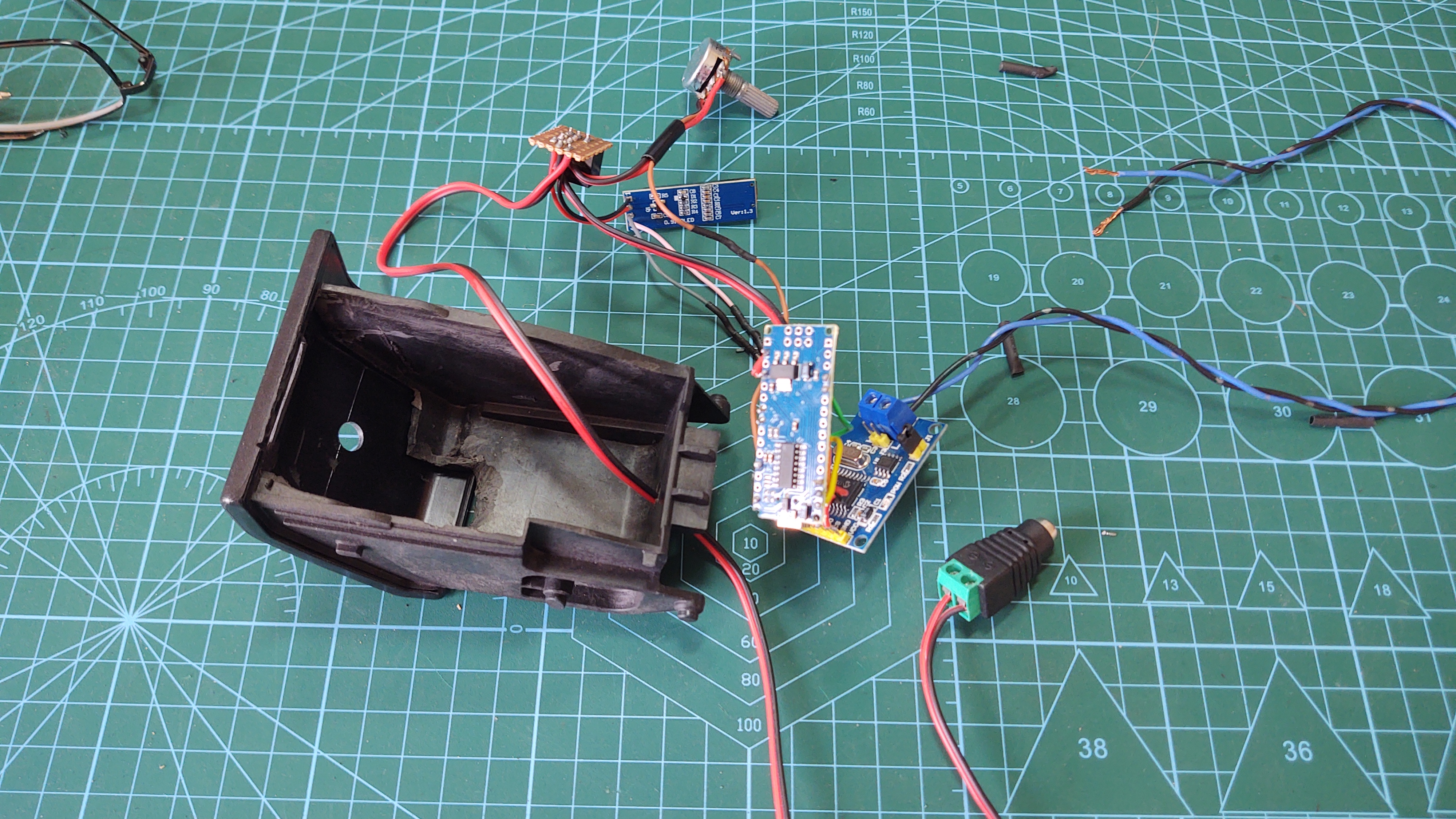

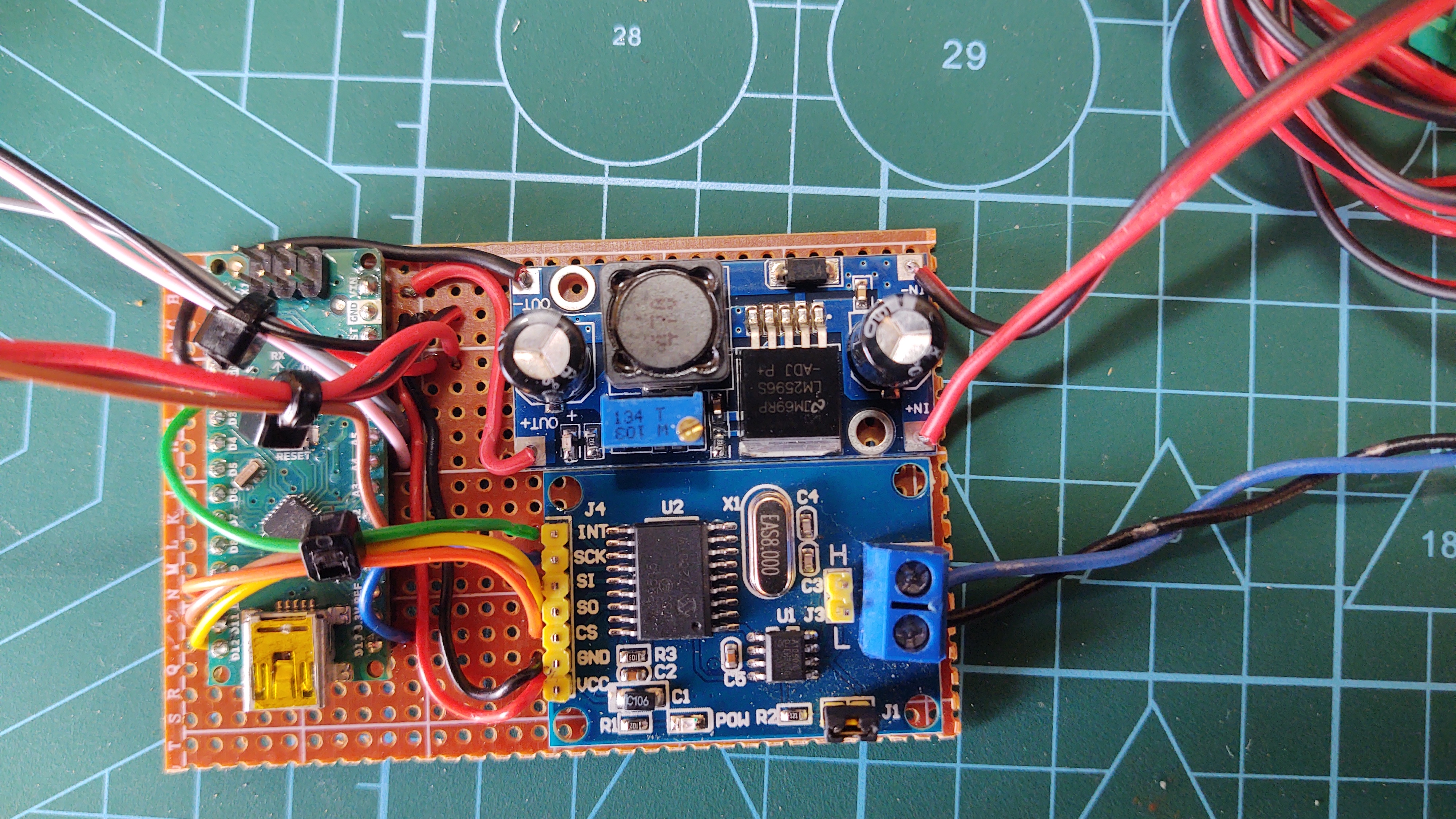

I used some vero board to make this a bit more robust.
I also added a buck converter to lower the voltage to around 6V as I wasn't sure the Nano would be happy with 14.4V. What are your thoughts on this guys and should I do the same for the Due and Uno in the low voltage junction box?
I'll probably have to cut and splice some of the wiring when installing but wanted to test I hadn't cocked something up first.
marcexec
Posts: 239
Location: Dublin, Ireland
Has thanked: 1041 times
Been thanked: 111 times
Re: Mitsubishi Outlander PHEV heater
Post by marcexec »

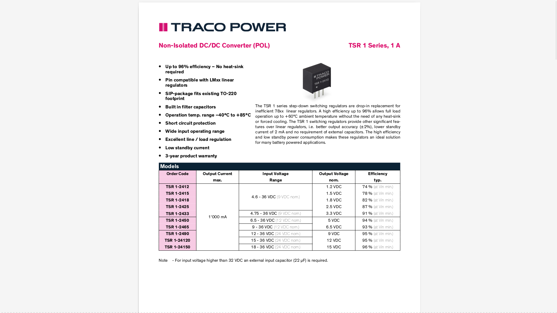

I'd measure the difference in power draw between buck converter vs direct. In general lower consumption would mean less heat, so more reliable. OTHO you're introducing another point of failure, if it fails open that is.
My Suzuki RF400 build @ES
Honda IMA & Lebowski howto
crasbe
Posts: 330
Location: Germany
Has thanked: 58 times
Been thanked: 180 times
Post by crasbe »
You could simply set the Buck converter to 5V and connect it's output to the +5V pin of the Arduino Nano instead of the VIN pin.
That bypasses the internal LDO completely.
That would be the better strategy anyway, because 6V is right on the edge of the permissible input voltage. The dropout voltage of the LM1117IMPX-5.0 is greater than 1.0V at room temperature.
And no, the LDO wouldn't really love 14.4V input voltage. Even though it might not explode immediately, the tiny package of the LDO on the Arduino Nano is not able to dissipate much heat.
A word of caution in regards to the LM2596 buck converter you have used: They usually come with a faked chip which has a lower efficiency (not really relevant for your case) due to a lower switching frequency. The catch is that sometimes (not always, because you can't predict what the Chinese put on there) the boards come with mismatched capacitors and inductors, resulting in a higher-than-usual output noise. That in turn can lead to unreliable operation, which is less than desirable in an automotive application.
My recommendation are these cute, integrated step-down converters from TRACO (and many other suppliers) like this one: https://www.mouser.de/ProductDetail/TRA ... oeVA%3D%3D
The Mouser link is just an example, idk where to buy stuff in the UK.
Alibro
Posts: 1112
Location: Northern Ireland
Has thanked: 504 times
Been thanked: 323 times
Post by Alibro »
Sorry guys I somehow managed to unsubscribe from the topic and missed your replies.
So the consensus is Arduino's don't like 14.4V and cheap Chinese buck converters may not be reliable. I'm not surprised at the answers so will follow your advice and come up with a better solution.

Alibro wrote: Tue Feb 13, 2024 4:07 pm So the consensus is Arduino's don't like 14.4V and cheap Chinese buck converters may not be reliable. I'm not surprised at the answers so will follow your advice and come up with a better solution.
Just found my Digikey order, I'm using an isolated one on the motorbike for the Lebowski/Honda IMA to step down 4S / 16.8V: https://www.digikey.ie/en/products/deta ... 3/16348346

crasbe wrote: Mon Feb 12, 2024 2:49 pm You could simply set the Buck converter to 5V and connect it's output to the +5V pin of the Arduino Nano instead of the VIN pin.
I didn't expect the first part of this answer until I checked the input voltage of Arduino Uno and found it is recommended 7V to 12V with a limit of 6V to 20V. The Nano is just 7V to 12V with no reference to max limit. I had wrongly assumed the Nano would be OK with 5V or 6V input.
Having been burned before (almost literally) by a cheap Chinese voltage converter I'm not keen for a repeat performance so have ordered a few of the Traco's

Alibro wrote: Tue Feb 13, 2024 10:14 pm Having been burned before (almost literally) by a cheap Chinese voltage converter I'm not keen for a repeat performance so have ordered a few of the Traco's
+1, wrong place to save (deep in the car and soon forgotten...)

I put up a photo earlier showing a circuit to control the heater but as mentioned we didn't like the cheap Chinese buck converter I used to bring the voltage down from 14.4V to 6V for the Arduino.
As suggested by Crasbe this is a Traco power TSR 1-2450 5V step down voltage regulator that is designed to handle up to 36V.
They are more expensive than the Chinese buck converter but I figured I should use something a bit more quality.
Also as suggested I connected it directly to the 5V pin as the Arduino needs a minimum 6V at Vin.
Thanks again for your support and guidance guys.

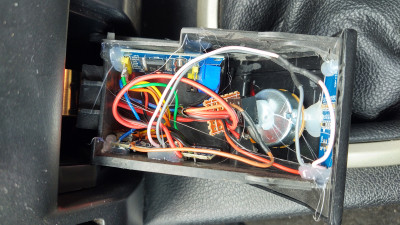

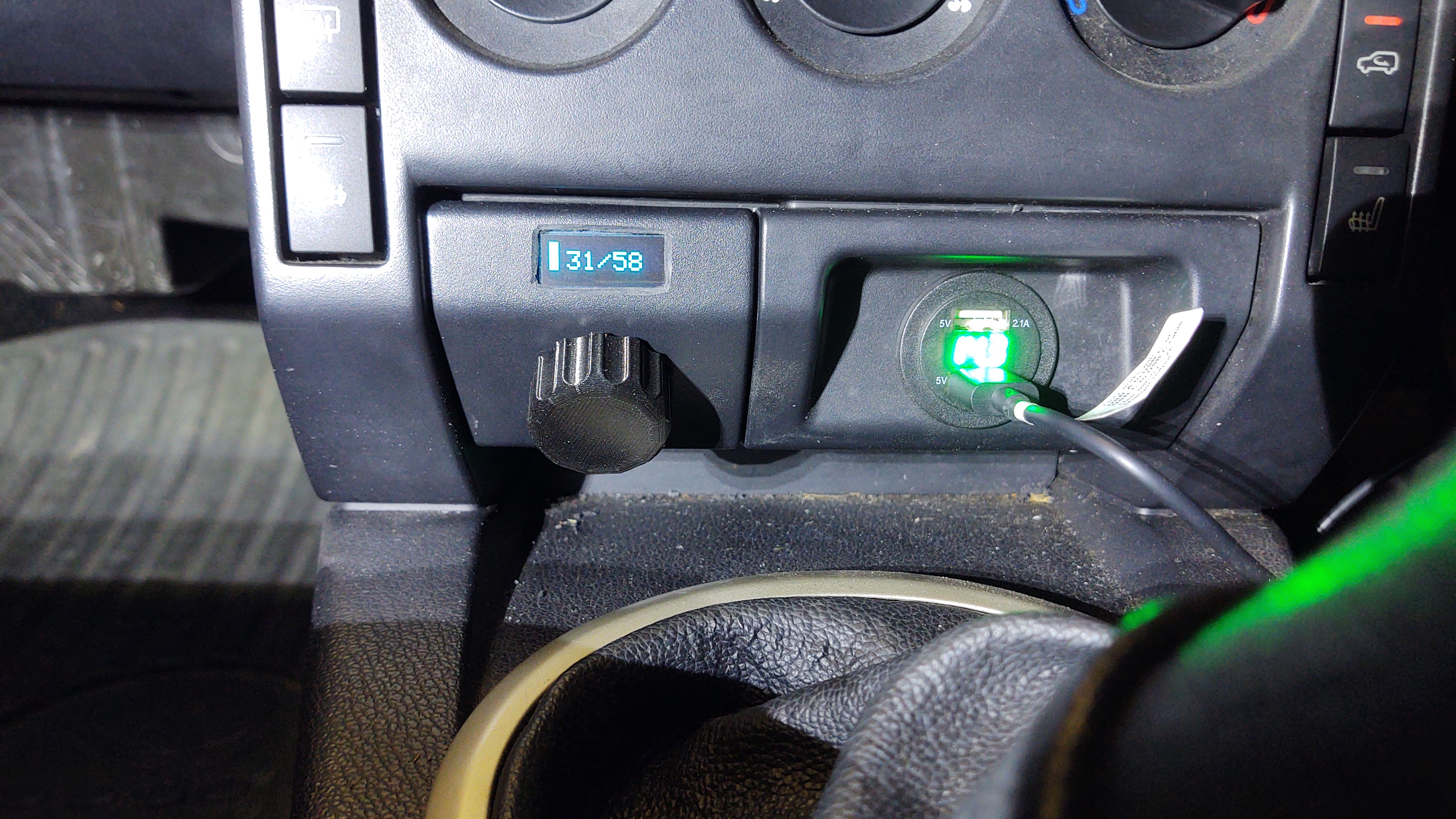

Here is a quick update of the heater situation now I have it installed.
It works! :D
The longer version includes a minor disaster and a change in design.
While testing I managed to drop some solder on the board while it was running. This caused the operation to be somewhat sub-optimal so after first replacing the MCP2515 I then had to replace the Arduino and of course it was no longer soldered to the vero board.
Originally I had planned to mount the board under the bonnet and feed wires through to the dash but while staring at the new pile of wires I had an idea.
OK so neat it isn't but this was more a proof of concept than a final installation. In order to tweak the code I will need to remove the Arduino as I didn't give myself enough room to plug in a cable but that can wait a bit. I have plenty of other things to work at in the meantime.
Jamie/TurboPete's code works great however in my application I might need to adjust the temperature difference before the heater switches to half power. It looks like it switches to half power while around 10°C below requested temp. This means if I request 55°C it only gets to around 50°C which is not quite enough. I find myself turning it up to 61 or 62°C to get the desired 55°C.
I assume this will change as we get into late Spring so for now I am keeping the adjustment and code as is. I have a second ash tray that I can use if I decide to use Arber333's code without a POT.
