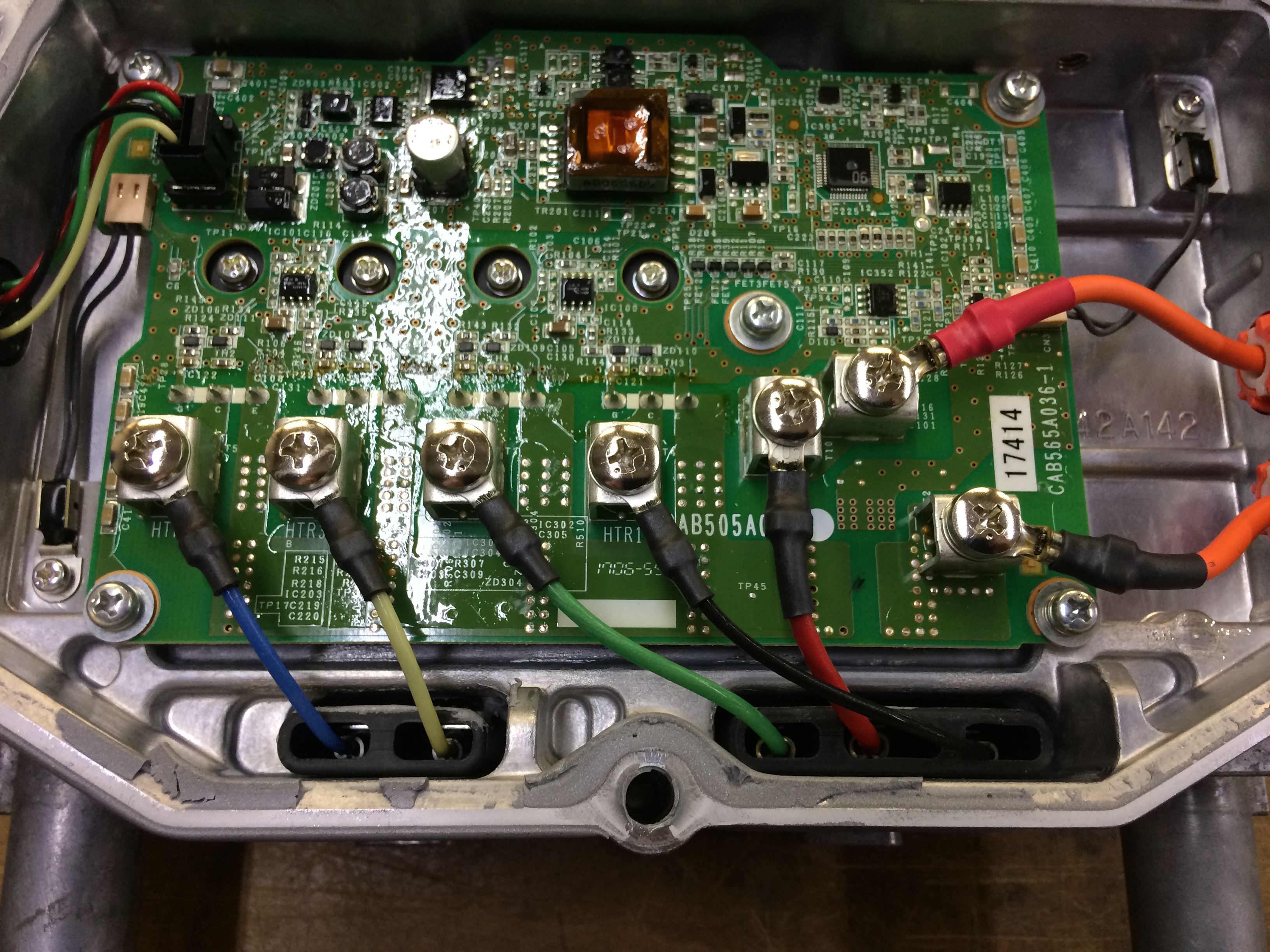

Hi Forum. For anyone interested I took the top off my PHEV heater.... cos I am nosey
Pics reveal heater connections etc.

Probably a very basic question but what does the coolant pump require more than just 12v and ground to run? I can see two signal wires in the loom that go to the VCU but I’m not sure what they do.
