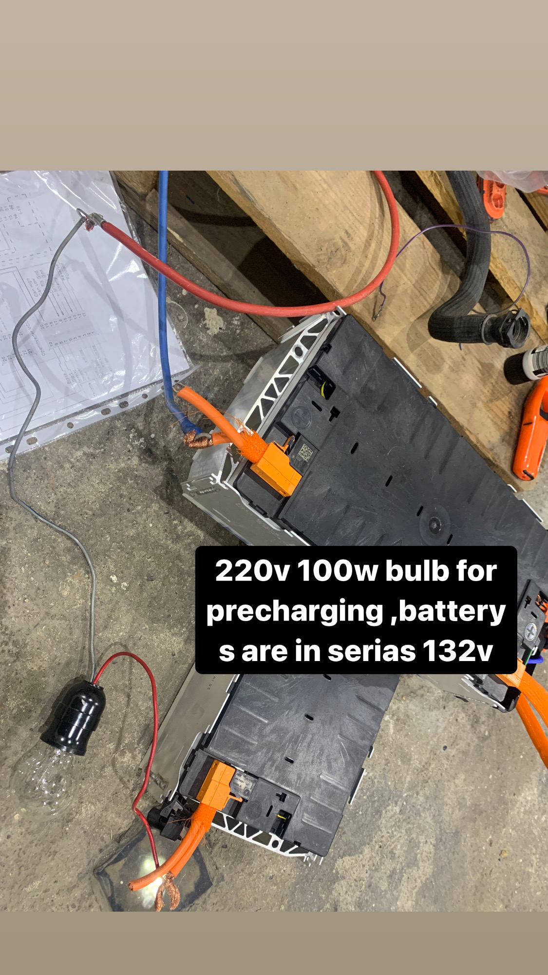

The motor is on a bench PMSM Bosch SMG 180/120 with resolver with Toyota Prius Gen 2 and Openinverter PCB of course!!
3 times watch the Video tutorial for FOC
I do everything as a Johannes and D. Maguire said in video, but when try to Test the motor NOTHING, i make a couple of photos how i connect the Motor+Inverter+Controller!

Nicely documented.
what isn't shown if opmode changes to run. If you did nothing about the PRECHARGE error then it won't. Lower udcsw to 100 and read here https://openinverter.org/wiki/Errors

Re: Peugeot Bosch SMG 180/120 with Gen 2 inverter
After lower the udcsw to 100v show RUN and the 220v bulb rise up with -10A BUT PRECHARGING stay
