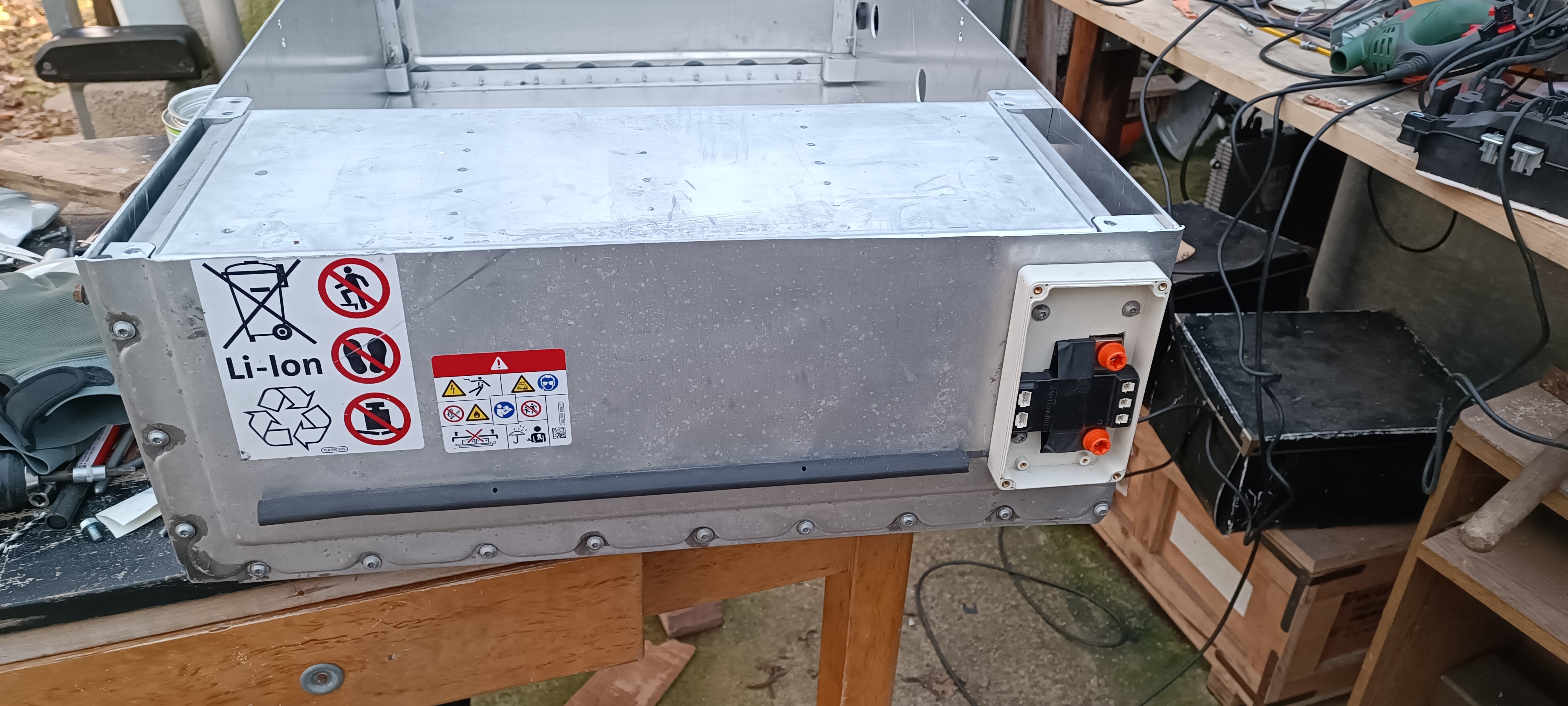

Tiny update, installed the DC cables. I'm much too cheap for a connector plus there's no room for it.
Still haven't finally decided on the BMS location. So far considering 3 alternatives which may or may not work:
a) Seal the BMS boxes with U-profiles filled with re-enterable gel and mount them outside the box - cables go through those squares I marked out
b) Bolt an extra box to the front of the big box and put the BMSes in there
c) Take the cover off the BMSes, fill them with gel and see if that fits inside the big box. Probably won't fit because mounting blocks are in the way.

Some more work on the battery box. Cut some sidewalls from the top cover of the OEM housing. Bonus: it's got all the requisite stickers - upside down though. I mounted the ISA shunt in an extra IP67 plastic box. It bolts onto the bus bars that I managed to solder nuts to.
My current take is that I can pre-assemble the entire pack on dollies, roll it under the car and lift it up with my neighbors motor cycle jack.
On the other end I did a capacity test of the Nissan battery that is still in the car. If you hit me with a decent price I might sell it and otherwise use it in the next project.
On the inside they have some nice gasket
In the front of the box I bolted some extra angle profile that I just cut out and bent on the 4 corners
Now need to wire up the ISA shunt and decide where and how CAN & 12V should exit the pack. Maybe some 4 pin round connector.My current take is that I can pre-assemble the entire pack on dollies, roll it under the car and lift it up with my neighbors motor cycle jack.

BMS is in da house
Also did the first trial fit and it is pretty much perfect. Only thing I didn't account for is the cross member bending downward on the outside. So the box doesn't sit flush on the beam but there is about 10mm distance. Will have to sleeve the bolts to prevent springiness.Support R/D and forum on Patreon: https://patreon.com/openinverter - Subscribe on odysee: https://odysee.com/@openinverter:9

Those brackets look a bit on the light side. Are you sure they would hold on to the pack? What if you removed 2 of the 4 bolts for dissasembly? You think they will hold?

Hmm it's the same brackets that have held the Nissan battery for 4 years now so I have some confidence. Which bolts do you mean that I could remove?

Brackets seem flimsy from photo perspective and length perpendicular seem a bit too much. I am sure you will properly support the box when you take the bolts out, thats all i wanted to remind you.
Also i want to remind you to make standoffs for the bracket-bolt-chassis joint. Do not let the bolts deform fittings or put side pressure on the chassis.

I'll upload a video soon, then it should become clearer. Yes, while the bolts are not in I use a motor cycle jack to support it.
In total I have
a) the three brackets in the front
b) 4 M10 bolts in the middle (you drilled 3 of the holes, I added another one)
c) 2 larger brackets in the back
In total I have

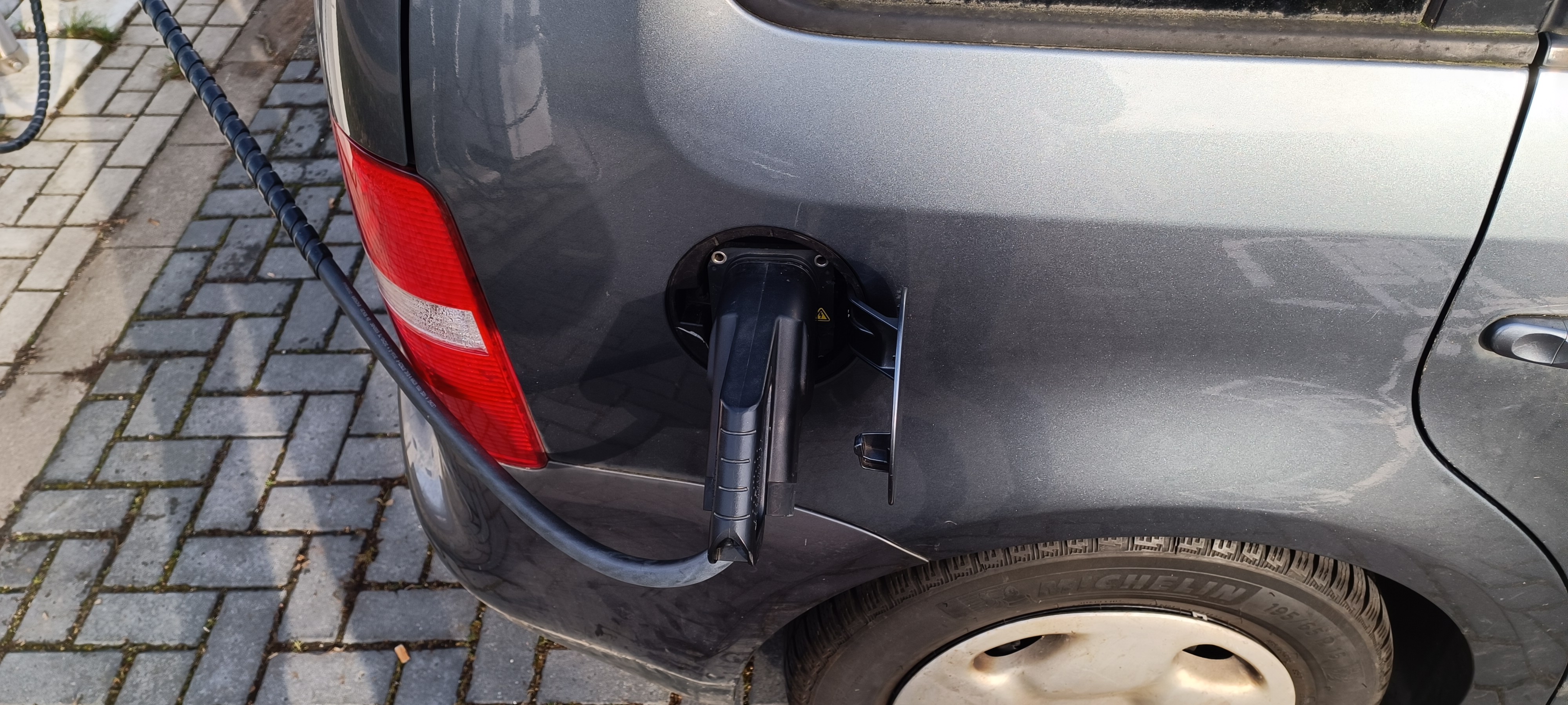

Charge port upgrade complete
Tight fit, had to butcher quite a bit
Now need to finish the battery upgrade to test. Can do a quick test with pyPLC of course

Oh look he is using his CHAdeMO port again
Really?
Yay CCS upgrade complete and working

Re: [DRIVING] VW Touran powered by Nissan Leaf
How is the port held in place? I do not see any fasteners used, and you trimmed off the bottom two.
- Posts: 6713
- Has thanked: 369 times
- Been thanked: 1543 times
To be improved
It can't move inward as it is touching a sidewall (video coming), it can't moved sideways because of the petrol tank flap thingy and it can't move out because the DC cables are inside a duct (they exit sideways) and that one is held on with a bolt.
Yeah, great. But: The Touran lost it's unique "charge-connector-sidewards" feeling

I'm currently stuck in CCS mounting pain too. I've not taken a look at a load of CCS plugs, what sort of clearance is required around the port?
Currently thinking of mounting sideways and wonder if I'll have issues getting the plug in there?
Yeah no way to sustain that one
From plugs and charge inlets I have seen they don't widen all to soon so it can sit inward quite a bit. Sideways CHAdeMO has always worked well, if that firs for you, do it.

Googling for
CCS plug dimensions
reveals some drawings. In your picture, I think there will be collision in the lower part, if the connector is short and goes downwards, like the Huber&Suhner on Numbat. Maybe cut the frame with the holes, to bring the inlet surface to the outer surface of the car, like Tesla and Johu do.
CCS plug dimensions
