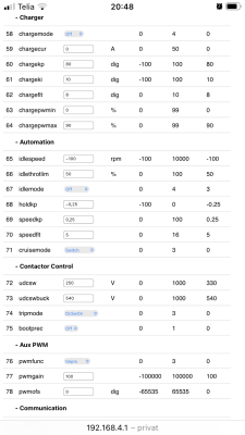

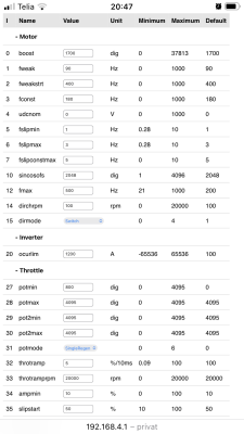

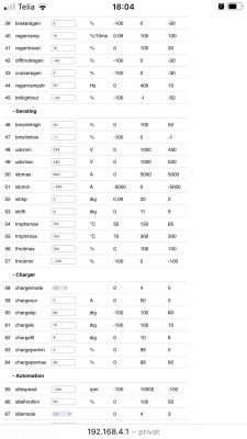

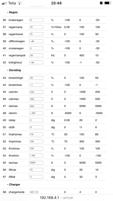

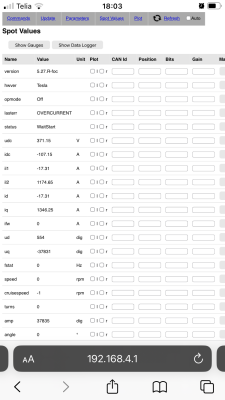

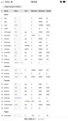

Audia2electric
Posts: 8
Joined: Mon Jul 31, 2023 5:08 pm
Re: Inverter Firmware 5.27.R
Post by Audia2electric »
Help!
5.27 uploaded to v.6 tesla sdu board. Before upload (5.20) I also activated hillhold and changed idlethrottlim from 50 to 60. After cycle off/on my parameter set is different…I dont have parameterset started with -Motor->
0 boost
1 tweak
As soon as I activate drive inverter clicks and overcurrent is present. Have I uploaded wrong file? see attached..
Returning from hillhold and idlethtrottle don’t help!
Just got car running again with proper coolant flow and pump…shouldnt mess with working system😕
Romale
Posts: 550
Location: Romania
Has thanked: 346 times
Been thanked: 101 times
Post by Romale »
Audia2electric wrote: Mon Sep 04, 2023 5:26 pm Help!
you made a gross mistake and flashed the firmware from the synchronous motor into the asynchronous)) download and update to the firmware marked sine!
evil neodymium :twisted:
Audia2electric
Posts: 8
Thanks! Prblm solved! Changed to sin file. Testrun showed very smooth in low acceleration but cutoff probably overcurrent not letting me go hard on throttle. Changed back to 5.20
Any parameter changes needed to be able to run 5.27?
Been thanked: 1918 times
catphish wrote: Sat Jul 01, 2023 11:35 pm I always assumed it would go into neutral and stay there. Maybe that would be a safer behaviour in that case.
Just quoting you so you get a bell :) Any idea on the above?
Romale
Posts: 550
Location: Romania
Post by Romale »
johu wrote: Tue Sep 12, 2023 10:48 am Any idea on the above?
switching to neutral when switching off the sw forward should clearly work immediately, regardless of what the motor speed is (isn't that the case now?) but the reverse gear, when turned on, turns on at speeds below those specified in the value (it seems to work like that, I personally used the value of 1000 rpm)
catphish
Posts: 966
Location: Dorset, UK
Has thanked: 99 times
Been thanked: 197 times
Post by catphish »
Audia2electric wrote: Mon Sep 04, 2023 8:21 pm Thanks! Prblm solved! Changed to sin file. Testrun showed very smooth in low acceleration but cutoff probably overcurrent not letting me go hard on throttle. Changed back to 5.20
The immediate problem here is that your fweak value is much too low. Lower fweak = more current. For reference, here is my SDU tune:
boost = 3200
fweak = 230
fslipmin=1.5
fslipmax = 3.0
fslipconstmax = 3.0
Increase fweak to 250 and go from there.
