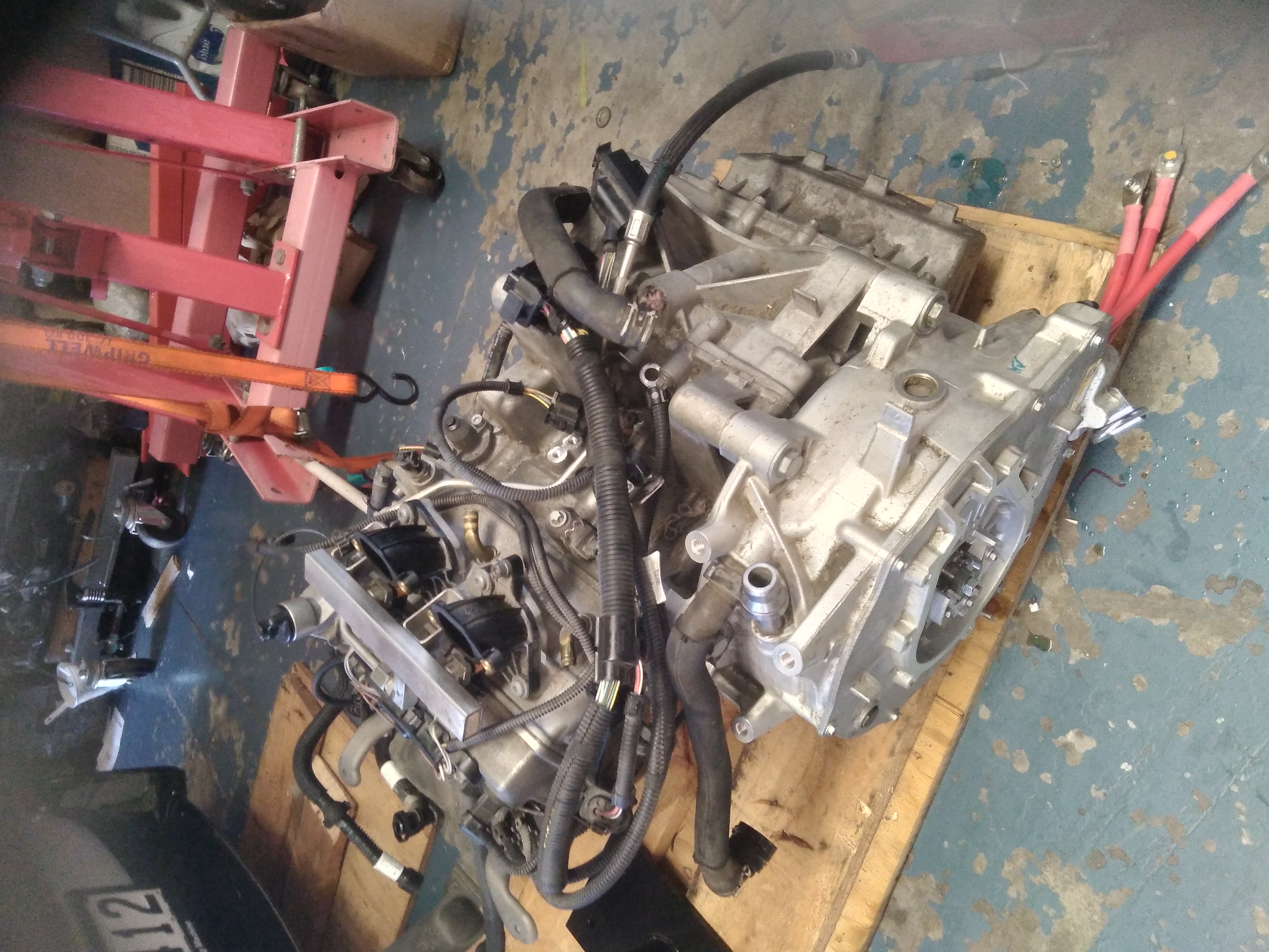

Presently checking for resolver usage. If can spin with a Leaf inverter with known leaf CAN info, will be able to start the ICE
Stand alone at this stage. Speeduino looks promising, may also do a hall effect switch, and bicycle sensor magnets, for Ignition, and use Lpg as first run, to see what can achieve.
Picture of the separated Generator, with the torsional drive , anti backlash, possibly engine pulse dampening, and menace to extract and refit Splined Coupling
In the foreground.
In the foreground.

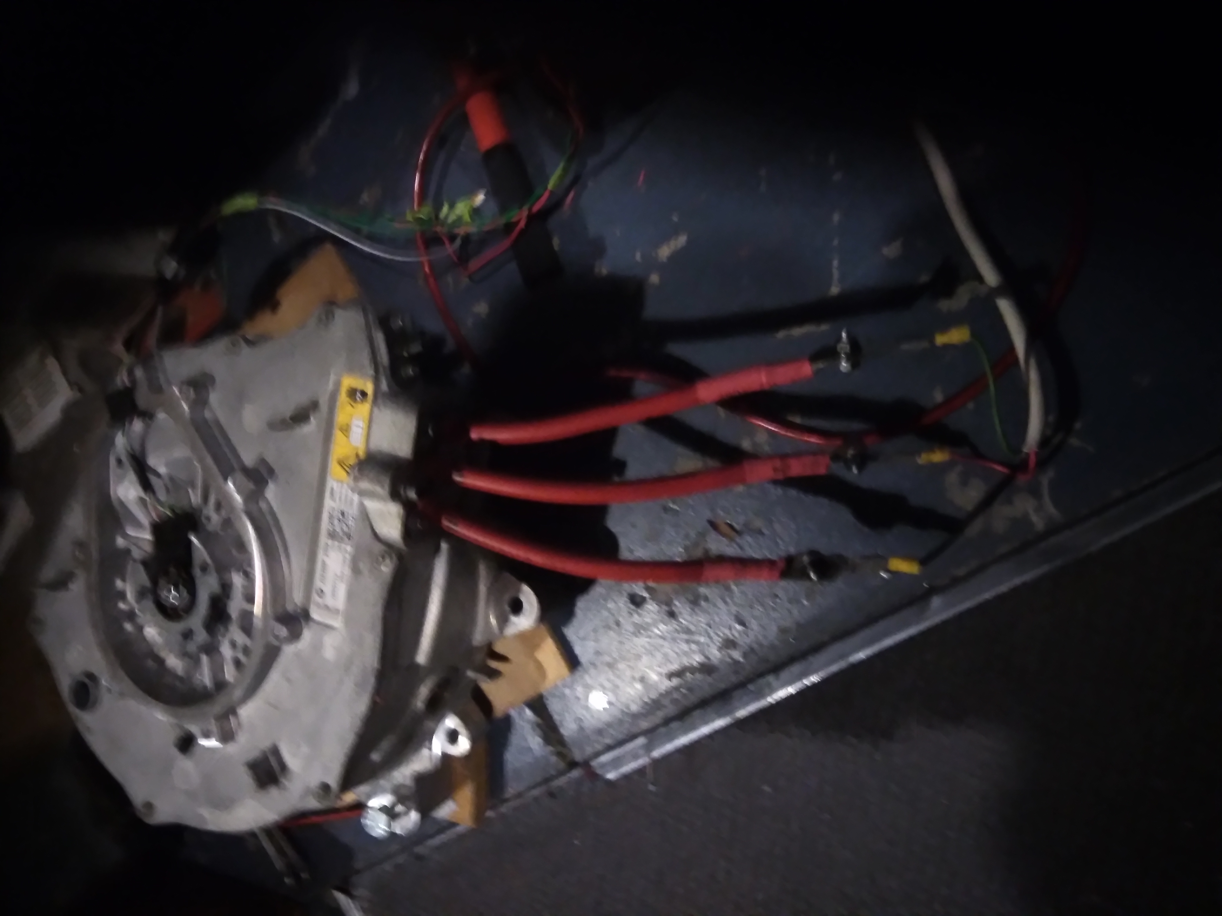

A step further.
Attempts to locate a Hv plug for the REX generator have not been successful.
A dismantle to obtain a suitable UVW connection was undertaken
Some interesting finds.
Coils are 2.00mm wire wound... how many Amps ??
15 windings , as in 5 per phase. AL 5 on one phase appear to be in parallel.. My guess is maybe an eyeball at 30 A in the winding, X 5 , so 150 A per phase, so maybe 250A total at say 50v, So that would be 12.5 Kw ish.
Think there was mention of 12Kw mode, but would think this would do 80 to 90 kph at around 120wh/ km.
Can anyone confirm what an i3 can do in ReX run when the main pack is depleted.?

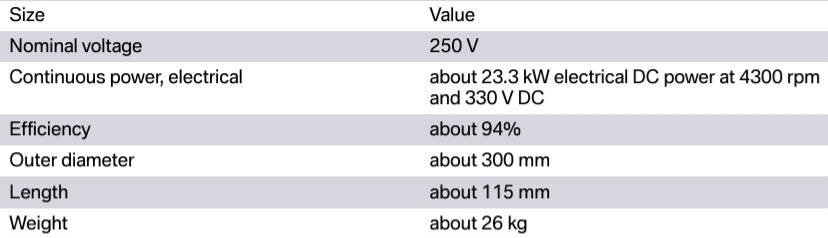

Re: State of Rex hacking?
Thanks for that...
Still more curious, the 23.3 Kw stated sounds Nice.
That's much more than I feel the motor hardware looks capable of, But more to Learn.
My Big Baffle is why only around 6 or 7 kw are used in operation..
Is it some USA regulatory nobbling?
I understand that the REX was made to only function when battery at 5% SOC, a USA requirement.
The Original software allowed the Rex to operate on request. And heard of one that had been reprogrammed several years ago, to earlier status.

Have just achieved the Generator spinning over oñ being patched to a Nissan Leaf gen 2 inverter,
Will see how can post this progress, am challenged with videos loading... Harder than making German electrics run on Japanese electronics..for me at this stage.

""Between 65-70mph on relatively flat ground with mild climate control usage. I believe it runs at the higher power mode above 56mph.""
Thanks Phate for the assistance, A further question, if you have run the battery right down low.
Re the REX operation,
When down to the lowest level as in 6% SOC indicated, where there is effectively no draw in the battery,
Is the 65-70 mph available, OR is that only when both ghe REX and the battery are contributing to the drivetrain?
Just trying to determine what the REX'S power alone is by reference to it's performance when battery is depleted

With much premeditation , heaving levers and printing engineer's assistsnce, the Non serviceable Torsion spline has been re Torqued..
As the unit is extracted, the tension releases and the parts all fall apart... So there Was debate as to whether the tension should be forward and giving miniscule dampening, or reverse and the torsion being a backlash eliminator, with solid forward spline drive. Anyone have any idea..? Have gone gor the forward option..
With some guiding threaded rods and carefully assembling, the Torsion spline has been reassembled to couple the Motor and Generator ...
Best advise for this is the same as Hitchhiker's guide to the Universe about Bogon Spacecraft hitching...Don't do it. Where possible Don't separate the motor and generator.. Bmw manual requires you to replaced the Torsion spline ..
Good news is it's all back together and preparing to turn over with the Leaf inverter...
