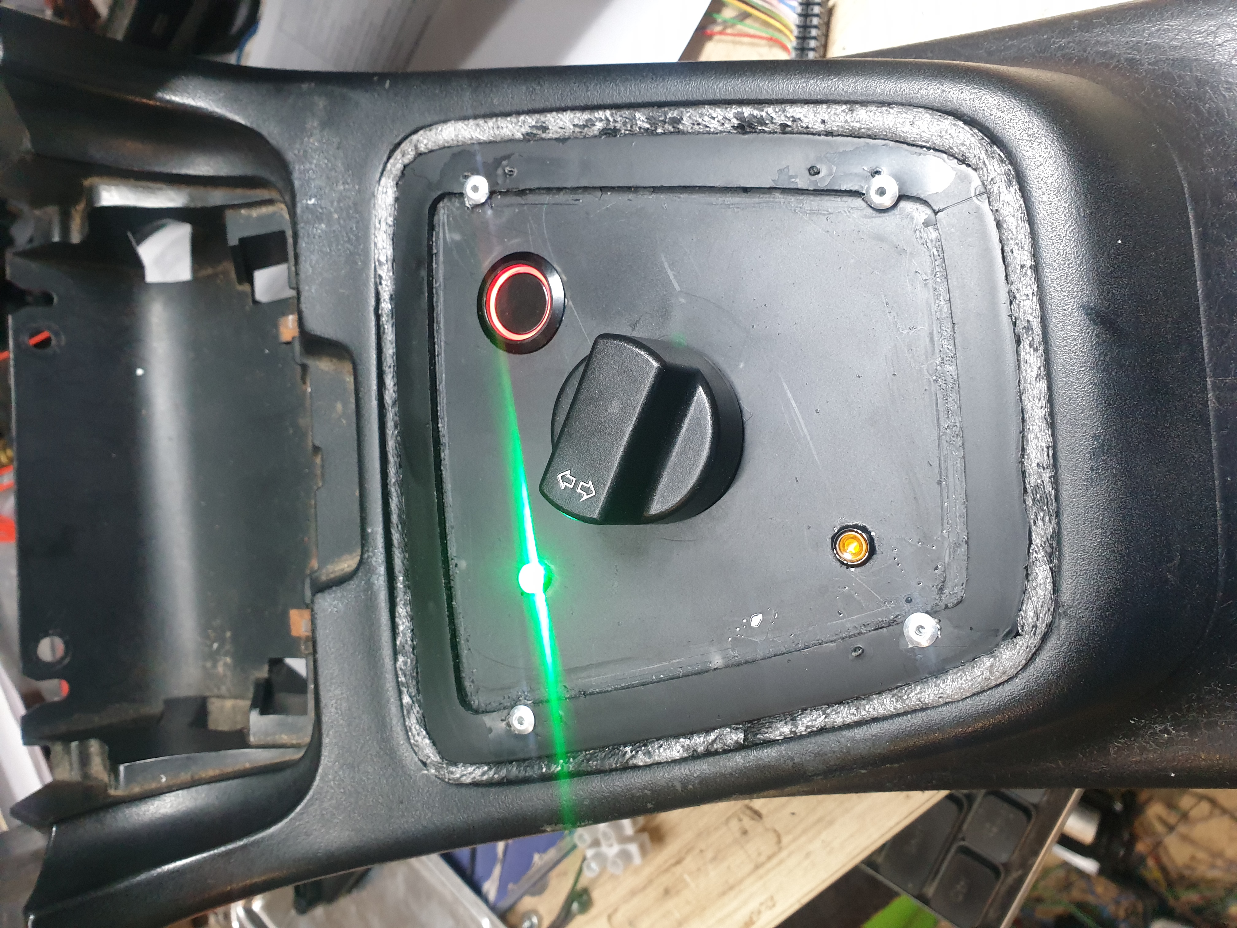

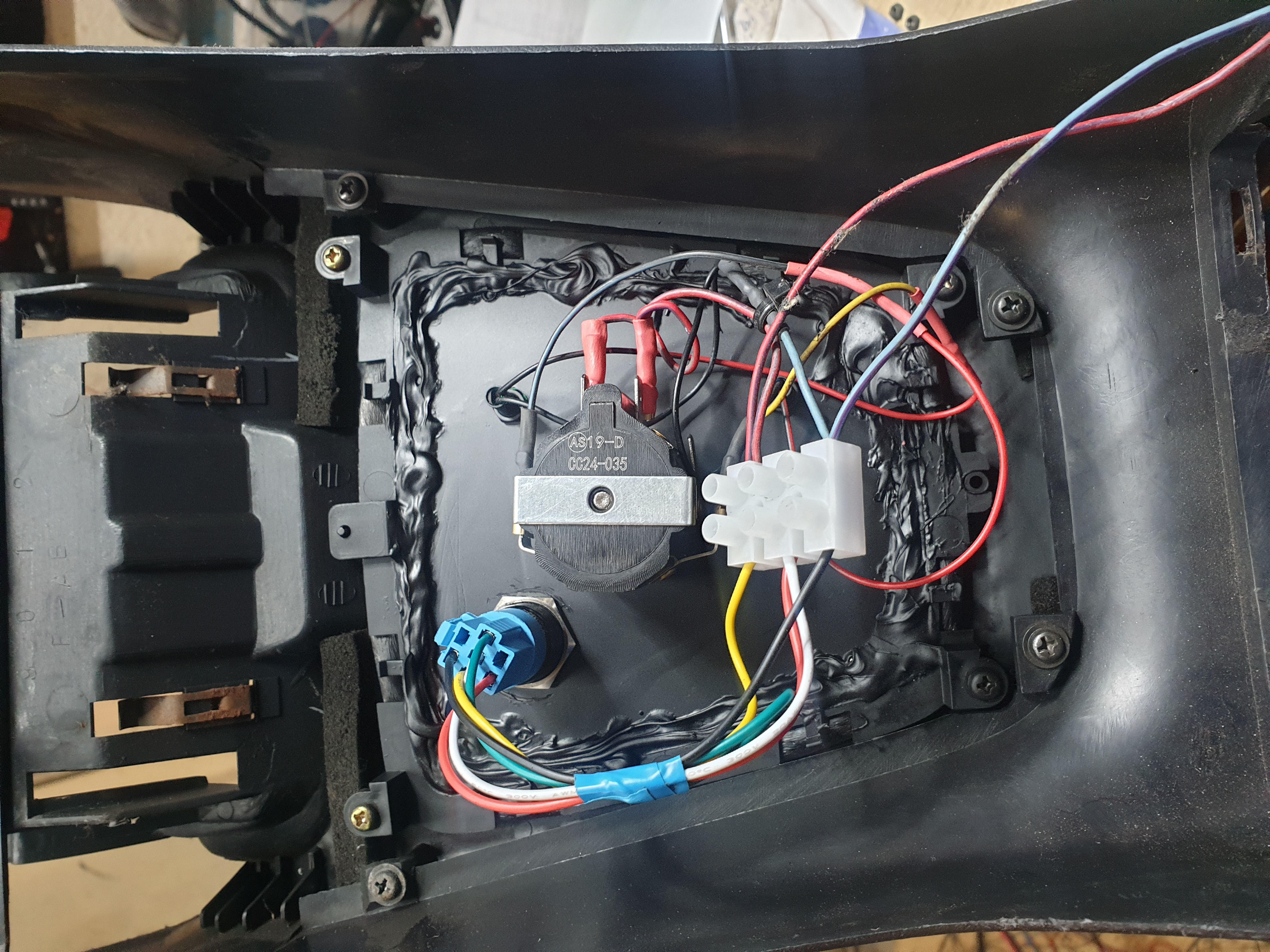

Here you can see how i used one tractor direction lights indicator from a hardware store and i add two LEDs.
- In Neutral N means that neither of inputs is active and no LEDs are lit.
- For FWD one 12V input is active and one green LED is active.
- For REV the rear 12V input is active and amber LED is active.
There are several terminals on that selector which you could use for signaling direction to other devices, for example turning on the rear lights.
Or there was a push button option where you can press down on the knob to activate horn contact. This could be used as addition safety feature with direction change. Later on i will add stickers saying N, FWD and REV for MOT.
Other switch i use to turn on heater and the pump. I love the signal LED on the rim :).
The cover is cut from 4mm transparent plexi plate where i sand the underside and spray paint it black. This makes the top gloss black and additionaly color cant be damaged on top.

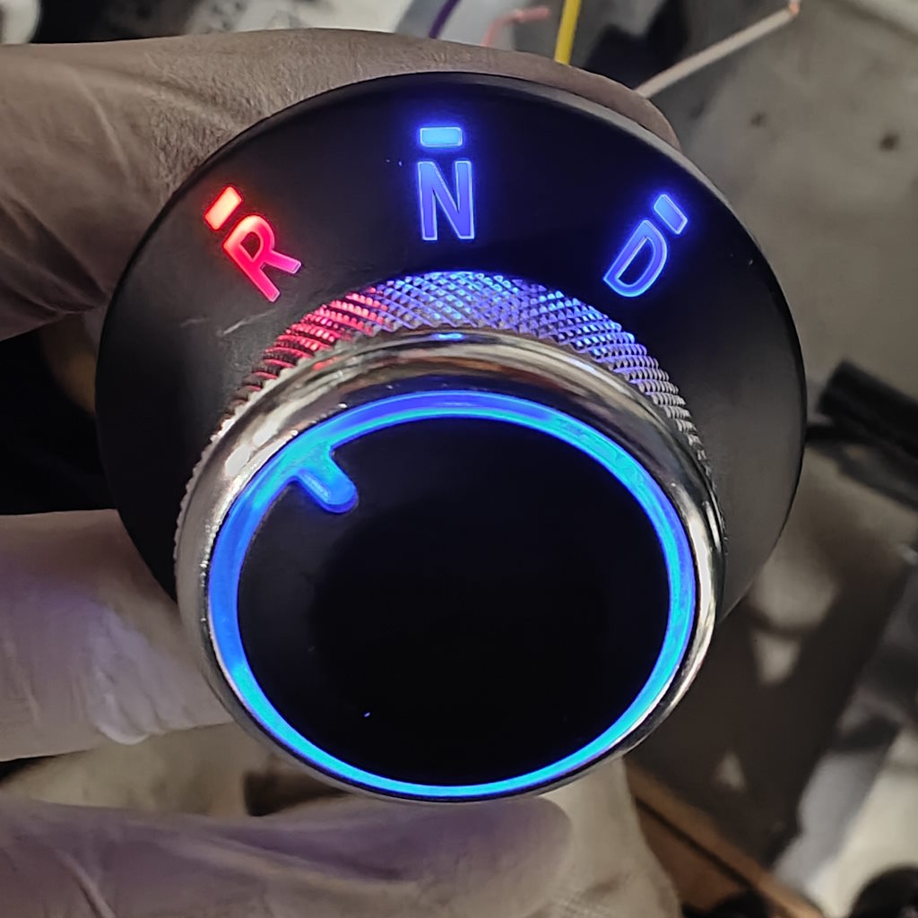

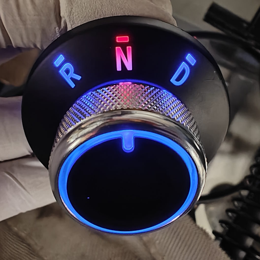

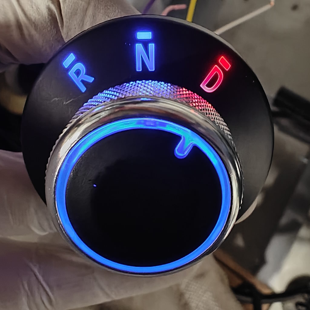

I am using this style of switch
It has a signal and switch output. Blue led is not annoyingly bright.

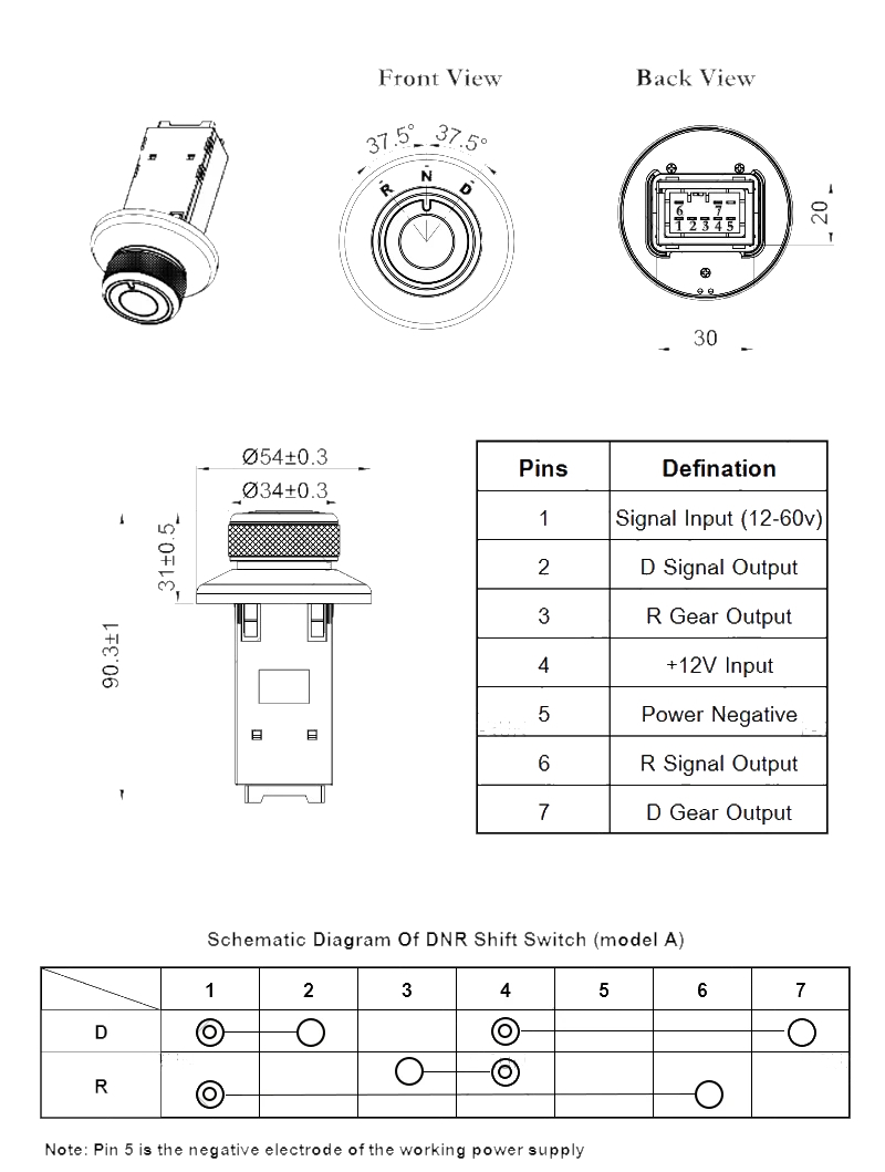

arber333 wrote: Wed Sep 04, 2024 3:34 pm What kind of polarity on the outputs?
There is a schematic/connection table is in last pic of my previous post :)
Drive outputs pin 2 & 7
Reverse outputs pin 3 & 6
pins 3 & 7 output +12v
Pins 2 & 6 output whatever you feed to pin 1.
LEDs are not controllable separately, they switch color depending on selector position.
Posts: 3796
Been thanked: 413 times
Re: Direction rocker switch (F-N-R) for Zombieverter wiring?
J0hannes wrote: Thu Sep 05, 2024 7:05 am There is a schematic/connection table is in last pic of my previous post :)
My question was what kind of outputs are those? Are they open collector or positive outputs?
Are you saying if you supply GND to pin 1 then GND will appear on active pins?
tnx
J0hannes
Posts: 159
Has thanked: 21 times
Been thanked: 182 times
Post by J0hannes »
arber333 wrote: Thu Sep 05, 2024 3:41 pm My question was what kind of outputs are those? Are they open collector or positive outputs?
tnx
Yes that's what I'm trying to say.
This looks to me like it is a mechanical rocker switch with rocker covered with a knob, so nothing fancy in that sense :)
There are two possible outputs for both D & R.
One is positive (connected to the +12v supply, which also powers the leds) and the other output is dependent on the pin 1 connection.
If pin 1 is not connected, you don't get an output from the pins defined as signal outputs.
