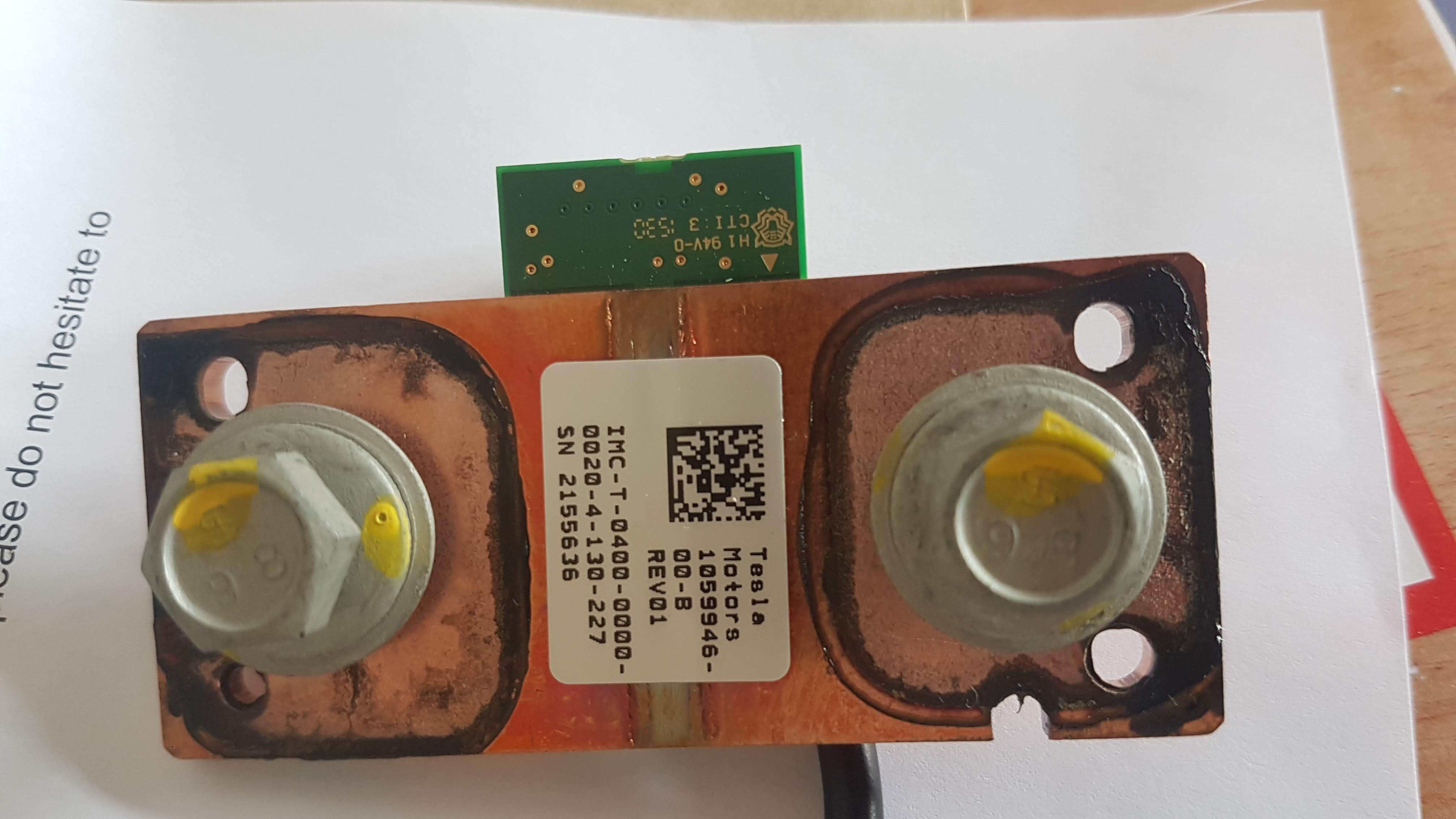

Cheap Tesla Shunts (£24)
Second Life EV Batteries has Telsa P100D shunts cheap https://www.secondlife-evbatteries.com/ ... hunt-p100d @tom91 has some code for them https://github.com/Tom-evnut/Tesla-Current-Shunt
I've just had one delivered to play with.

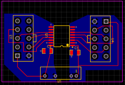

I have created a simple SPI isolator in easyeda and was wondering if any EEng could give some advice ... I have placed the tracks as far apart as possible for isolation however i have not used a ground plane is that probably ok in this situation? also as the voltage is at most 400v it didn't seem necessary to make a machined air gap is rhat also ok? Any advice would be appreciated.
PS ic is ADUM1401CRWZ-RL & 3,3v to 5v DCDC is TBA 1-0311m also this will be released publicly once finished,

rstevens81 wrote: Sat Apr 10, 2021 9:51 pm I have created a simple SPI isolator in easyeda and was wondering if any EEng could give some advice ... I have placed the tracks as far apart as possible for isolation however i have not used a ground plane is that probably ok in this situation? also as the voltage is at most 400v it didn't seem necessary to make a machined air gap is rhat also ok? Any advice would be appreciated.
Great idea!
I would use a DC/DC with greater physical leg distance between primary and secondary side, for example https://www.mouser.se/ProductDetail/CUI ... blDw%3D%3D
I also suggests use of 2pcs of bypass capacitors(ceramic) of 100nF connected between pin1 & pin2 resp. pin15 & pin16 on the adum isolator IC, located as close to the IC as possible.
I would avoid any routing making the isolation distance shorter than the component leg distance, ie no routing under the components over the isolation barrier. Also, might be good idea to have a ground plane on each side of the barrier, on the backside of the board.

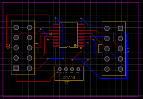

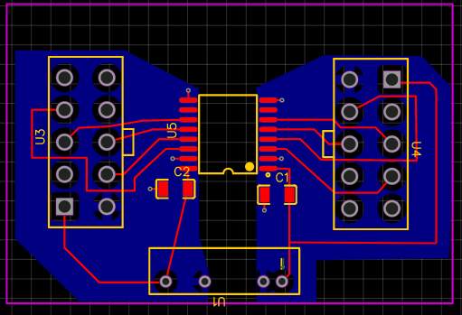

I think i have captured your suggested changes any further suggestions or and mistakes i have made :)

Looks good to me.
There is no harm in extending the ground planes to fill the entire board, except for the isolation barrier, but will work as is.

published:
https://oshwlab.com/rstevens81/SPI-Isolator-Tesla-Shunt
Have ordered pcb (from JLC along with components from LCSC) will feed back any findings.
Note: DCDC changed to more readily available one.

Got one up and running with 3.3v.
Contains a IHM-A-1500 from ISABELLENHÜTTE https://studylib.net/doc/18803520/ihm-a-1500, a STM8AF6266TC and a 2903AVQ.
Based on datasheets 3.3 or 5v should be fine, based on my uneducated reading of them
