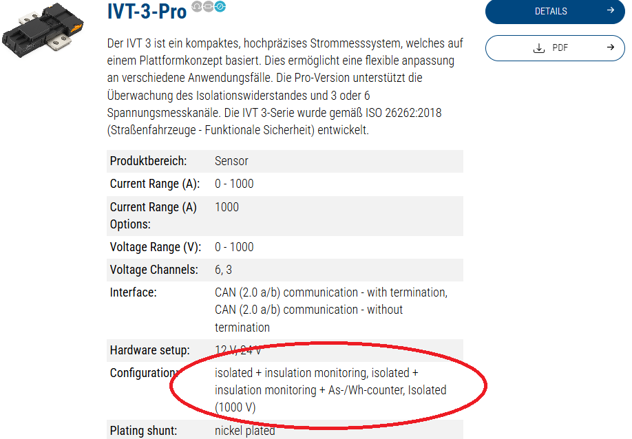

The new Isabellenhütte IVT 3 pro has an integrated insulation monitor. At around €300, it is cheaper than anything from Bender! Has anyone already used it, or does anyone know the CAN messages?

Isabellenhütten has informed me that the sensor sold by DigiKey does not measure insulation. The type designation must have an “R” after the “I,” e.g., “IVT-3-1K-U6-IR-CAN2-12.”

According to the datasheet just the pro version can Donte Isolation Monitoring

According to the data sheet, there is no Pro version “without” insulation measurement. Likewise, there is no Base version “with” voltage measurement. DigiKey offers both the Base and Pro versions, from which I concluded that the Pro version available there has insulation measurement. However, this is not the case. Pre-production samples can be requested from Isabellenhütten.
Based on this description, there appear to be three versions!

I have now received and installed my IVT Pro with insulation monitoring. The mounting dimensions are the same as for the old IVT with 1k (2 holes), but as you can see from the data sheet, the housing is significantly larger. The connectors are on the side, and I have not yet found a source for them. I printed a suitable cover right away. The CAN messages are different from the old ones. The configuration can be changed by customers via UDS security access level 1, whatever that means. I use it out of the box
The insulation measurement can be switched on and off via CAN to avoid interference with external insulation measurements during DC charging. There are no switching outputs. Output is exclusively via CAN. A Ctrl. CAN message with CRC must be sent continuously, otherwise the insulation measurement stops. The other functions also work without it. I also found an insulation fault right away. A radiator hose was in contact with an exposed part of the HV+ cable, causing the resistance to drop below 1kOhm. After I fitted a plastic cap to the contact, the value rose to 3600kOhm. The internal sensor warning threshold is 1000kOhm and the alarm threshold is 400kOhm. For my 400V system, 200kOhm AC and 40kOhm DC would be sufficient after the R100. With an additional 2 MOhm resistor, the system measured perfectly and my total value dropped to 1700 kOhm, which would still be sufficient. HV+ and HV- are also output separately, making it possible to identify which line is causing the problem.
