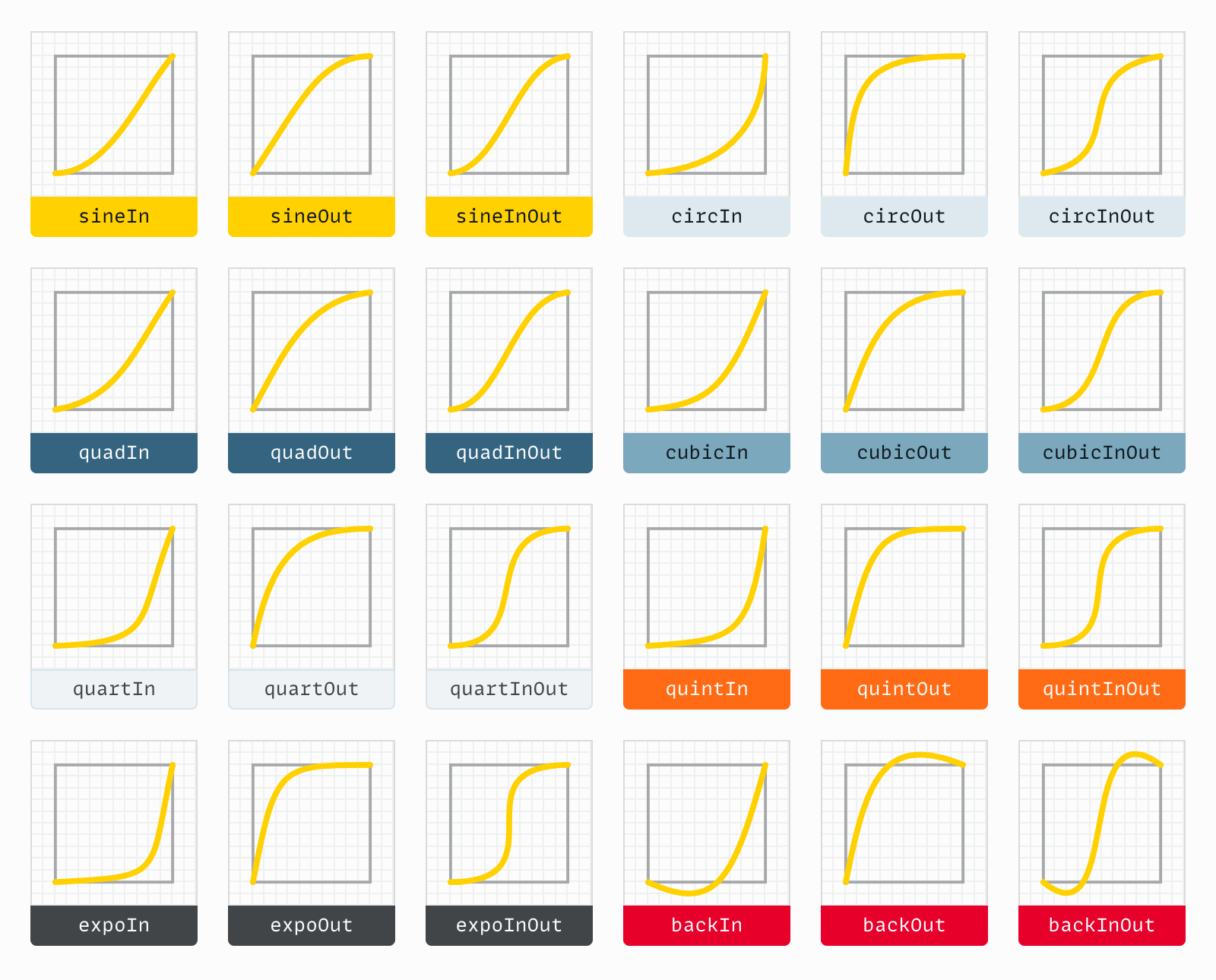

and here is version that ramps down regentravel with a expoOut curve:
regentravel 30 	km/h: 31 	hz: 096.0	pedal: 21.0% 	potnom: -18.0
regentravel 30 	km/h: 29 	hz: 088.9	pedal: 19.0% 	potnom: -22.0
regentravel 30 	km/h: 26 	hz: 081.4	pedal: 17.0% 	potnom: -26.0
regentravel 30 	km/h: 23 	hz: 073.6	pedal: 15.0% 	potnom: -30.0
regentravel 30 	km/h: 20 	hz: 065.2	pedal: 13.0% 	potnom: -34.1
regentravel 30 	km/h: 17 	hz: 056.5	pedal: 11.0% 	potnom: -38.1
regentravel 30 	km/h: 13 	hz: 047.2	pedal: 9.0% 	potnom: -42.1
regentravel 30 	km/h: 10 	hz: 037.4	pedal: 7.0% 	potnom: -43.1
regentravel 30 	km/h: 7 	hz: 027.7	pedal: 5.0% 	potnom: -34.6
regentravel 29 	km/h: 5 	hz: 020.0	pedal: 3.0% 	potnom: -27.0
regentravel 27 	km/h: 3 	hz: 014.1	pedal: 1.0% 	potnom: -20.4
regentravel 24 	km/h: 2 	hz: 009.7	pedal: 0.0% 	potnom: -14.5
regentravel 20 	km/h: 2 	hz: 006.5	pedal: 0.0% 	potnom: -9.8
regentravel 16 	km/h: 1 	hz: 004.4	pedal: 0.0% 	potnom: -6.6
	- slight acceleration when almost standsill below -
regentravel 12 	km/h: 1 	hz: 003.0	pedal: 2.0% 	potnom: -3.8
regentravel 9 	km/h: 1 	hz: 002.2	pedal: 4.0% 	potnom: -1.9
regentravel 8 	km/h: 1 	hz: 001.8	pedal: 6.0% 	potnom: -0.7
regentravel 7 	km/h: 1 	hz: 001.6	pedal: 8.0% 	potnom: 0.6
regentravel 7 	km/h: 2 	hz: 002.2	pedal: 10.0% 	potnom: 2.8
This second version - using curve - is smoother and giving stronger regen and more control on low speeds. Regen hits -43 on this second version where on the linear speed based version, it only hits -34.
Different curves can be applied. This expoOut is quite extreme, and regentravel goes to zero only at the very end but makes a good example. Attached different curves for ramping down the regentravel. Those curves ending with Out work the best here.
