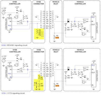

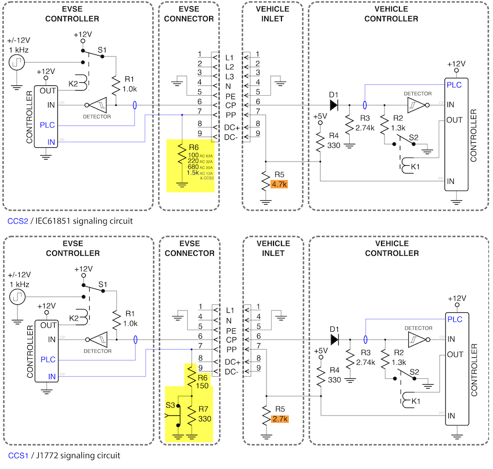

Posts: 1884
Has thanked: 91 times
Been thanked: 517 times
Re: outlander charger with zombieverter
My plan is to use the PP with an analogue in on zombie to automate charging. Though this isn't coded yet
Should be simple code and a couple of resistors

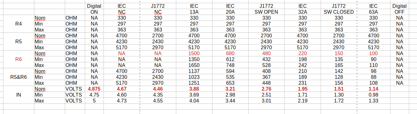

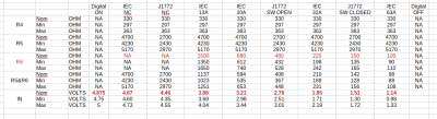

rstevens81
Posts: 386
Location: Bristol, UK
Has thanked: 29 times
Been thanked: 114 times
Post by rstevens81 »
here an excel sheet that's got the actual voltages that the pin will see :)
for the lazy here a pic :)
J1772_IEC61851.ods
(266.04 KiB) Downloaded 262 times
