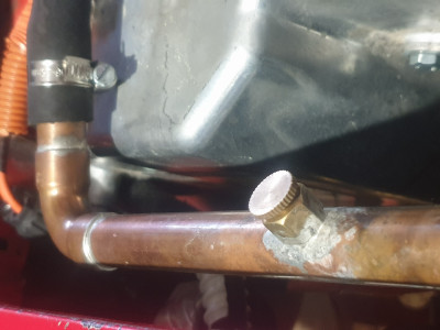

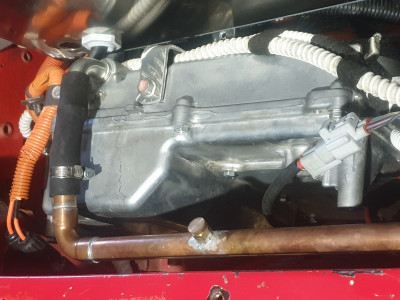

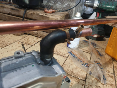

See here the deair system i useP.S.Mangelsdorf wrote: ↑Tue Nov 28, 2023 1:20 pm On my LDU powered car, I have had many, many issues with cooling the drive unit on the street.
Here's what I've learned:
- having somewhere for the air that comes through the radiator to go is important. Like others mentioned, its easy for it to get stuck in an engine bay. I'm still working on getting the air out from underhood.
I use a piece of central heating copper tube dia 18mm make a 8mm hole and solder a brass screw valve to it perpendicular. I use plummers paste to guarantee good joint with solder. Zinc i use is thick pure zinc wire no other additives. You can get everything in a hardware store.
The idea is that valve to be on the highest point of the tubing. Your header tank must be higher though to supply liquid consistently.
On the lowest point is the pump and a supply intake. I simply solder 10mm copper tube on 18mm copper tubing so my header tank will supply liquid to the lowest (practical) part and liquid will push air out through the top vent.
There is no problem in using the same header for cooling and heating system as long as it is closed on both sides.
