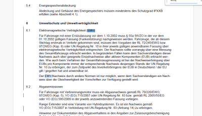

I´m a mechancial engineer sited in germany and recently, I´m doing a VW T3 conversion with a Tesla SDU (still OEM-Board) and VW MEB- modules. This project needs a VCU that can work with the libal n-BMS and comes with some kind of hardware proof for EMC (mandatory for german road approval)
Does them zombieverter has any EMC proof? Or has anyone have to deal with this point already?

why do you think that the EMC is mandatory. The TÜV leaflet 764 says that no EMC is necessary for cars before 2002.
Re: EMC proof of the zombieverter
You´re right. I simply overread that sentence and focused on how to make sure all components are EMC. I was pretty relieved my TüV- guy accepted that way instead of having to EMC check the whole car. Lets see what §55 STVzO demands..

That's exactly how I see it. The limit values are similar, the regulation does not apply to purely electric vehicles before 2002. This would come into play if it was a petrol hybrid. These cases are also covered in leaflet 764. The TÜV will have no problem as long as the motor and inverter are from a current car, even if the control board has been replaced. If this were not the case, simply installing another fan or hi-fi equipment would require an EMC test!

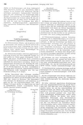

My TÜV inspector put it like this. In principle, all vehicles must comply with the regulations that applied when they first entered road traffic. However, you should be guided by the state of the art. In my case, a car from 1950, I could pack the battery in a wooden box and wouldn't need any protection against contact, which my inspector wouldn't like.
